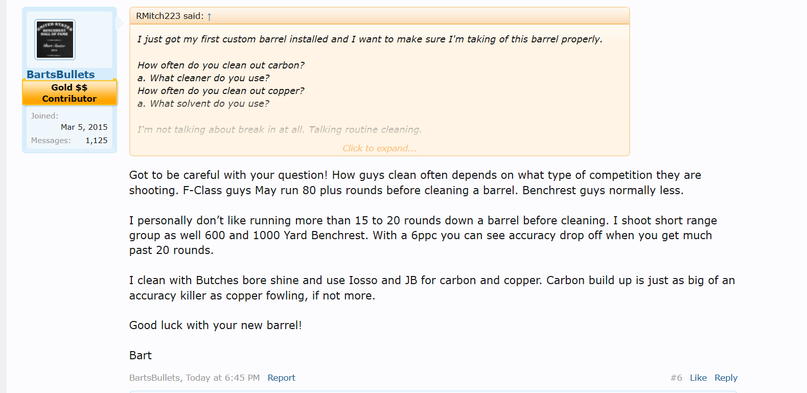

I just got my first custom barrel installed and I want to make sure I'm taking care of this barrel properly.
How often do you clean out carbon?
a. What cleaner do you use?
How often do you clean out copper?
a. What solvent do you use?
I'm not talking about break in at all. Talking routine cleaning.
Thanks!
