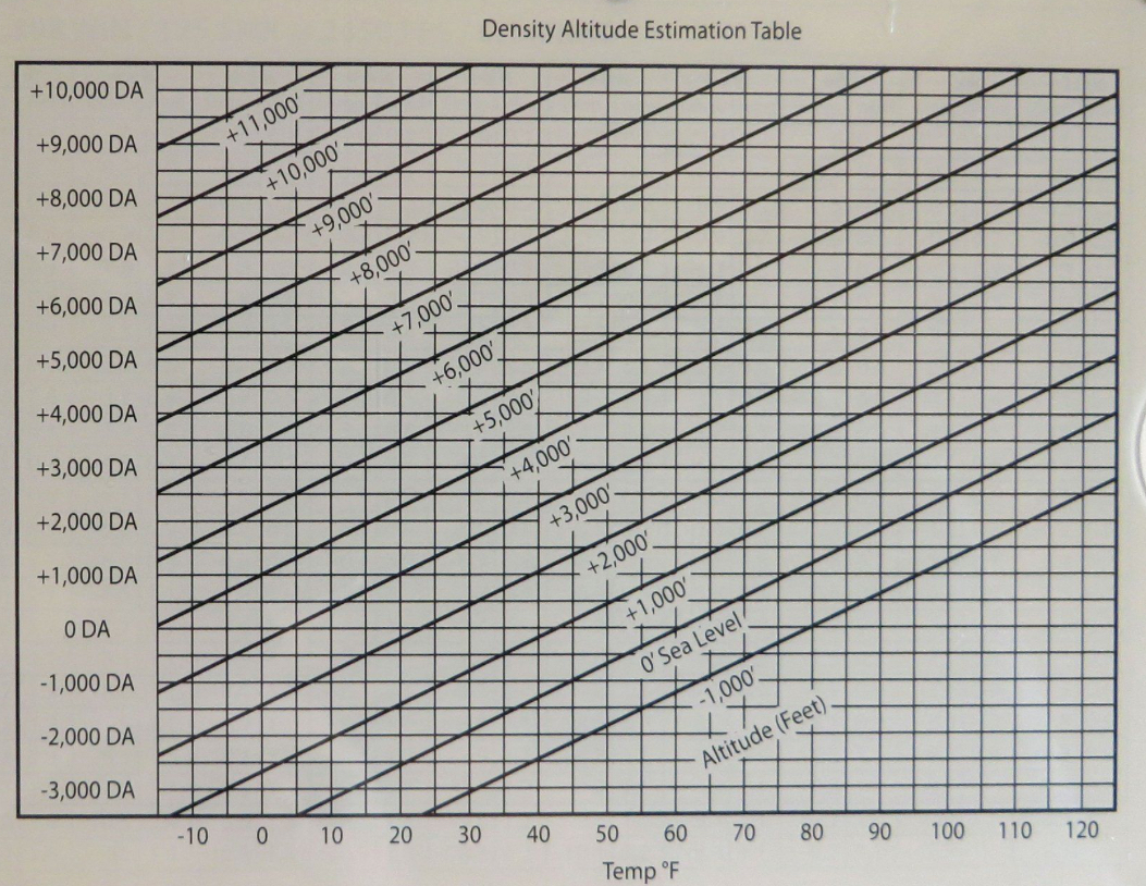

Don’t over complicate. It’s really simple. Standard atmosphere is 15 degrees C at sea level with a pressure of 29.92 in Hg.
The standard lapse rate is 2 degrees C per 1000 ft increase in altitude/elevation. The standard lapse rate for pressure is 1 in Hg per 1000 feet.
So standard temp and pressure at 5000 feet is 5 C and 24.92 in Hg
in freedom units, it’s 59 degrees F and 29.92 at sea level is standard. Lapse rate is 3.5F per 1000 feet and still 1 inch.
this chart above gets you in the ballpark enough for shooting.
the big takeaway is that about every 15F above standard equals 1000 ft increase in DA. Memorize that and you don’t need this chart.
all this is an approximation and gets you in the shooters ballpark. It ignores pressure effects and humidity. But is close enough for what we do.
