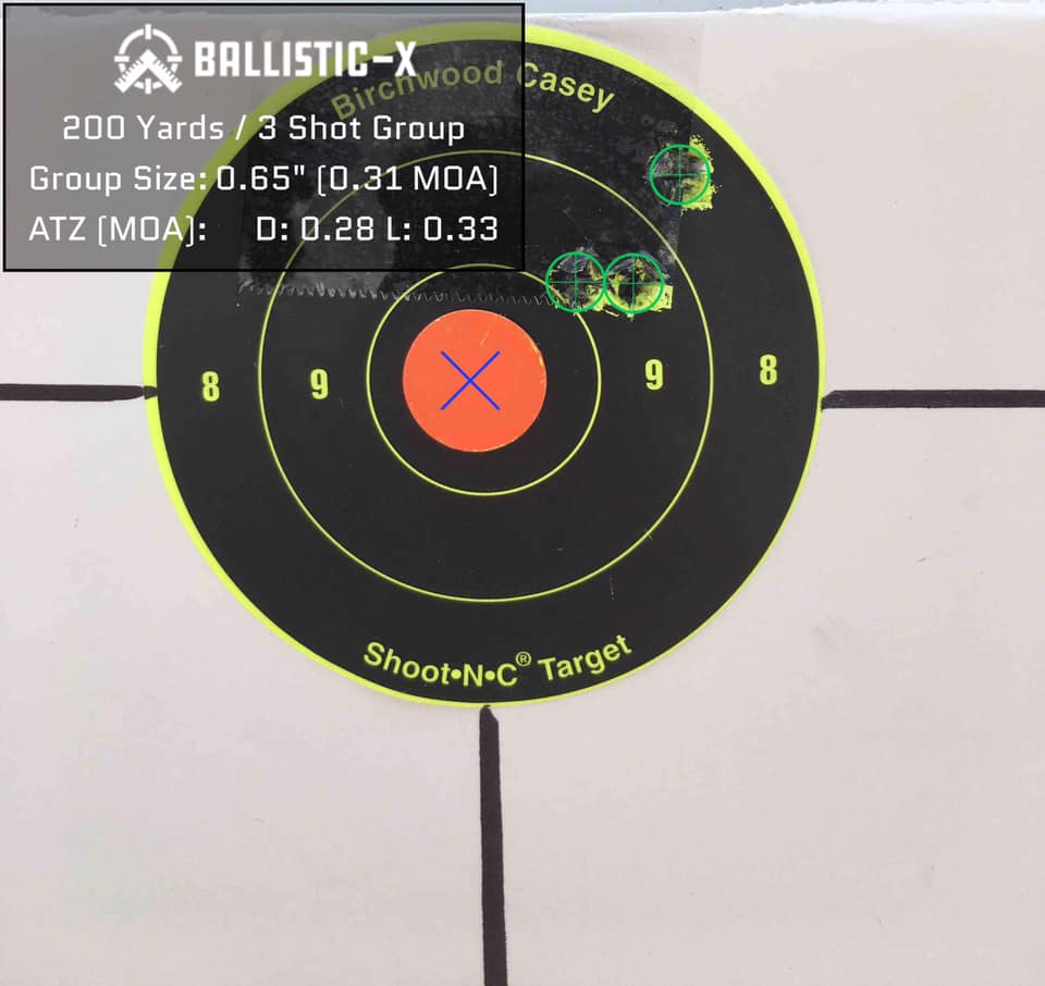

So I went back to the range and ran a ladder test at 300 yards working from 41 grains of H4350 up to 43 grains and I verified the most accurate load at 200 yards.
The best shooting load was 140 ELD / 41.5gr H4350 / 210M Primer seated 0.030 off the lands (2.900 COAL). The groups shown below were all @ 200 yards shot today, 7/26. The interesting thing is that my velocity is 2,613 fps. Seems really freaking slow. My buddy gets 2775 out of the same load.
Would you guys recommend to keep shooting it? Primary use is as a PRS match rifle and it seems like the accuracy is still there - just seems like my velocity took a major dump.
