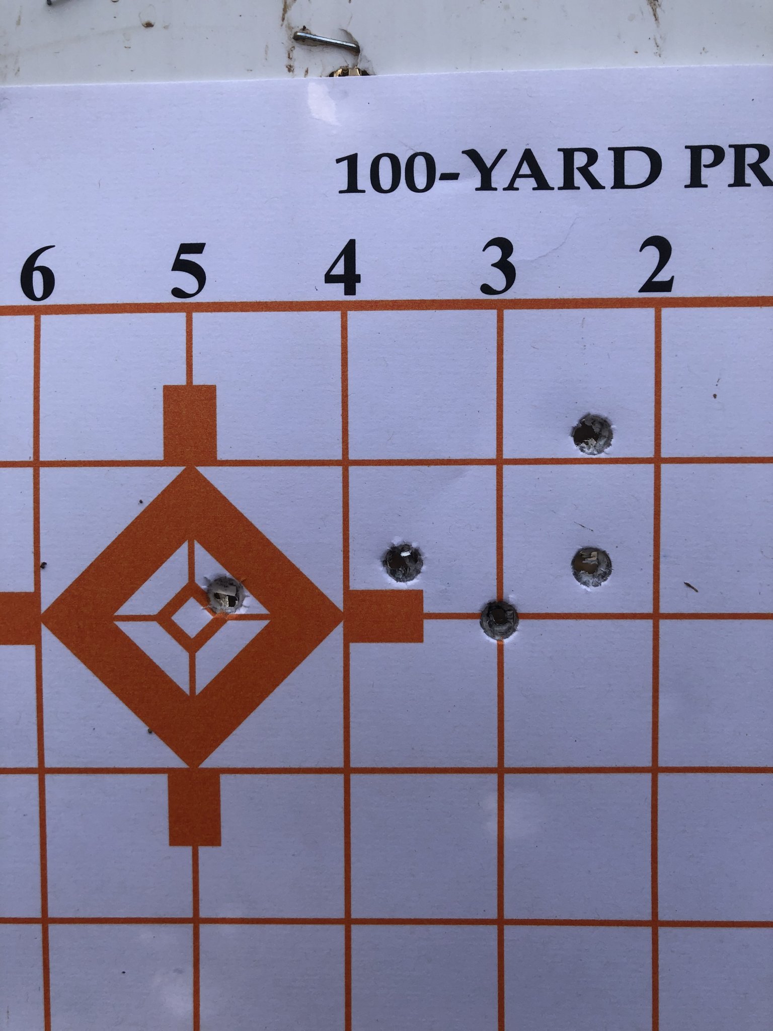

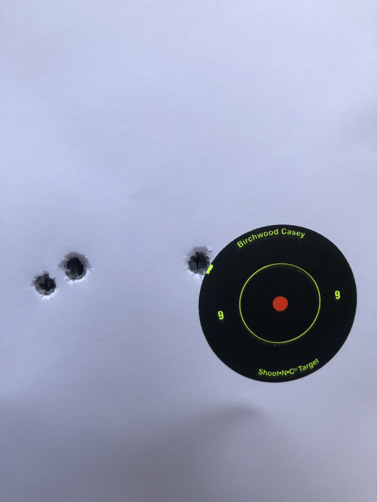

Ok now that I have your attention I have a conundrum that I haven't figured out.
My dad recently bought an X-Bolt Pro LR in 6.5 PRC and to be frank it shoots inconsistent at best and terrible at worst. After chasing my tail with 3 shot load development groups I buckled down and shot 10 rounds of factory ammo to check the group size. One 4" group later I sent it back to Browning who shot a 3 rounds into .55" at 50 yards and was told it meets their 0.75" spec.
So I took it to the range to compare it to my 6.5 PRC and it continues to string shots along both horizontally and vertically with no rhyme or reason while my M7 shoots under 1/2" with the exact same ammo. So after shooting a group that was 1" vertical and 2.5" horizontal I was trying to determine how much the BC would be effected if I took the scope off before I javelined it into the woods when I got the bright idea to take the suppressor off mine and put it on the Browning.

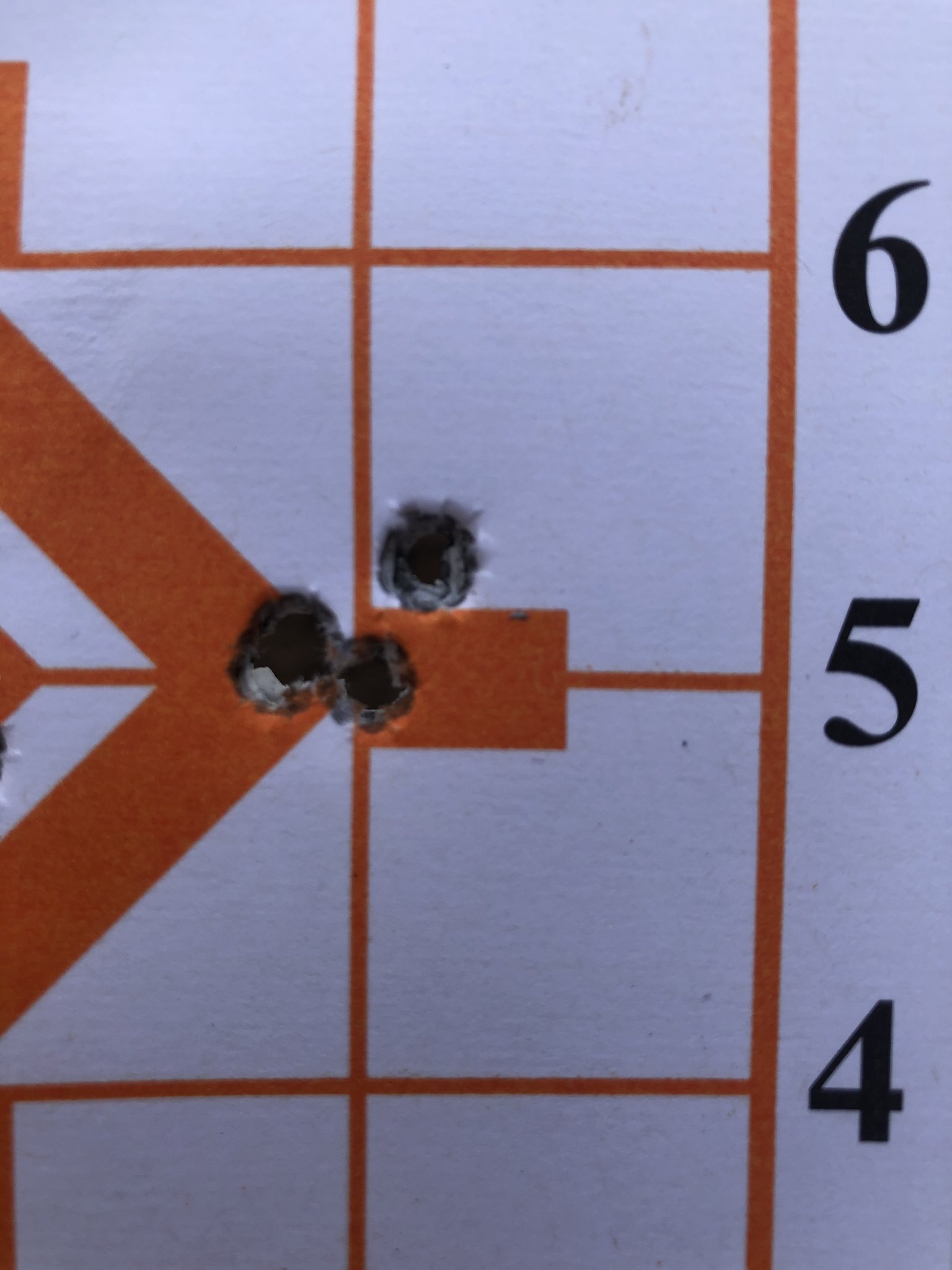

That's where the title comes from, the next 4 rounds went into a ragged 0.4 MOA hole, the best group this gun has shot by an inch, and I'm utterly baffled as to what would cause the suppressor to have such a pronounced effect on the accuracy of the rifle. I even went back and shot my rifle unsuppressed to confirm that is wasn't just me pulling shots and proceeded to print the same size groups as it did suppressed.
So anyone have any ideas? None of my other rifles exhibit any noticeable change in accuracy so I have no idea what is wrong with this one that apparently weight can fix it?.
Did Browning inform you of the ammunition they used to get their results? Bullet weight, etc. I’m a novice, so I don’t have much technical advice to offer. However I’m interested to see what others have to say.
I do, blew through a $114 box of Hammer bullets trying to get that damn thing to shoot with powder charges from 52gr to 58.5gr H4831 trying to find a load that works but no dice. Also tried H1000 and Superformance with the same results.

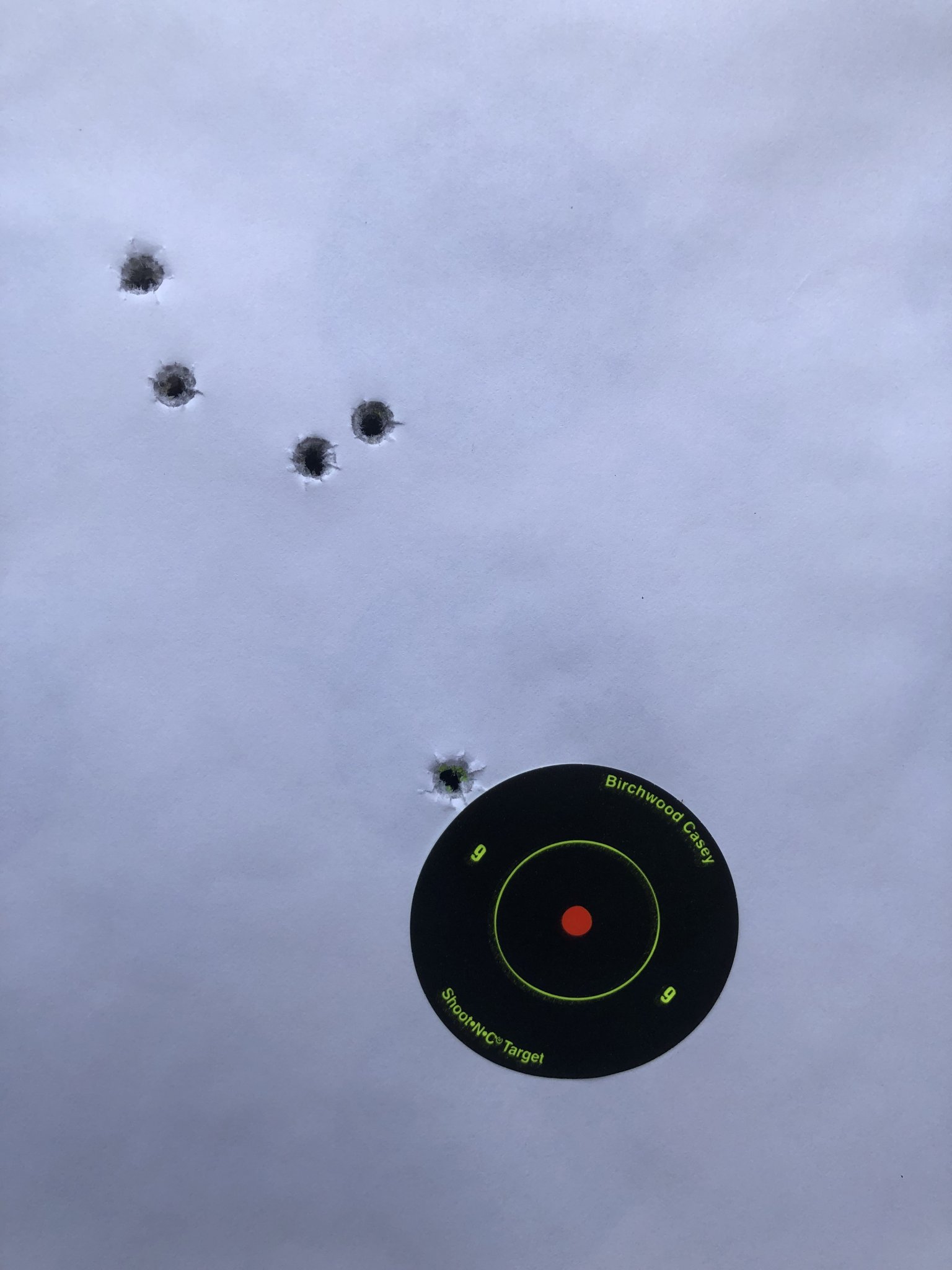

it could individually print ok 3 shot groups but it seemed to have a wandering zero as the groups would shift from target to target. However if you overlaid them on the same target you get a vastly larger group.
I would get a group like that but the next three shot group would be at the top of the target with a flier to the right. It was more random luck if the bullets landed close together.

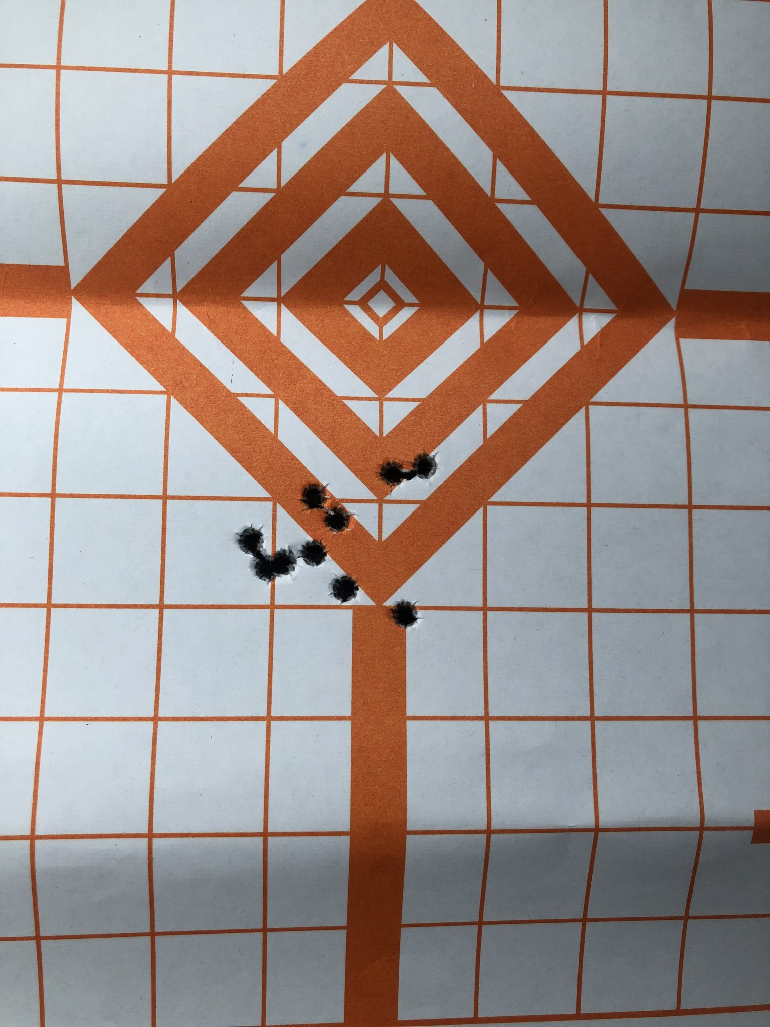

Below is 10 rounds of factory 143gr ELD-X, the shots are pretty much in order right to left for the first 6 then 7&8 started back right while 9&10 hit 2&3.
That last group is why it went back to Browning.

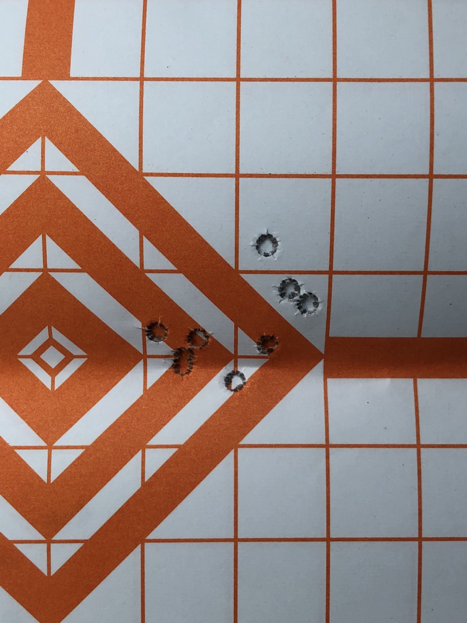

Then the groups I shot yesterday unsuppressed then suppressed
Those two groups were shot a max of 10 minutes apart with the same batch of handloads with the only difference being the suppressor.
As for the test ammo Browning used it was the 143gr ELD-X Precision Hunter ammo, the same thing I shot the 4+” group with. It can print small groups if they happen to line up but the variability is far more than I’m comfortable with for a long range rifle.

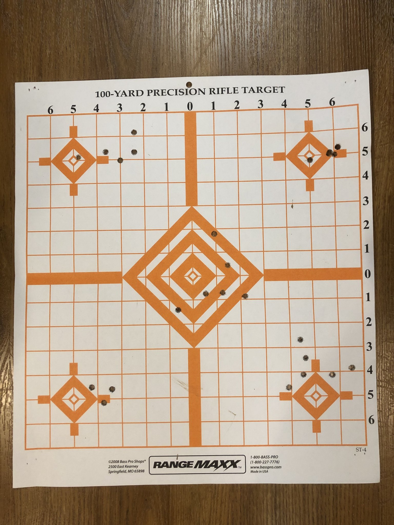

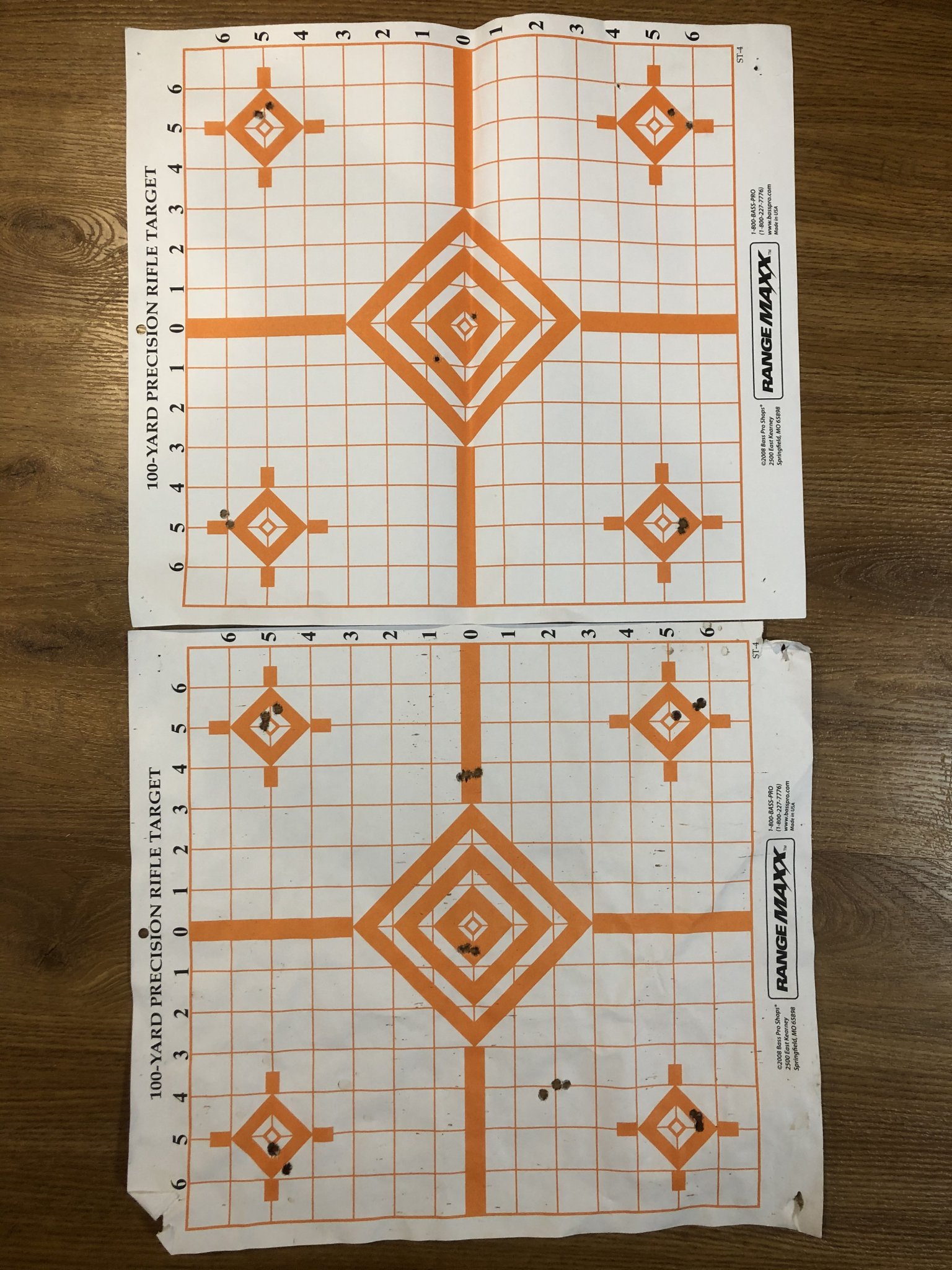

This is what I get when I shoot 5 shot and 10 shot groups. This has been on going since the first time I fired the rifle as I was doing load work ups and was expecting large groups moving around. The problem is that no matter what I shot through it it never got better. Some would group good one trip then fall apart the next for no apparent reason.
8A92CC49-5836-4760-8019-A9BC869A7631.jpeg2566F7BC-881D-4A94-B9CD-BE4157070C97.jpegA32E1226-03BC-40E7-9EFB-9F3BFA4BA019.jpegDF2D5F5E-7F05-4D9B-950A-7CD434729C64.jpeg9EEB3D4C-6952-40E6-88E2-9FEA96BB93F9.jpeg68BDCF35-63FB-46FE-BD0E-89378E46B2D8.jpeg
As you can see it is consistently inconsistent, sometimes they are all over and sometimes they happen to fall into a tight group. The first two pictures are the same loads shot at different targets with no scope adjustment, as you can see one group is to the left while the other is right above. Also I will note that the stringing is not sequential and it follows no real pattern, the 10 shot group went to the left for shots 1-6 but then doubled back on itself for 7-10.
Additionally just to check when I built my new rifle with a proof prefit CF barrel I fired some of the left over reloads that I had made for the Browning, this was my result with several different charge weights. The two in the top middle were my first two shots at 100 after zeroing at 50, all the rest are 3 shot groups with mostly different charge weights and a couple dulicates.
As you can see the same reloads in a different rifle are night and day different so clearly it isn’t an issue with my handloading either or the scope that I took directly off the rail of the Browning and put on my M7.

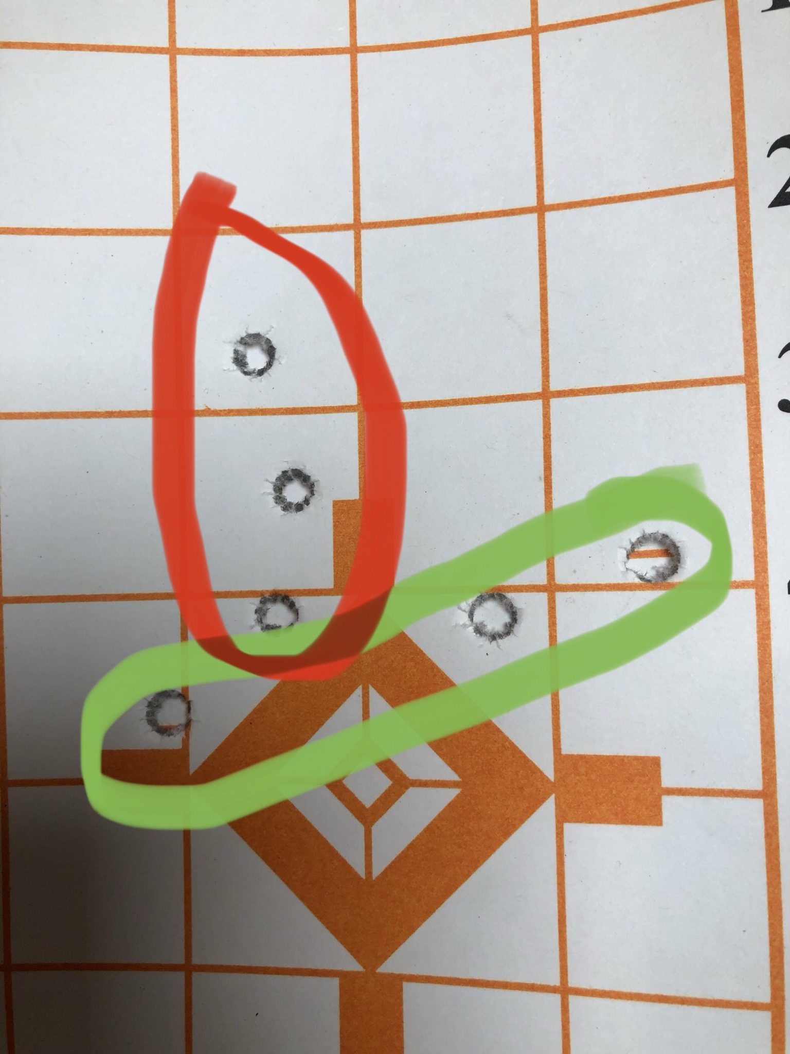

As you said I thought the concussion reduction with the suppressor could be the contributing factor but I shot my rifle without it and it groups the same as it does suppressed. Unfortunately I ran out of ammo before I could test the suppressor again but was able to test with the protector on, the suppressor on and the ff waiting 5 to 10 minutes between groups.

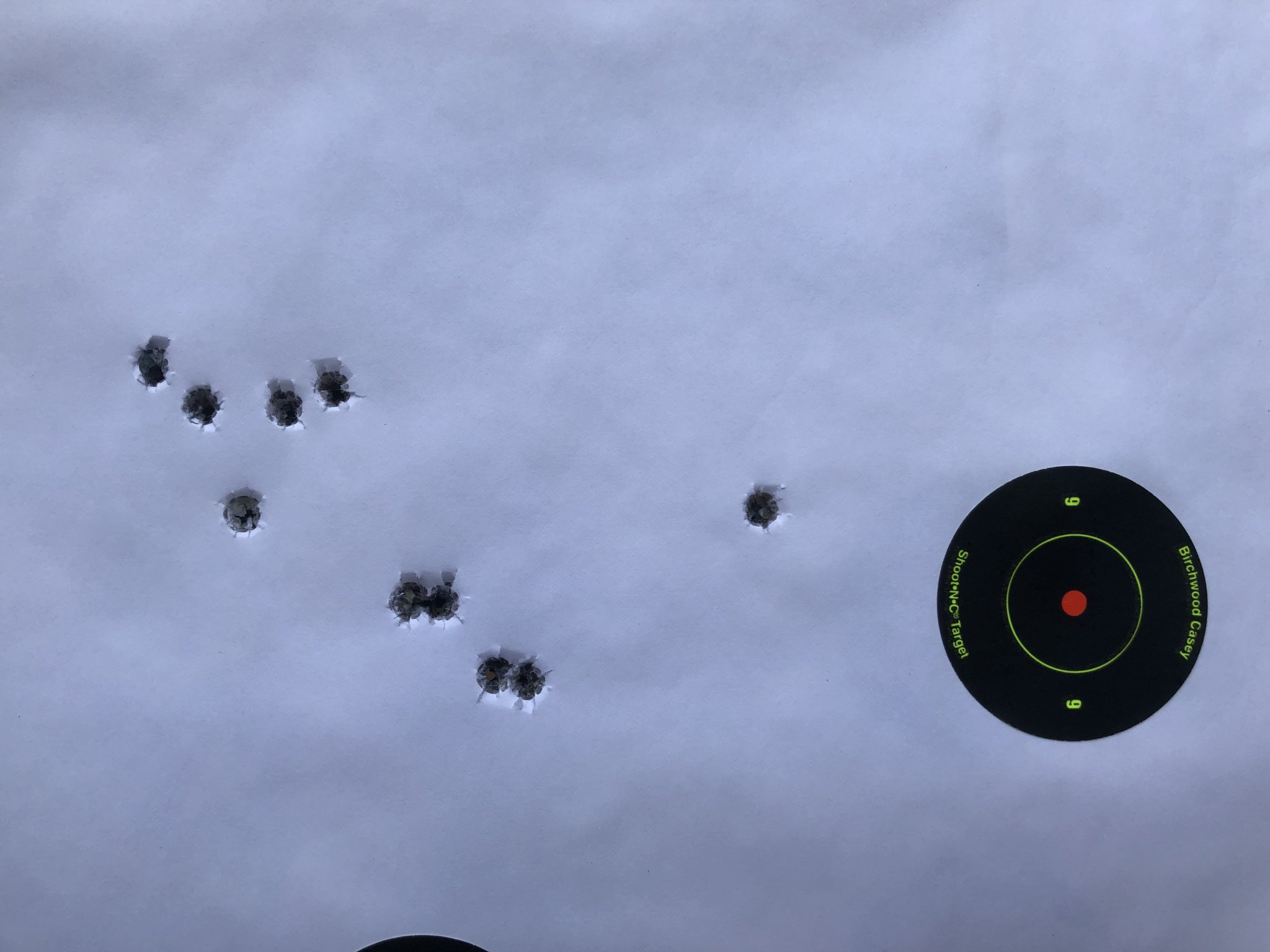

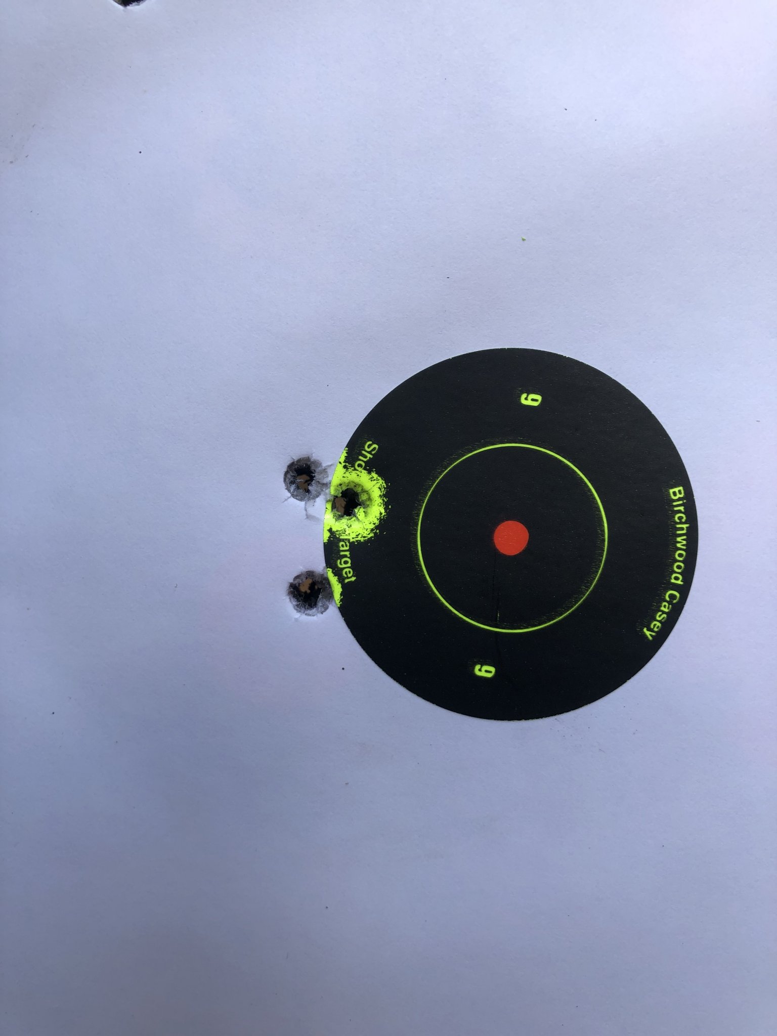

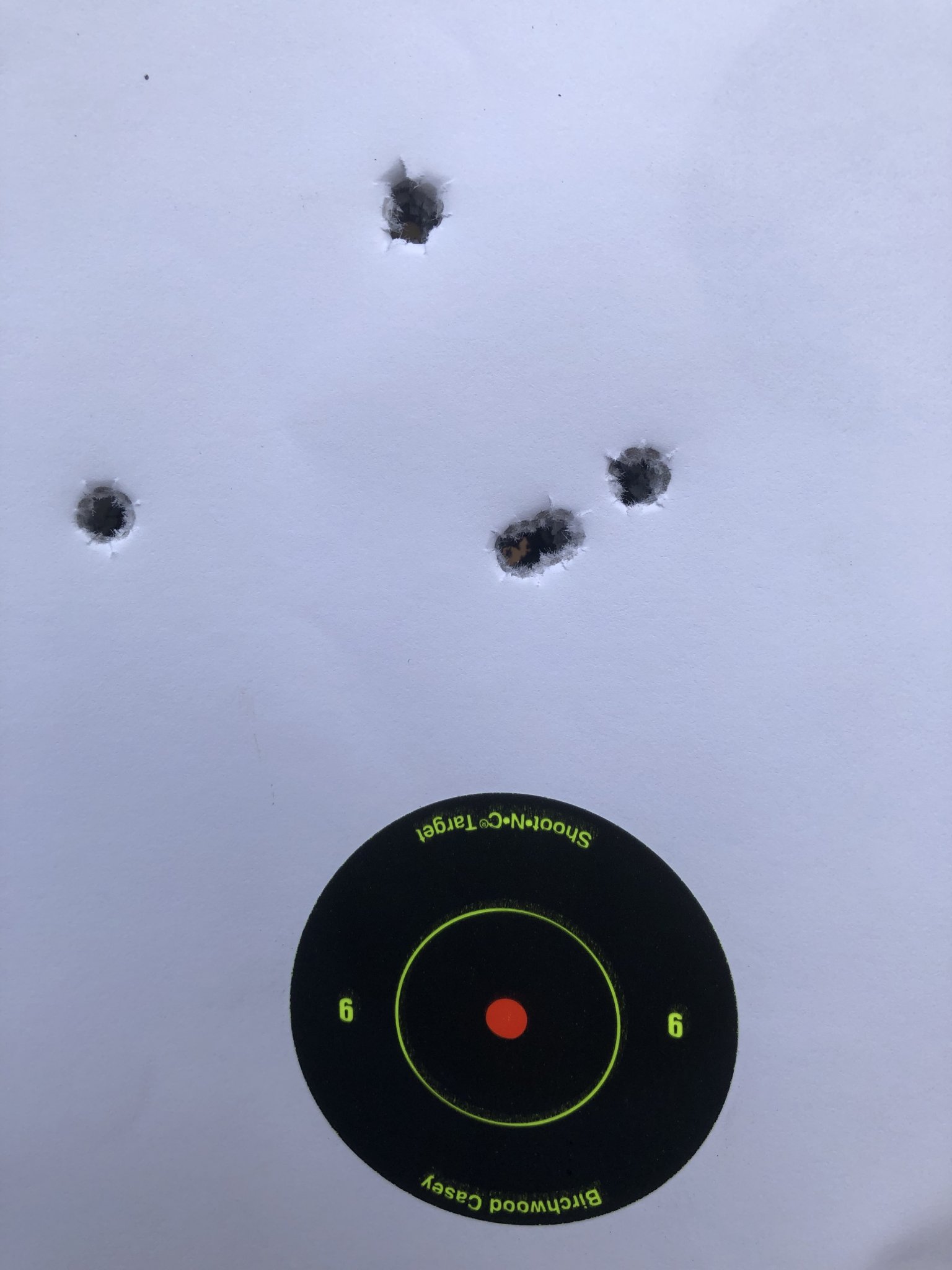

The normal one went horizontal
The suppressor shot a tight group
Then the bare muzzle without protector shot the same ammo stringing vertically and a similar bullet with the same charge horizontally.
At this point I’m not really sure what to do with it, it’s my Dad’s rifle but I’m the one who convinced him to go with the LR model in 6.5 PRC because of how accurate it was supposed to be. Now I feel bad because he spent $1800 on a gun that shoots way worse than his $300 7600 and deer season is in less than a month. If it was mine I’d just leave it suppressed but he doesn’t want to deal with the extra length or weight of the suppressor when he spends a lot of his time walking through thick brush.

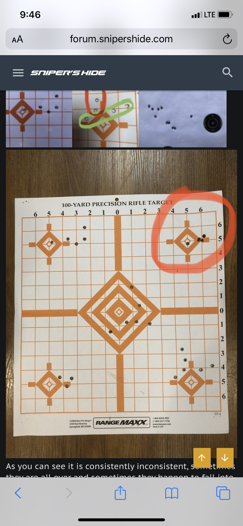

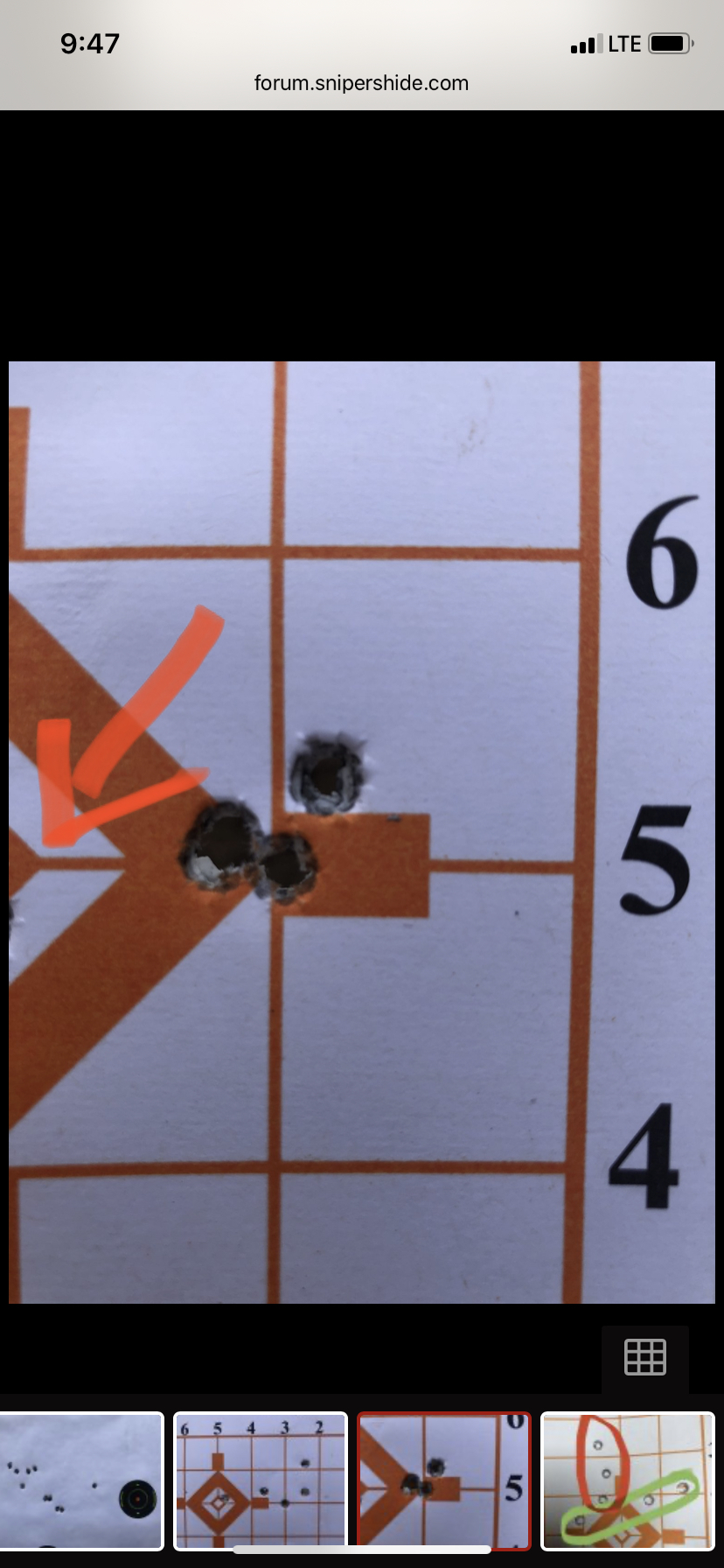

Isn’t this bad target showing the suppressed group you zoomed in on? (Top right target)
The suppressed group looks exactly like the top right group on the bad target. You can see the very edge of the hole that is out of frame after the zoom.
Either way what you are describing would suggests some kind of harmonic issue. I’m guessing you have a thread protector on when the can isn’t on. Did you try without that? Have you checked/retorqued action screws?

You are correct that was the target I shot yesterday after getting the rifle back from Browning. The groups on that target were thread protector on in the top left, suppressed in the top right and thread protector off in the bottom right. You can clearly see how much of a difference the suppressor makes.
The hole to the left of the suppressed group is actually my first shot on paper after remounting the scope, I was aiming at the center bullseye and then used bottom left to work on getting the rifle mostly dialed back in. As you can see my first group was pretty good at roughly 3/4 MOA. I them waited 10 minutes and shot my other rifle to let it cool before shooting the main group.
The main group in the center was 6 rounds of a load that shoots 1/2 MOA in my PRC but clearly does not work in this rifle. Each group was shot over a period of a minute or two then the rifle was set aside to cool while I shot the other one with roughly 10 minutes between groups.
