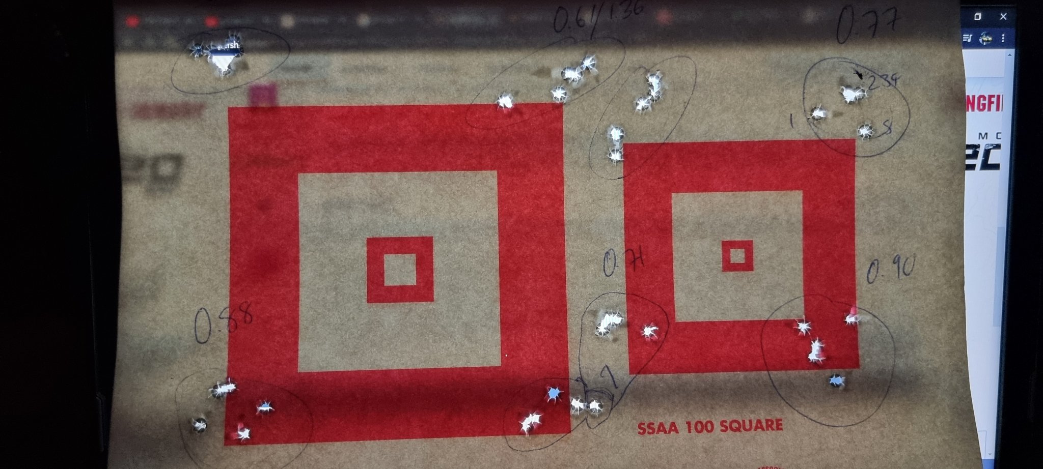

What kind of velocities and accuracy are you getting with your current load?
Good to know, is it marked on the barrel? Always a struggle to figure that out with other brands besides Tikka. At least its not easy to find immediate confirmation of the twist rate.
