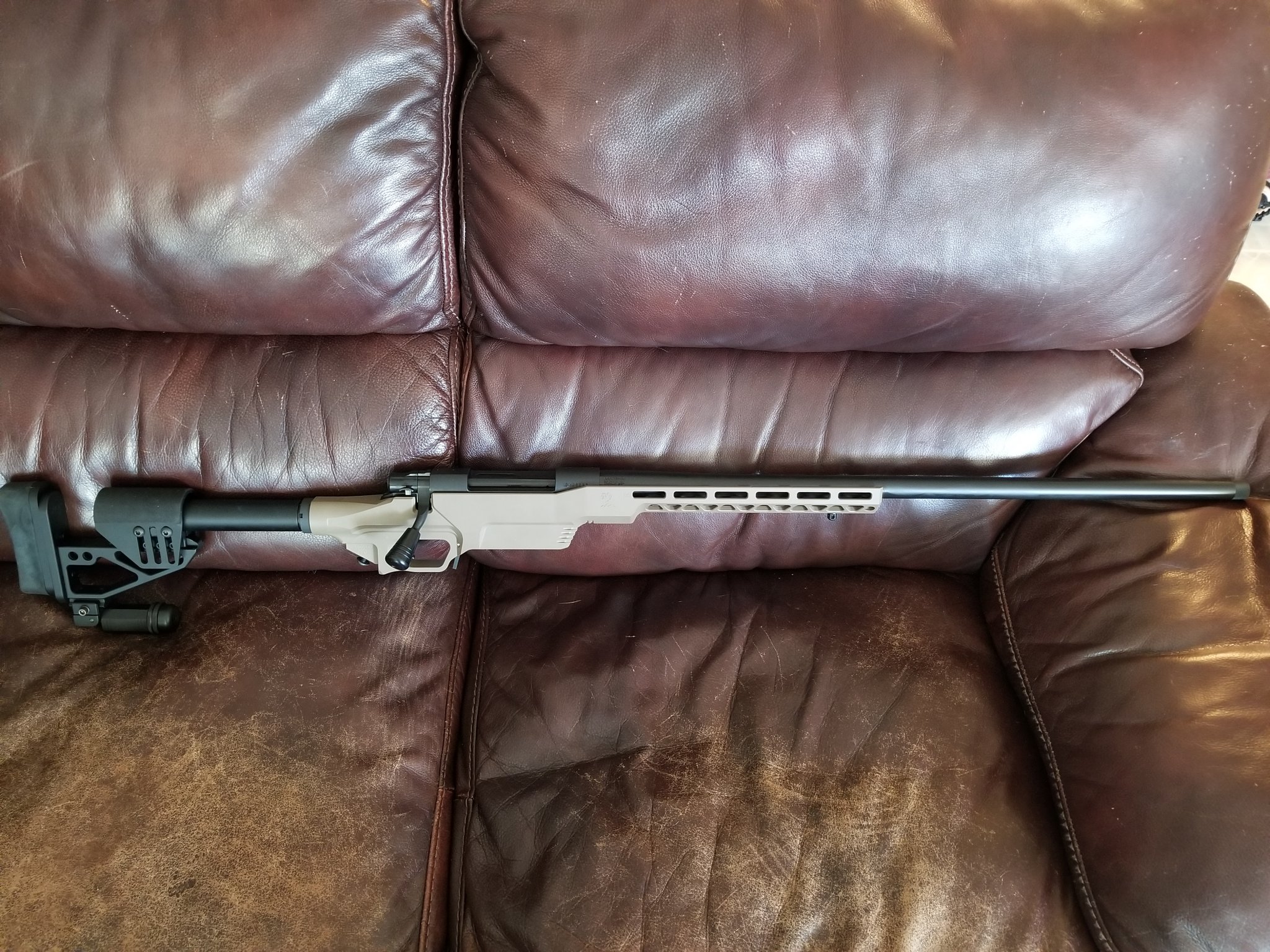

The MDT ESS chassis for the Howa long and short actions arrived today.
Exceeded expectations in all respects. More expensive than other options but I'm happy.
Buttstock looked a bit fragile on the website but in reality, it's rock solid.
Picking up the barreled actions later his week.
Final assembly and it's time to go shoot.
