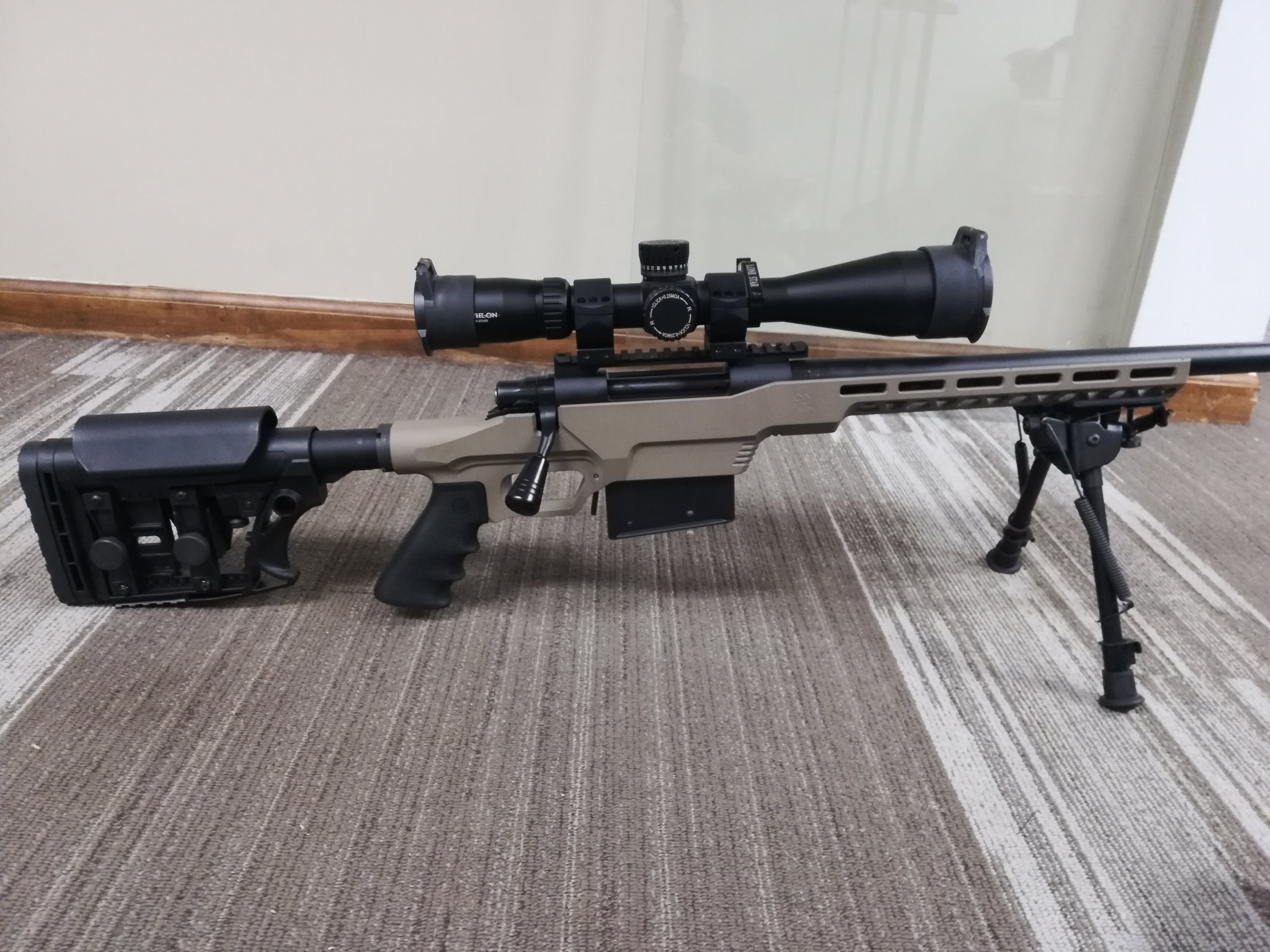

Howa 1500 Barreled Action Build
Ok lets do a build run down! I didnt know i was going to light a fire!
I have a few builds on stock barrels but these are my two favorites.
Tan MDT:
-Howa .223 action
-ESS Chassis, carbon forend, side folder
-Shillen Barrel chambered in .223 Ackley improved built by 782 Custom Gunworks
-Leupold Mark 5 5-25 with Tremor 3
-Ken Ferrrel bases, Leupold rings
-Silencer Co OMega 300

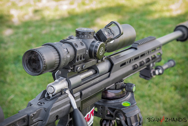

Black KRG
-Howa .308 short action
-Bravo center, whiskey 3 gen5 back, enclosed forend, arca rail
-Proof stianless m24 barrel in 6mm creedmoor
-SPUHR mount
-Leupold Mark6 with tremor3
-Ken Ferrel base
-Leupold Delta Point red dot (for target acquisition)

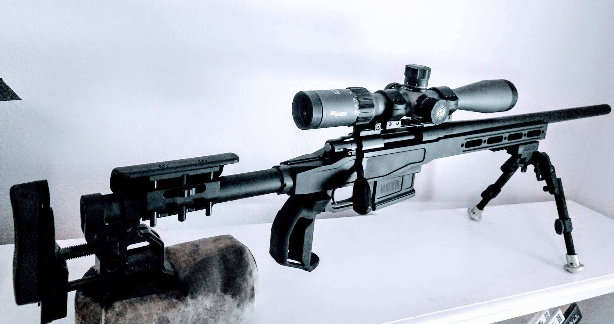

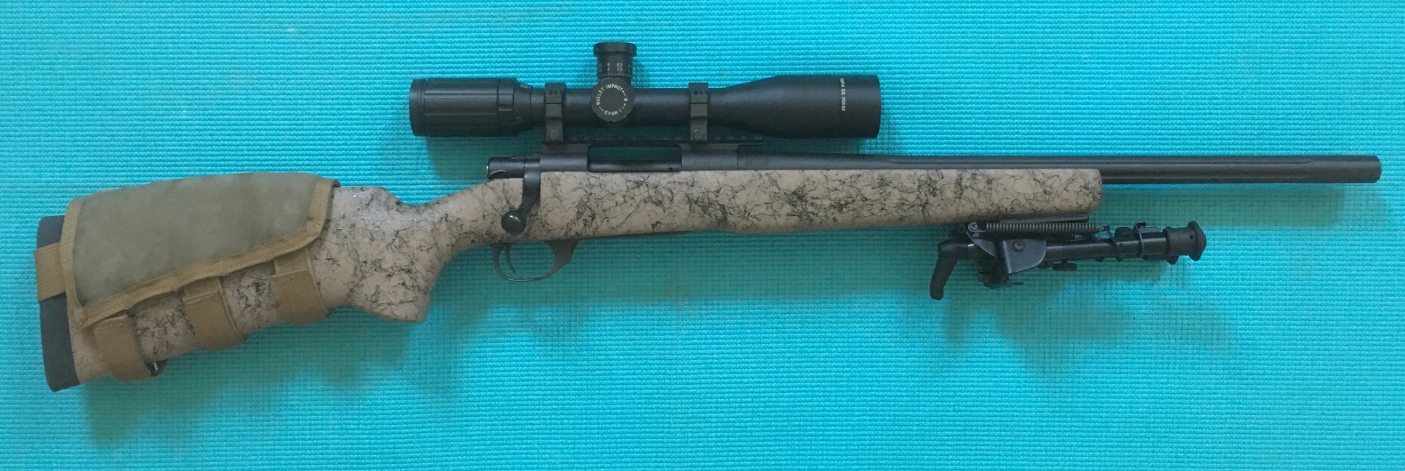

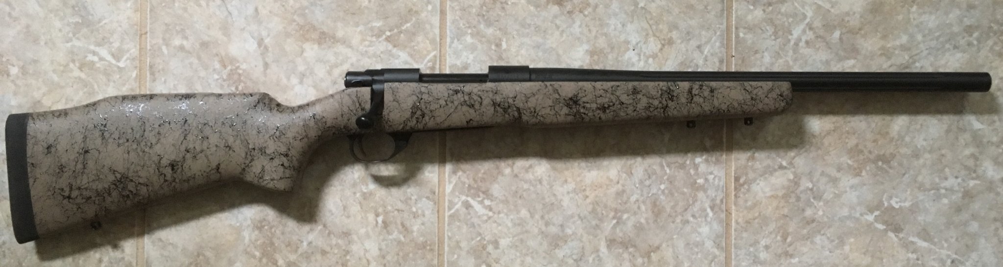

Not the greatest photos but here is mine:
6.5CM
24" heavy barrel
Smokings Guns fiberglass stock
Bushnell LRHS 4.5-18x44
Warne 20MOS rail
Seekins Precision rings

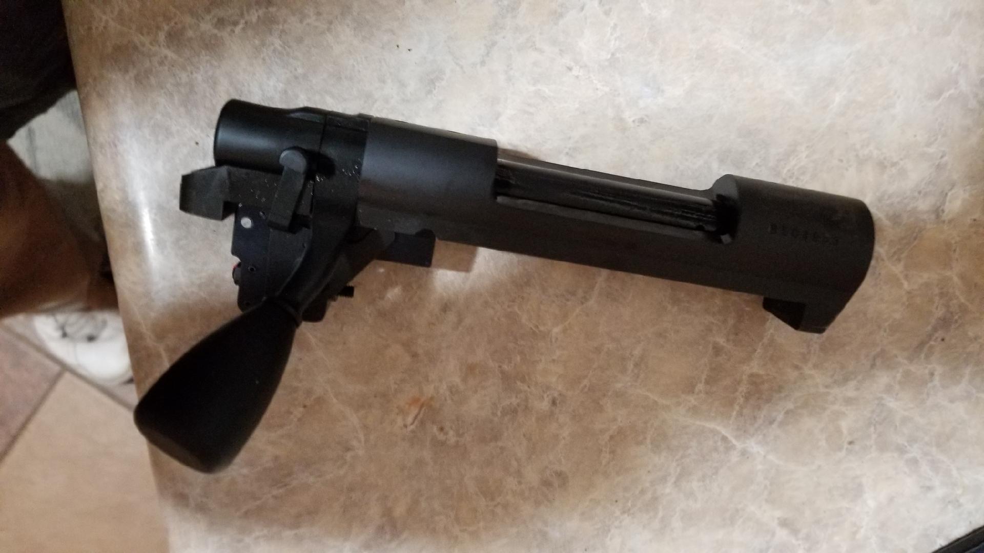

Well I ordered a 308 barreled action from brownells tore it apart and built a 22 Creedmoor on one. Never threaded metric so as I always do it I build something for myself so I learn how. I am pretty impressed with the quality of the action
Bought the Bell and Carlson adjustable stock cause I like a more traditional stock

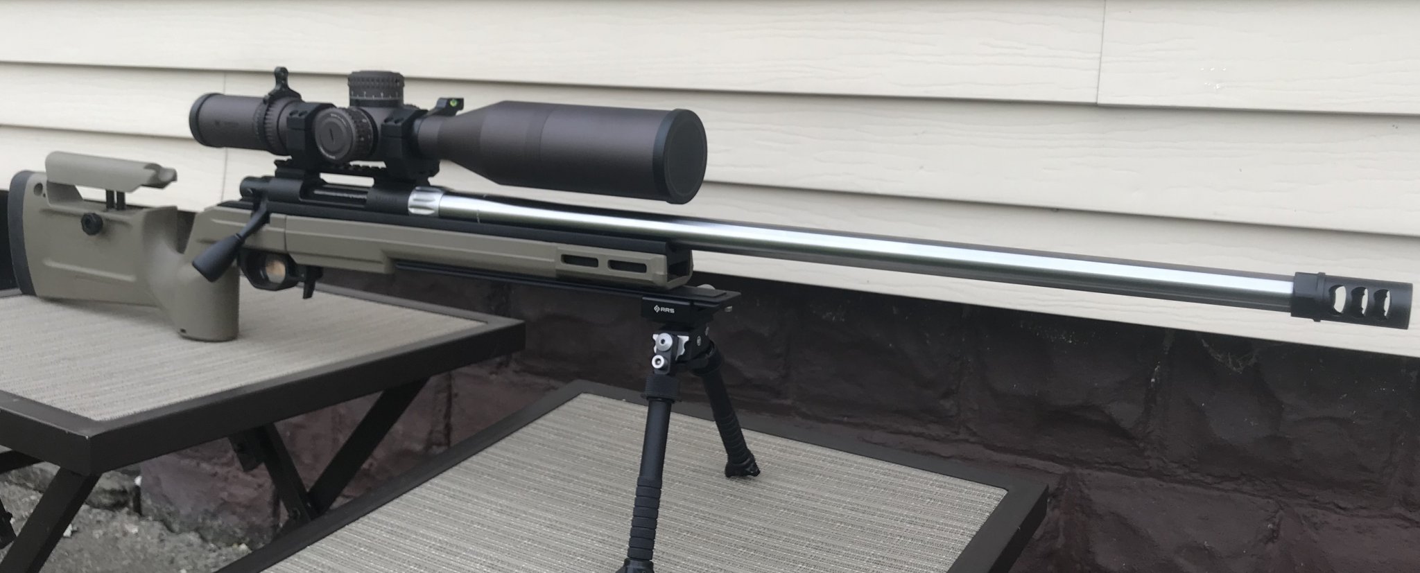

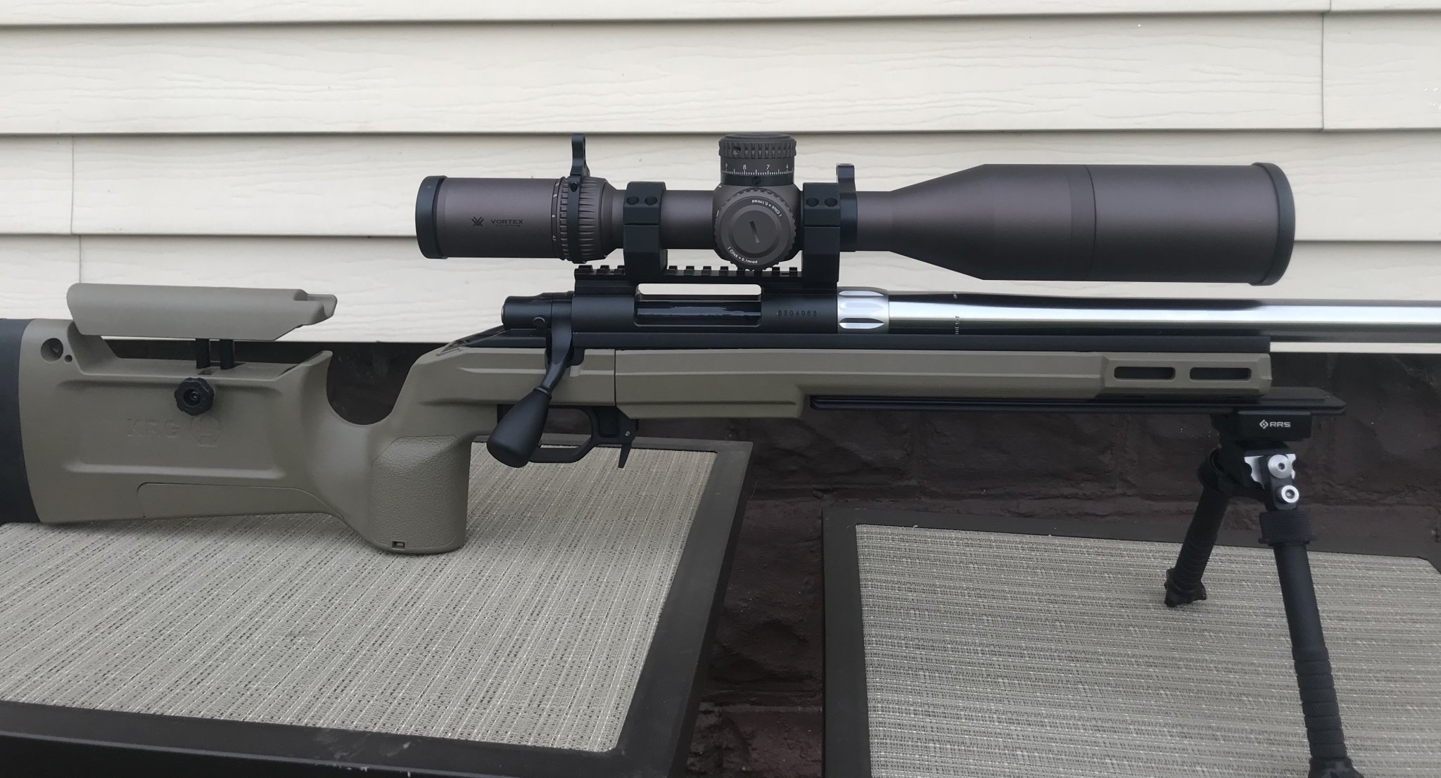

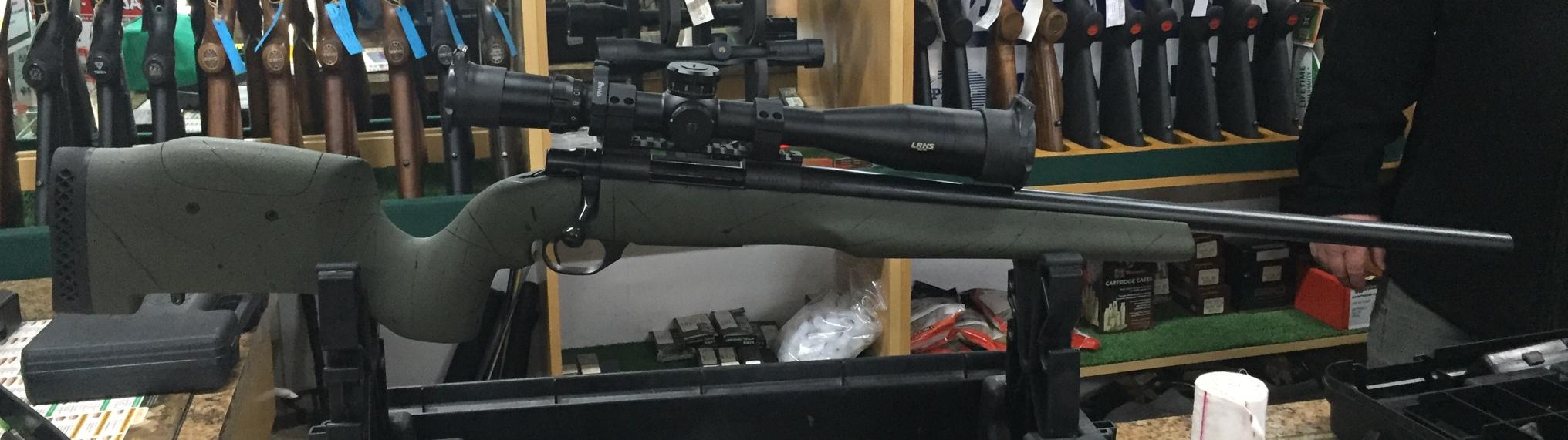

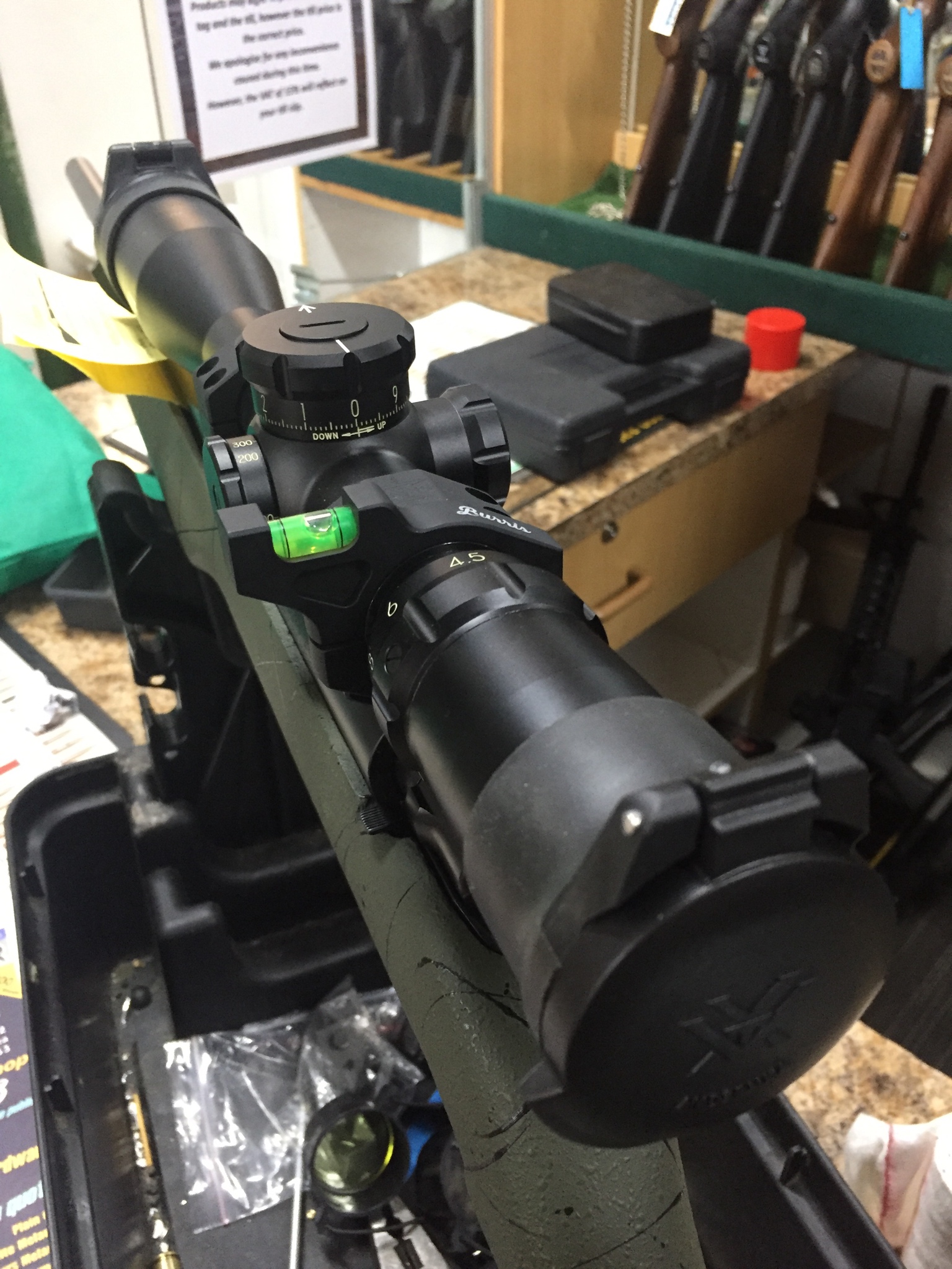

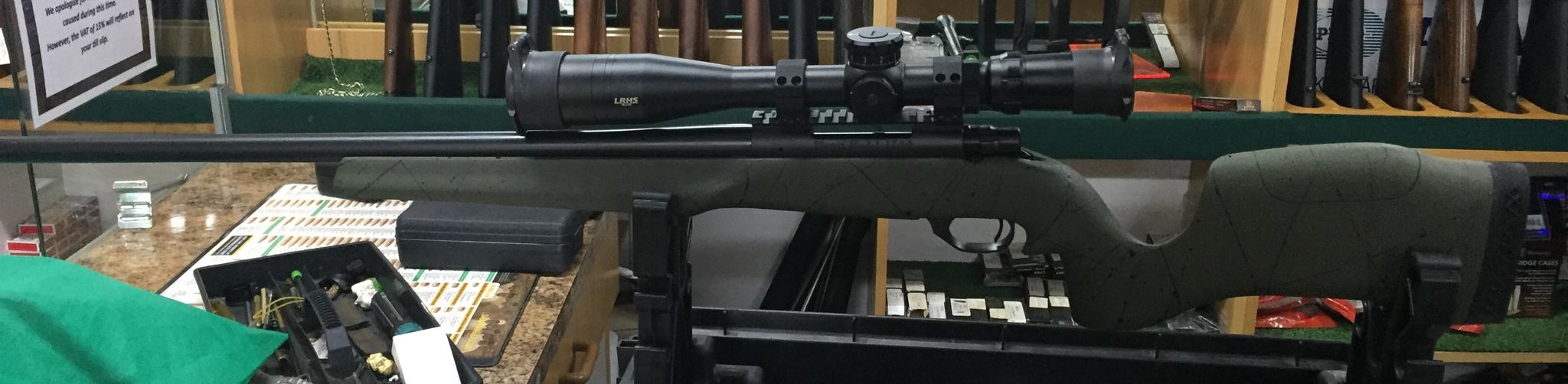

I got my 20" .308 deal from Brownells and finally finished the build. I got a great deal on the XLR Element gen 1. I added a MDT carbine stock, which is great. Added a Legacy Sports clamp on bolt knob, Burris steel 25moa base, lighter spring for the HACT trigger and the Anarchy Outdoors grip. If my local range finally finishes some repairs and opens back up I can see what it'll do.
It’ll shoot. I’ve been doing some loading and breaking in the barrel and I’ve been getting .5 to .3 inch groups and cleaning is a breeze. The box magazine will feed rounds as long as 2.8750 which gets a 168 SMK within .015 of the lands. Got 50 rounds through it so far and it is slick as a gut.
I’d like to add that the scope is 1 click off of dead nuts center of adjustment for the windage with a Talley 20MOA rail with Warne rings. Maybe I just got lucky?
Great start to your build. I wanted to do something similar. I assume that is the new Bell&Carlson M40 stock?
I dont know if it's a new model but it is the B&C M40 stock. I was trying go budget with this and I am definitely pleased with the stock. I just got it all together on Friday and wont be able to shoot until Tuesday but I think it's going to be a good setup.

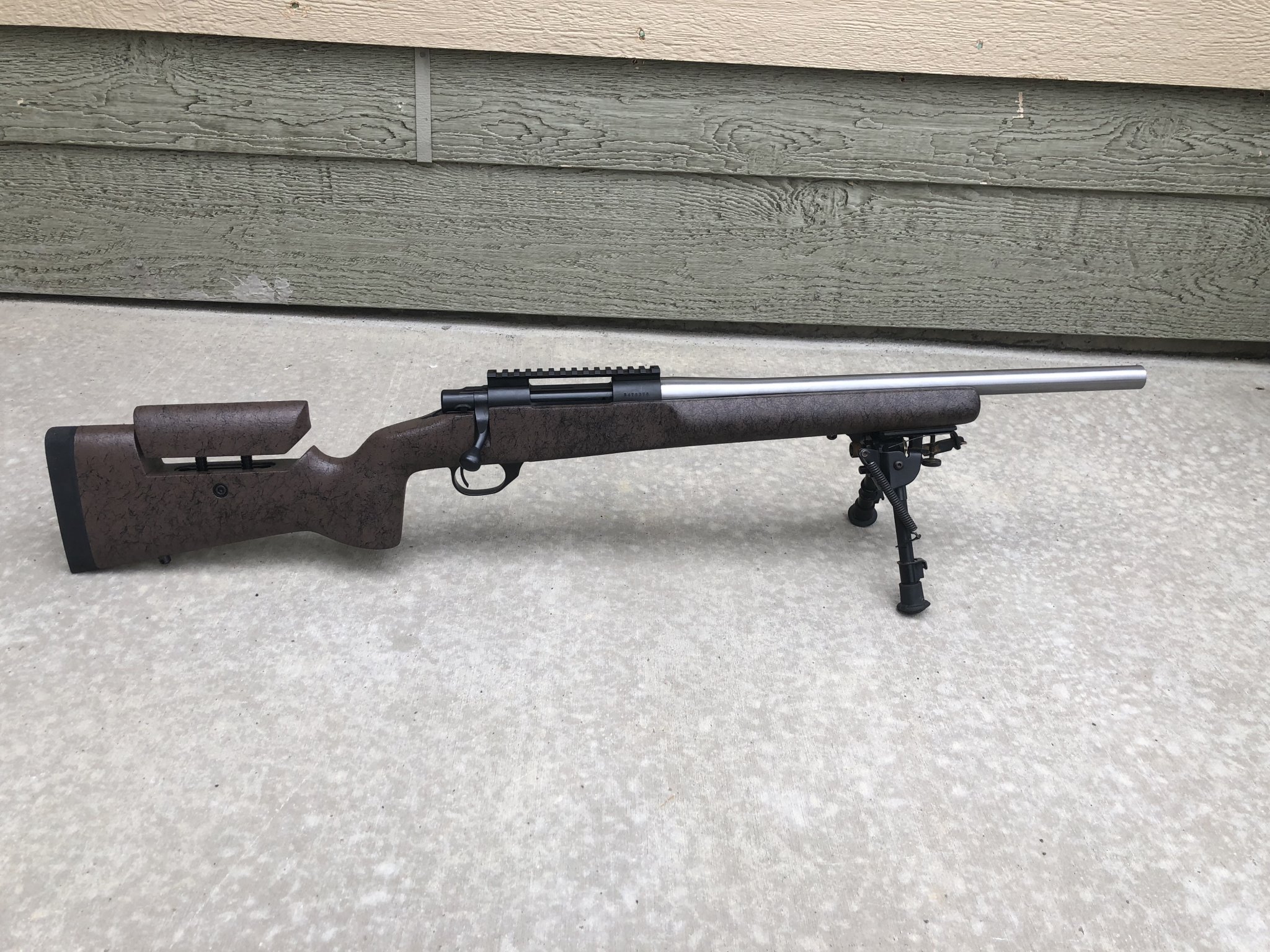

I put this one together for a buddy. I was really happy with the inlet and overall quality of the bell and Carlson. The CDI bottom metal was great too though we did have to mill a little tab off of the action in the magazine well to get the AI mags to feed. No big deal.
That's a gorgeous gun? What's the barrel length? Looks short and fat just how I like em lol

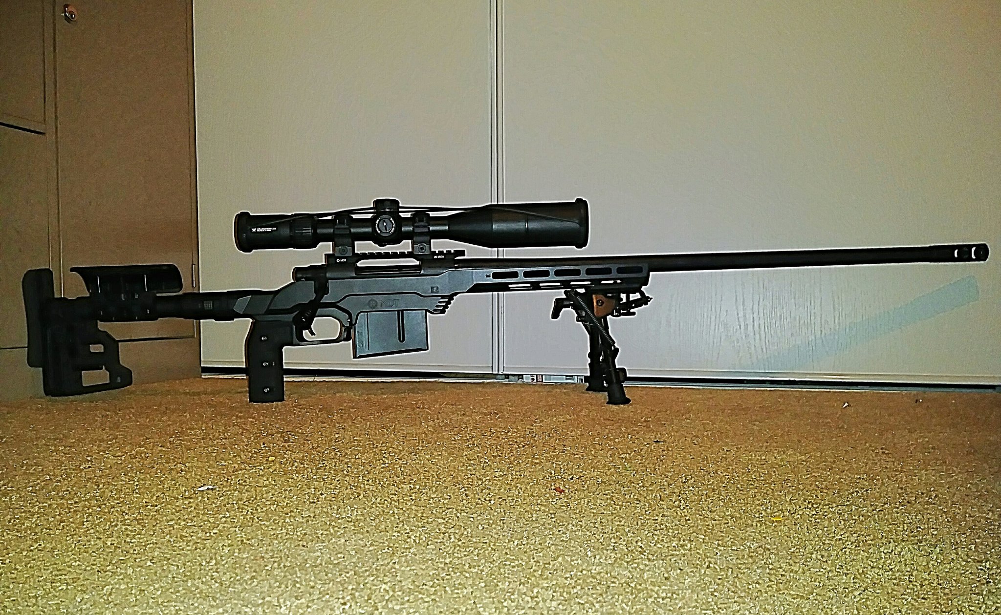

Finally got a Bravo stock for my 24", 6.5CM barreled action i purchased when Brownells was having their sale.
I'm debating if i should trim a little off my rail, or take out a spacer on the stock and slide the scope a little forward. The scope currently touches at the forward edge of the rail.

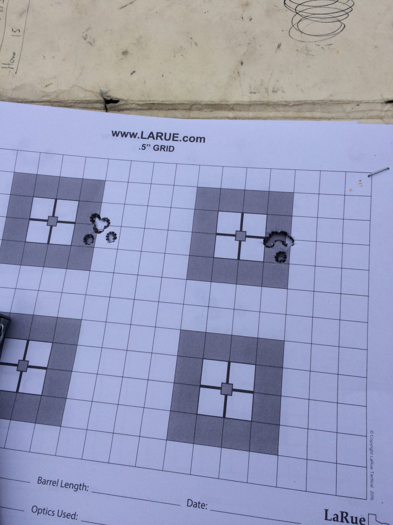

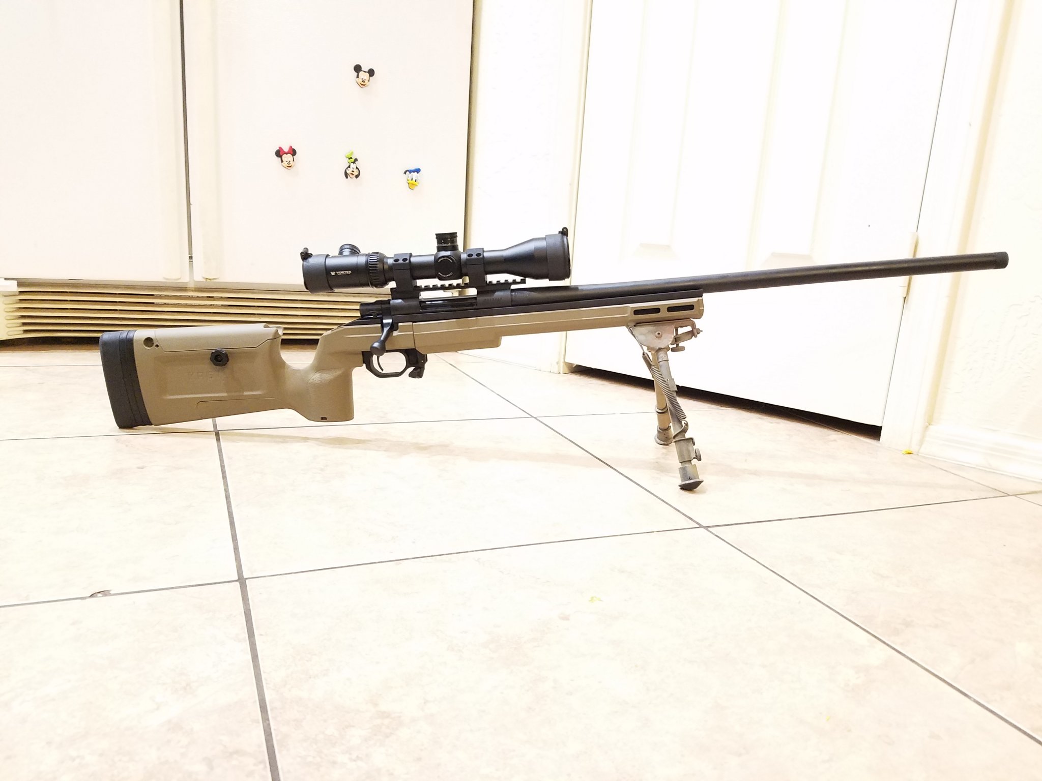

I got out last weekend and was able to shoot my howa/bravo setup. I got on paper at 50 yards, then went straight back to 200. It got really windy after that. I'd guess the gusts were 35-40mph from right to left. I tried 3 rounds of 120gr, and 5 rounds of 143gr (both Hornady eld factory loads) in the wind without very favorable results.
Then i shot 3 rounds of the 143 eld between gusts at the lower right corner. I was pleased with those results. I think I'm going to need more magnification if I'm going to do better than that, since my cross hairs at 10x covered the orange dot.
I'm very happy with this rifle.
