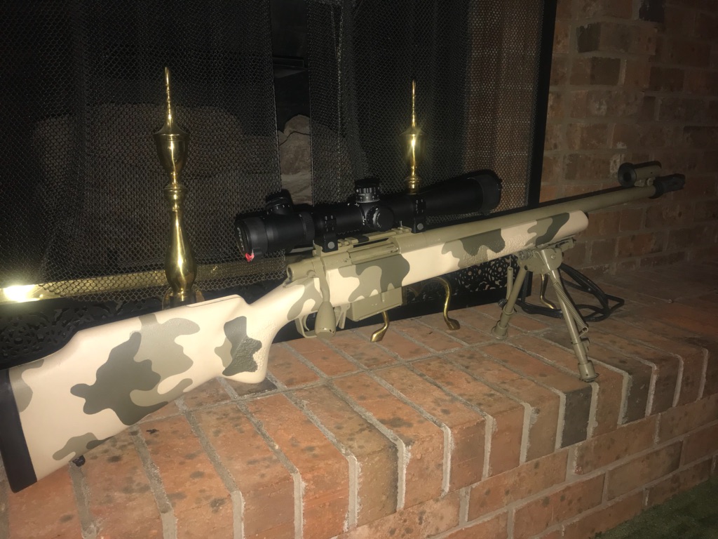

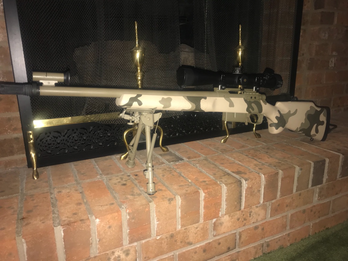

Here’s my Howa 1500 .308 20” factory bull barrel
Bell and Carlson stock (bedded myself)
PTG bottom metal
Nightforce 20 moa base
Threaded bolt handle (threaded myself)
Timney trigger (can’t remember the model off hand)
Vortex rings
Vortex pst gen 2 5-25x50
Cerakoted myself as I hate blued rifles.

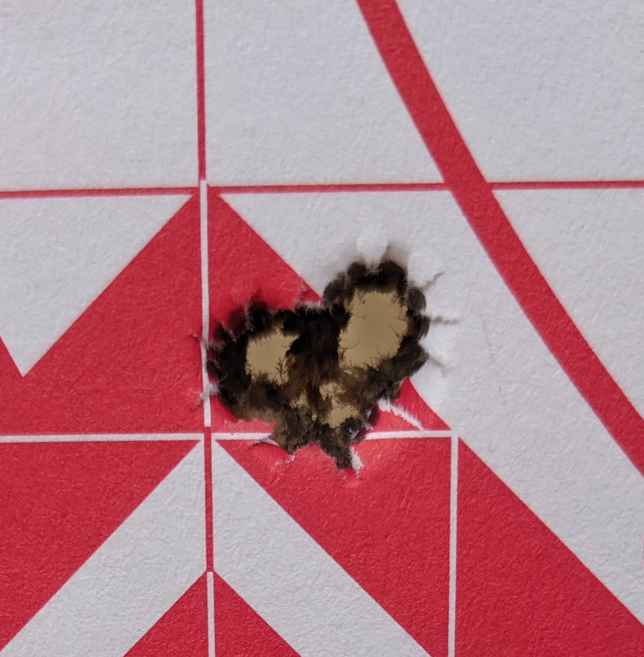

Here’s a 4 round group at 100 yards with factory Hornady black 168gr. Bought a few cases a couple years back on sale and this rifle seemed to love that stuff.
Have the same gun in .308, 20" as well. Might look into the factory Hndy Black.

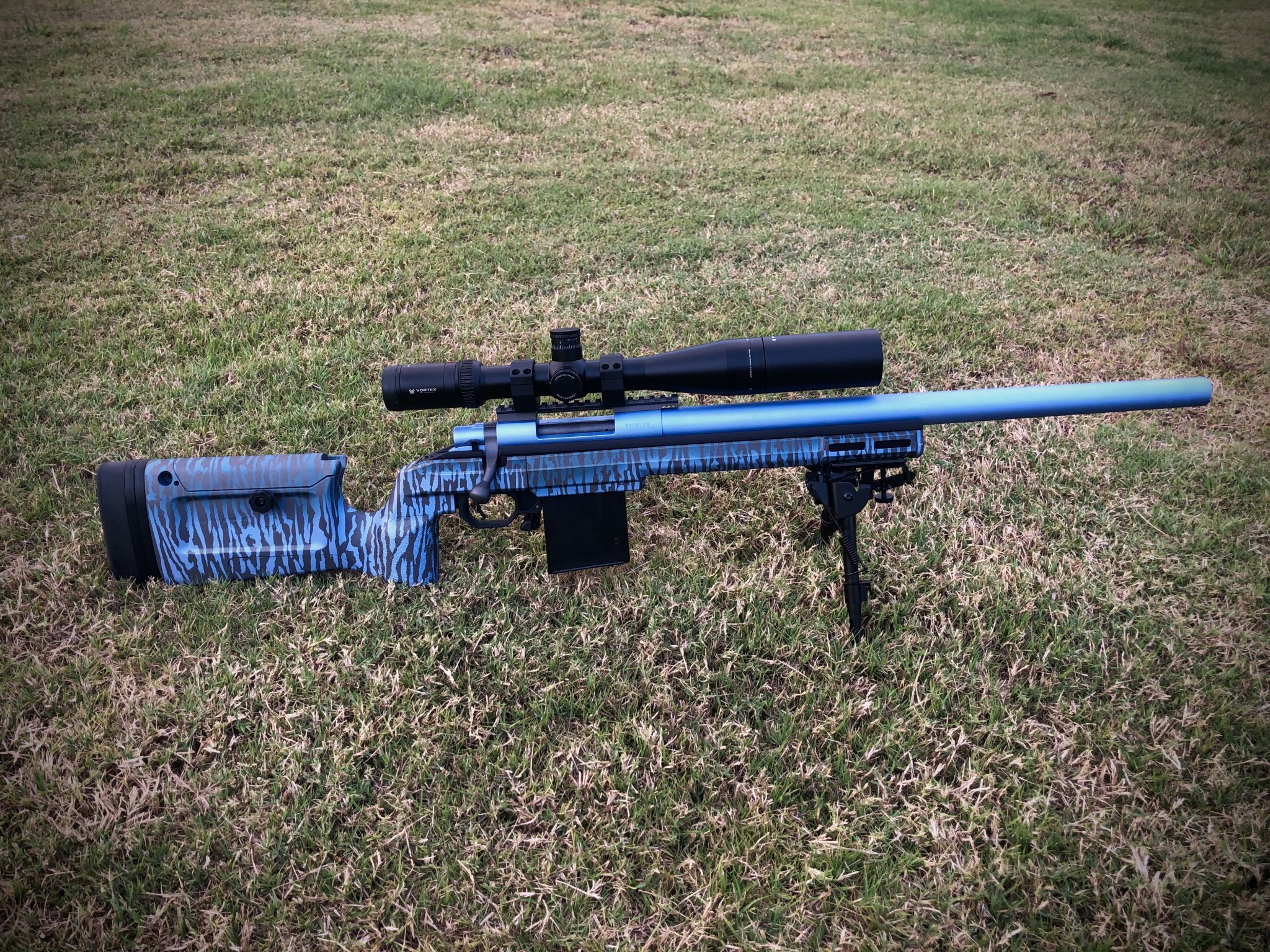

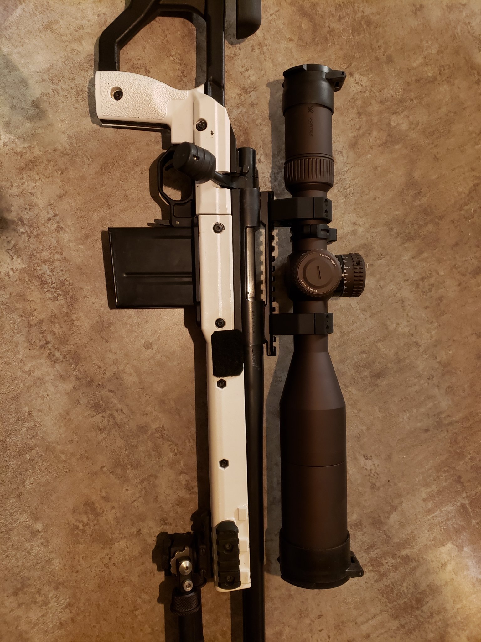

G'day all,

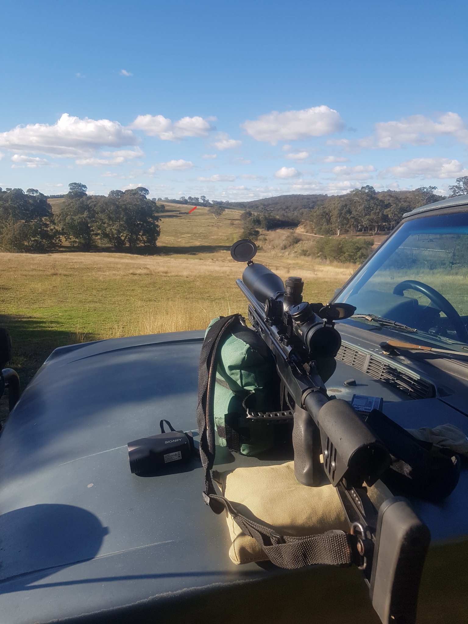

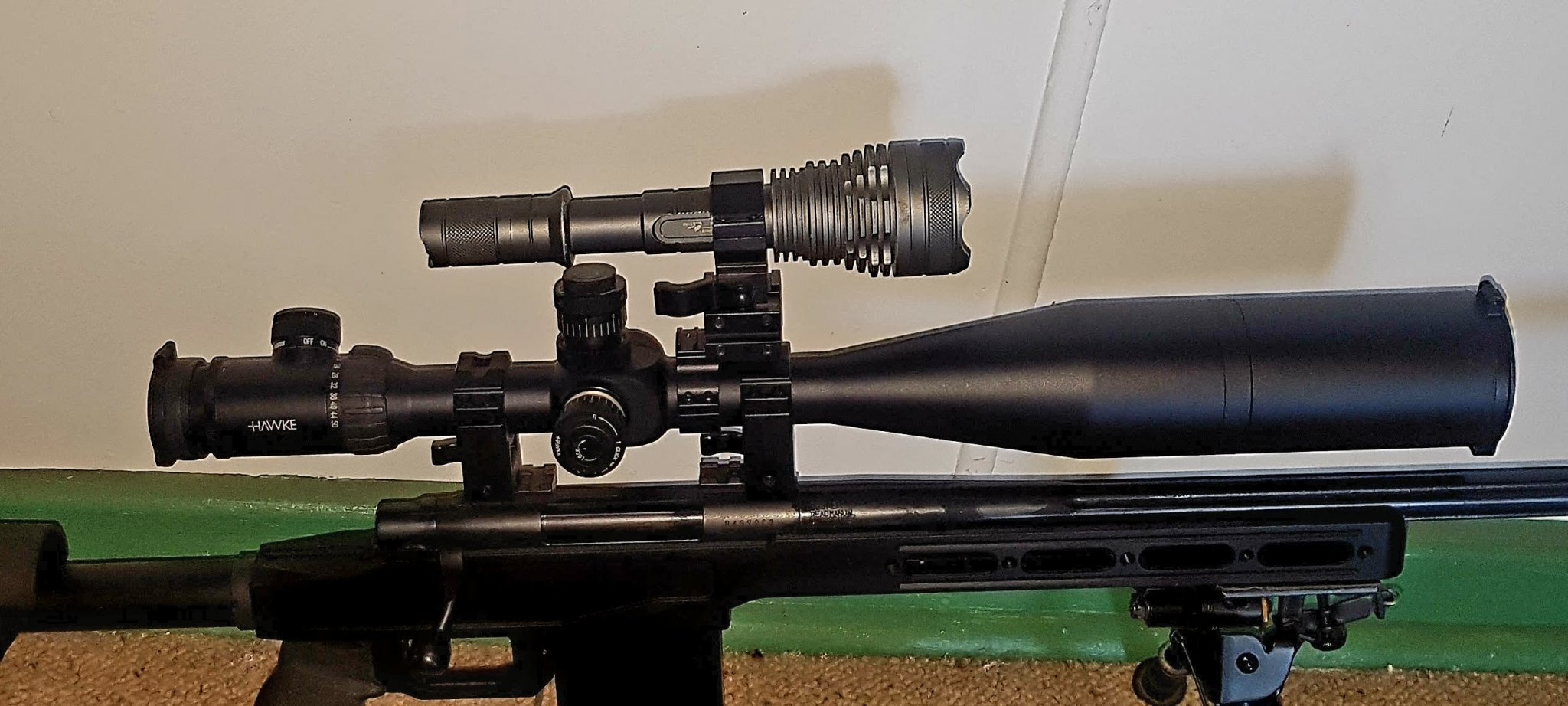

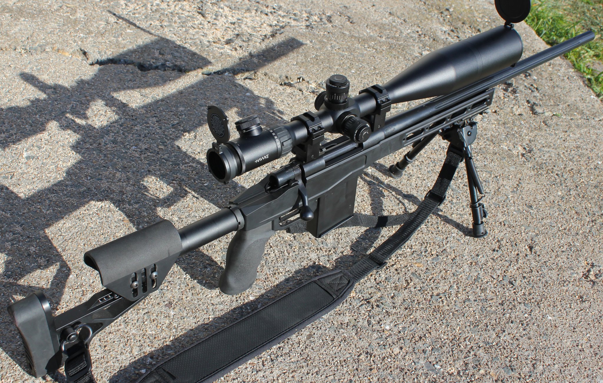

I always like a chance to show someone my current favourite, some nice rigs shown above, this is mine.
It's a Howa 1500 .223 9 twist 24" fluted varmint. I removed the very pretty piece of walnut that came standard and fitted an XLR Industries Element chassis, a Gunbloke 1.5lb 2 stage trigger, a Hawke 10-50x60 Sidewinder scope and for night time a Trustfire SST-50 with a quick release mount. With the torch mounted on that big scope this is not a walk around type rifle so I only ever use it when on or in a vehicle or lurking prone in an ambush position.View attachment 7136824View attachment 7136826View attachment 7136831View attachment 7136832

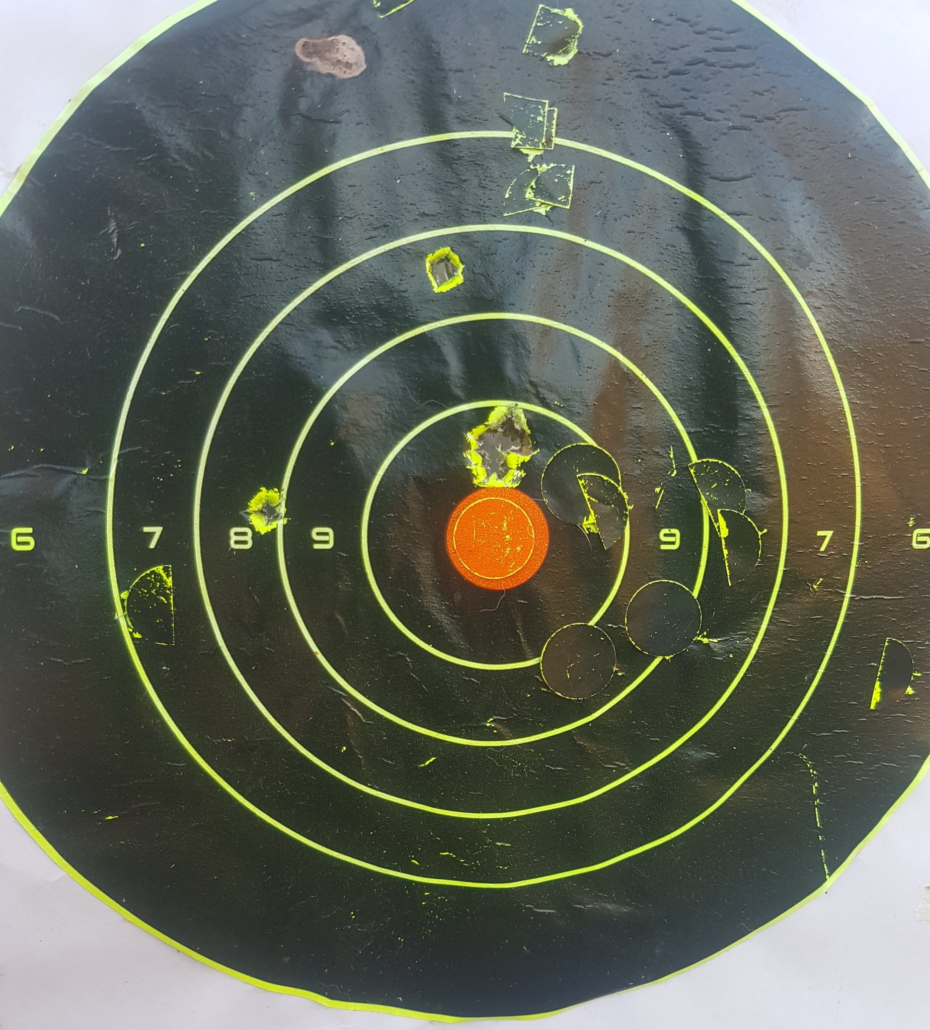

The benefit of letting your OCD take full control in the quest for the perfect hand load is visible above. After 18 months of experimentation I hit the sweet spot. Weight batching both projectiles and brass, and using Hornady 55gn Roo Max soft nose projectiles seated to the cannelure, ADI cases weighing 93.3gn and 25.6gn of ADI 2206H powder, the group above the bull is 5 rounds at 250m.
For a comparison I fired my last 2 Buffalo River factory rounds (the 2 flyers). Buffalo River is an Australian brand using Sierra 55gn soft nose and ADI brass, so serves as a good reference point.
Nice rifle and great group. Nice classic Rangey, too!

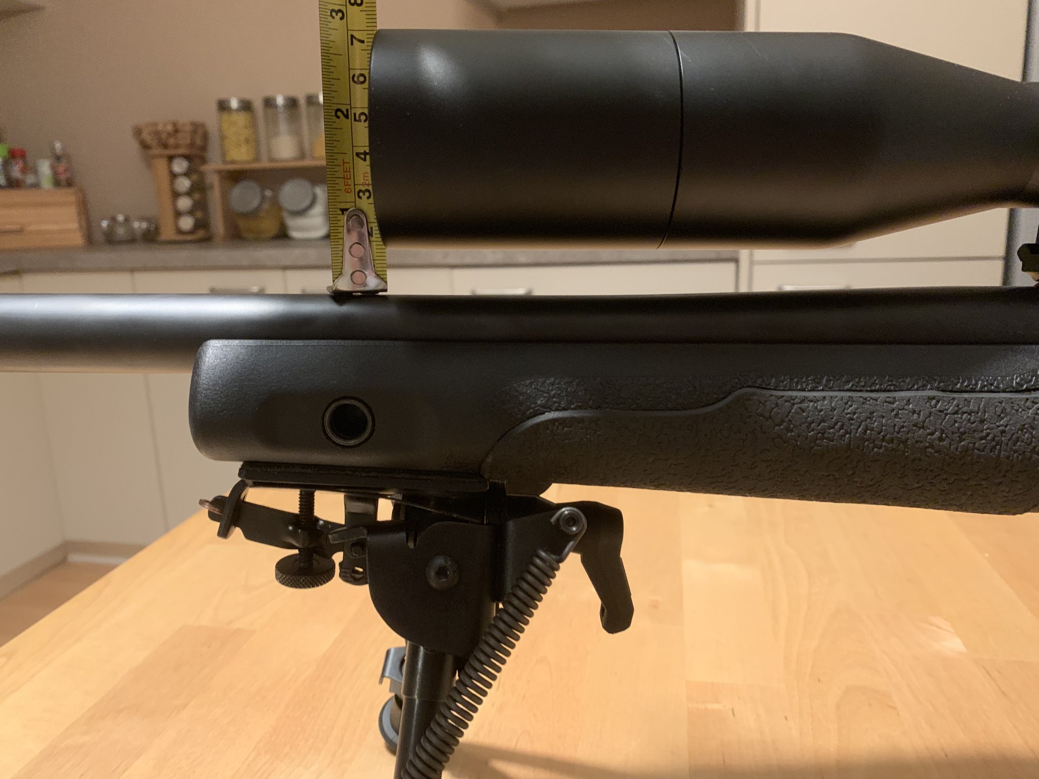

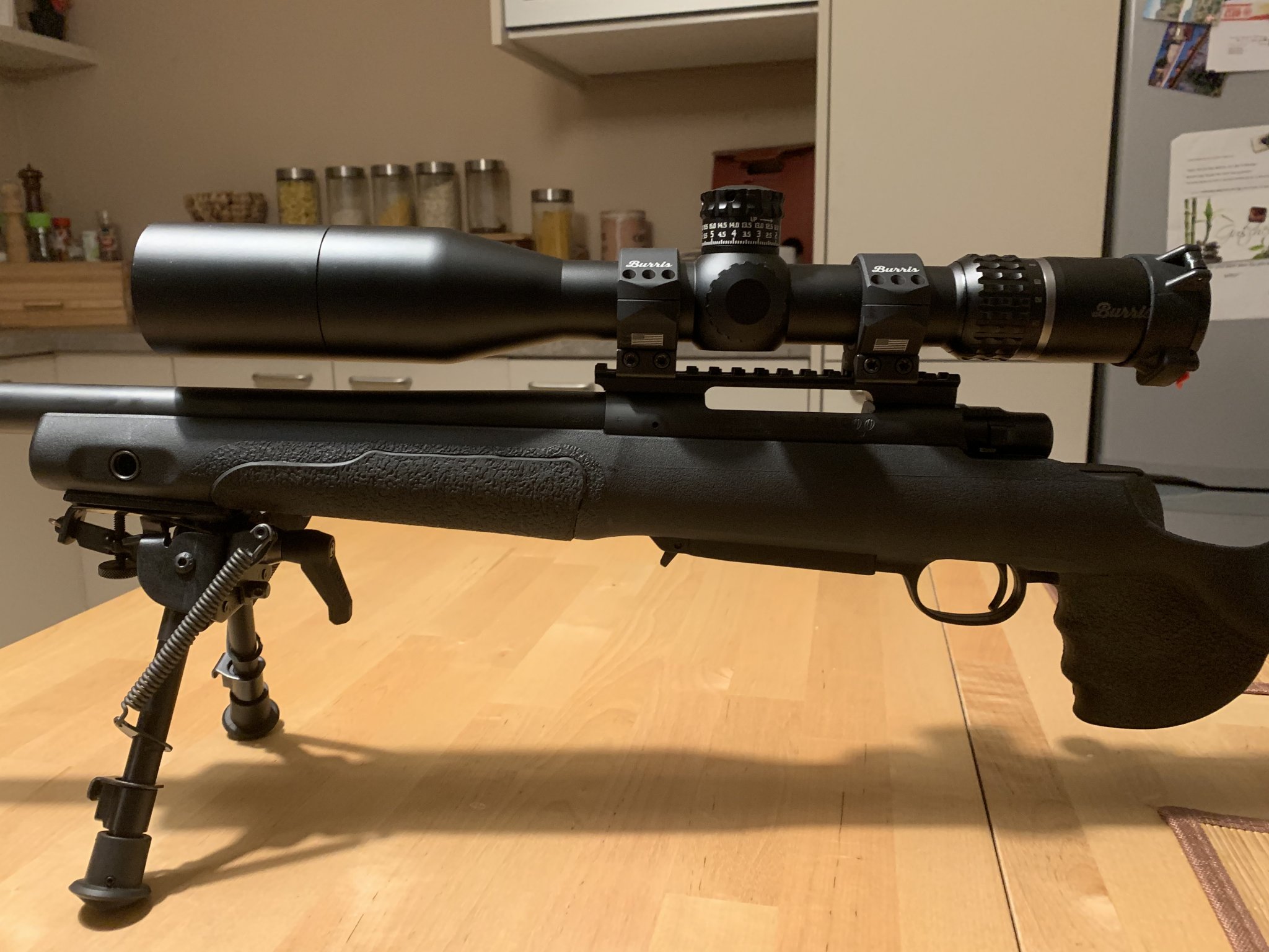

I am new to bolt action rifles and I recently purchased a Howa 1500 in .308 along with a Burris XTR II 5-25x50mm. Does anyone have any experience with the 34mm Burris XTR (1.5 in) rings? I am curious to see how high off the bore the scope will be.
Thank you in advance.
I have Howa in .308 with almost the same config: XTR II 3-15x50 but in 1.0" (low) XTR Signature rings on Recknagel (Era-Tac) base. Rings are great and I didn't have any problems with this combo, just torque to spec. Scope sits with enough space to barrel, 1.5" would be to high for me IMO. You can look up my photos in this thread. I can post better pic from a side later when I'm home.
Reactions: Dadude122
Thank you for your response pmalec85. I just ordered the Burris XTR Signature rings (34mm) in 1.0 inch. I will return the 1.5 inch rings when I receive them.

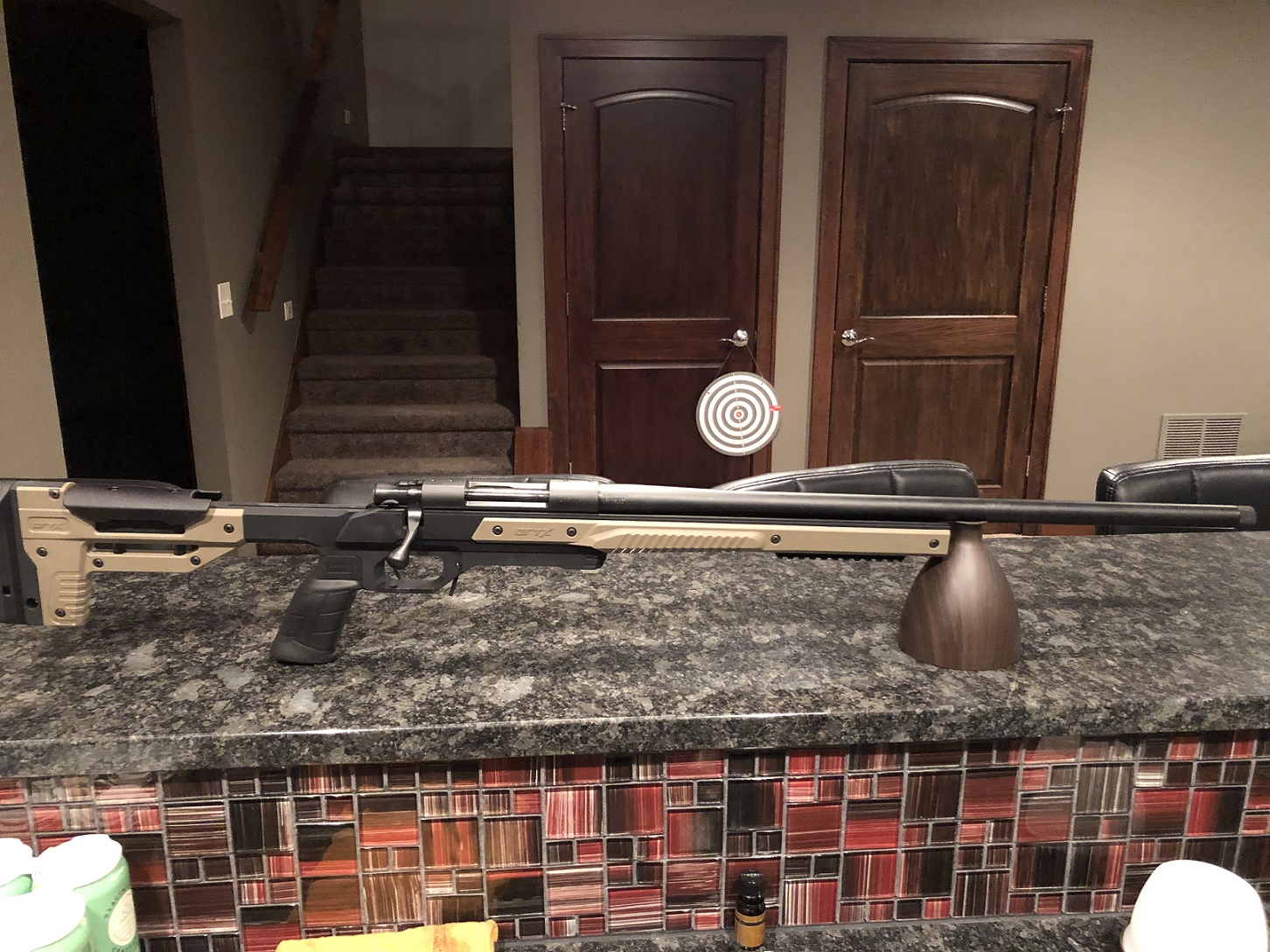

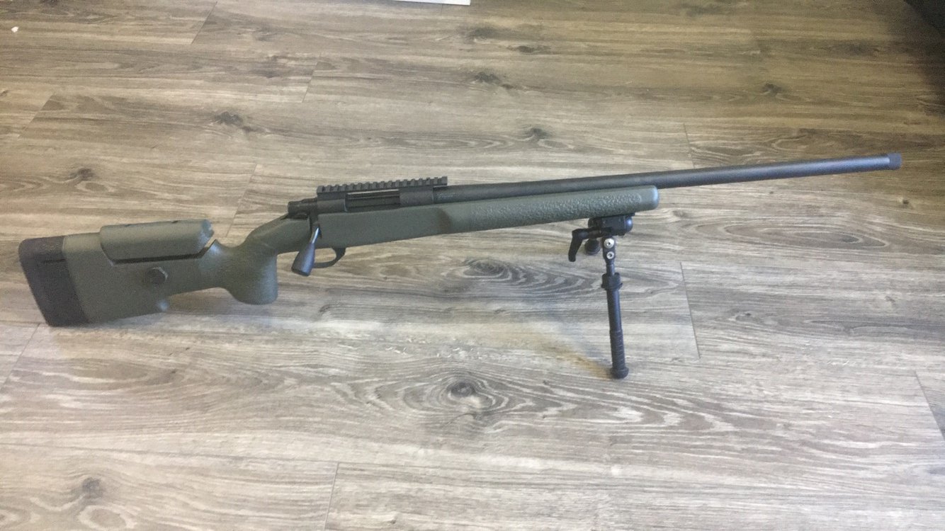

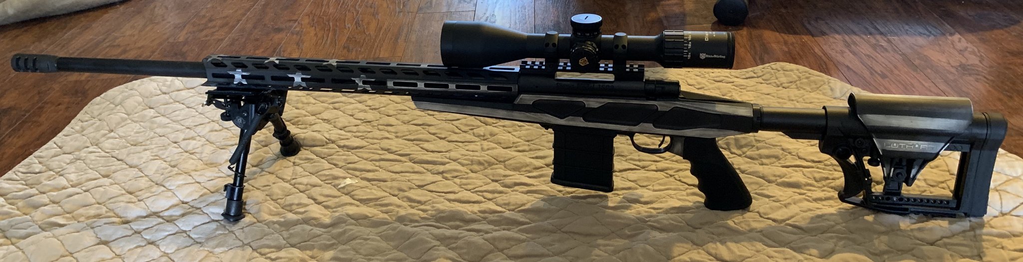

Is this for self builds only? Mine is a Howa M1500 heavy in 6.5 Creed. 26 in heavy barrel, Luth-AR 4 stock, and the bundled Nikko Diamond long range 16x50. My first precision rifle. Bought, not self built. My self build is going to be (hopefully if commifornia doesnt fuck things up) a .338 Lapua

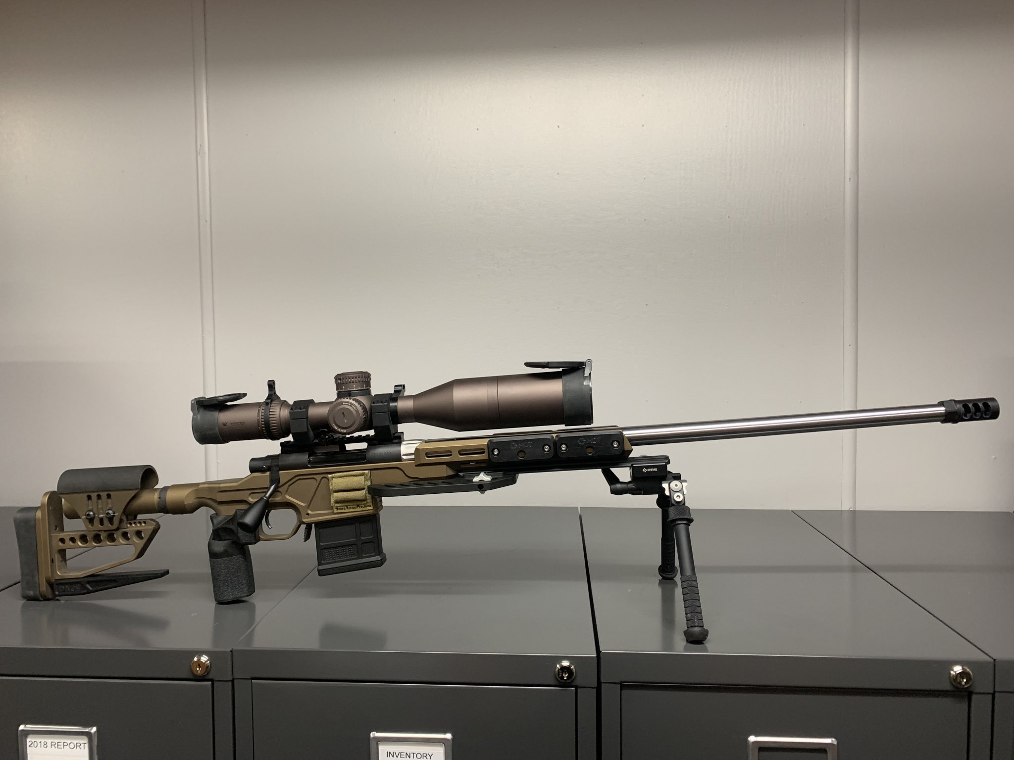

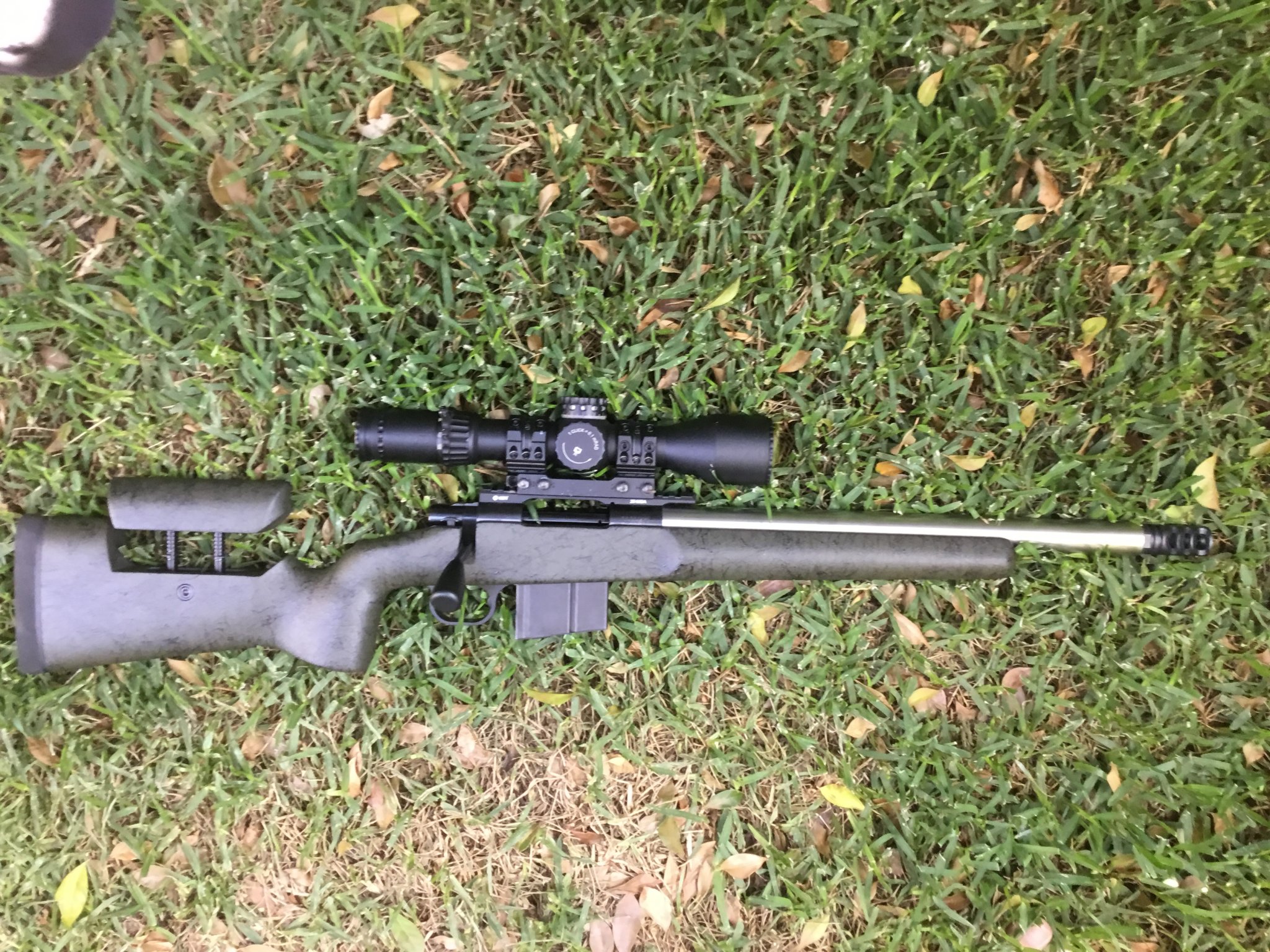

I am glad this thread has posted. I am contemplating a Howa 6.5 creedmore build in a McMillan or Manners stock. I like the idea of the aluminum mini chassis Manners but like the a6 adjustable of McMillan. Hows is everyone rifle holding up and what are your groups like?

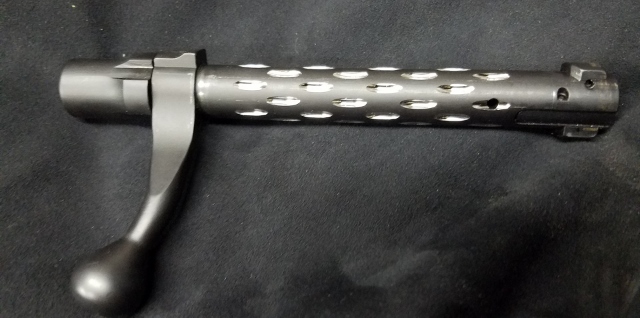

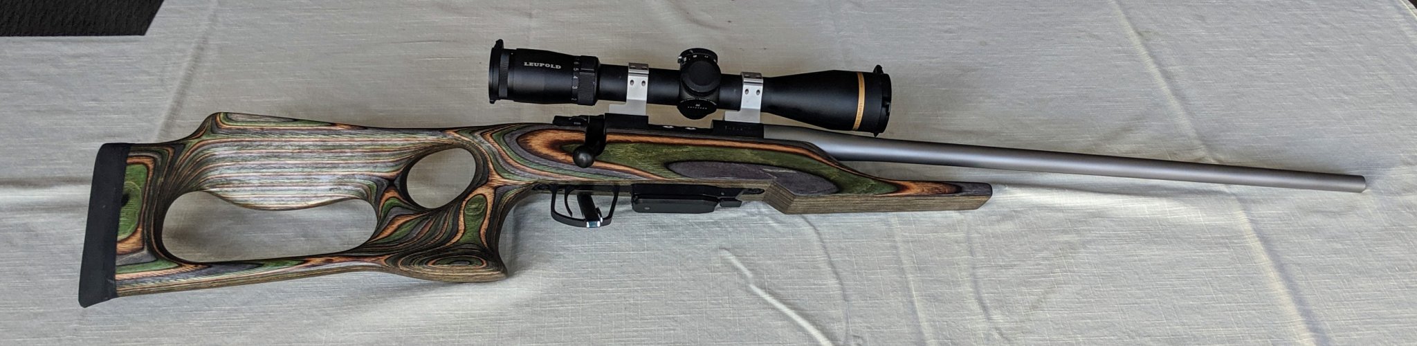

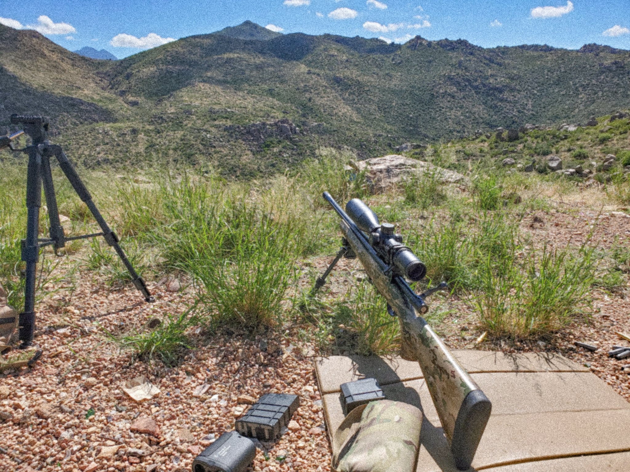

Here is my Howa 1500 semi-custom build in 6mm AR (AKA 6mm Grendel). Details:
1. Howa 1500 Mini barreled action (22" from Brownell's - one heck of a sale)
2. PacNor SS Super Match #1, 1-8", 3-groove barrel, finished at 22"
3. Bolt fluting by LRI
4. Lapua 6.5 G brass
5. Redding type S bushing Full length sizing die, 6.5 G
6. L.E. Wilson Neck Sizer Die Bushing, 0.269"
7. Forster Ultra Micrometer Seater Die, 6mm PPC (My GS reamed it to 6mm G) Actually I am using an L.E. Wilson 6PPC seater
8. Boyd's Barracuda stock in Forest Camo, un-inletted, inletted, with pillars, and glass bedded by my GS
9. DIP bottom metal/mag holder with DIP mag release
10. Talley Light Weight Alloy Scope Mount (30 mm, Medium)
11. Leupold VX-6 HD, 2-12x, FireDot, windplex
12. Original trigger - worked on by my GS (2.5#, no creep, ample over travel)
13. Shortened Magazine.
Using 90 gr TGK over 31.2 gr CFE223, CCI 450, 2889 fps

Man that is an awesome build. I’d have a rifle in 6AR/Grendel in a heartbeat if I didn’t have to roll my own when it came to ammo. Nice rifle.

Man, I've had a 6mm grendal bolt build on my list for a while. I have a 22" AR 6mm predator, which is the same.
Is that velocity a typo? I'm getting 2830 with 90 gr TMKs.
My only reservation so far with a mini is the complaints about the mags. I think someone is making a DBM that uses AICS mags, but I don't remember who it is.
Glad I'm not the only one who feels that velocity is off by a lot. Hopefully he meant something much much faster!
Thanks. It was a typo. I fixed it 2889. Mags work perfect with the DIP alum bottom metal. I cut down the one in the pics for a 4 round cap. I had vel upto 3000 with TAC, but it was a kind of hot load.

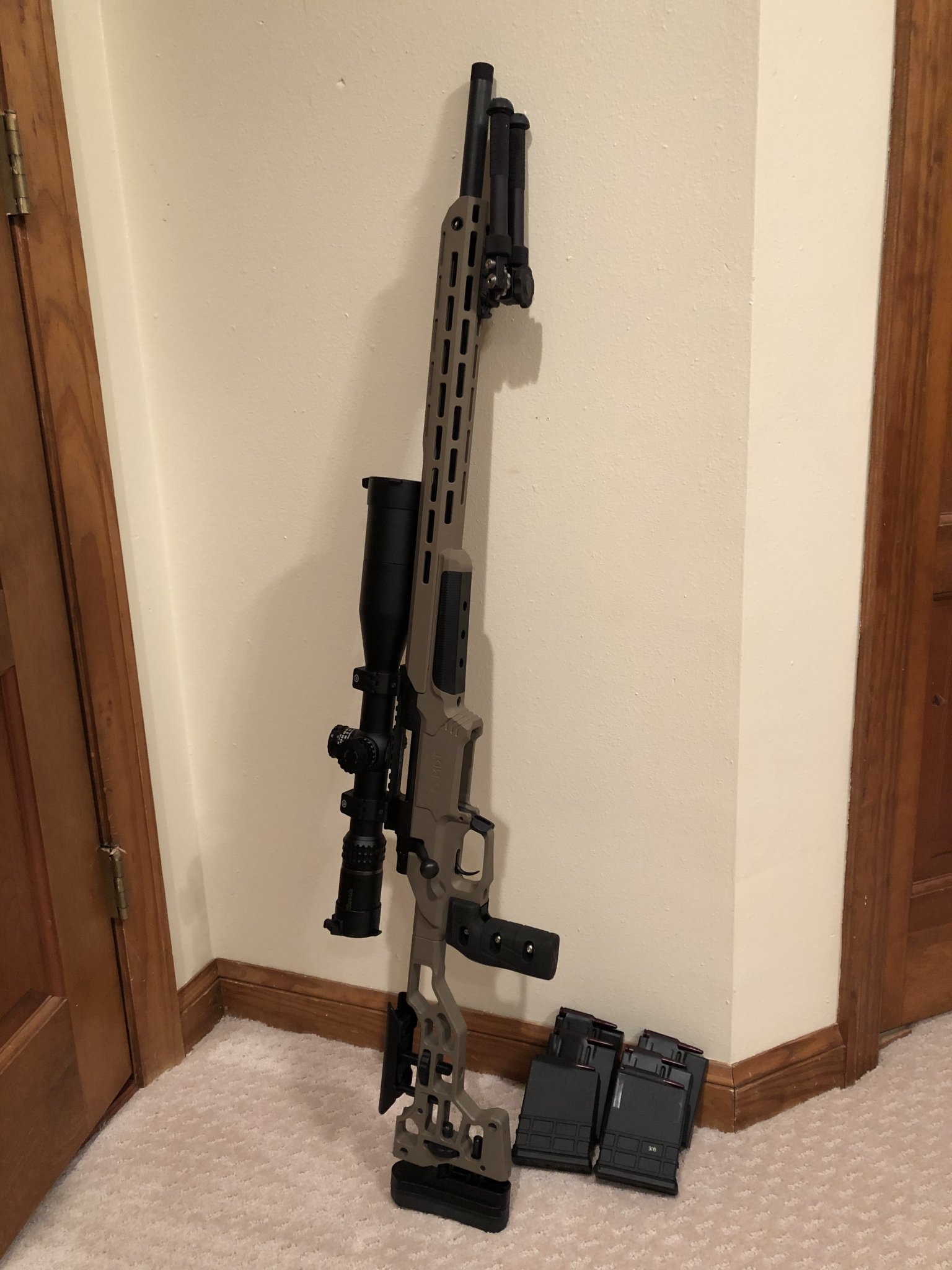

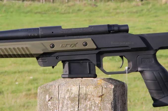

Does anyone have a mini heavy barrel in an Oryx chassis or the one sold by Brownell’s?
I’d like to see if someone can post up close pics of the mag release lever and how much clearance is around the barrel to chassis.
thanks

It is CDI that makes the AICS bottom metal, but the mags are a lot longer than the action so you're still limited in length. I like the release better though....

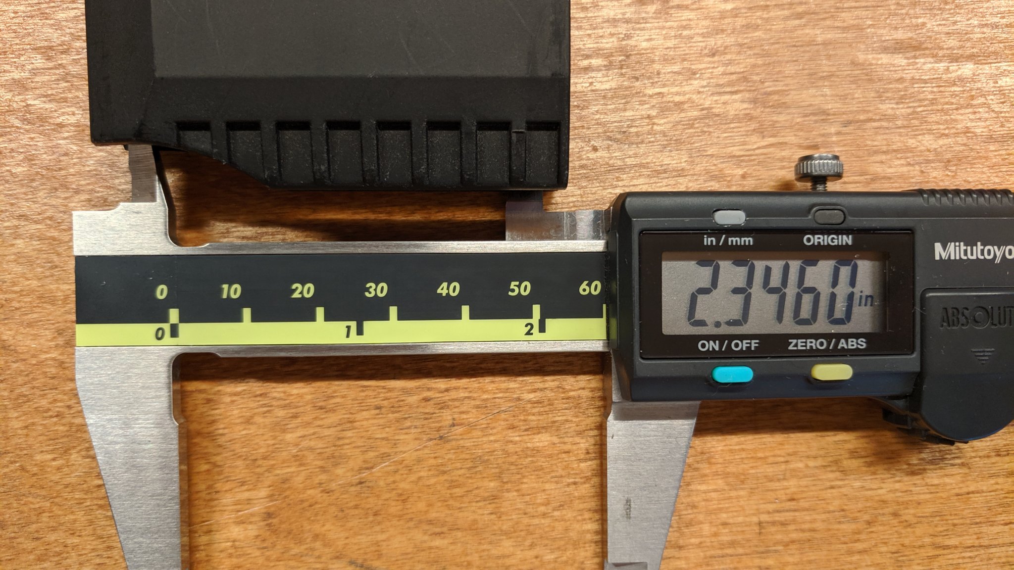

What is the max internal length of a Howa mini grendel mag? Or max COAL?
Ah, I figured. I know whatshisname that runs the 6mm AR site runs them pretty slow, so I wasn't sure.
2.32" from what I have read for the Howa mag
