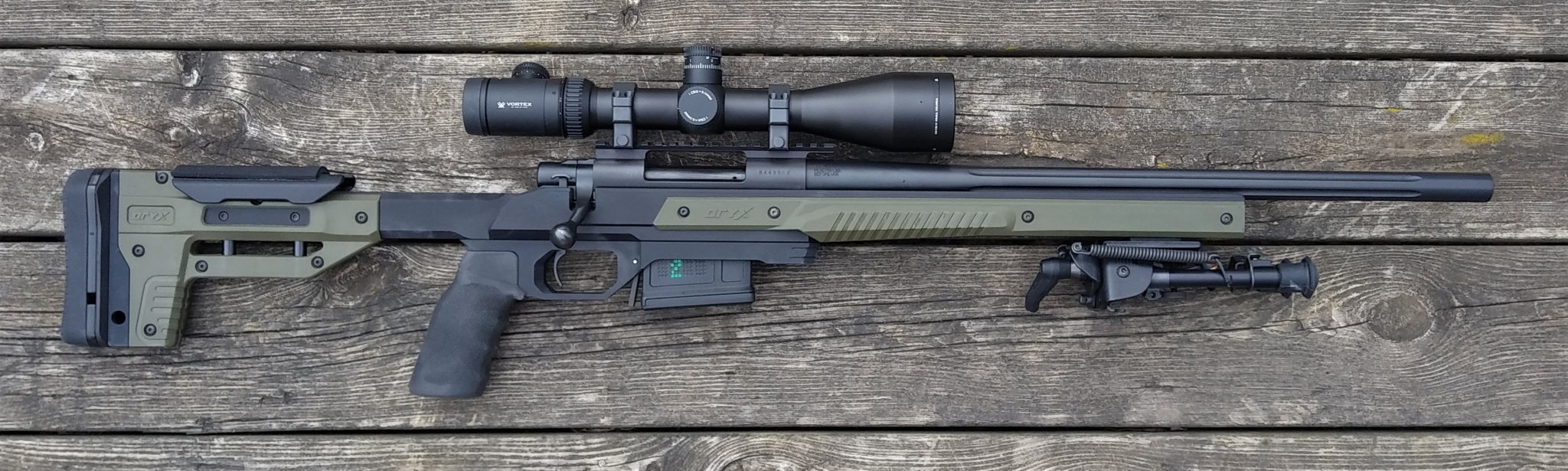

The Oryx is a great option for the Howa.
Reactions: long range sponge
The lack of reviews concerned me too but it turned out just fine. I'm 6ft 2in and its totally comfortable for me with no extra spacers. Let me know if you have any other questions, I will do my best to answer them.

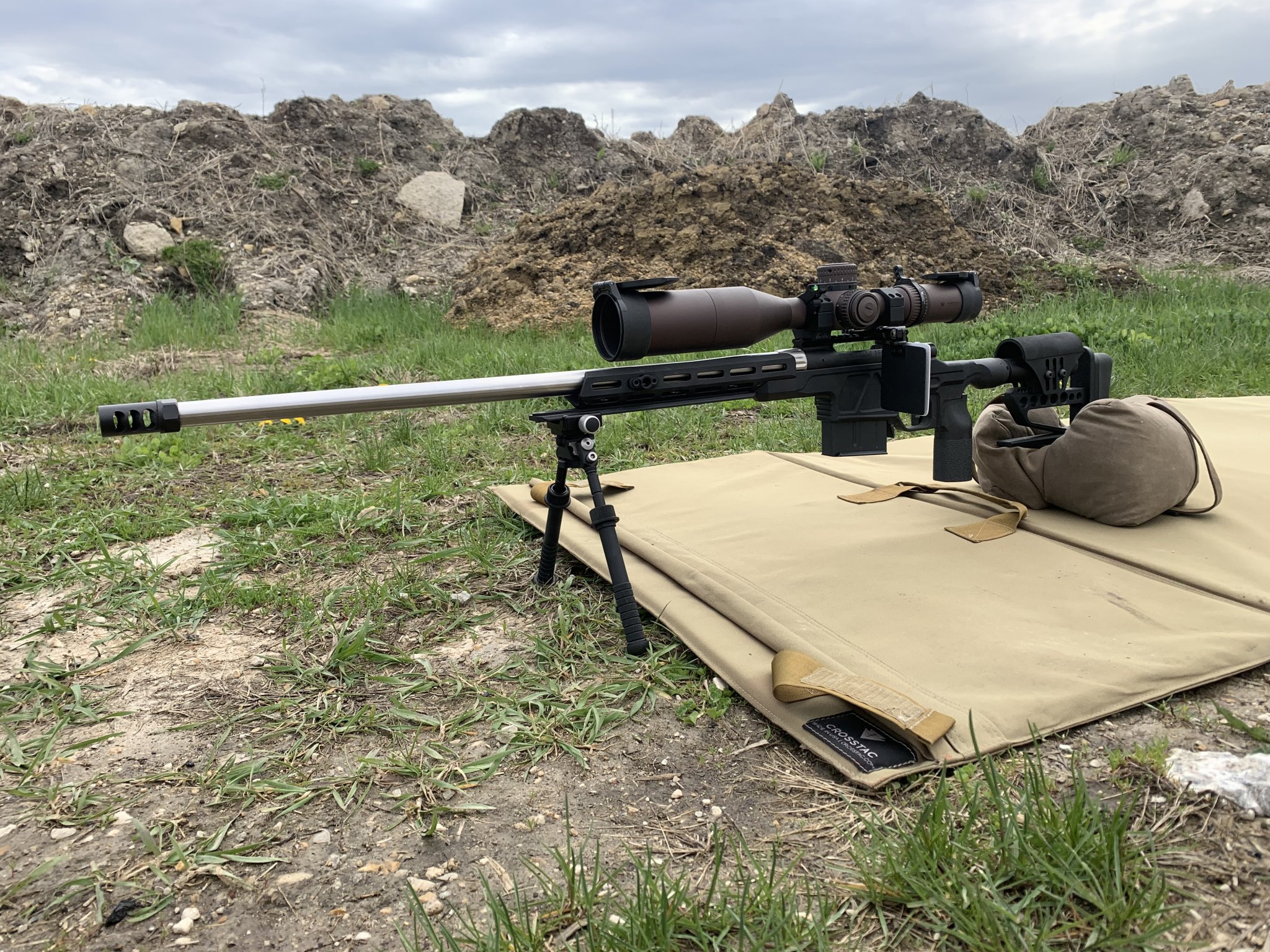

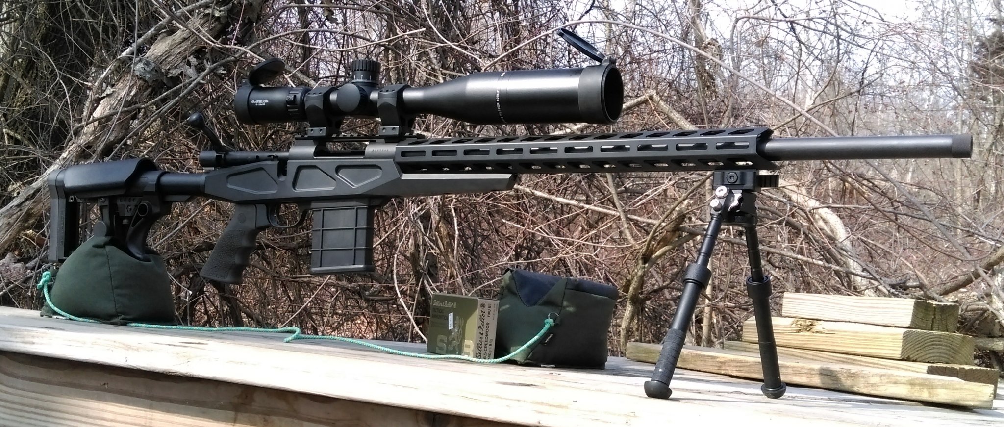

I own 3 HCR rifles (6.5 duty rifle, 6.5 practice rifle, and a 6mm comp rifle) and have put around 3000 rds through them in the last 1 1/2 years. My partner has a duty 6.5 HCR and a practice HCR. I am not sure of his exact round count but it’s around 1500 rds. They are solid, smooth, and amazingly accurate rifles. My comp rifle has a Timney trigger, Arca rail, MPA grip, and XLR stock with bag rider. Duty rifle is stock. If you have any specific questions I can answer I would be happy to help.
