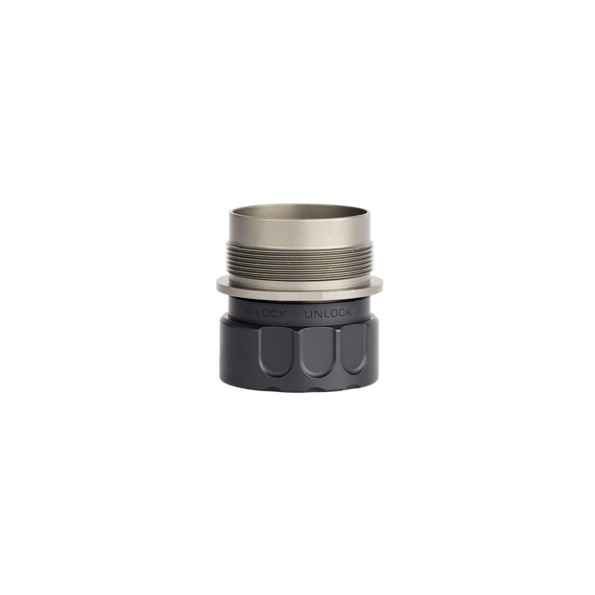

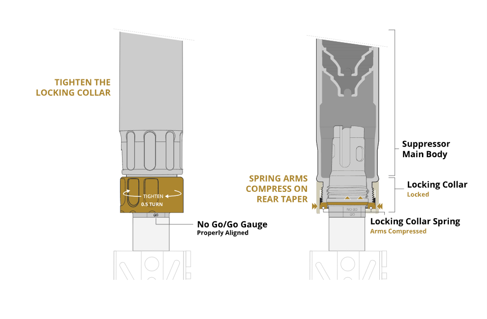

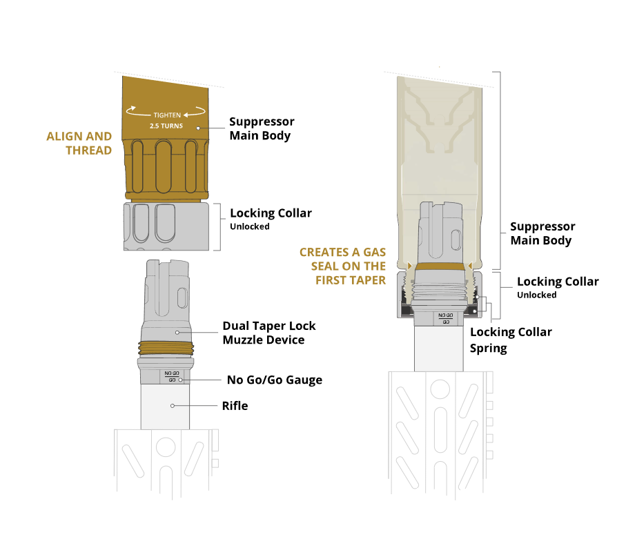

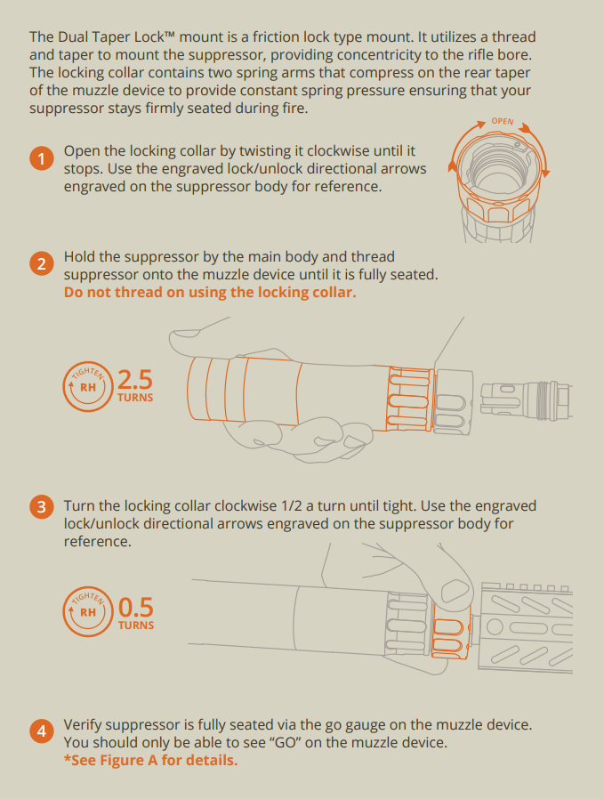

Rugged Universal Mount is HUB, taper with locking collar.
ASR is taper with locking collar.
Torrent Suppressors Hideout is taper with locking tab to prevent backing off, but the thread is much finer than either of the above.

Rugged RUM: ✅ I don’t see a collar? I see a dual taper? Maybe I’m missing something? Maybe I’m looking at the wrong unit?

Rugged's Dual taper lock system and the RUM

Rugged RUM (dual taper system) - You don't really hear too much about this one. Limited selection of muzzle devices. Only thing I can recall which is user error is the suppressor main body loosens, but the rear taper locking collar keeps it secured to the muzzle device. It happens when the suppressor body isn't tightened firmly on the forward taper. It's also indicative of the secondary taper locking collar functioning well as a retention mechanism.

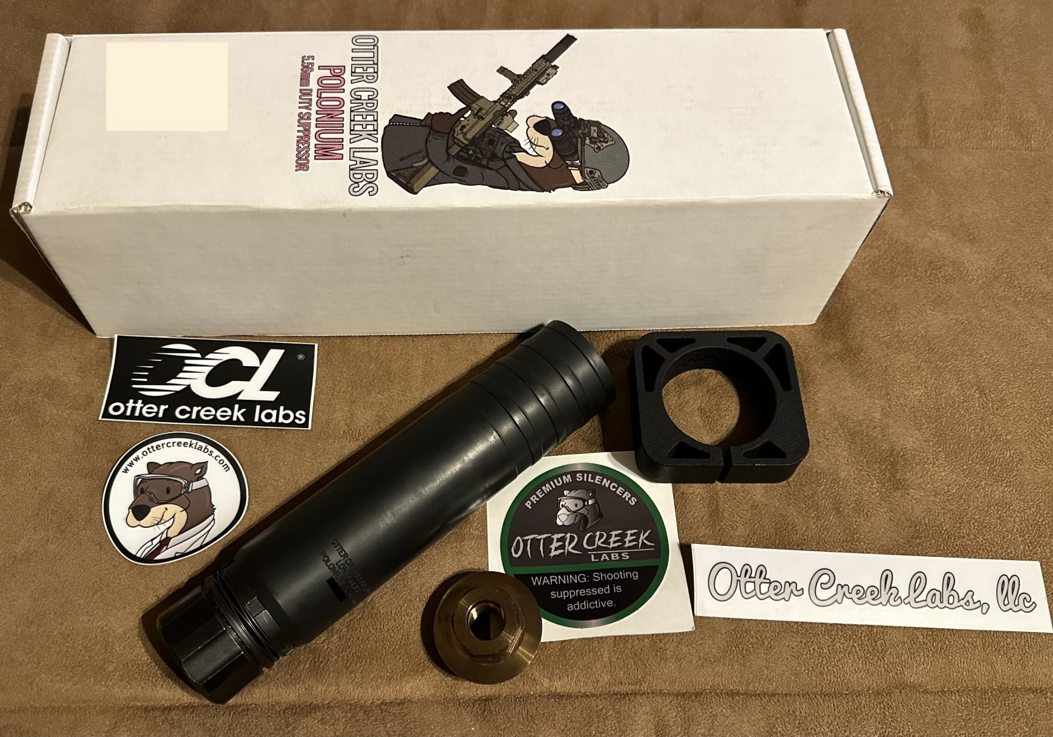

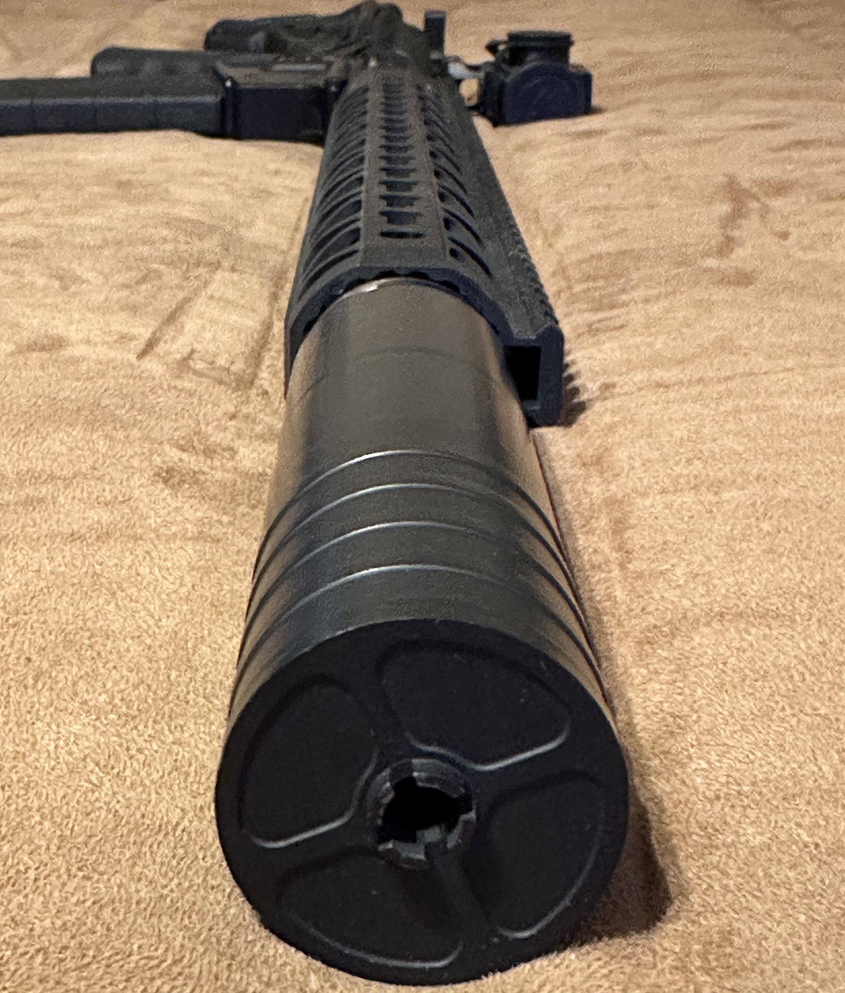

I'm running a Dead Air KeyMo on my OCL Polonium 5.56 can that the stamp came back today. My SOT is a range, so I get to use them as much as I want while waiting. Never once had any issues with the KeyMo coming loose or having any issues. I can highly recommend this can, too.
