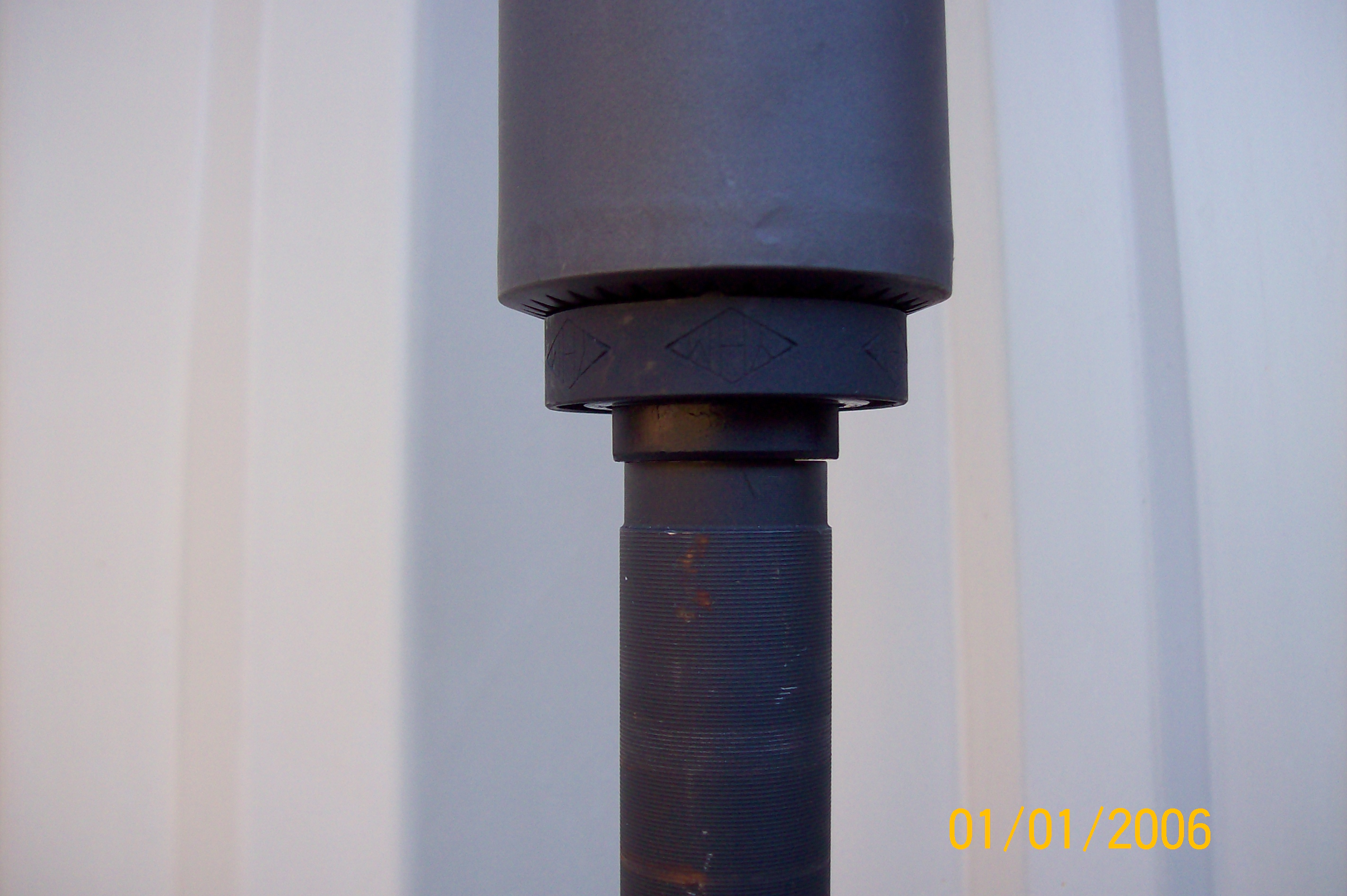

Here was my problem. In the pic of the attached QD adapter and suppressor you can see a slight gap on the right side between the barrel shoulder and the adapter. This is with the adapter LOOSE-not torqued. When torqued, the adapter face and barrel shoulder match up. This in turn pulls the threaded section to one side and causes the huge change in POI.

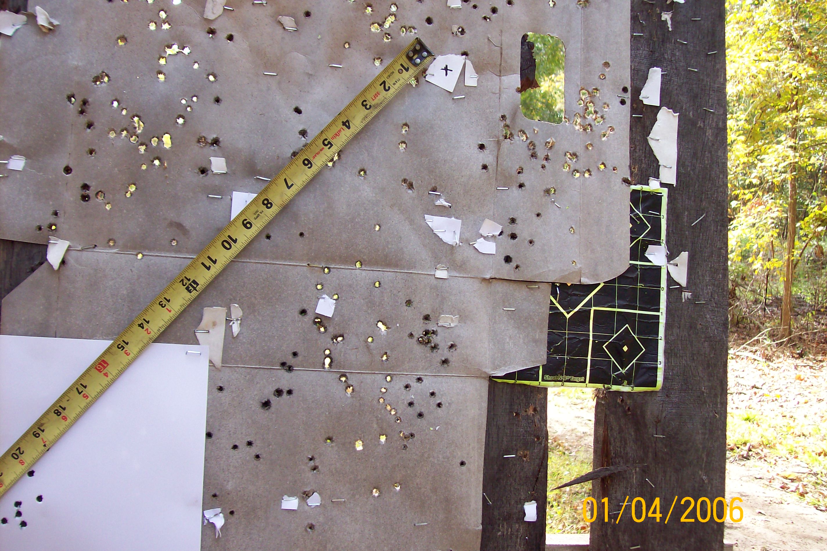

In the target pic, up in the upper right quadrant you can see a small piece of paper with an X on it. That was my POA, while POI was 21.5" at about 730. When I loosened the adapter the threads sprang back to original position and POI returned to normal. All this was at 100 yds.
