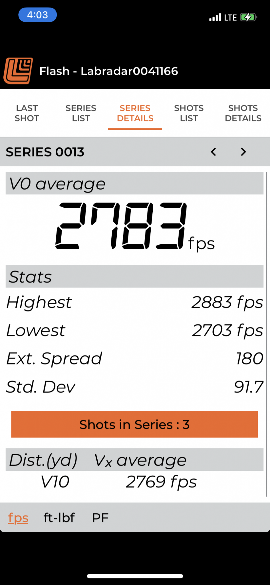

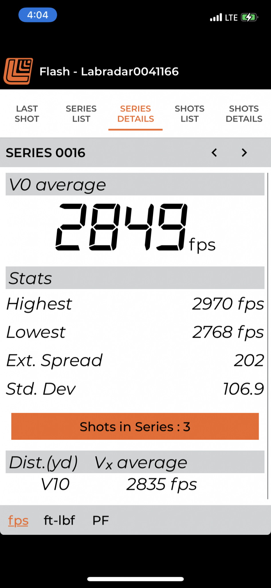

    At the start of this test, the barrel probably had a max of 20 rounds and was not cleaned since the factory round test the week prior. I shot another factory 3 shot group of the Berger 109 factory yellow box. They were almost dead on velocity from the previous session, maybe 15 FPS slower than the previous session as it was quite cooler. So I started with the 109s and Superperformance. Brass was virgin Lapua and Fed 205M primers. First string was a huge velocity split. 180 ES and an SD of 92.
    The next 2 were slightly better ES in the 80s ans SD’s in the 40s.

    Accuracy was not terrible, maybe .75” or so. I was seriously thinking my Chargemaster 1500 was F’d. No way could I see these kinds of spreads.

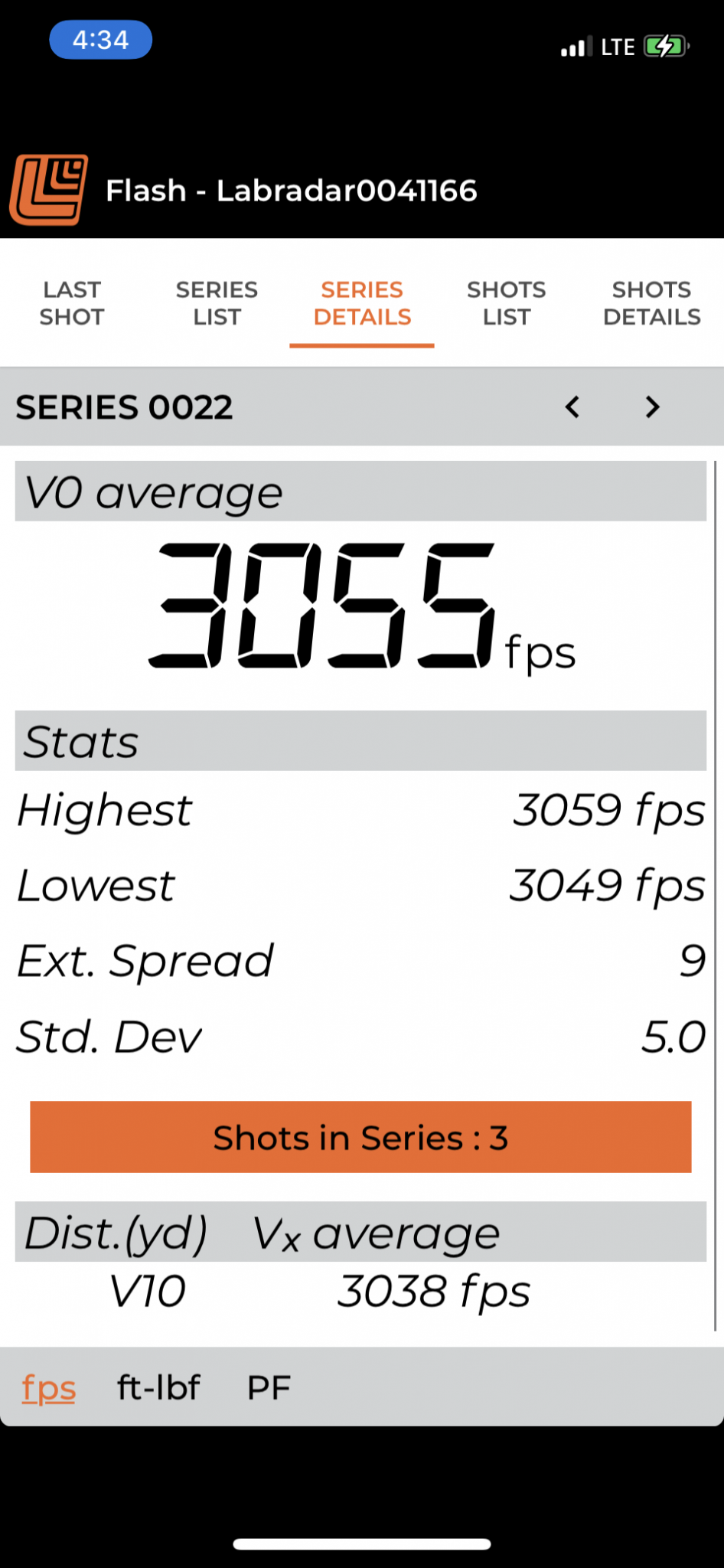

    So with dread, I began the next ladder with the 105 Bergers and IMR 4451 thinking either my powder thrower or LabRadar had sh*t the bed. The next five Strings were SD of 19, 14, 8, 3.5 and 5.1.
    Any clue what would cause 200 foot spreads like that? All were virgin Lapua, match primers, neck mandreled, etc. WTF?

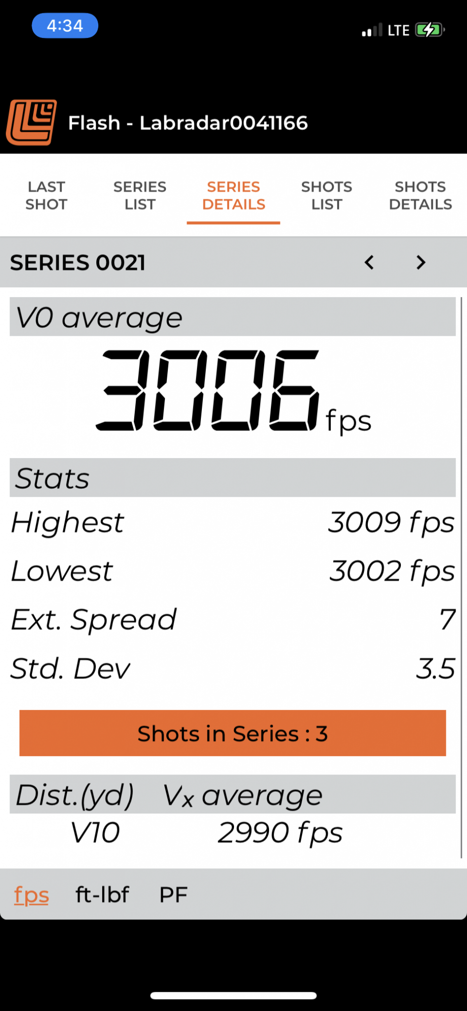

    Based on my results yesterday with the 4451, my load dev is done in 15 rounds. I found a node right at 3000 fps that shoots into a tiny cloverleaf with a 3.5 SD. I *might* do a seating test, but its shooting so well at factory OAL, that I'm not sure it's worth the components and barrel life. Next week, I'm going to take it out to 1000 and beyond and see how that load shoots. If it shoots as well as I think it will, I'm done.
