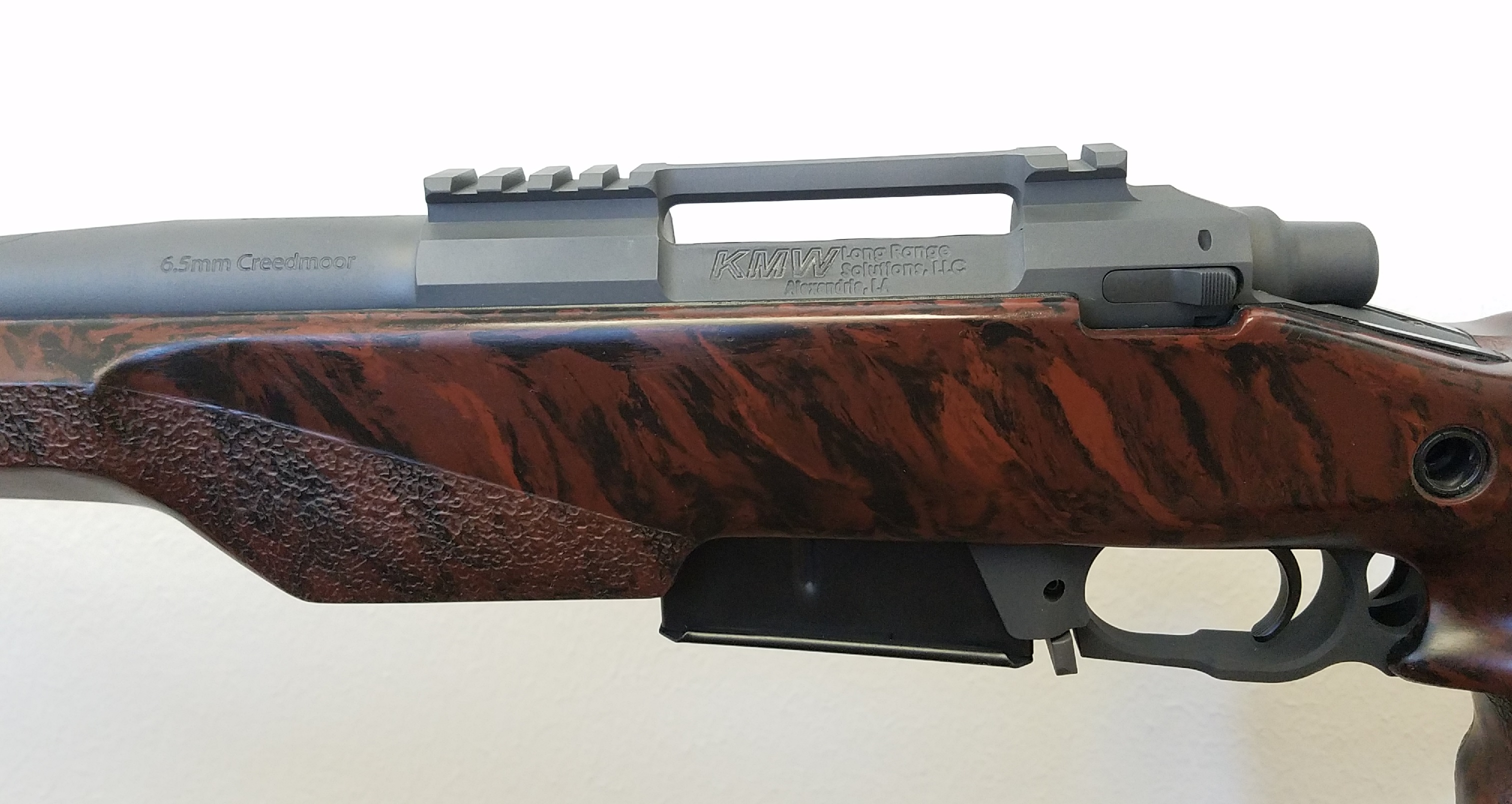

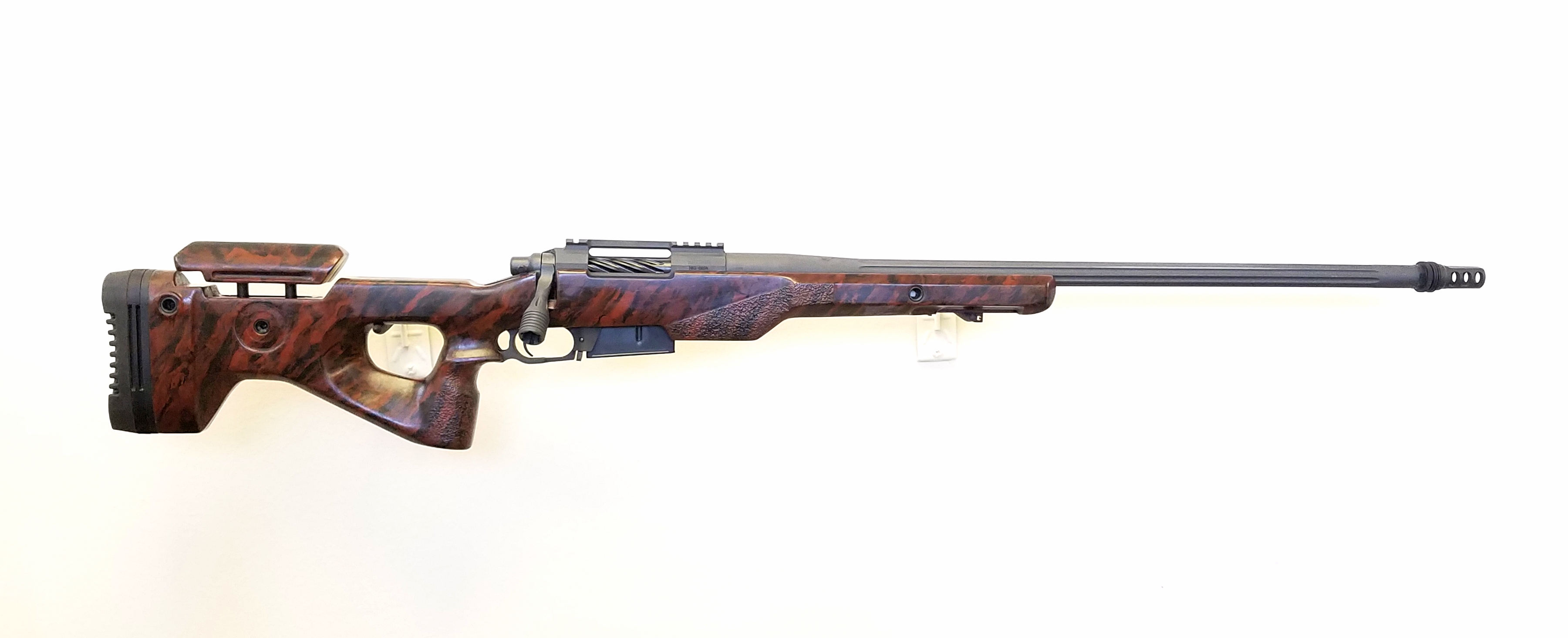

Took a chance on trying something new.
A group of Hunter themed SENTINEL rifles.
Attempted to mimic traditional metal and wood look while keeping the advantages of modern materials. Also wanted them weighing less than the usual work guns.
These came out nice enough that I think I am going to do a dedicated group again every Fall.

That looks great! Specs??
Thanks.

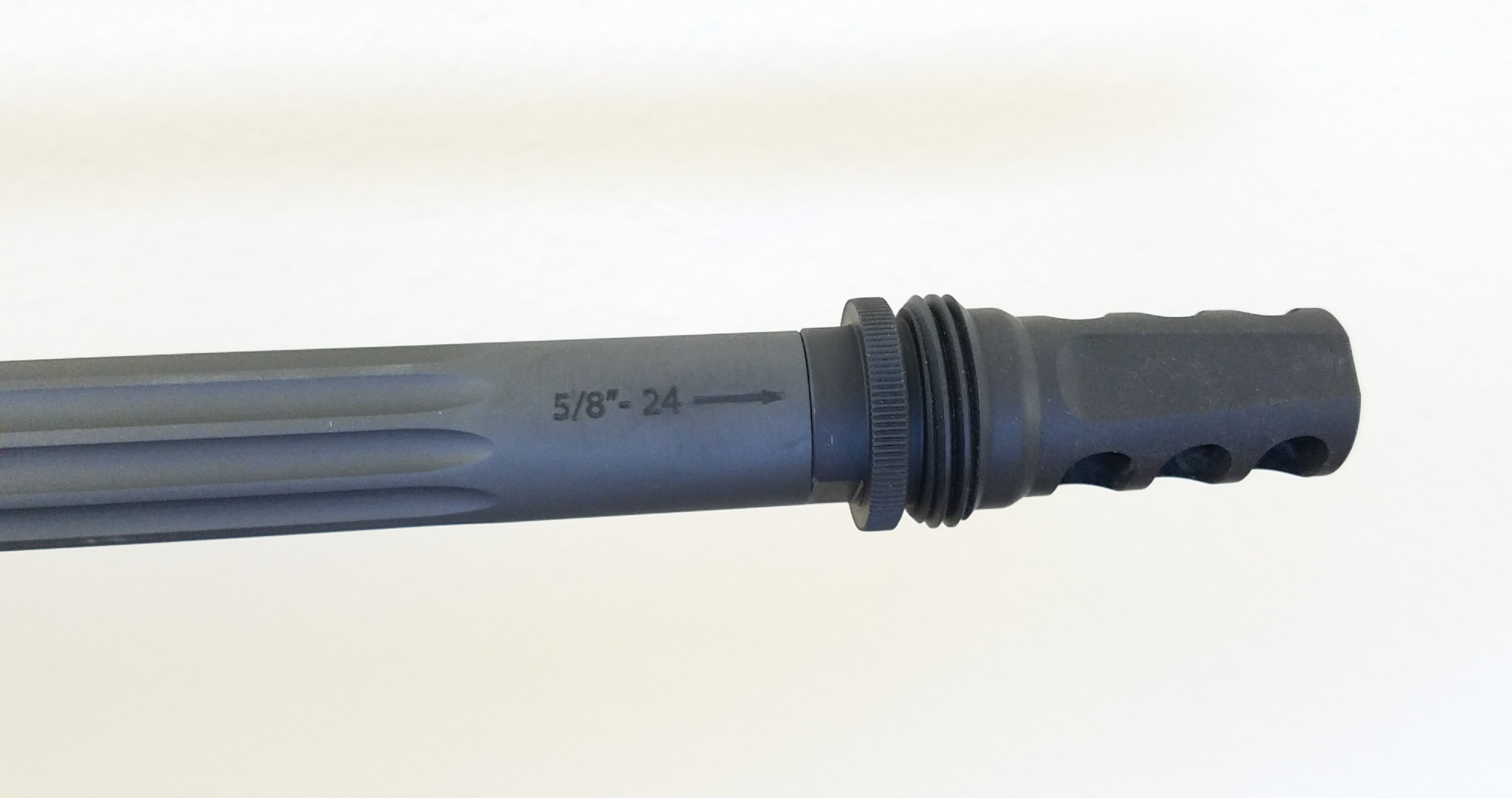

Branded Defiance action with bolt to my spec (smaller bolt dia and short handle )
Krieger 1-8" , stainless Med Palma w/10 flute pattern finishing at 26"
SENTINEL stock with light fill, IMB internal chassis and molded in wood color.
Timney M510 trigger.
Bolt body, firing pin, extractor and cocking piece coated by I.H.I. IonBond
All other external metal finished in Smoke color CeraKote Extreme.
What does the weight come out to, as pictured?
Weight as pictured is about 11 pounds.
Without going full carbon fiber on the stock and barrel blank, it was never destined to be a really light rifle. Too much heritage from the original SENTINEL work guns, so everything is overkill on hardware and components.
