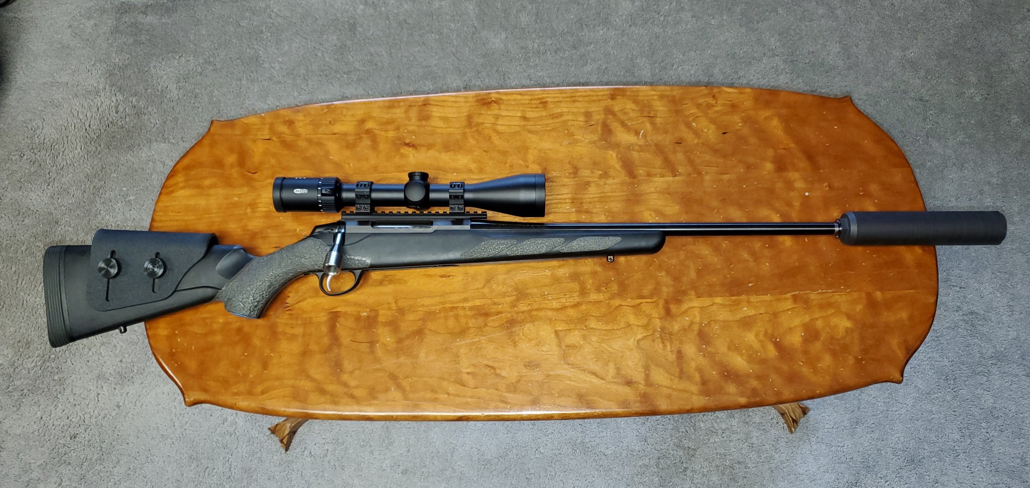

Here is a Thunder Chicken mounted on a Tikka T3 30-06 cut down to 20".
With the Meopta Meostar R2 2-12X50 it balances out really nicely.
The Thunder Chicken works awesome on my 300 black out.
Next weekend is when I plan on getting this sighted in, then start the load testing.
