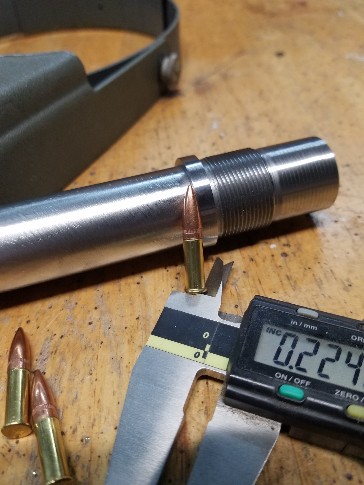

I BLAME MYSELF !
Rimdenter
Gunny Sergeant
Feb 27, 2021
586
491
Texas
It's a sickness many years ago my wife conceived a name for, to make the story short we have to understand that all women are sound minded and when she made the statement , if it wasnt good enough why did you by it ? I slipped back into that dark place. She negated the fact that $$$$$$$ was the problem at that time . The last 2 weeks a flood of empty hulls piled up on the front porch while daily I assaulted steel and paper from 50 to 330 yds everytime I picked up the gun or guns she would say ,I thought you already had that sighted in. Finally it happened I told her it wasnt close enough !!!! I found myself gazing into the brite screen this morning plotting a profile on a Nosler 40gr. BT, jumping on my PC to enter points and create a I'd profile program to make a female tensioner. FOR WHAT !!!! I thought the gun already shoots good ! Yes it is a sickness.

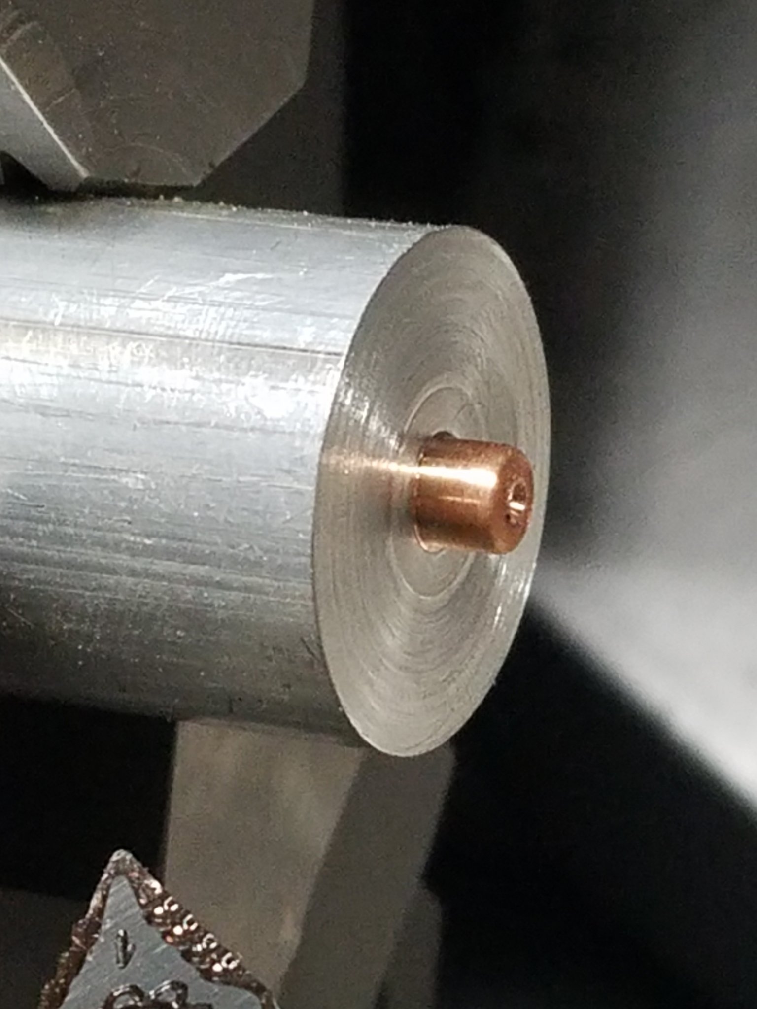

Wow what a day I feel like I've been in a watch shop ! Turning pre made bullets is a task, certainly! I know I heard someone in Arkansas holler from the 1st 3 I shot! I'll just be blunt 16" twist ain't the ticket unless its 2000 fps and I didn't see that ! Pic below shows 3 holes couple you could put a castle key in.

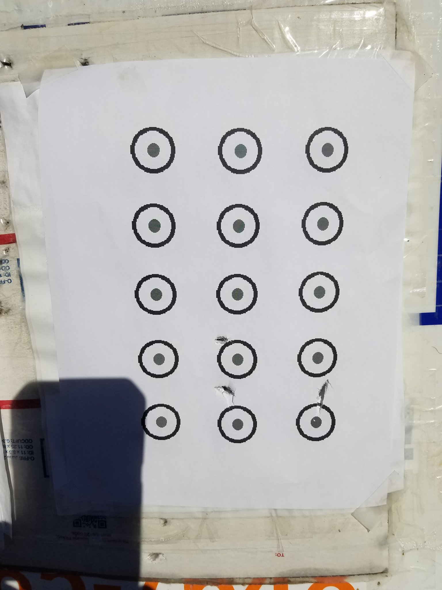

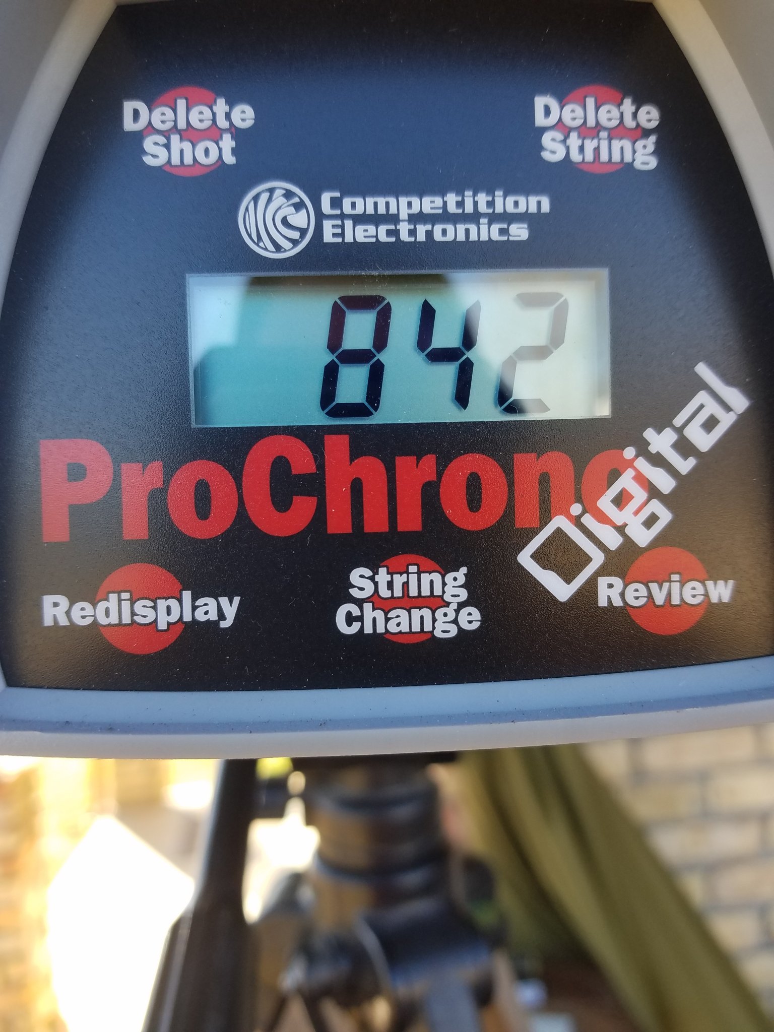

The 1st load at 1.5 grs ACC7 never saw paper at 842 the 2nd load at 2.0 grs hit low left at 1115 the 3rd hit right at 2.5 grs. 1278 fps

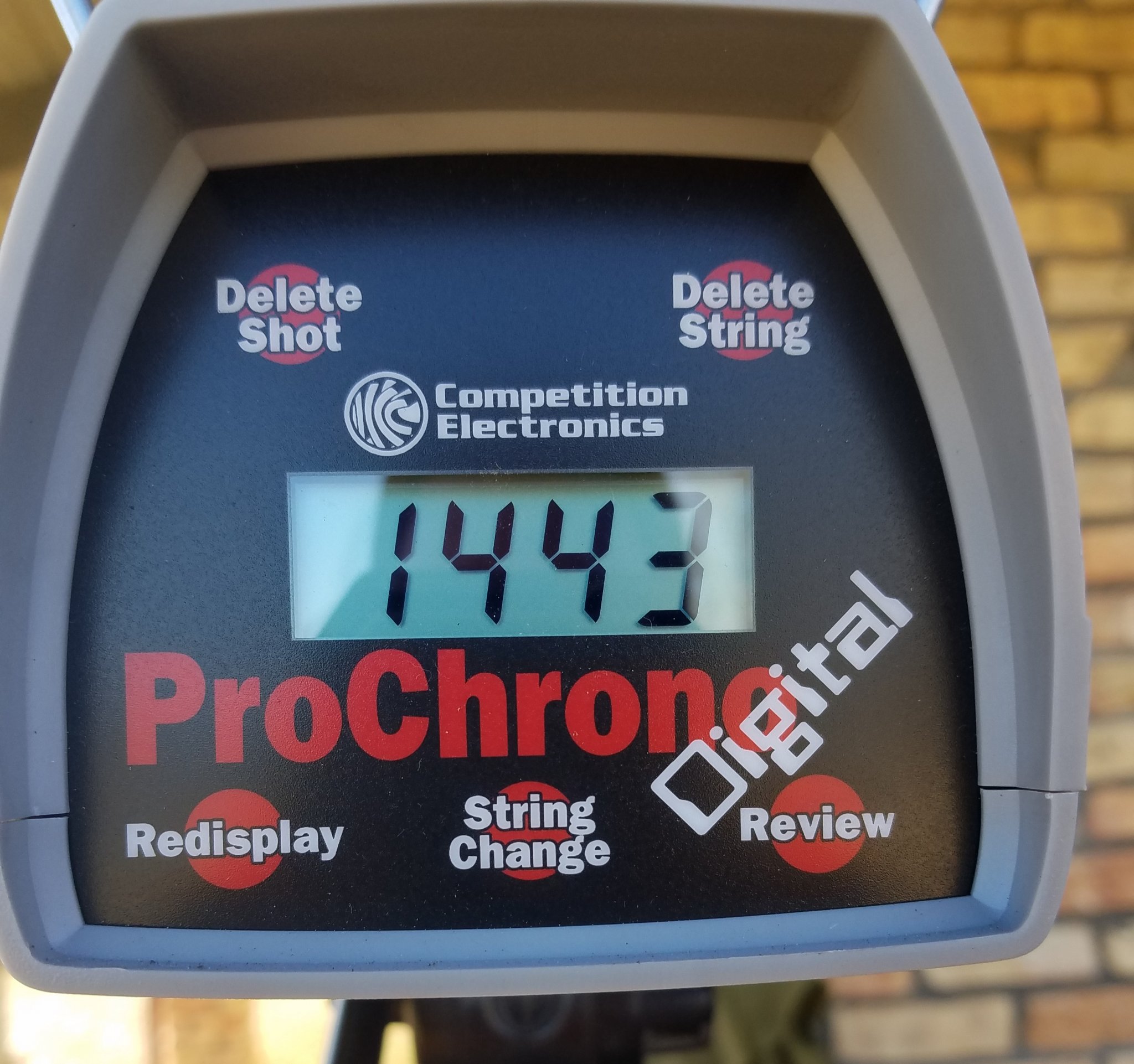

The smaller hole was at 3.0 grs hit close to where I was aiming 1443 fps the 4th shot was a duplicate 1443 and hit in the same hole no apparent rim swelling or the firing pin indent being pushed out so pressure was good sounded like my 17hmr Anny though.

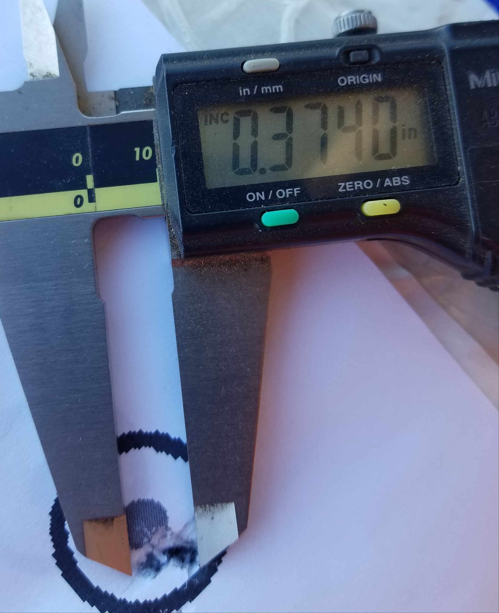

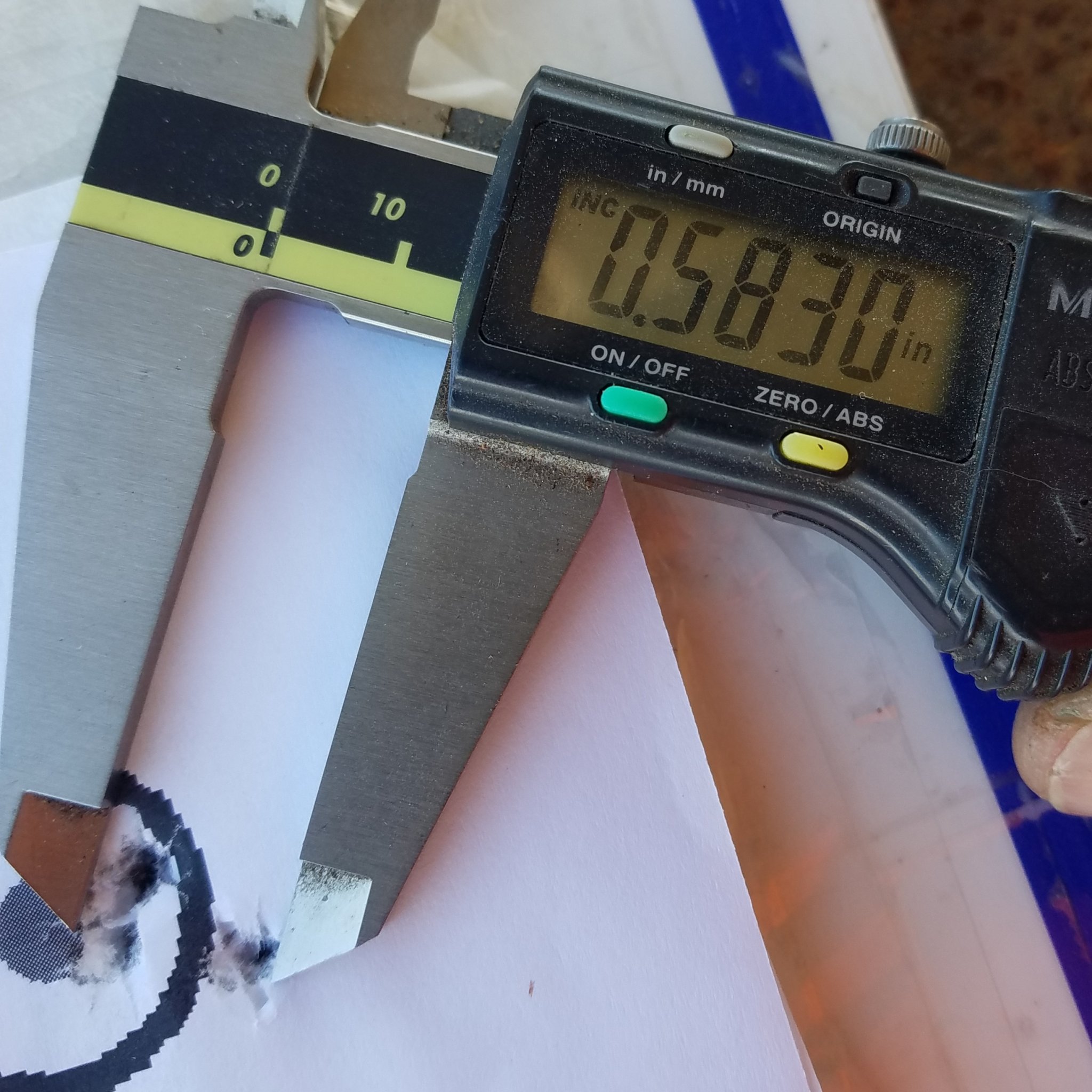

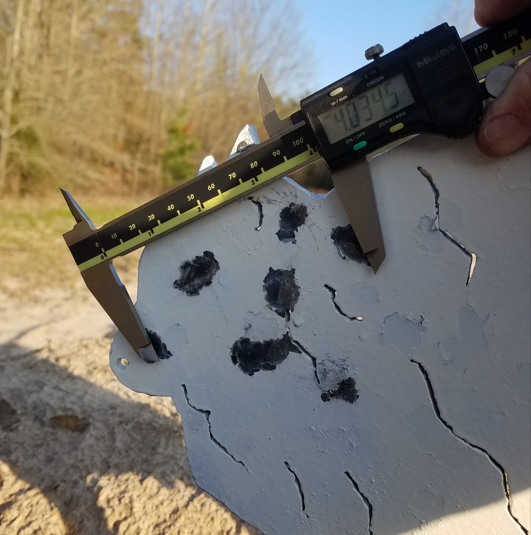

Thought I better check my bore so I blasted 2 10 shot groups real quick with Wolf target and I'll tell you I'll always chunck 1 outta 10 but there respectable.

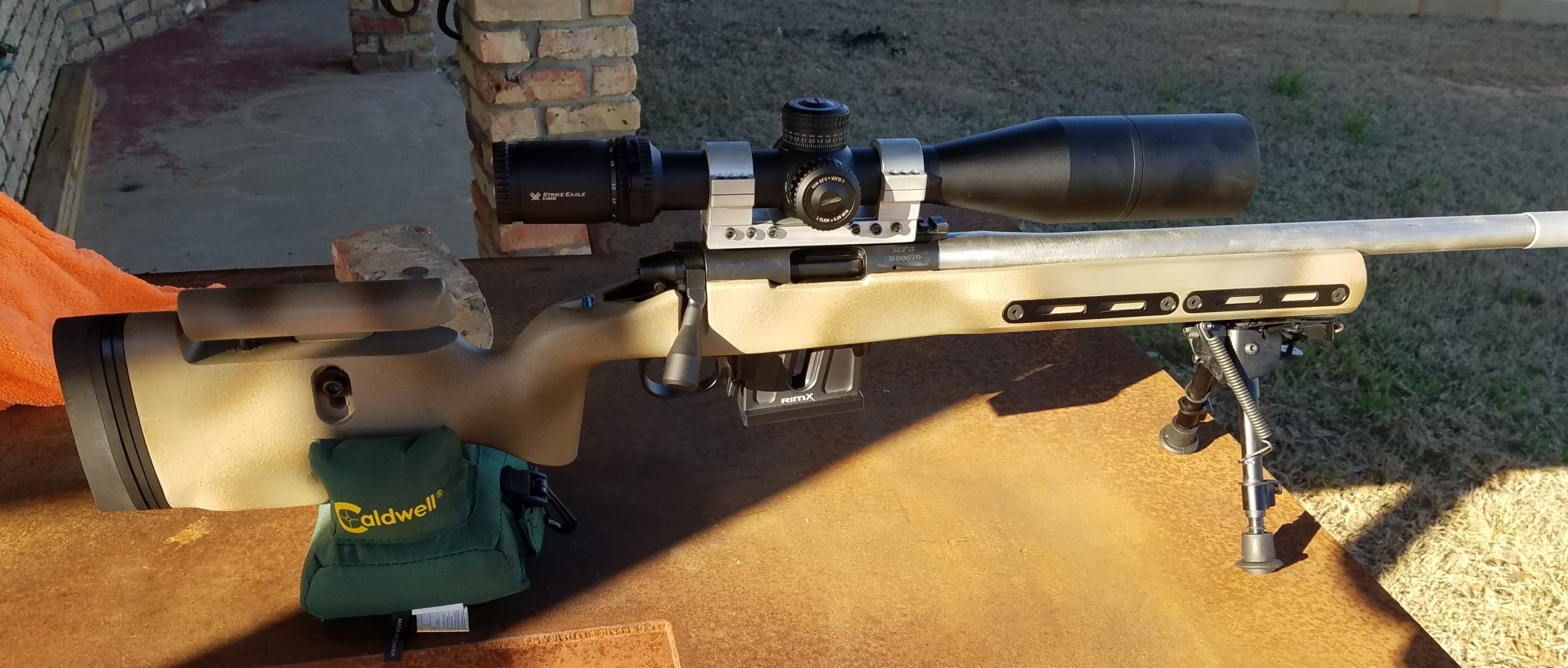

I did jerk the Razor off and mounted my 5-25 Eagle on the gun incase of a accident 🤔 but nothing blew up last 2 pics are of the rifle with a internal helix brake that I tried a ton of different durometer orings on to tune the harmonics . Waiting on a fast twist blank. The 1pc. Scope mount I built is precision wire cut the rail and ring saddles were all cut after machineing.

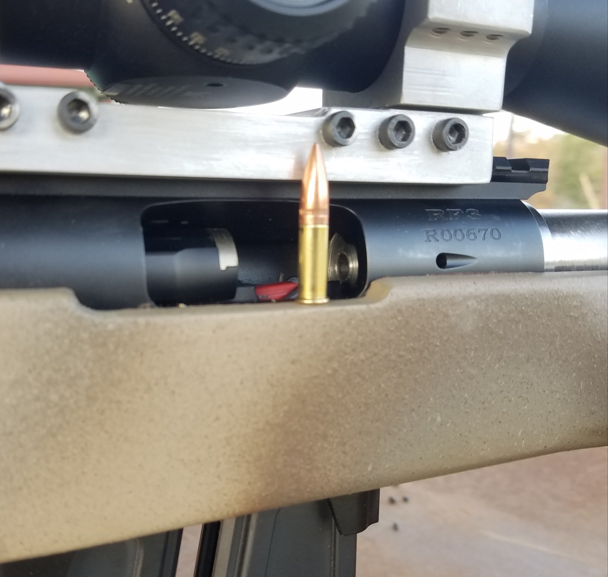

It's a standard rimx action a proof 18" stainless barrel with a trigger tech Diamond at 4oz. After 200 rounds I tore it apart re cut the taper on barrel .100 smaller from the 1.200 to muzzle. I indexed the barrel to 12 o clock and bedded it in the grayboe ridgeback stock it has a 30 moa rail the 1 PC. 34mm mono block scope saddle has 20 moa wire cut in for a total of 50 put the Harris bipod on fitted the v brake called it ready. The scope now is a Vortex ffp eagle 5-25 in MOA.

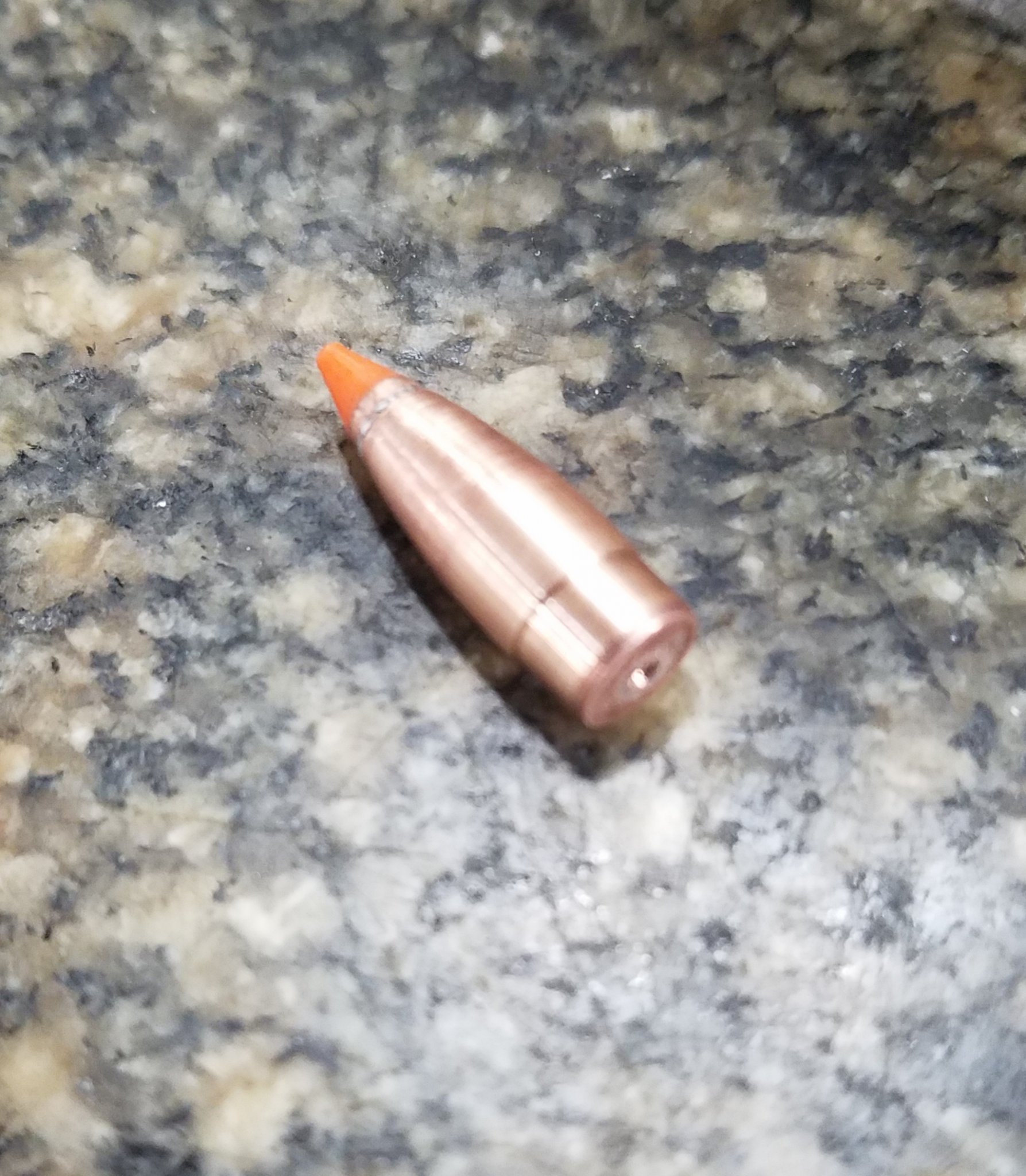

So I've grown tired of waiting on a barrel , so I dug into my barrel bag. Wa La Black hole .224 hence a .224 rimfire 1" OD. though . 1st task make a reduction adapter RIMX TENON to Bastard .748 x 20 UNF3 . Fitted barrel in reduced cut shoulder to 1.6854 cut chamber for odgive .010 in.
Heel turned 55 FMJ Hornady bullets they are wiped swaged in brass waiting on a nice day now.
