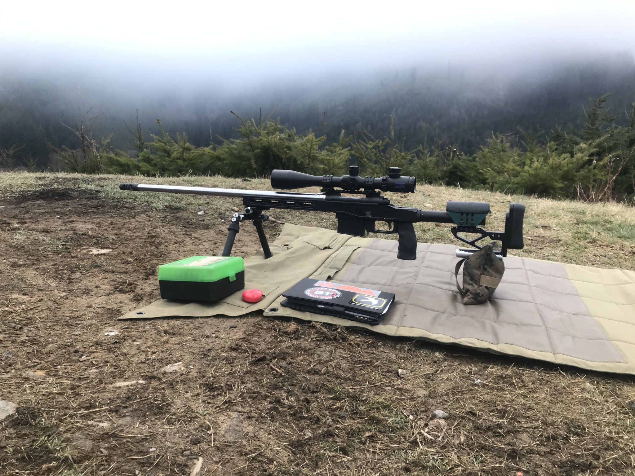

    Ejection has been super lame lately.
    Added a bigger ball under the extractor and that helped but it was just a better level of lame.
    Did a few searches here and someone long long ago used an AR spring cut down as a replacement.
    Made one and cleaned up the ejector and hole.
    Put it all together and it actually works ok now.
    A satisfactory level of lame:).
    Search function sucks but using google to do it got me the info I wanted.
    If you want information searching here almost certainly with
    Lessons learned here?
    1-Savage is a far cry from my nucleus at extraction and ejection but a few barrels worth of abuse and grime certainly warranted some attention.
    2-take the time for the info you seek and almost certainly you’ll find it.
    !!!!!!UPDATE !!!!!!!!
    the first fix helped for a while but quickly faded.
    I then bought the upgraded extractor and ejector from site support Tactical Works.
    That kit did what I wanted and it’s lasting.
    Reactions: Dirty D
    The best fix I could have ever done was taking that $25 loss on resale at the horrible revelation of how truly crappy mine was!
    The experience did have the affect of snapping me into selling other stuff and getting what I considered at the time my ultimate tactical rifle, so in a way I should be thankful, lol.
    Reactions: Steel+Killer
    A bit of an after report.
    I’ve been shooting my precision poors rifle a lot lately and after the upgraded parts Buttercup has been humming along like a champ.
    If your savage has sucky extraction or ejection that kit is a welcome addition.
