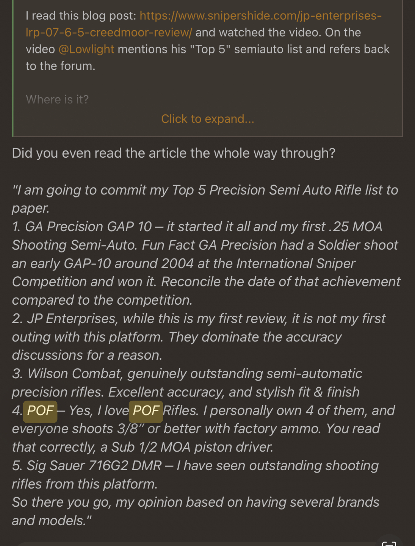

Somebody recommending a savage on the Hide? Hell has frozen over. All jokes aside, that's actually a decent looking rifle.
My large frame journey started with sig, then pos, I mean pof, then I built a di out of the pof receivers, then turned it back to its original self and sold it. Then I picked up a pws, loved it, shot awesome, then I sold it because I got an awesome deal on a like new lmt, been happy with that decision ever since.
The sad part is I really wanted an lmt from the get go but the sig caught my eye at a gunshow and I bought it instead. Only to come full circle and end up with an lmt 6k dollars later.
The lmt has been the most consistent shooter of them all for me yet. My pws was a hammer and I really struggled with letting it go. I sold it to someone close with the caveat I would trade them the lmt straight up to get it back if it didn't shoot as good as I wanted it to. So far, it has surpassed all my expectations.
They were / are some of the most accurate rifles around. My 556s and 762 are accurate af
Frank says :
I had read a lot of good things about them before I purchased the one I had. Researching semi autos is actually what led me to the hide.
Mine just wouldn't consistently shoot well at all. It could be awesome one day, then shoot 3 moa the next. That was the only large frame I ever had that I had that issue with.

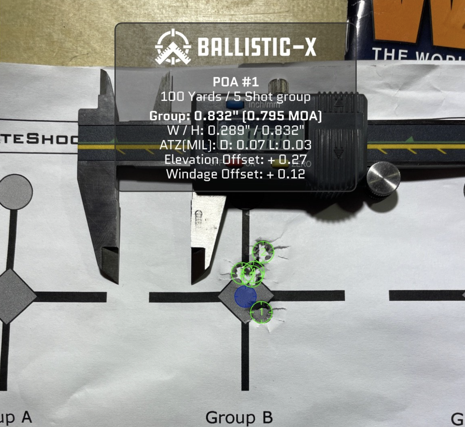

Yeah, the MSR-10s don’t look, feel, or have finishes anything like Savage bolt guns.
Totally different rifle fit/feel/finish.
The mechanical advantage adjustable gas isn’t limited in turns either. I disassembled mine to take a closer look at it and discovered that about the gas block. It has a locking seal feature on the gas tube to gas block fit as well, reminiscent of the SASS program.
If mine doesn’t shoot, I’m going to have a 7mm SWC barrel spun up for it, and use the factory gas block if I can.
My friend’s 6.5CM MSR-10 bug-holes out of the box with Hornady 147gr ELD-M if I recall. He was shocked at how accurate it was. He’s a big benchrest guy who has his own portable press, loads for 6 PPC right there on the range.

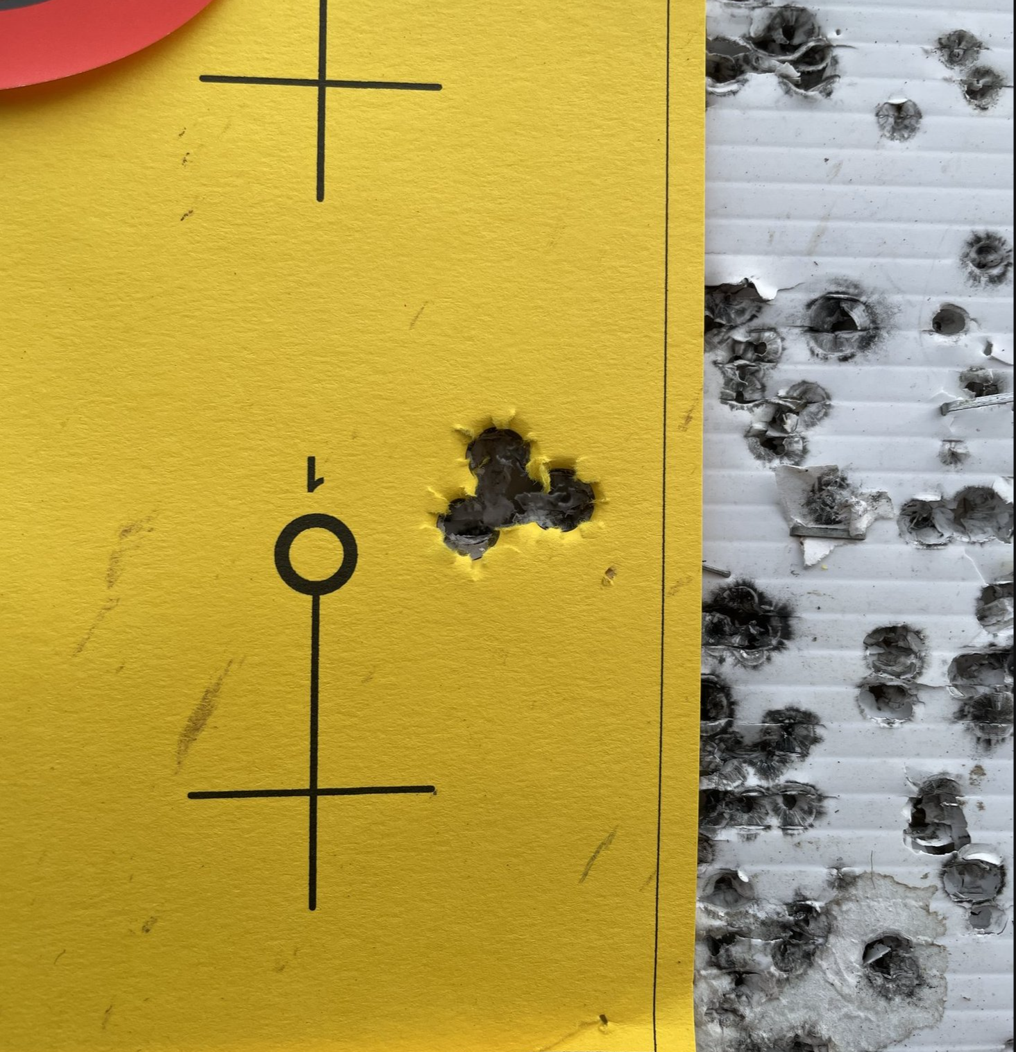

I had a similar experience with two 20" POF rifles they just didn't shoot consistently.
My 716i handles and runs a lot better although groups are mediocre, 2-3MOA, 1.5MOA with handloads.
