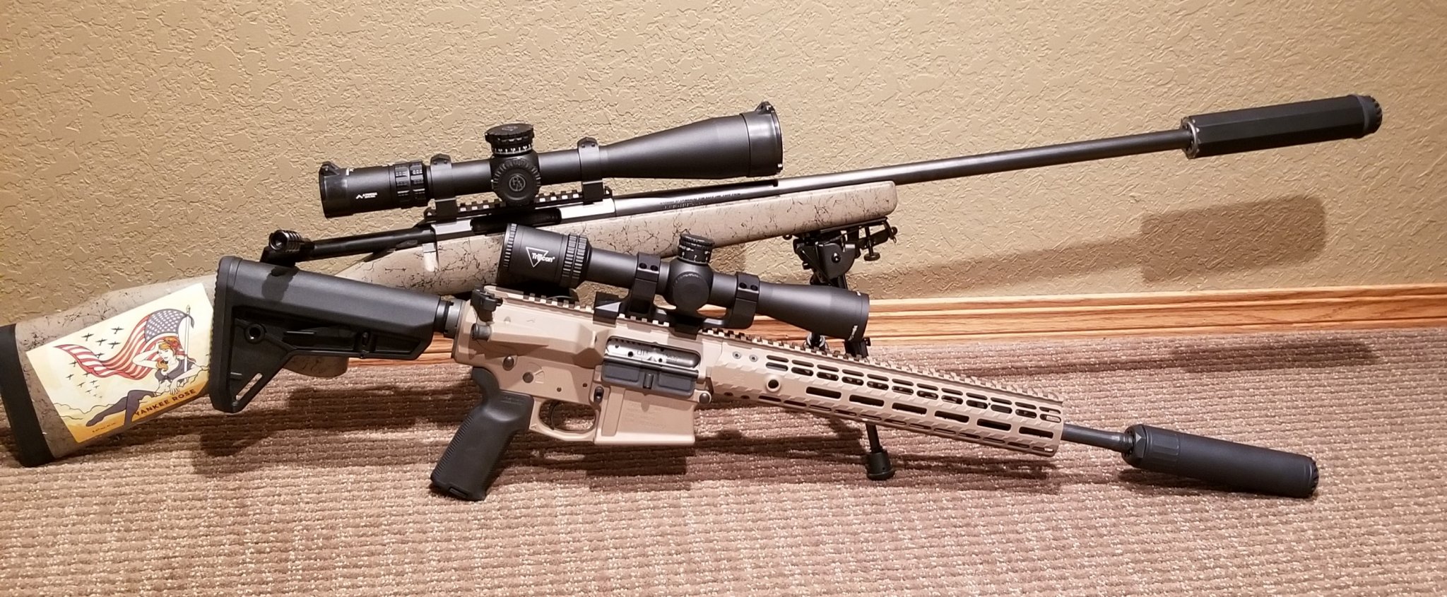

I like 20" barrels for my .308s and .223s in bolt guns.
I know folks like to go as short as 16 for the 308 but I figure since it's the fat, slow kid on the team I'd just as soon help it out a bit.
I would definitely consider 18 for the .223 though. Hard to argue with the success of the mk12 running an 18 inch barrel. I sort of fall back on the whole thing where the 5.56 was designed around a 20 inch barrel.
I just spent a month agonizing over whether to cut my .308 to 16” or 18”... then I just said fuck it and put a 20” Proof CF on. I couldn’t stomach giving up more velocity. I think 20” plus a can is still plenty short.

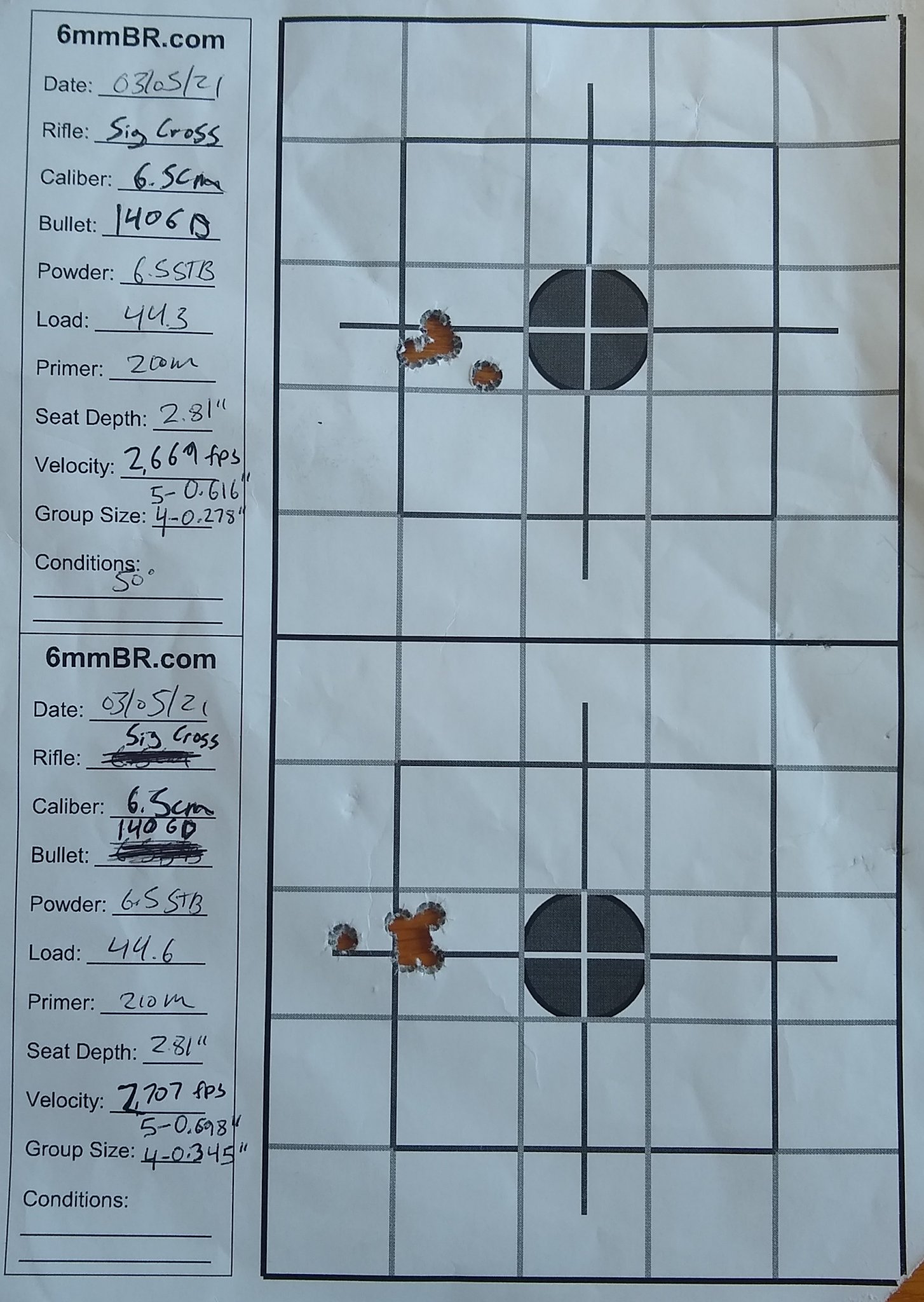

I chronoed some of the same ammo out of my 18" Sig Cross, and got the following velocities:
127gr LRX @ 2,742 fps
142gr ABLR @ 2,680 fps
It shot well on the Sig, different barrels and barrel lengths, interesting that the Sig was ~100 fps slower with the 127gr, but only ~50 fps slower with the 142gr.

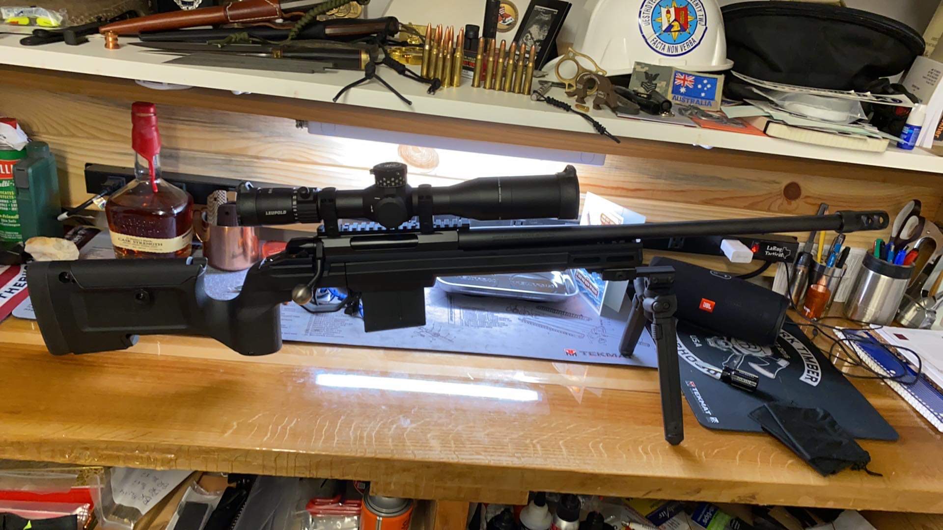

Absolutely. My Tikka has shot everything I've fed it under an MOA, most under 1/2 MOA. Except for the 95 gr VMAX's. It doesn't like those. I reload 129ABLR's and 130 Gamechangers for it and those will handle anything I need to shoot with it.
Im almost to the point I'm gonna shove whatever bullet I can find into a case lol. Definitely a pretty anemic speed on those 140s though. Some quick math I did up a while back pretty much convinced me that realistically anything that is shot at inside of 600yds can be done as easily with a 120 grain bullet zippin along or with a 140 grain movin a couple 100 fps slower. But those are just number crunching theoretics.

If you run suppressors.....you will LOVE shorty barrels. I am hooked! I have a 26 inch 6.5cm on my bolt gun and with a 9 inch can on it even though it's in an APO folder chassis it's a bit much for hunting.
I have a .223.barrel I had @toygunner chop like he did on my son's 6.5CM that I'll be swapping on soon.
If you get in and out of ATV's, stands, blinds and huts......having a short barrel is a MUST in my book. My 26 inch 6.5cm with 9 inch can is literally too big to use in one of our shooting huts (18 inch SPR style AR15 with same 9 inch can is barely usable)
My son's rig got me so hooked on short barrels I went REALLY unconventional on the barrel for my AR10 I'm building........16 inch Wilson Combat 6.5CM. I am getting into hunting at night, have reloading stuff for 6.5CM and wanted to try something different. I also have a law gen3 folder for this AR10 build to help with being compact.
