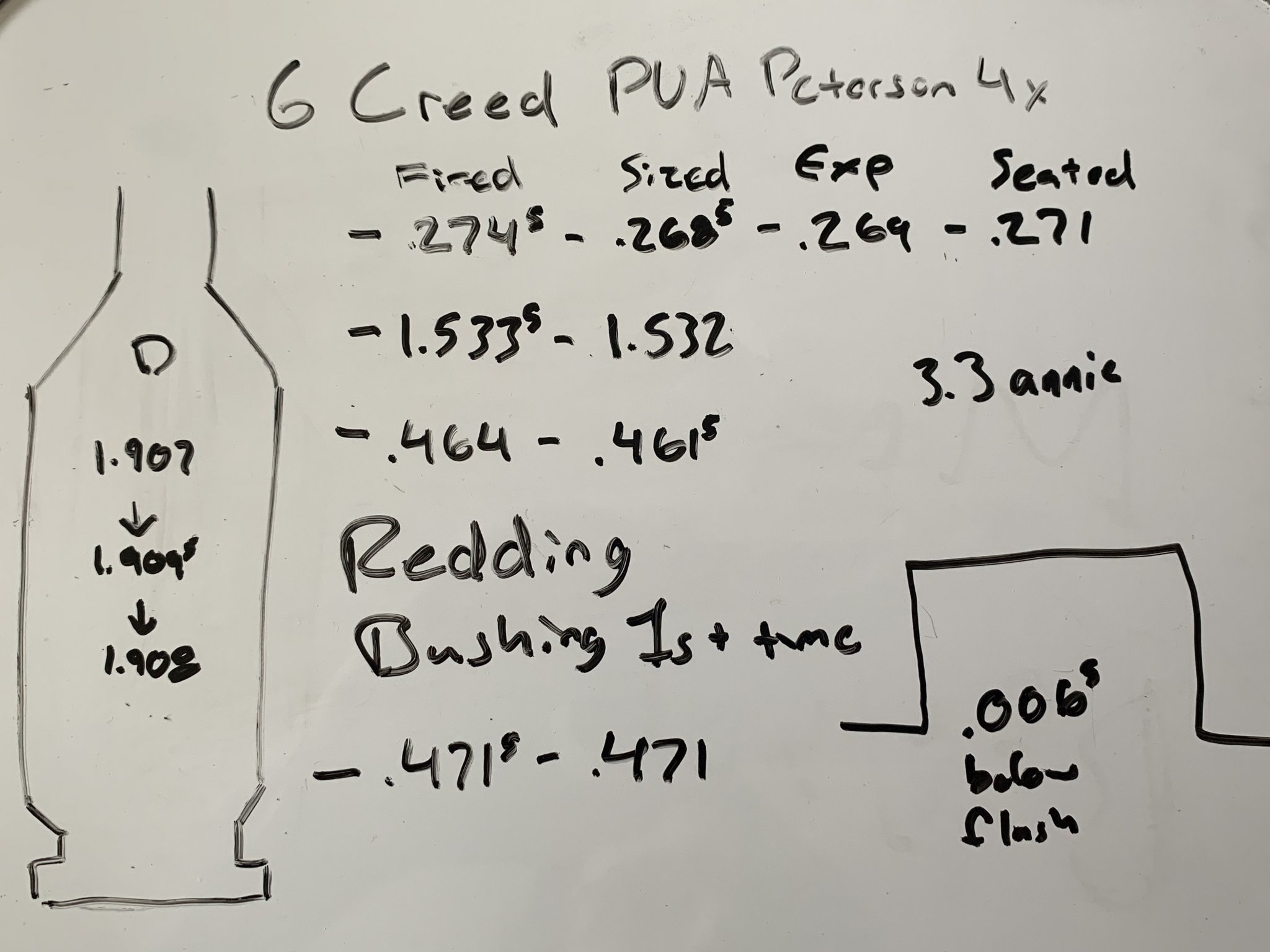

My last batch of rounds did not work out as I cannot chamber my rounds. I am about to pull all my rounds and start over.
My question is when starting over, do I decap all my primers as well? Or, can I resize my brass and proceed onward?
Pistol, rifle? How can we possibly answer if you don’t tell us anything about what you’re doing?
I’m sure it’ll be fine with primers but I wouldn’t tumble with them in, not be cause of explosions, but because of crap in primer holes. If pistol it doesn’t matter, if precision rifle I would deprime.
This time, measure and check before you proceed instead of afterwards. How is it that they aren’t chambering?
It is 6.5 Creedmoor rifle rounds.
What I am doing is pulling 200 rounds of improperly sized ammo so that I can reload the entire batch. I am going to separate every round so that I can resize all the cartridges properly and reload the batch.
I am not overly thrilled about popping out all the primers as I have no idea if that has an impact on the primer's reusability. So, I am asking if the more experienced folks, when doing a re-do, pop the primers and, after resizing, reuse the primers effectively.
You don’t have to pop out and waste all the primers. Take the decaping pin out of the die and just resize them. Good luck. It’s a pain in the ass but will work just fine.
What's funny about your 'bomb' comment is that I am too aware of that dynamic and when I build my large scale model rockets, I don't have the same fear. Despite that fact that I have to make my own igniters and the engines are considerably larger explosives.
The difference is that in one instance you're standing at a safe distance when the "bomb" goes off, and in the other it's a few inches from your eyeballs :)
I'm curious, though, as you didn't give much detail, is the brass once-fired? Virgin? If once-fired, is it from your rifle or someone else's? What brand of brass?
It's odd that brass fired through your chamber (or virgin brass), wouldn't chamber, even if not sized appropriately. I'd expect it after maybe 5-6 firings, but not one.
It is once fired. However, the answer to your question is some was fired in this my Tikka and some was fired through my Bergara. Hence this batch is to get everything on the same page (Tikka). So yes some fit okay and, most do not as it was used on the different rifle.
Since the original post, I have been doing a lot of measurements and, of my sample, I'm finding the cartridge diameter at the base (The webbing end?) while under SAAMI spec is .002 over my reference cartridge (Berger 140 gn. OTM). This seems to correspond with the 'feel' when I close the bolt. the bolt gets tight just it gets close to full forward.
I am now going to measure a few more of my loaded rounds to see if this is true for the batch as all other numbers, so far are at or under my reference round.
