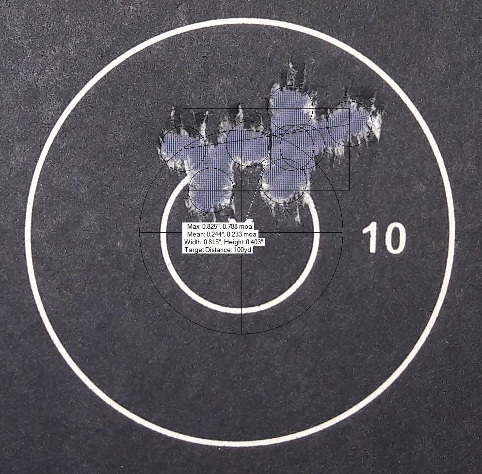

Just got back from the range and there is a remarkable difference.
Reinstalling did the trick. In regards to the lug, in this case, get the lug seated square and complete first. with no other consideration. Then, with the butt on the bench, so the barrel points up and the lug seats completely rearward, you can get the front (upper) bolt started, begin to torque down the lug spacer, and start the rear bolt. Torque the front to 25 ft/lbs. then the rear. At this point I used a level to check the chamber against the bubble level on the stock.
When all is good final torque to 60 ft/lbs.
I believe this is the new instructions except for the level check.
Today, each round went exactly where I aimed. Most of the time I watched the hole appear exactly where I placed my crosshairs at 100yds.
So to groups. Well now , I have absolutely witnessed every one of my mistakes. off the bench, I was less than .75. It is quite disheartening to see your body positioning and trigger pull go phooey in real time.
When I went prone, my preferred position, I saw everything I need to work on. But again, every bullet landed exactly where I aimed., no matter how messed up that was. On average, I was 1 MOA, but that variance is 100% me. So I'm feeling quite confident in the rifle.
Thanks you all for the input. it is all excellent expert advice that produces the exact result desired.

Follow-up:
After reseating the chassis and re-installing the scope, with a slow double checking of everything, I was able to go out today and try toe zero at 100 and practice confirming trajectories out to 296 yds. Tomorrow hopefully I can run it out to 900.
A funny thing happened on the way to 300 (Zero Mostel reference is deliberate). I had run out of the nice Prime 6.5Crd 130 ammo and figured I'll use S& B 130. I saw not expecting much from that ammo as it has been spotty in the past. Once zero, I shot the following whole collecting chrono data.
To say the least, I was pleasantly surprised and very happy. The calc to 296 yds was spot on and one shot confirmed it with aplomb. From talking to a local ballistics guy, we were able to show that the Magneto-speed chrono accounts for the shift in POI.
Thanks to the advice from you guys. It was spot on and, as a result, I am looking forward to trying out our new LR range at VGHC.
