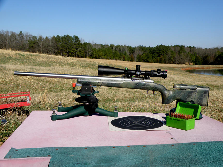

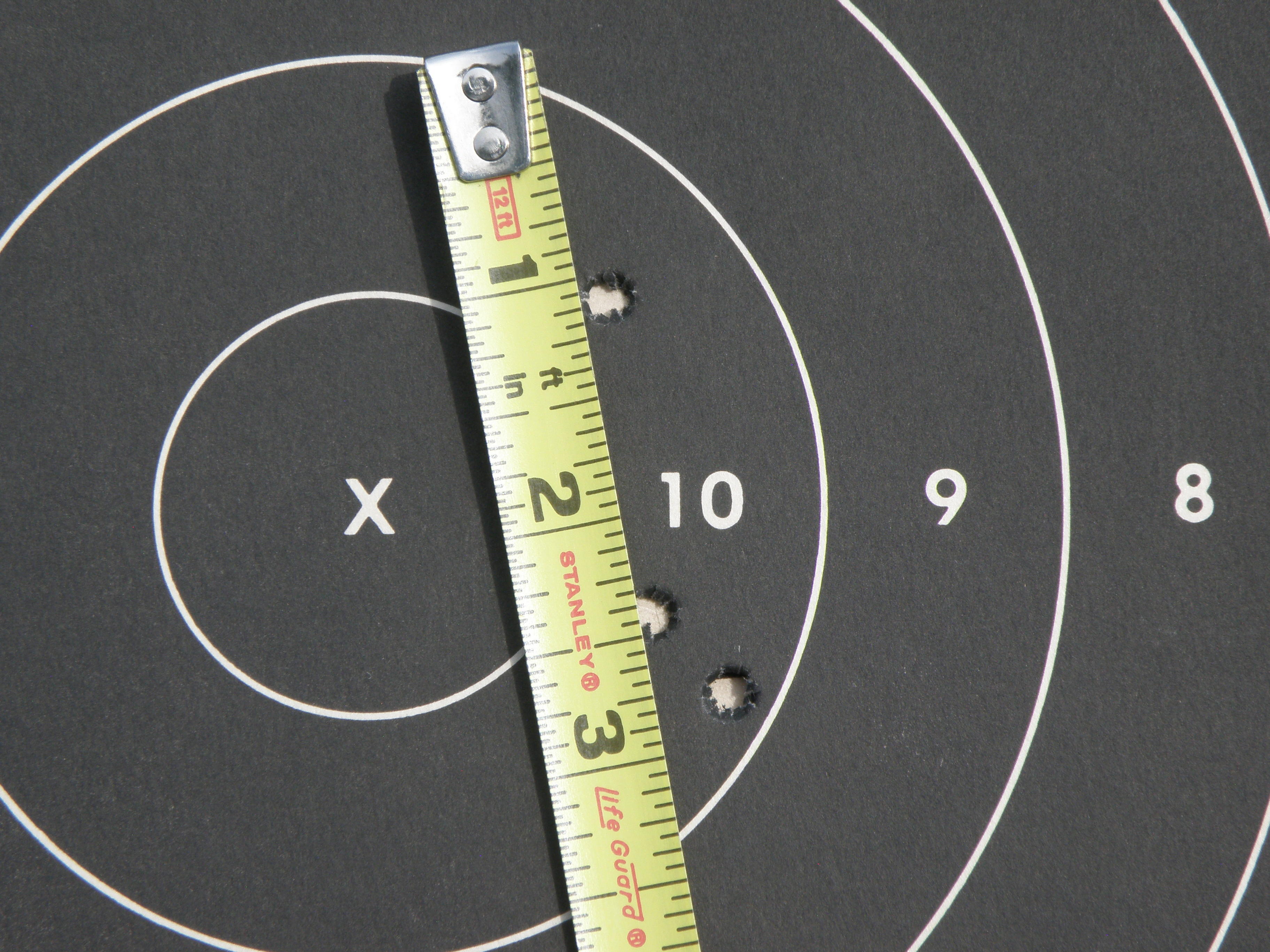

I looked for a long time to have mine built and the only builder that I never had anyone say a bad thing about was Kevin Rayhill. Home - Stockade Gun Stocks
I just asked him to build me a really good shooter for hunting antelope in Wyoming and he did. I had ordered a Brux 6mm blank and a Savage duel port target action and wanted his Tactical/ Prairie Dog Special stock. I had it chambered in 6mm Norma BR. This is what it looks like and my first 400 yd. target I shot to see if the new custom turret was (on the paper).
