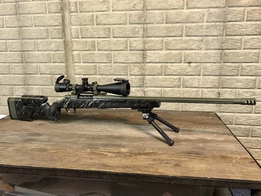

    I was making the decision about a year ago, went for 300 win mag purely for the more readily available factory ammo options. Testing out Hornady 200gr ELD precision hunter loads currently....here's my rifle...
    Part of me wishes I went 7mm Rem Mag over .300WM just for recoil alone, but man do I love the sound of a 200gr pill hitting steel at 900 yards. Either one would allow you to harvest game with confidence.
