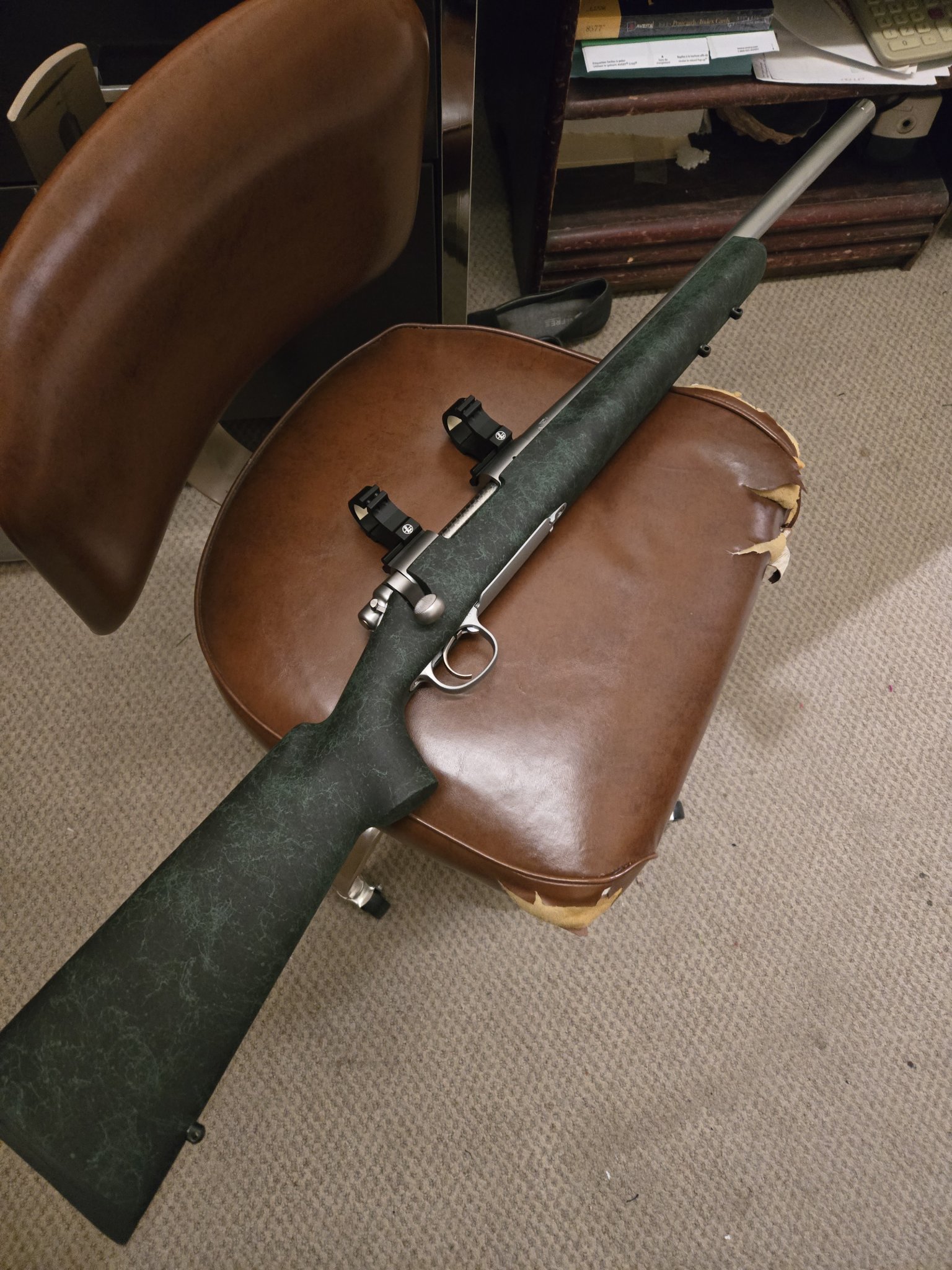

A prolific firearms collector(1000s of guns.) Of all types recently passed and I was given a chance to pick 2 firearms. Picked a Sig 716 patrol and the Rem 700 5R. I have shot it a little with a cheaper scope. Deciding on a better than good optics for it. I cleaned it down to metal since it had been shot. It is a precise rifle haveing squeezed one or two 1/2min 5shot groups out of it with hornedy 168gr match. But it's not the most consistant.
My question is how close to a legit M40(exact model?) is it? I don't think it's a world class barrel or anything haha.

I have 3 of them since 2010... A.260 Rem, .308 Win, and .300 WinMag, and the .308 Win is identical to the above rifle. They are shooters. The 5R Milspec is not based on a M40, it's based on a M24. The barrel is an actual M24 barrel that has been turned-down to a Remington Sendero/Varmint contour. Same basic HS Precision stock as the M24, except it doesn't have the adjustments in it like the M24 stock does. An M24 also has a hooded front iron sight installed, and these do not. Other than that, these rifles are treated and assembled by the same smiths as the M24's are, according to a Remington insider I talked to years ago.

The 5r rifle was just a marketing deal. There is nothing about it and the m40 that are similar except the action, and the m40 action is gone over by smiths at Quantico. The barrel on a 5r shares same rifling profile and tw of the m24, but it's not the same barrel blank or quality of blank that rem used in the custom shop on m24 builds. I can't remember all the exact parts, but 15ish yrs ago when the 5r came out, it was debunked quickly that "it uses same barrel as m24" that rumor mill on the web started. They shoot fine for a factory gun, nothing more or less. I had a 5r when it originally came out, shot ok till it got warm. The bore center was .040+ off from OD, it got swapped to a real 5r from bartlien. I had a lowly aac tac 308 rem that shot better than the 5r, after I put it in an AI chassis.

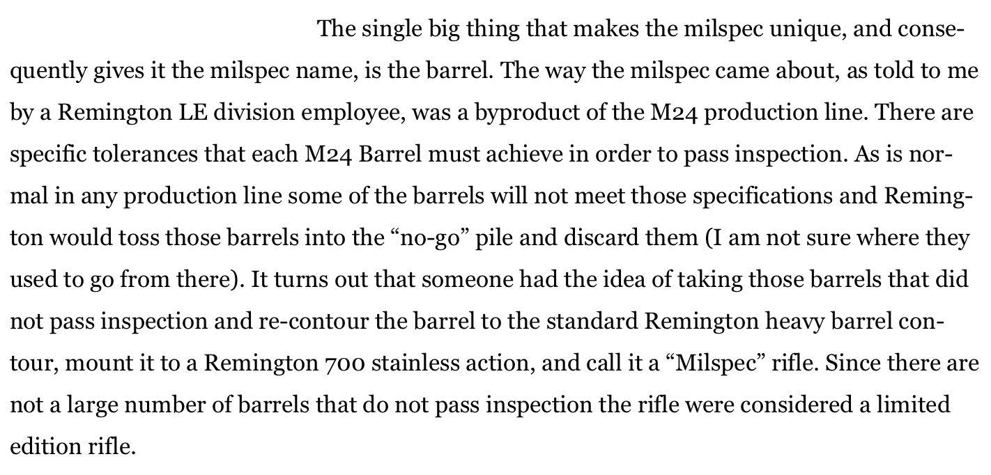

It is the same barrels and blanks as the M24, dude. All factory barrels are hit-or-miss. Your AAC might have shot better than your 5R...Luck of the draw with factory built rifles. I've had factory ADL sporter barrels that shot 3/4 MOA with handloads, and some CDL barrels that couldn't shoot 2.5" groups to save its life.
Also, "real 5R barrels" were originally built and designed by Boots Obermeyer. Eventually Remington started producing their own CHF 5R barrels for the M24's...Which is what they used in the 5R Milspec, and what they still use today in the M24 rifles.

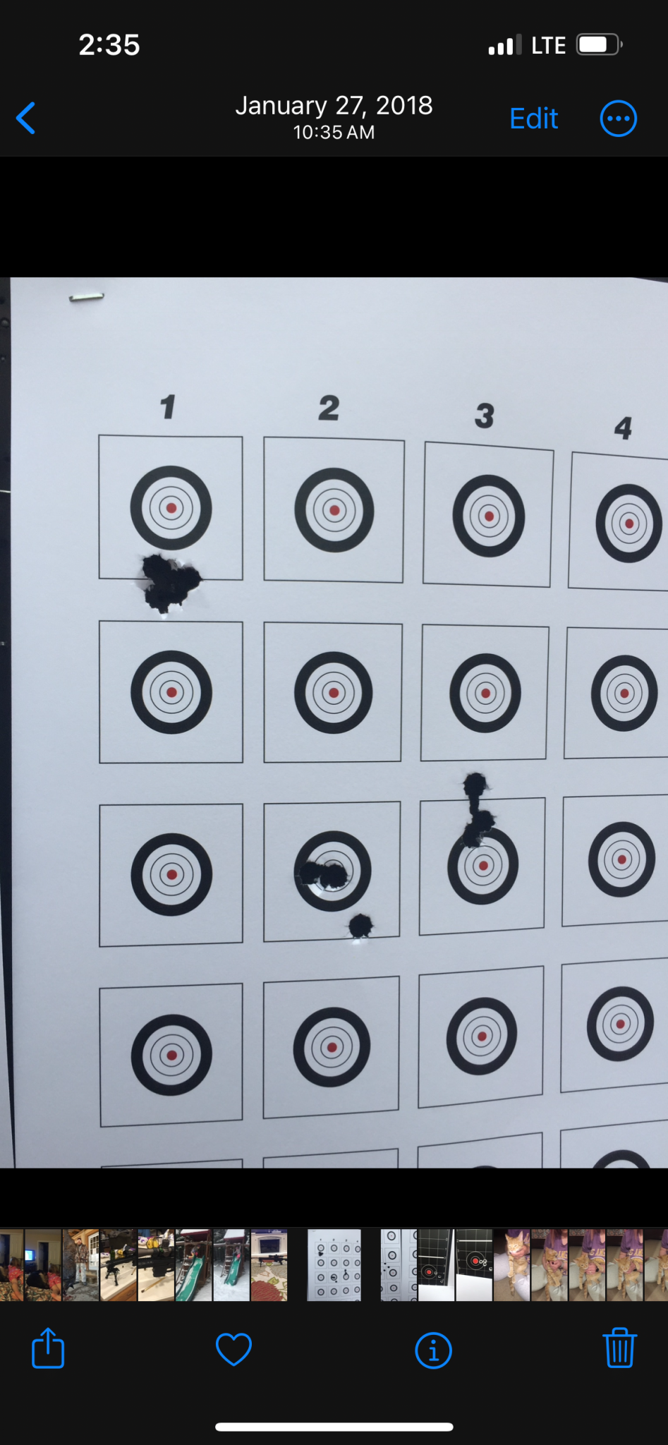

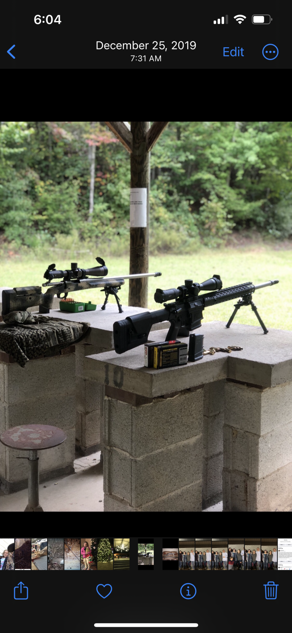

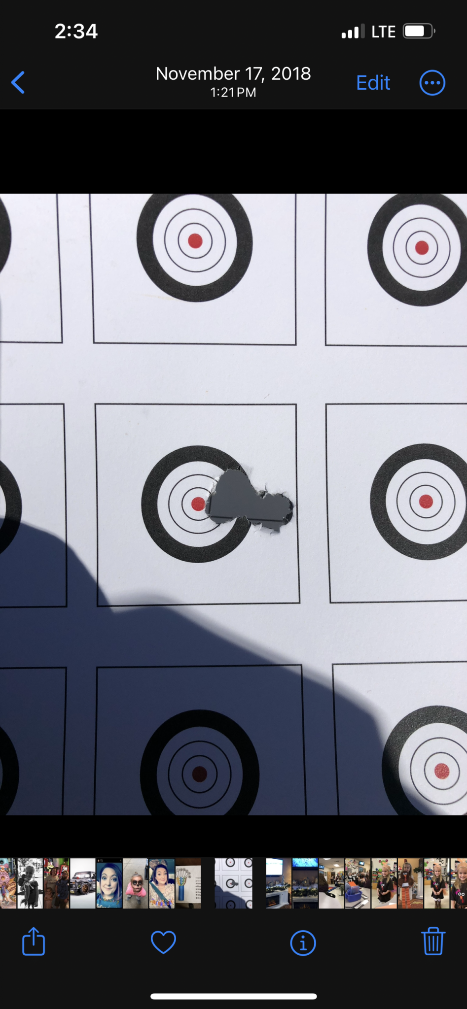

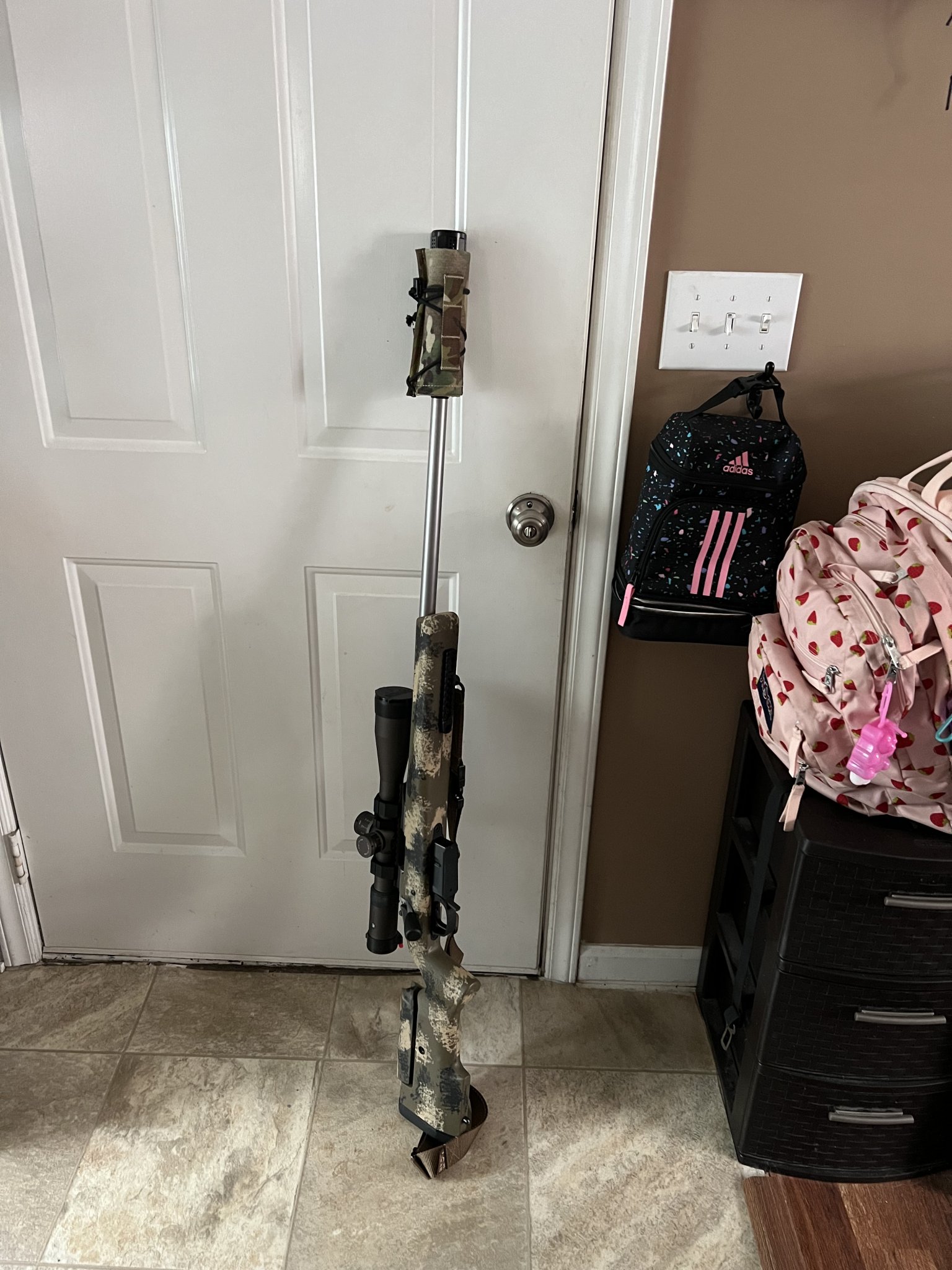

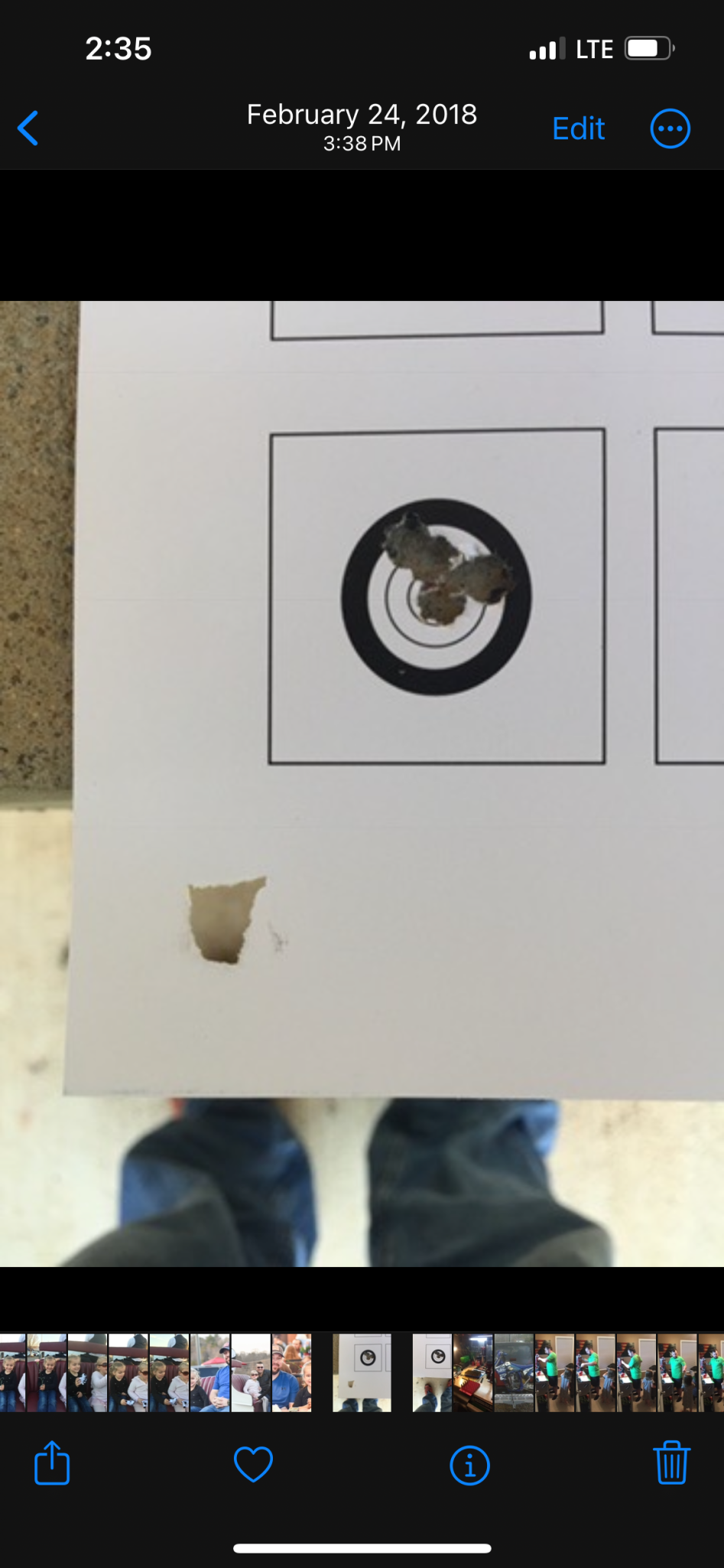

My 5r milspec has been one of my favorite guns. I will never get rid of it. It’s been stupid accurate from day one. I did put mine in a manners t4a.
