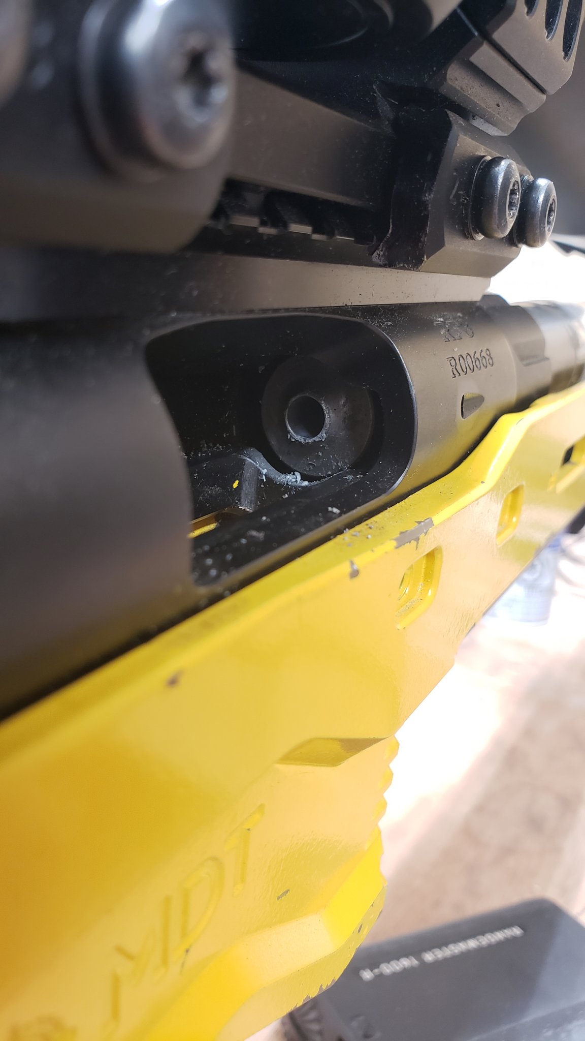

I didnt know you could do a true coned breach in a vudoo with out dryfire concerns. The RimX typically has the flat and a slight cone. I rebarreled with a true coned breach in mine now and It can cause issues with dryfire.
If I can do that with a Vudoo effectively then 🤔
I don.t believe the Vudoos came with a "Do not dry fire warning" so they probably took care of that problem with the pin stop and also some cone breach shapes don't damage as easily as others. I had a Lilja barreled Annie with a cone breach that you absolutely could not dry fire without damaging the cone! Ask me how I know?

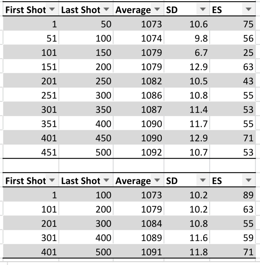

I just had similar results within my first 500 tested over the Chrony with a new barrel earlier this week with a gain of 40 ish fps. Over the next 500 or so im assuming you expect velocity to stabilize but potentially sd’s to shrink slightly?

This lot of ammo i've used quite a bit. The SD are higher in this barrel then others so far. Give it another 600 see where we are at. Its also a slightly larger headspace then I'd like at 0.046" maybe this plays a part too.
