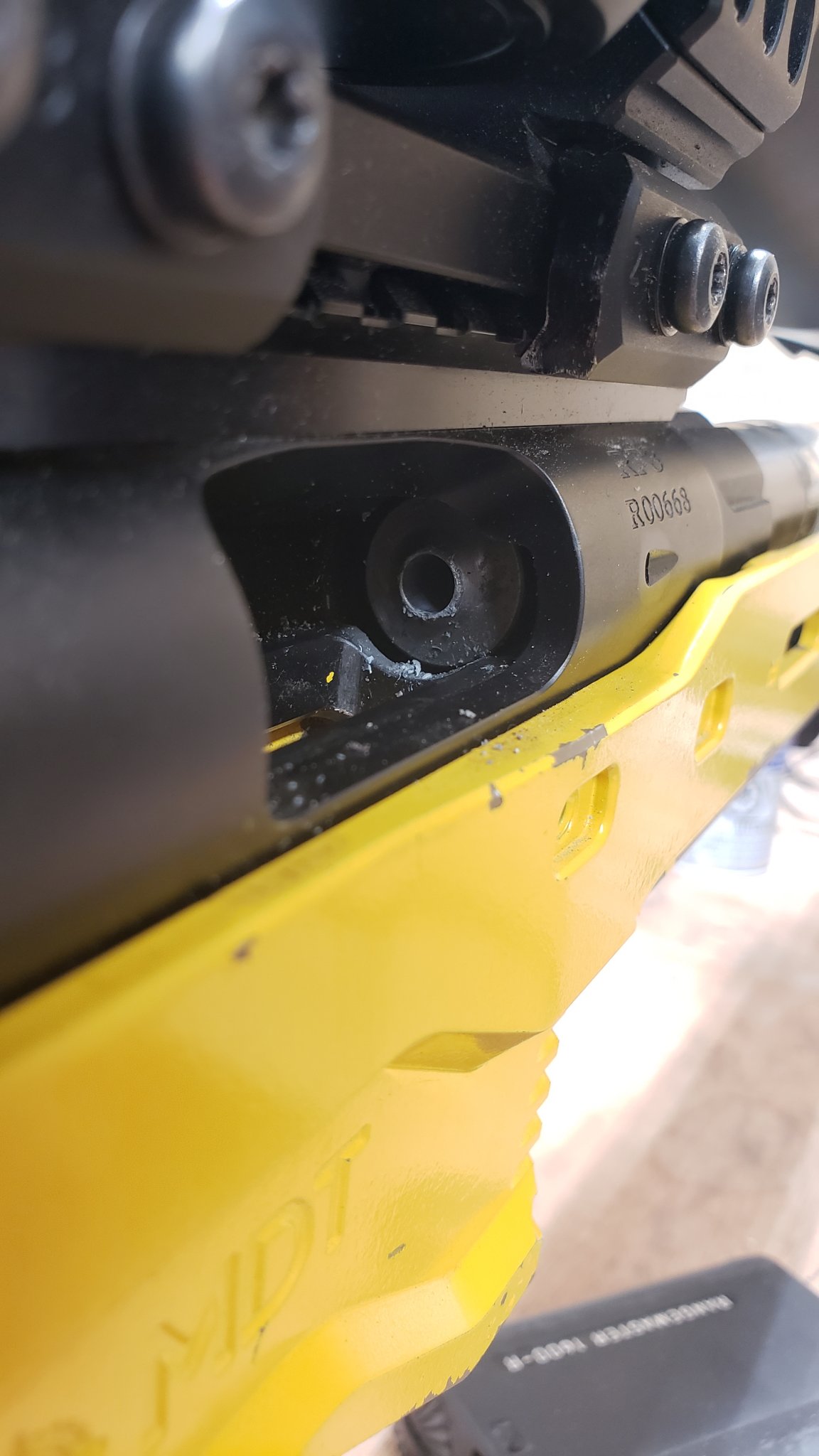

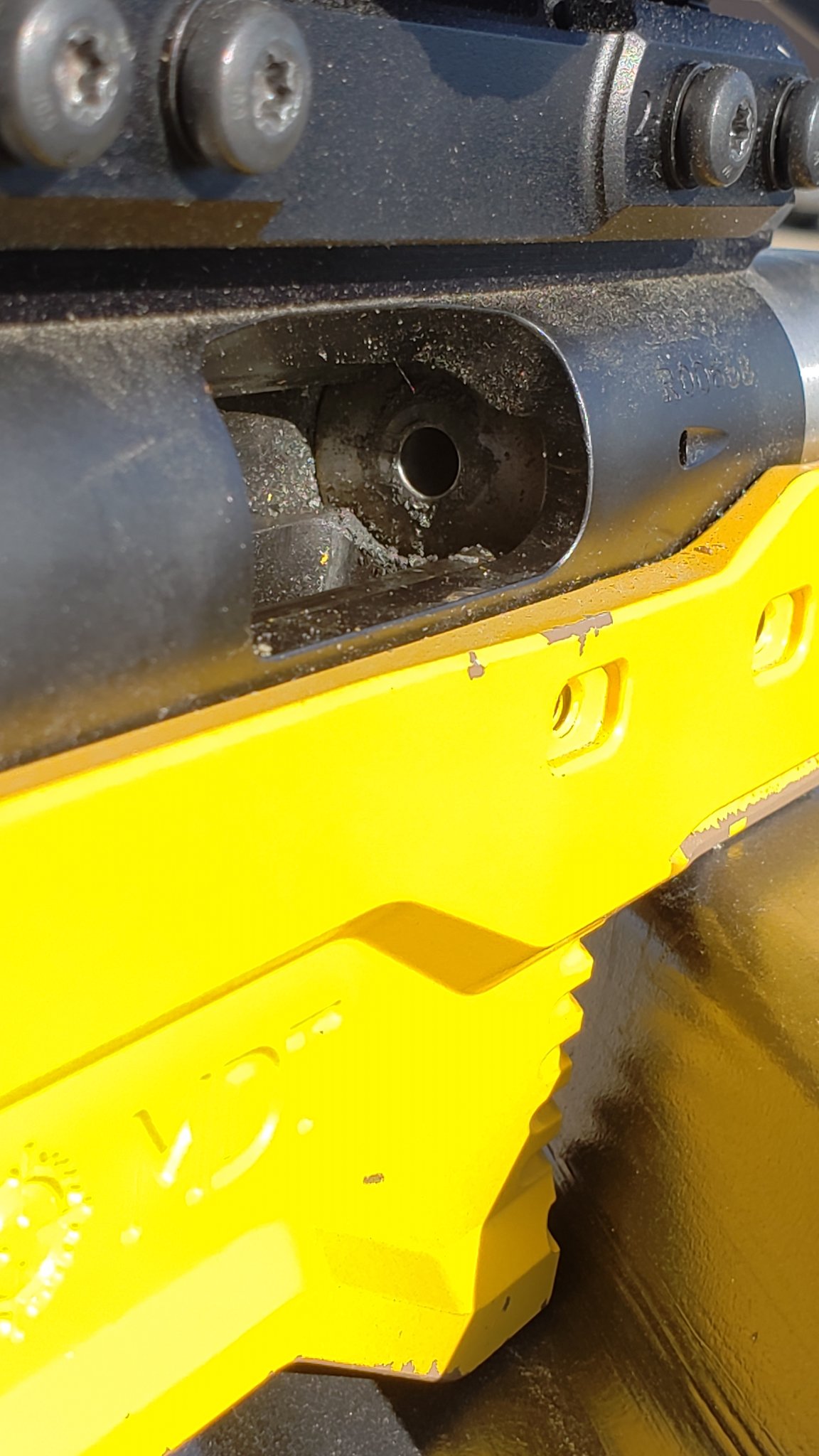

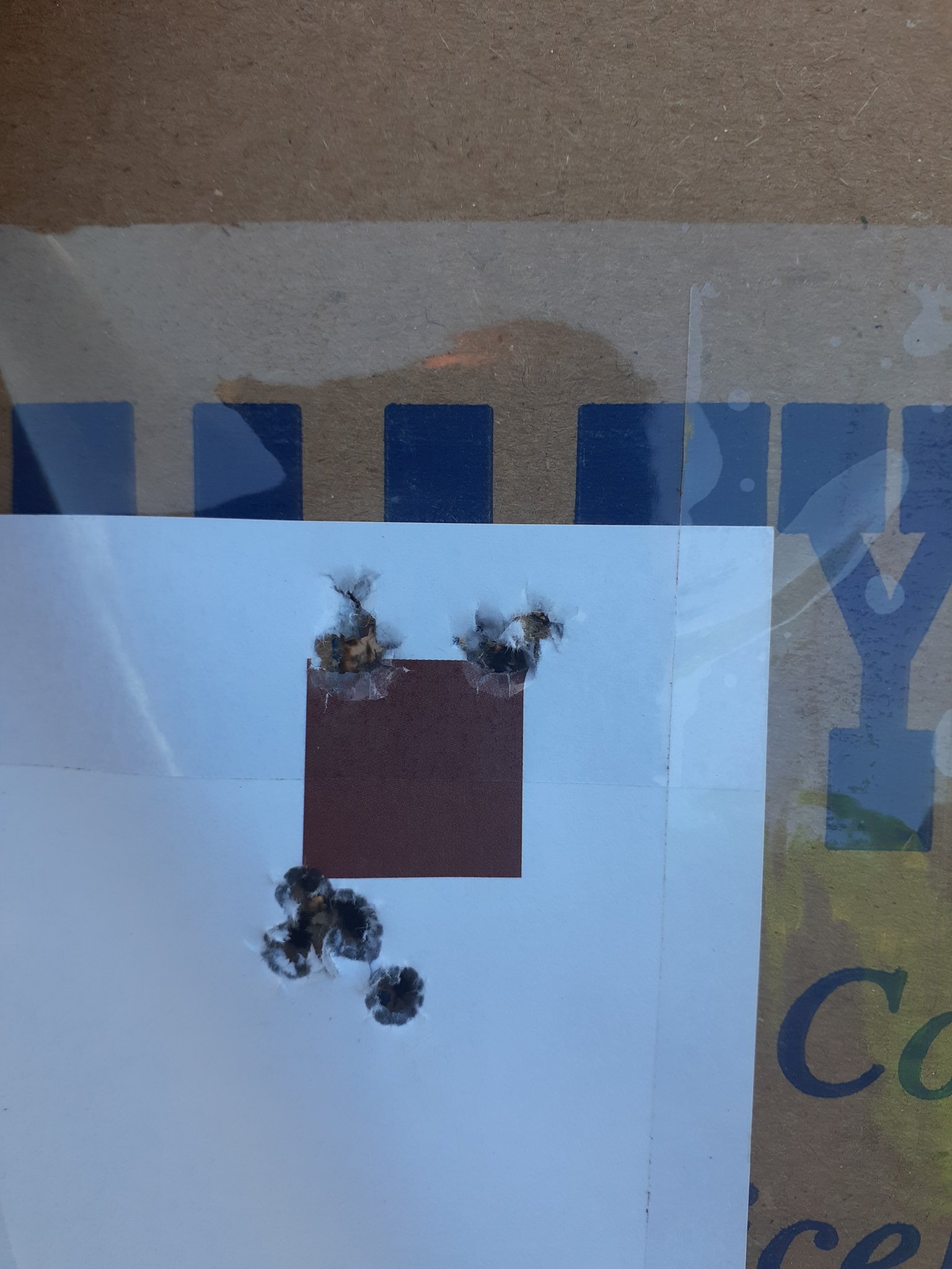

I'll jump in here for the sake of shits and giggles. My experience shooting rimfire is killing stuff and shooting prs type rimfire matches. I also utilize the rimx as a trainer as I have a 450 yard range out my back door. It is long enough to be long range with the .22 but not long enough to stretch out the centerfire stuff. My young daughters are also head over heels for the nrl22x type local matches. I have ZERO experience with paper shooting and .22lr.
We have one rimx that we share. It was purchased in July of 2020. I have not kept track, but we have gone through between 8 and 12 cases of ammo in that time. It has a Bartlein chambered by a gentleman that built his business being a good nrl shooter in centerfire and giving back to the shooting community. He asked a few basic questions and followed people's advice. I believe the barrel I have is one of the first handful of rimfire barrels he chambered. I have not had any feeding issues and the fanciest ammo I have shot through the gun is sk standard+. When it was brand spanking we shot some groups at 50 yards. They were incredible. I finally figured out how to post pics. The square is 1" and there are separate groups with the aiming points being the corners. I will also add that I am not a good group shooter. The other group was shot by my daughter at 8 years old. The round that is out of the group she said the trigger broke before she was ready. This was all with sk+. Groups were shot bipod and rear bag.
I have cleaned the gun one time, about 2k or 3k rounds in. 2 weeks ago I won a heavily advertised 1 day "cash match" and my daughter took top youth with it. In order to do so I had to hit multiple targets that were 1 moa and sometimes smaller, sometimes from wobbly positions. The gun has not been cleaned in 10s of thousands of rounds.
After winning the match I was out of that lot # and had to change. Upon zeroing, the gun was still shooting sub 3/8" at 50 yards and probably sub 1/4" if I really tried. (My shooting bench was a pallet balanced on an old hay feeder). Some lots have definitely been better than others.
I will not claim that the gun is capable of winning a benchrest match, the shooter definitely is not. However, I will say with pretty high confidence that it ain't holding me back in .22 prs type matches.
I did notice it took a couple shots for poi to settle in the one time I cleaned it, and the velocity took a box or so of ammo to stabilize.
My main purpose for having a .22 is to use as a trainer and for my kids to shoot. It is cheaper and requires less time in reloading and cleaning than centerfire. The no cleaning method works for field shooting. (I understand this is a sample of one). I will not say that it will work for every discipline, or that cleaning regularly will not work. I treat it the way I do because rimfire is my "play time."

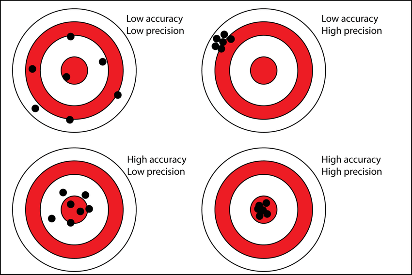

A more succinct way to say what I just said above is:
Hypothesis:
Given the same accurate/precise gun, what both camps really want is consistency. They have different accuracy/precision requirements, but it seems one may achieve acceptable consistency (different for each camp) in at least two ways:
  • cleaning frequently (sub-50 rds) or,
  • not cleaning the bore much (but cleaning the chamber when a carbon ring starts).
Whether it's BR or something else, the goal is always as much accuracy or precision as is possible under the conditions of the shooting discipline.

Your words "that only in select disciplines, less cleaning may increase accuracy/precision" suggest that the relationship between cleaning and accuracy/precision is discipline dependent.
If this is true, the rifle bore and the ammo must be aware of which shooting discipline for which they are being used.
Let’s see…I can see that my omission of the word “acceptable” might be messing you up. I had included that word earlier here (emph. added):
Hypothesis:
So, here’s a better formulated paragraph:
"The counter-intuitive hypothesis I made suggests that, if true and only in select disciplines, less cleaning may increase acceptable-per-discipline accuracy/precision."
What I’m getting at is rimfire PRS shooters do not need as accurate/precise of a rifle as a BR shooter, and if one takes into account shot strings etc there is evidence to indicate cleaning less lifts the rifle into its best accuracy/precision “zone” by keeping it there longer (much longer).
Does this modification help?
Edit: I just realized I emphasized the wrong phrase in my self-quote above. Fixed it.

It doesn’t matter if people agree or disagree with the hypothesis, but I want to make sure people understand the concept.
IMAGINE THE FOLLOWING
Pretend If:
  • Every time a rimfire rifle is thoroughly cleaned, it becomes less accurate/precise
  • It takes 1000 rds to re-attain previous groups
  • Those earlier groups were tight enough to win in a certain shooting discipline
And if that shooting discipline:
  • Has stages that require 50 rds shot in succession
  • Disallows cleaning mid-stage
  • Disallows shooting of any form between stages (to refoul the bore)
Then:
  • A shooter in said discipline should not clean between stages or even between matches unless they can shoot another 1000 rounds (carbon ring removal excepted)
  • They should wait until acceptable-per-discipline accuracy/precision degrades before cleaning (unless they can’t help themselves lol)
It may be that the accuracy/precision of a rimfire rifle with 1000 rds down the pipe is not good enough to win in BR, but is good enough to win in PRS, and that cleaning frequently in PRS leds to lots of fliers because shooters can’t refoul the bore to acceptable standards in the time that they have.
And: acceptable accuracy/precision are RELATIVE (not absolute) concepts here. Relative to certain shooting disciplines.

I have a Lilja 16 twist tightbore that I shot a lot of F-Class practice with at the Olympic Training Center.
I would fire 10-15 shots to get warmed up and get the clean bore dirty. Then I would shoot 60 shots for record. Things stayed tight and steady with zero fliers for two matches.
Like clockwork around the 125-150 round mark I would start getting fliers that were way off call. With the lighting there and my scope zoomed into about 50 power (S&B 12-50) I could watch every bullet go into the rubber of the electronic target.
I tried to just skip cleaning but the fliers never went away.
Clean it and suddenly I was good.
My Vudoos with Ace, Bartlien and Shilen barrels dont do it nearly as bad as this Lilja. But cleaning doesent take more than a few minutes and it keeps things consistent. So why wait for things to go to shit.
