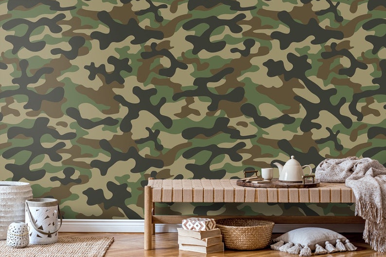

who don't love that cammo look
in the bathroom it makes a lot of sense when you miss the can no one will see it ... lol ship lap looks sort of good or wood paneling for that almost a log cabin feel .
