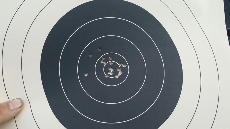

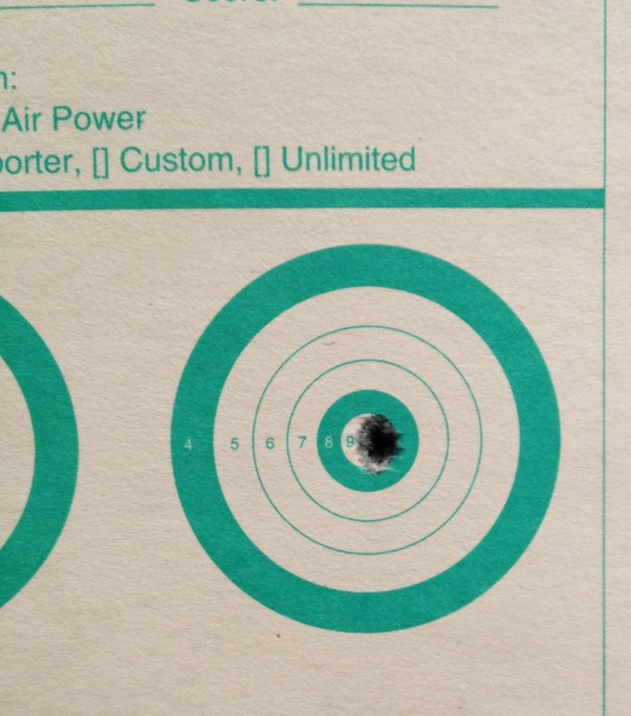

If you do not see a benefit to cleaning the bbl, your rig is not accurate enough for PRS or to notice. You will be able to measure it in a precision rifle from a bench on a dead calm day. I used to not clean them as well until I owned a truly accurate 22lr.. A precision rimfire will begin to degrade after 200+ rds depending on the bbl. Clean them after each outing and then reseason with 20rds. Use high quality cleaning rod and clean from breach end only.
i literally shot this from supported prone at 100 a week or so ago...... MOOOOOORE than accurate for PRS. 27674.jpeg
reason for the 3 fliers......my buttstock was a 2x4
over 1K down the pipe.......i mean, if you want to clean, then by all means........if you do it properly its not gonna cause any issues...........personally i feel its not worth the effort.

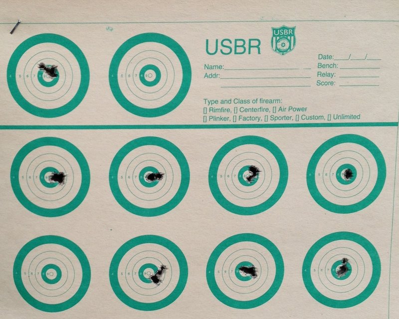

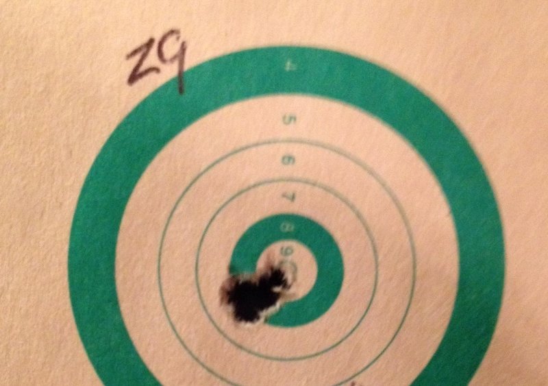

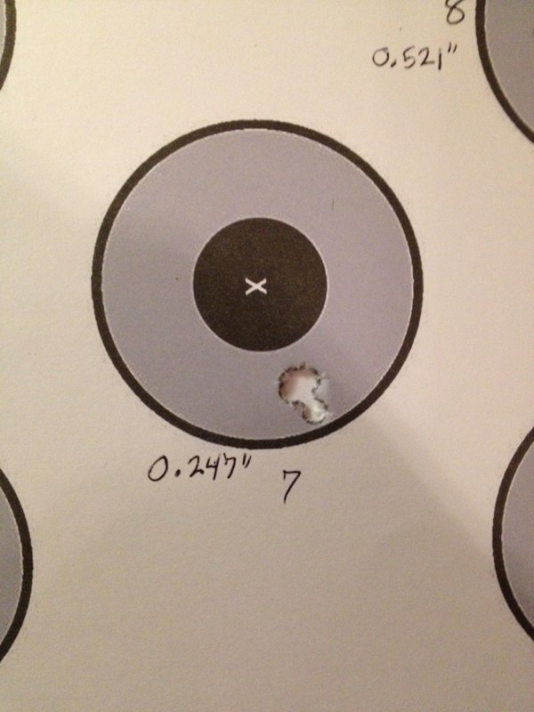

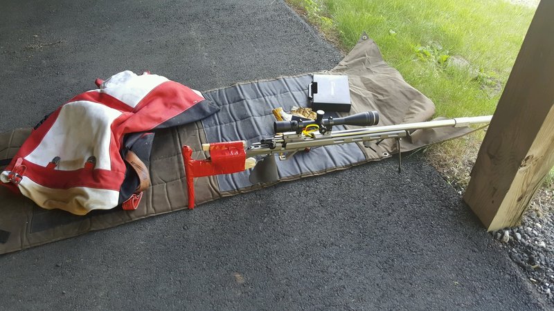

Attached are a couple of old pics of 5sh groups at 50y and 100y with one of my old Remingtons. It is true that it is a single shot and the scope is a 36x and is completely NOT the set up for rimfire PRS but it does highlight what can be accomplished shooting from a supported prone or bench position with good ammo and a precision 22lr rifle. I will freely admit that the more typical 100y group with this rifle is closer to 1/2" but it did shoot the group in the pic and is surprisingly accurate even when using that old Lapua CX ammo.
The last two pics were from an old Anschutz rifle topped with a 20x Unertl at 50y. Each group was 5sh including the sighters in the upper left of the tgt. For whatever reason that particular rifle has never been quite as good at 100y but still will ave <1"
