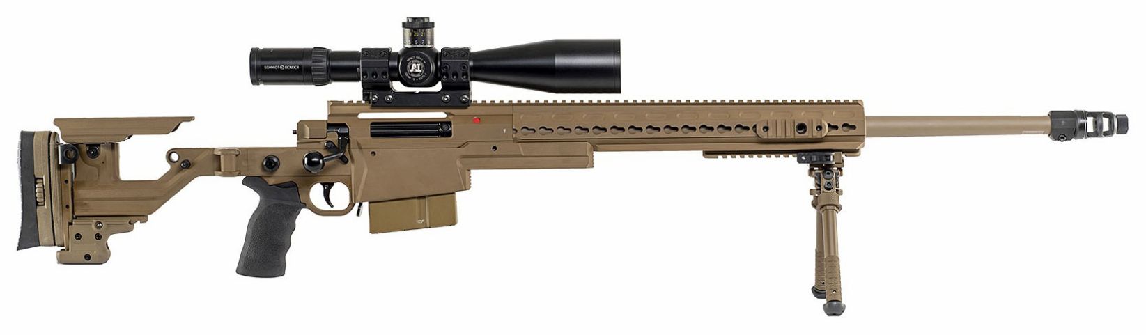

You seen the aw Mkiii pics yet?
Reactions: BCX

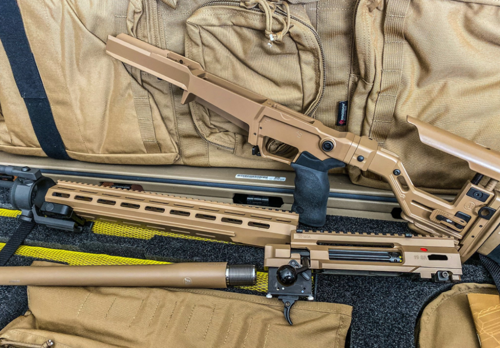

Yes, I've seen them. I looked over the ASR at SHOT Show last month.
The new generation is a completely different design architecture than the current gen. My assumption is the new generation of short action (AT?, AX? AC? lololol...no idea) would follow the same design.
- Non bonded chassis to action interface
- Non bonded buttstock
- 5 action screws; 4 in front, 1 in rear (current is 2 in front, 2 in rear)
- Similar design with 2 vertical bolts to attach trigger pack, but ASR trigger is not interchangeable with AT/AX
- Since the chassis isn't bonded, they can incorporate the AR grip tang (rotated backwards 10°)

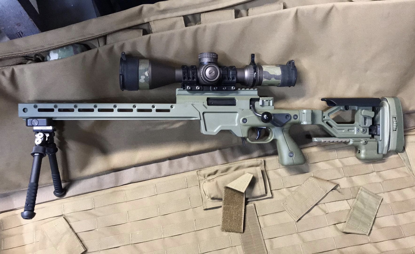

This was a picture from @NoLegs24 's ASR

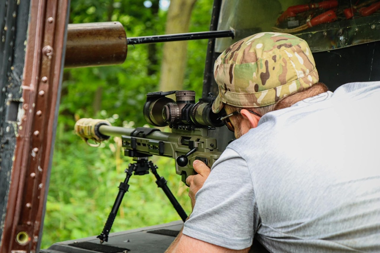

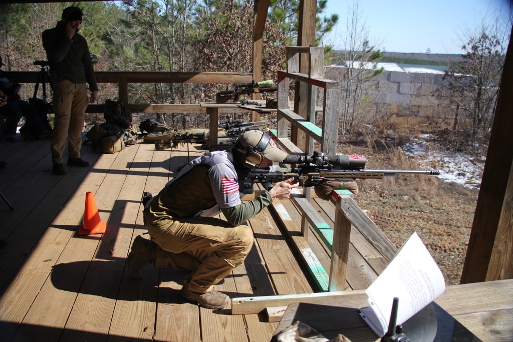

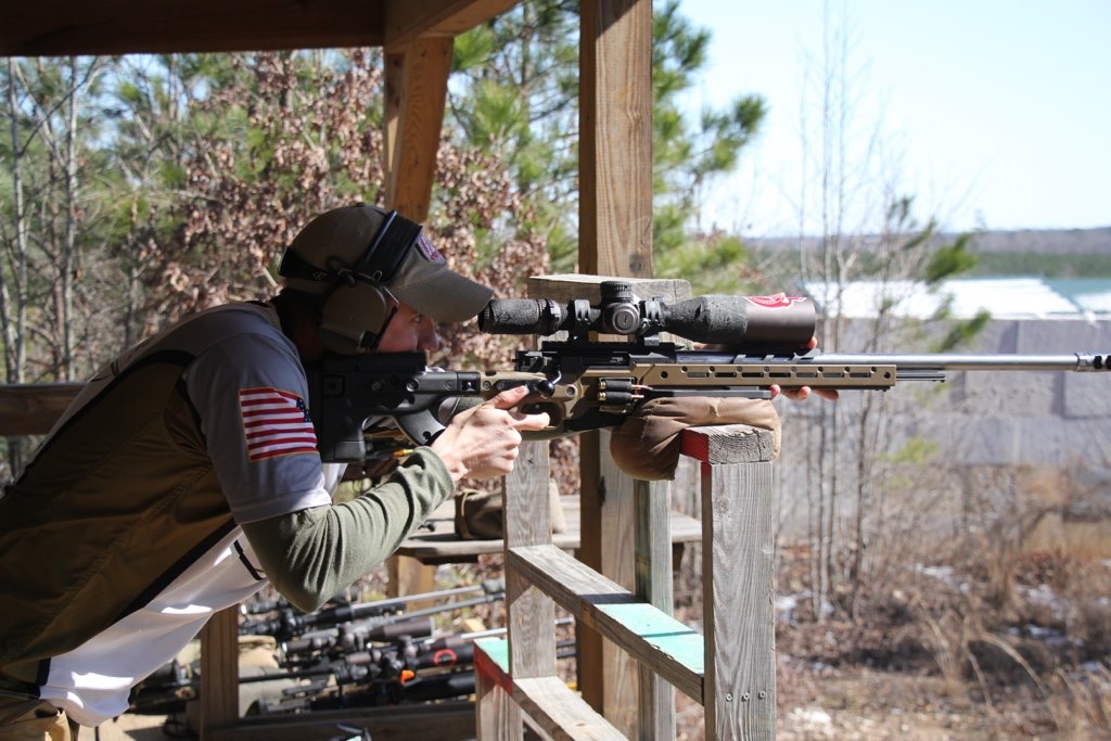

@BLKWLFK9 doing work on a barricade stage at the Frontline Fury PRS match. If you haven’t checked it out yet, go to Podbean and check out his podcast “Just Fn Sent It” for some great commentary and insight into precision rifle shooting and other topics. I’m planning on doing an interview at some point to discuss all things AI and match shooting.
Nice !! Buying that but stock hurts . Is it just me or did those go up in price The AX but stock conversion is what has kept me from getting one of The ao chassis I’ll probably still end up with one just dragging my feet

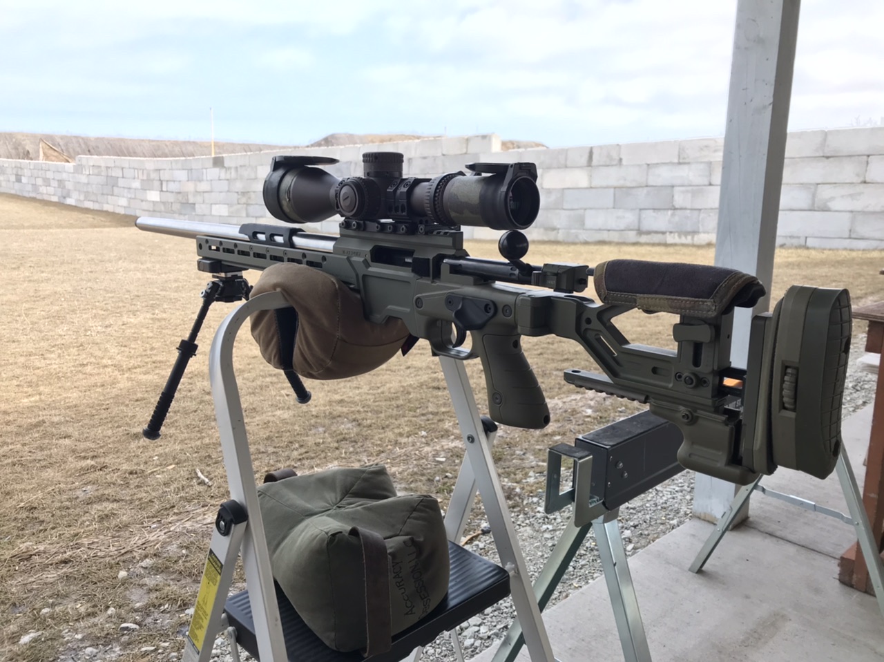

The setup I have now is from a debonded factory AX, so I used that buttstock. I don't know if they've gone up in price though. EuroOptic is about $100 cheaper than Mile High, but that's because Mile High has the installation price built in. If you tell them you're doing it yourself, they'll discount the price.
I hear you on it being expensive though...honestly, the AT buttstock will do just about everything the AX buttstock does. I don't think the chassis will be any worse off with the AT back end, plus if down the road you still want to upgrade it's a small task to de-bond the buttstock and put the AX back end on.
