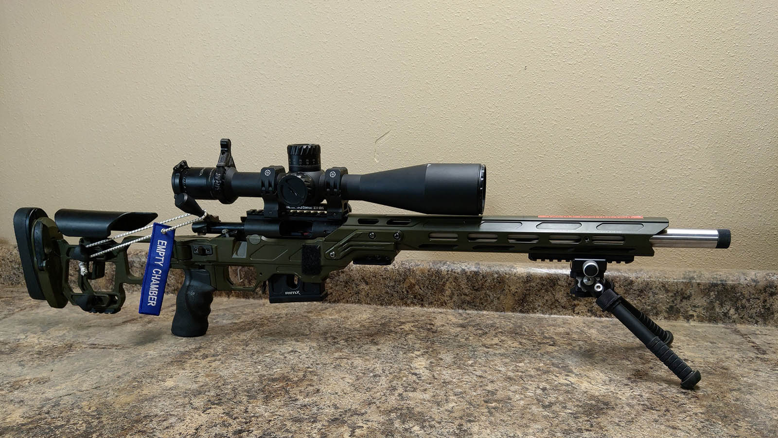

    I have the crusader f1 in mil with the extreme reticle its on my GA precision hospitaller with the ai ax chasis v2 action and 29in bartlein 338 lapua and i love it the 40mm tube is great the glass is super clear and clean made repeated shots out to a mile hitting an 18in steel plate. Made me get the patriot which is also super clean and bright. The only funny thing is that when you hit right you turn your windage right not left i was told thats how the European scopes work. Reticles are accurate and precise. Mine have been i only can attest to my scopes. Check out darn fine shot you can get the same scope for cheaper val isnt the only game in town.
    Matt

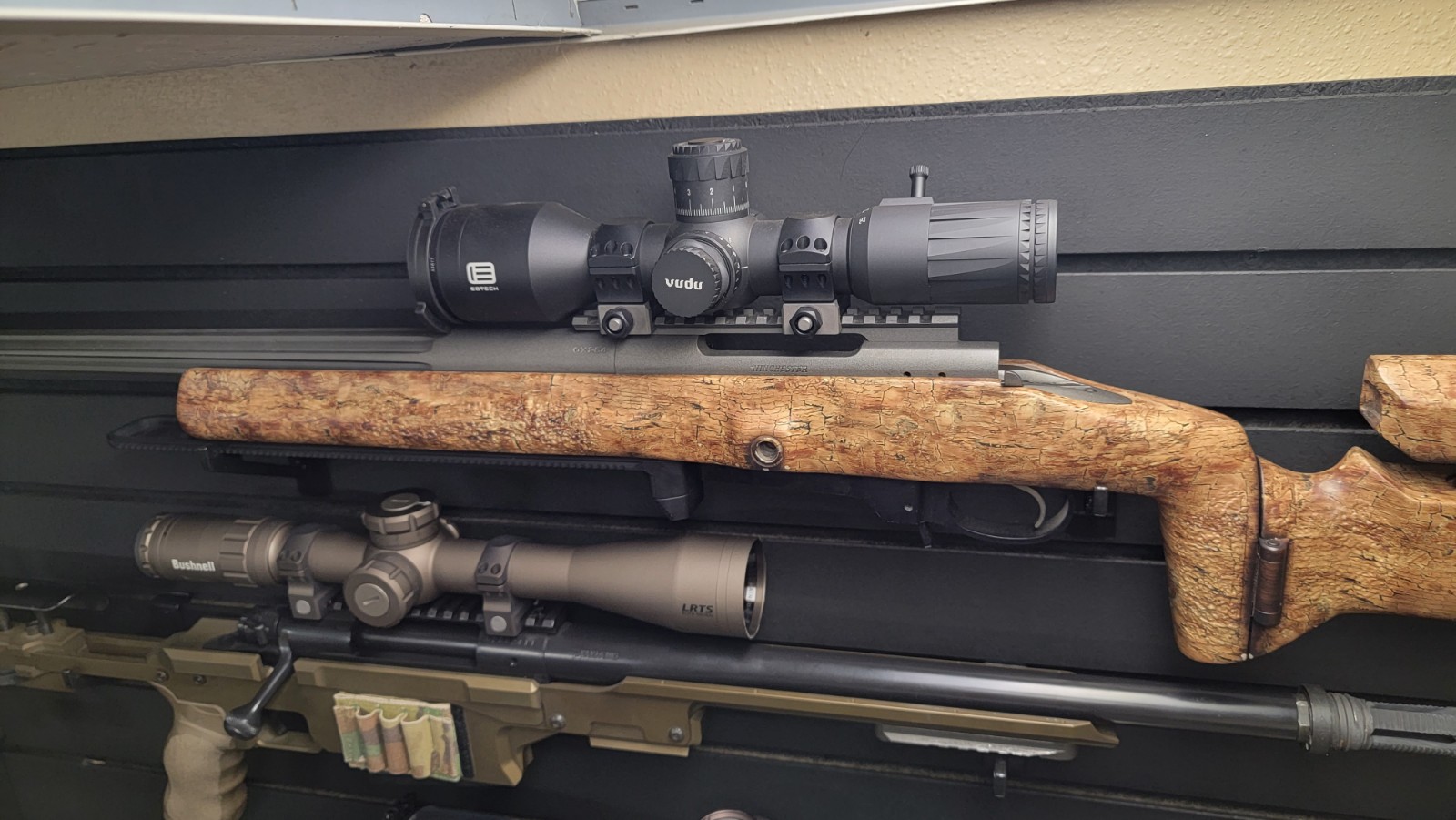

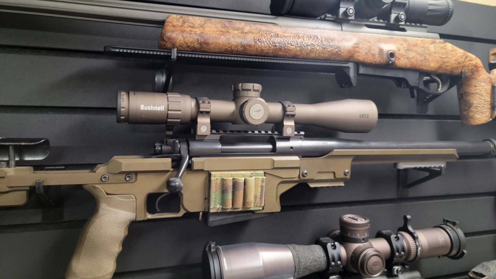

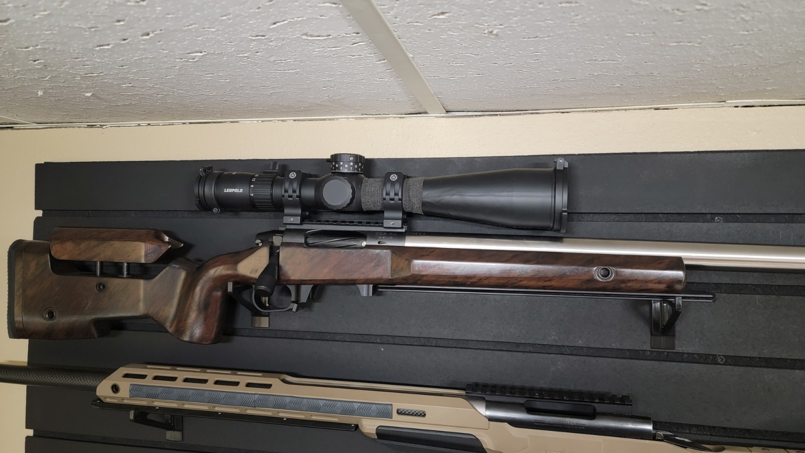

    Well, since this seems to be a concern here, whenever this comes up. Here's my "shill" card...for whatever it's worth.
    Here's what I currently have on the shelf. And most of them are on the shelf, because I wanted to try something that was different than what I currently had. Generally speaking, I don't feel the need to validate my opinion, but work has been slow, and I've been meaning to take some pictures anyway.
    March 5-42 High Master and Gen2 Razor with the EBR-7C
    5-25 Vudu with H59 and Bushy LRTS
    Gen3 Razor with EBR-7D and Mk5 7-35 with H59
    and the TT Gen3XR before I sold it. Had high hopes for the Gen3XR Fine...but hard to justify $1000 price bump for the floating dot to be the only difference.

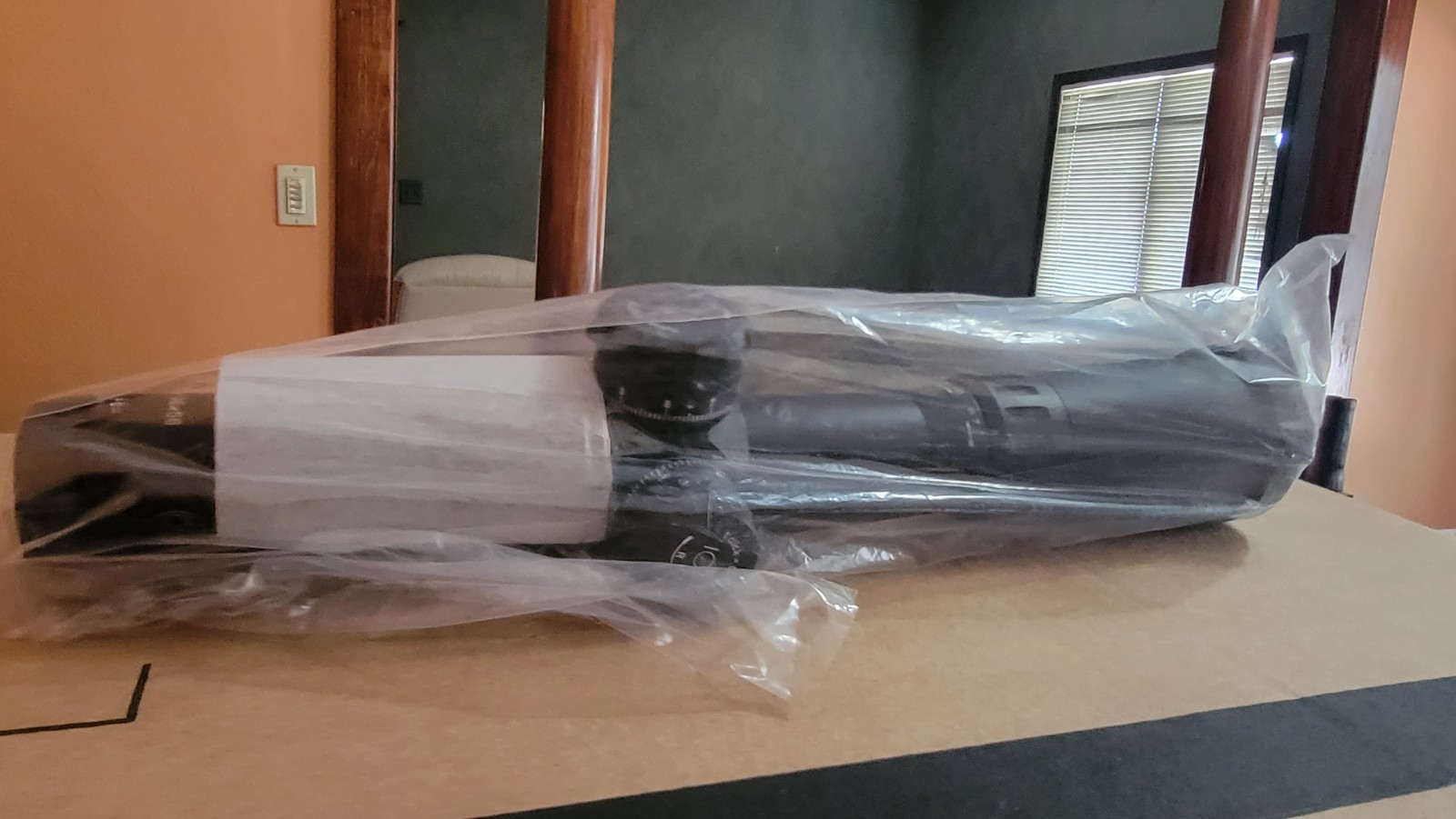

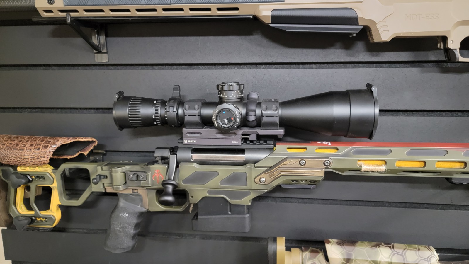

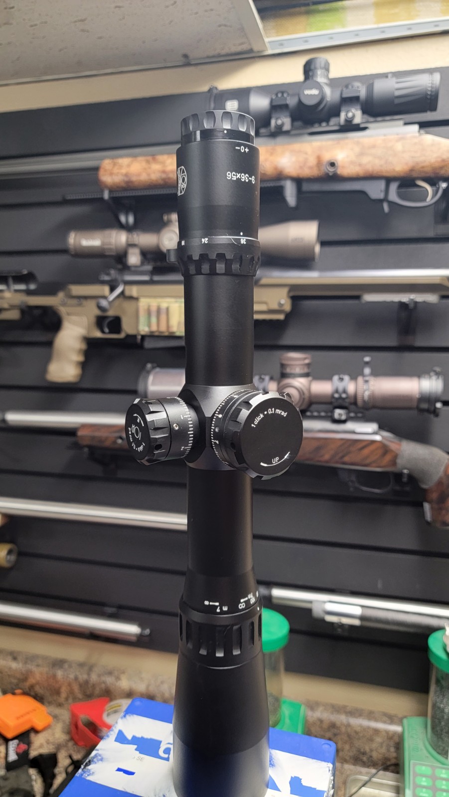

    This is NOT by any means, an in-depth review of any kind. It's more of a general, first impression to evaluate things I would like, things I could learn to live, things I could deal with, and things I didn't like.
    I was initially suspicious when I could feel the weight of the optic inside the factory IOR box shift fore and aft and when I opened the box, I could see why.
    It's rare, albeit unheard of, to have a scope over $1000 to not have some level of foam insert to prevent shifting. This did not.
    The caps secured the front and back and surely prevent damage, but the optic itself is simply wrapped in bubble wrap and the included 40mm rings are just hanging out on the end. The ocular end has an extra piece of bubble wrap on the tube and the shade is wrapped in paper, and slid over it. Presumably to reduce the size of the box needed to package everything.
    A deal breaker? No...but we're not off to a good start.

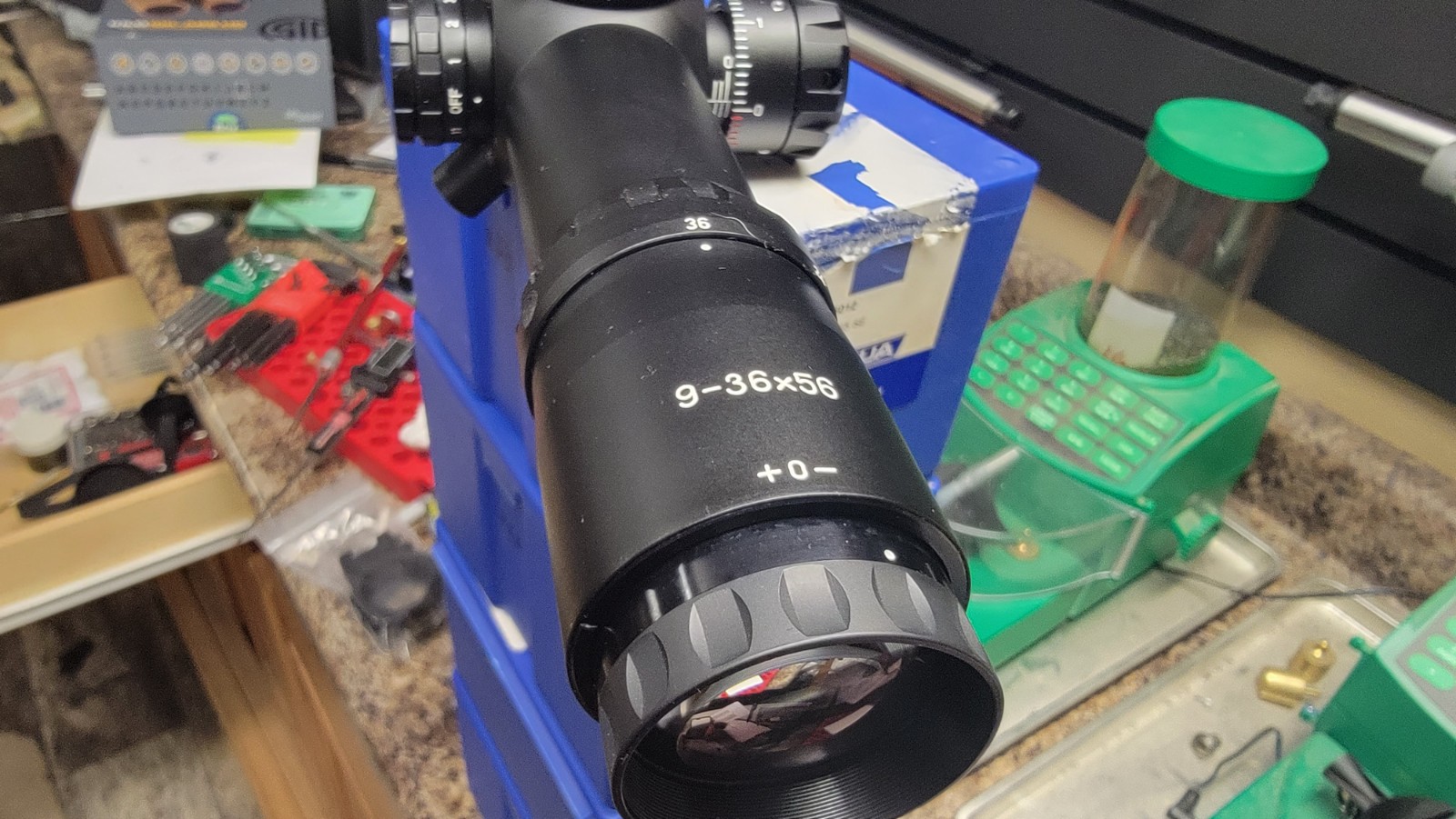

    Included for the "manual" were these three pages that include the break down of scope specs, directions on how to use the optic and the MIL Reticle...which, on the zoomed in portion, you can't read. A fourth for warranty registration and transfers was not photographed.
    A deal breaker? Still no, but not ideal.

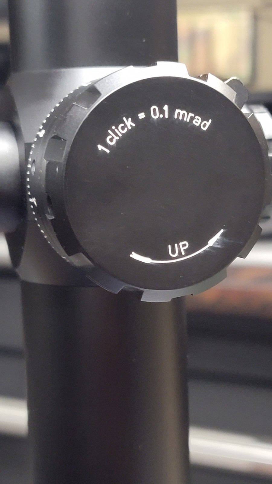

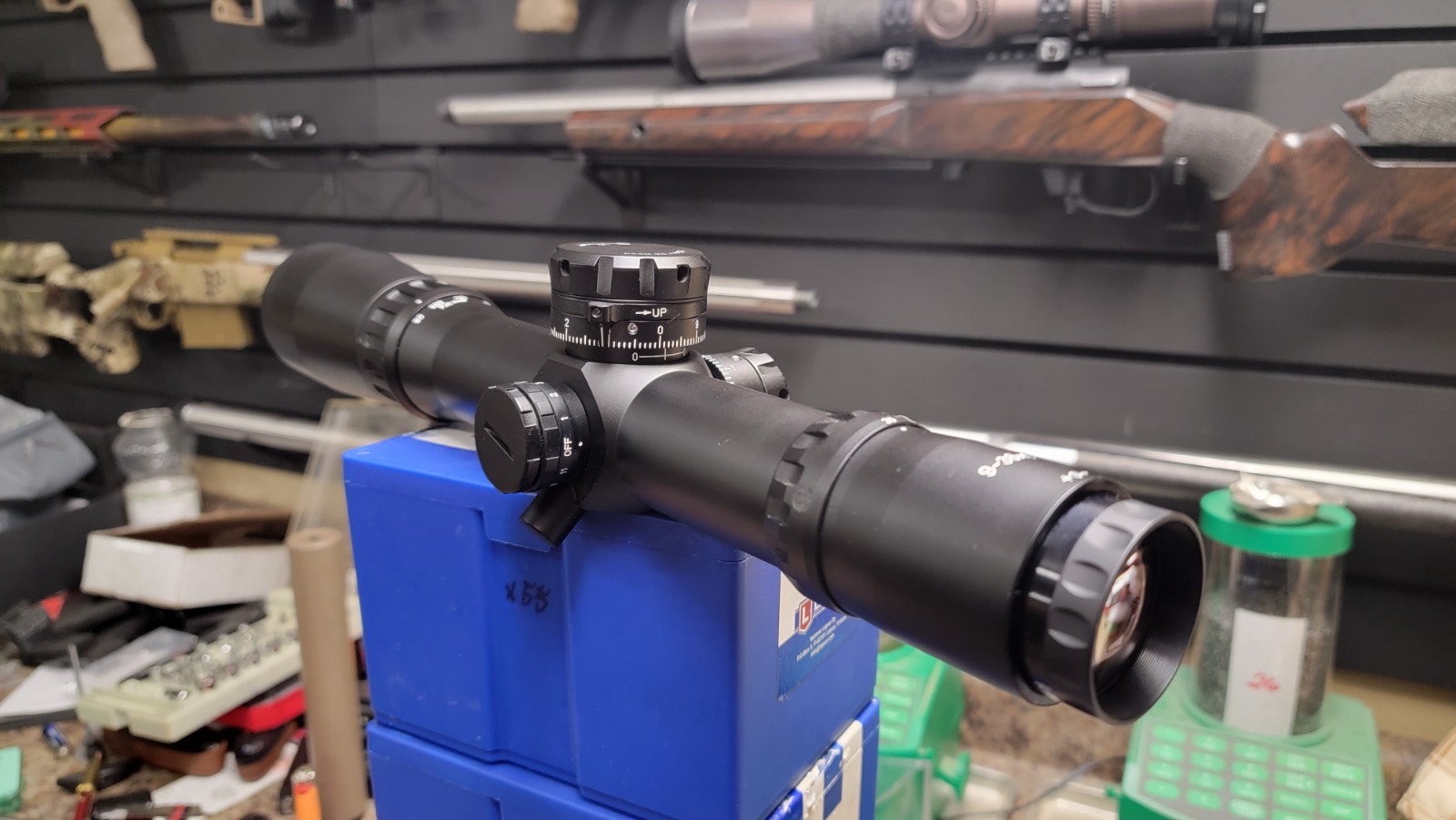

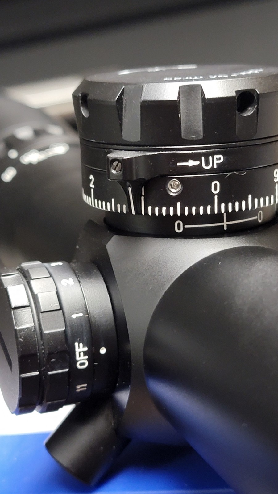

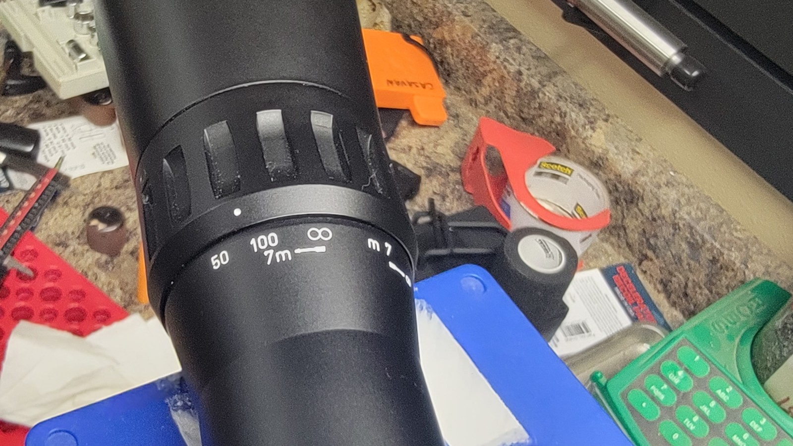

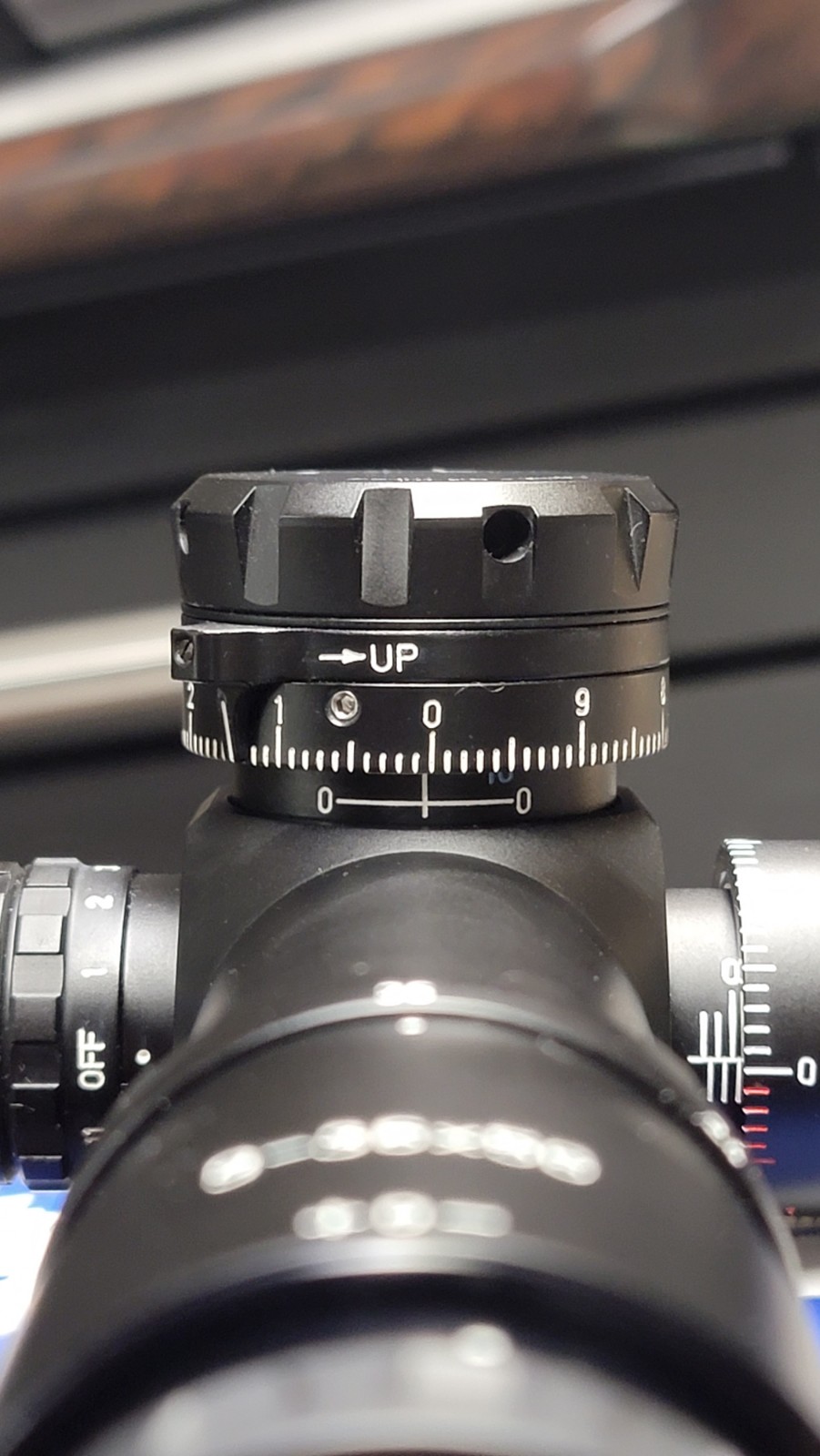

    First impressions are fairly good. Turret has good clicks, but they are not locking, and they turn very very easy. Too easy IMO, for not locking.
    The good impression of the elevation turret is lost by the windage turret. It's bad. Feels like it's made by a completely different company. Soft, mushy and not distinct at all.
    Fast focus eye piece does what it's suppose to, but again, it turns very easy, and doesn't lock. If I were to attach scope caps, that may prevent them from getting bumped...maybe.
    Illumination is the only feature on the left side, and while I didn't check it for daylight brightness...I'd doubt it. Again, not a deal breaker.
    I feel like the majority of high end optic companies that include illumination, have an "off" setting between each of the 11 power settings. This does not.

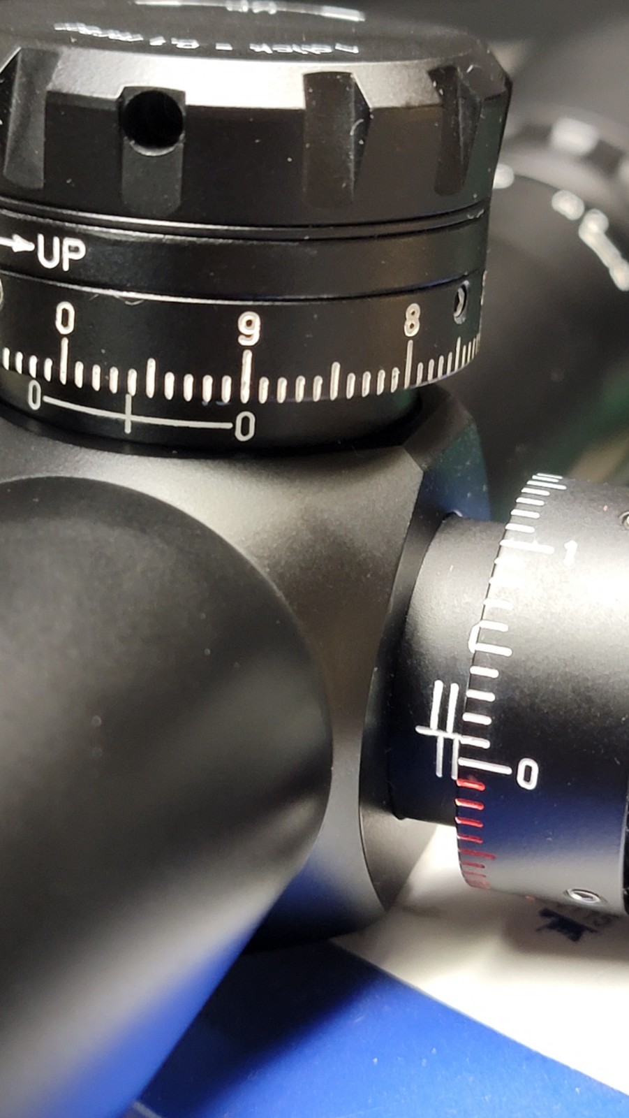

    One major factor that I feel eliminates this from being truly useful in PRS style shooting is the parallax. It works VERY well where it is, and I have heard reports that having it forward on the objective helps with brightness and clarity but it's difficult to reach when your behind the rifle.
    Interestingly, there are only about 10°-15° of rotation needed for 100m to infinity, so putting a cat tail up front and on the left side might actually make this work well in centerfire...
    BUT the benefit of being able to parallax down to 7m is lost by needing to rotate 300°+ from 7-50m which makes it virtually useless in NRL22. It's just too difficult to manipulate on the clock.

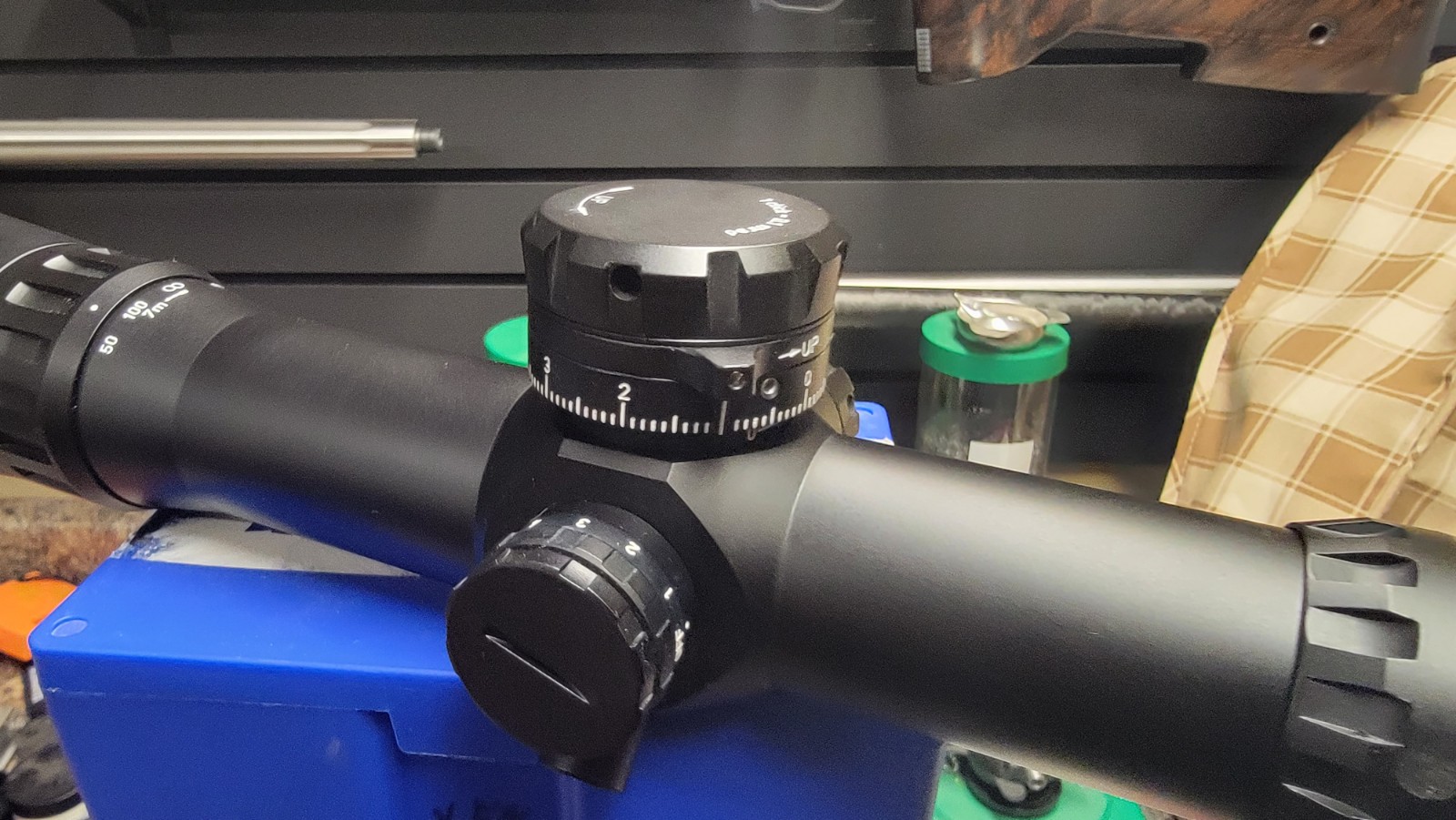

    Setting the Zero and Zero Stop is simple enough. Very similar to the old Leupold Mk6 where the ring itself is free to spin. Downside is that it still takes 3 screws to loosen in order to freely rotate the bottom ring.
    ALSO, as you can see, the paint in the elevation turret was smeared, presumably at the factory when the engraving was done, and it was never fixed.
    The secondary point of impact indicator is an interesting idea that would benifit from using the same 1.5m key that the zero and zero stop set screws use. The flat screw that it currently has is just a dumb choice. Ideally, especially for PRS style shooting...a locking throw lever that could be flipped to release, and closed to engage the secondary point would have been ideal.
    Example on a PRS stage where you need 2.3 mil for target one, and 5.1 mil for target 2 doesn't make much sense to dig out a separate tool to set when it would be different 20 minutes later at stage 2....but if it was on a quick set throw lever. It could be set on the fly.
    I don't remember if the zero was between the hashes when I took it out of the box, I don't think it was. I am fairly sure that after I zeroed it, i just didn't have it perfectly lined up when I locked the ring down.

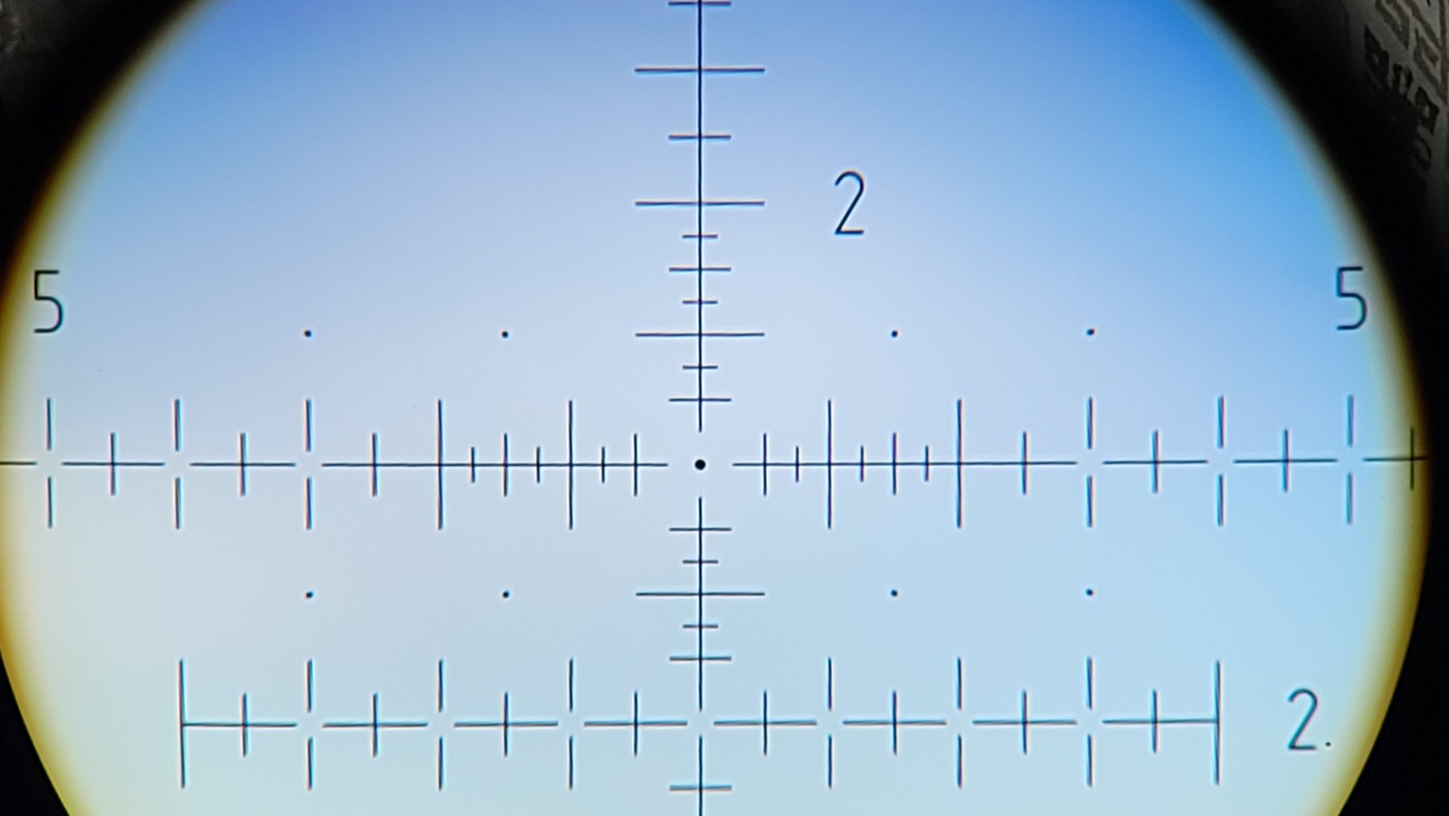

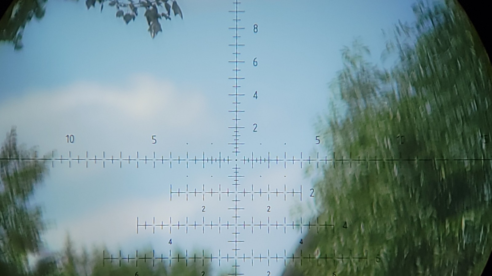

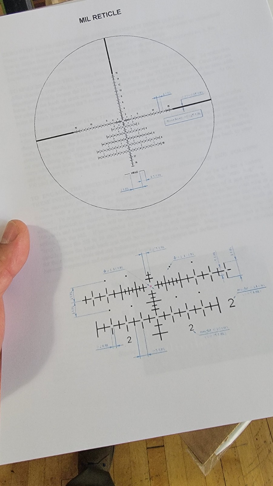

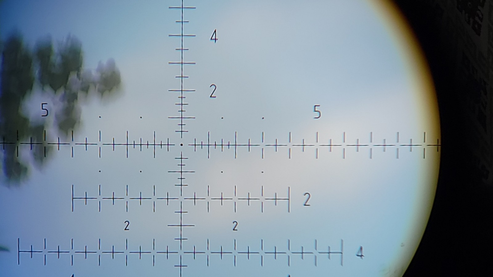

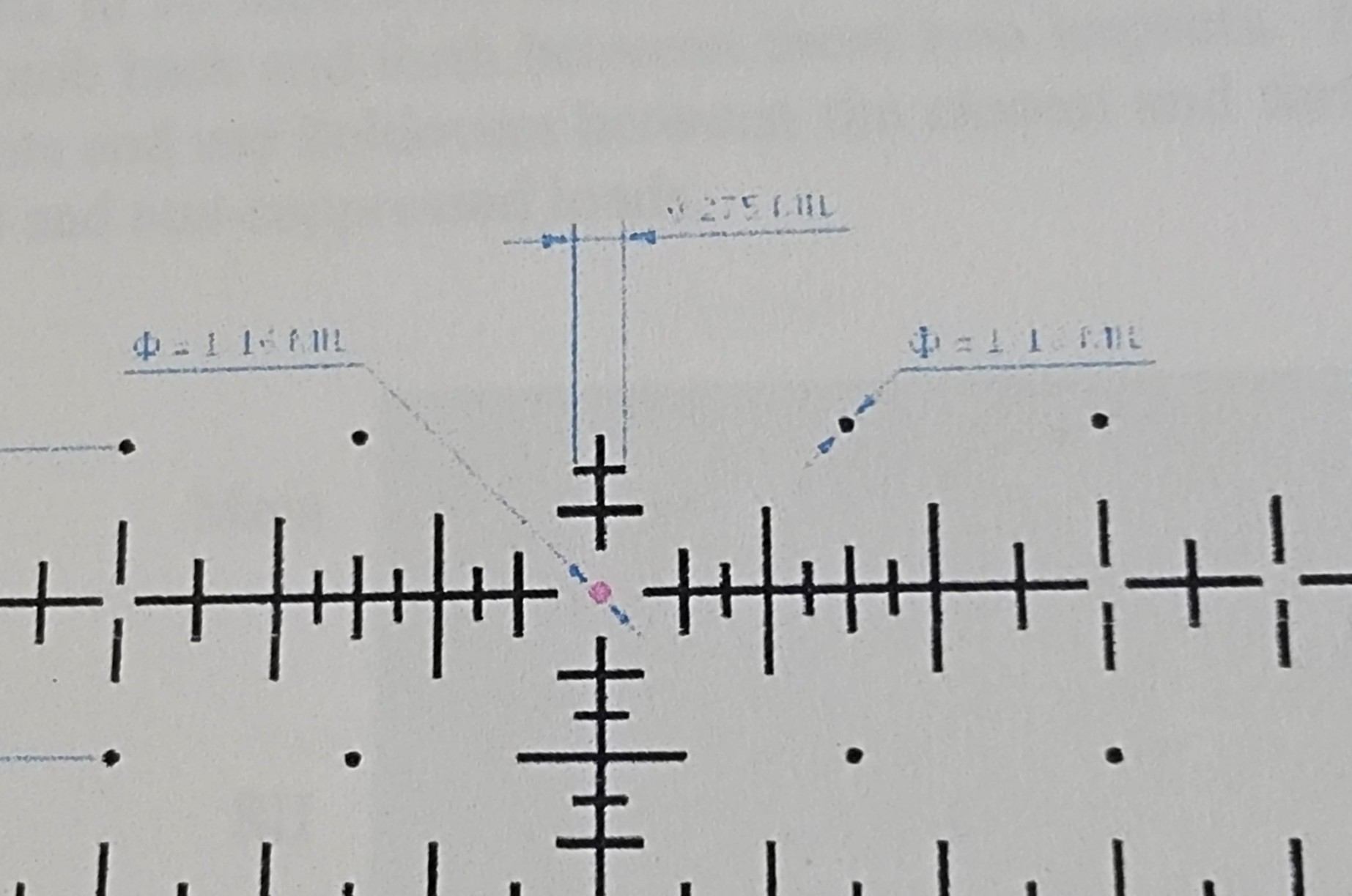

    Andy lastly...the reticle. The reason for the post.
    Is it usable? Yes.
    The hash marks are a little longer than I'm used to (1 Mil, 1/2 Mil and 1/4 Mil from what I can tell), but at least they are not overly heavy. I really have no idea how thick the lines are. I can't find any information on them.
    The floating center dot appears to be 0.1 Mil which is WAY to big IMO. It's still usable but the additional dots at 1.5 and 3 mil on the windage are better....but I don't have any idea what they are either.
    They are listed on the picture but I can't read them.
    Does it have elements that are good? Yes.
    The additional floating dots are much more refined, and the opened space on the main cross bar help to provide references while opening up the spacing...allowing it to appear less cluttered. It has far less information than most christmas tree reticles, which is a pro and a con...depending on whos looking. If you've never used one...and find something like the H59 or Tremor to be overwhelming...then this may be better for you. It's not for me.
    Is it useful for what I need it for?
    No.
    For a little over 10 years now, I've been using a mil hash, christmas tree that is based on a .2 mil system. In fact, I'm not really aware of any others that are not.
    My brain instinctively looks at this and snaps to assume the floating dots are at .5 mil, which clearly they are not.
    Additionally, when my brain assumes the dots are at .5 mil...it also assumes the 2 mil hash is actually 1 mil and the dot is just in the wrong place. I think it's 2 fold. Partially because I'm used to seeing hashes at .2 and used to seeing dots at .5
    Weird, but that's the way my brain reads it. Again, I think if you were a NEW shooter, with NOT EXPERIENCE using .2 mil grid systems...this may work for you.
    Is it usable? Yes.
    No.

    This MP8 Extreme X1 appears to be their pinnacle...but the image associated with it is poor at best when you compare it to the full detail and actual vector display provided by most manufacturers like Nightforce with their MilXT
    Anyone care to voice their opinions? I've even gone as far as to contact Valdada and request photos through the optic to get an actual representation of the reticle, but was denied.
    I'm to the point where I'm actually designing (finalizing) my own reticle. (i was a designer in college) Since they build them to order anyway...I'm wondering if they would even entertain a custom for me.
    Apparently they have a GAP reticle as well...(not even listed on their link of available reticles) but the jpeg they use to showcase it is washed out and hard to read.
    The Nightforce Mil-XT for comparison. All reticle details are well displayed on the website...as anyone would expect from a premier manufacturer like NF.
    Image with no description
    C-Bass I don't know if you have pulled the trigger on this scope or not but they have updated alot of things. For example Midway USA and Optics Planet have old adjustment values of 1/4 moa clicks when they are all 1/8 moa clicks now. The reticle is thinner than the old scopes and really pop when you get the ocular adjustment dialed in. I purchased their 10x60 model i can go on about subtle differences that i think beat some of the other brands mentioned. If you want to know more message me. Every now and then i goto Rapid City to shoot the 1,600 yd range. Are you around there?
    You must not have noticed the post I made a few up the page, showing what I bought, the likes, and overwhelming dislikes.
    To be honest, there wasn't really much positive. 😕

    So I just finish the tracking test with my valada g2 mini 35 mils of travel. On my collimator it's in moa.i ran 114.moa converted to mil 33.1 mils. it was 1/10. Tracking error thats really really good.
    I do alot of testing for optics companys behind the scenes. F.y.i. valada dropped ior. Now it's just valada the g2 and g2 mini are made at lightworks in Japan. Also use promo code. AZZATO.
    to save alot of money.
    The g2 40mm. Is his gen-2. & is much better then the gen one. People should not look down at valada. Things happen in companys and val dropped ior. Since he did the scopes are way WAY BETTER.
