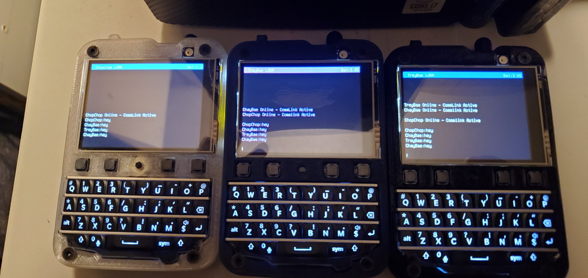

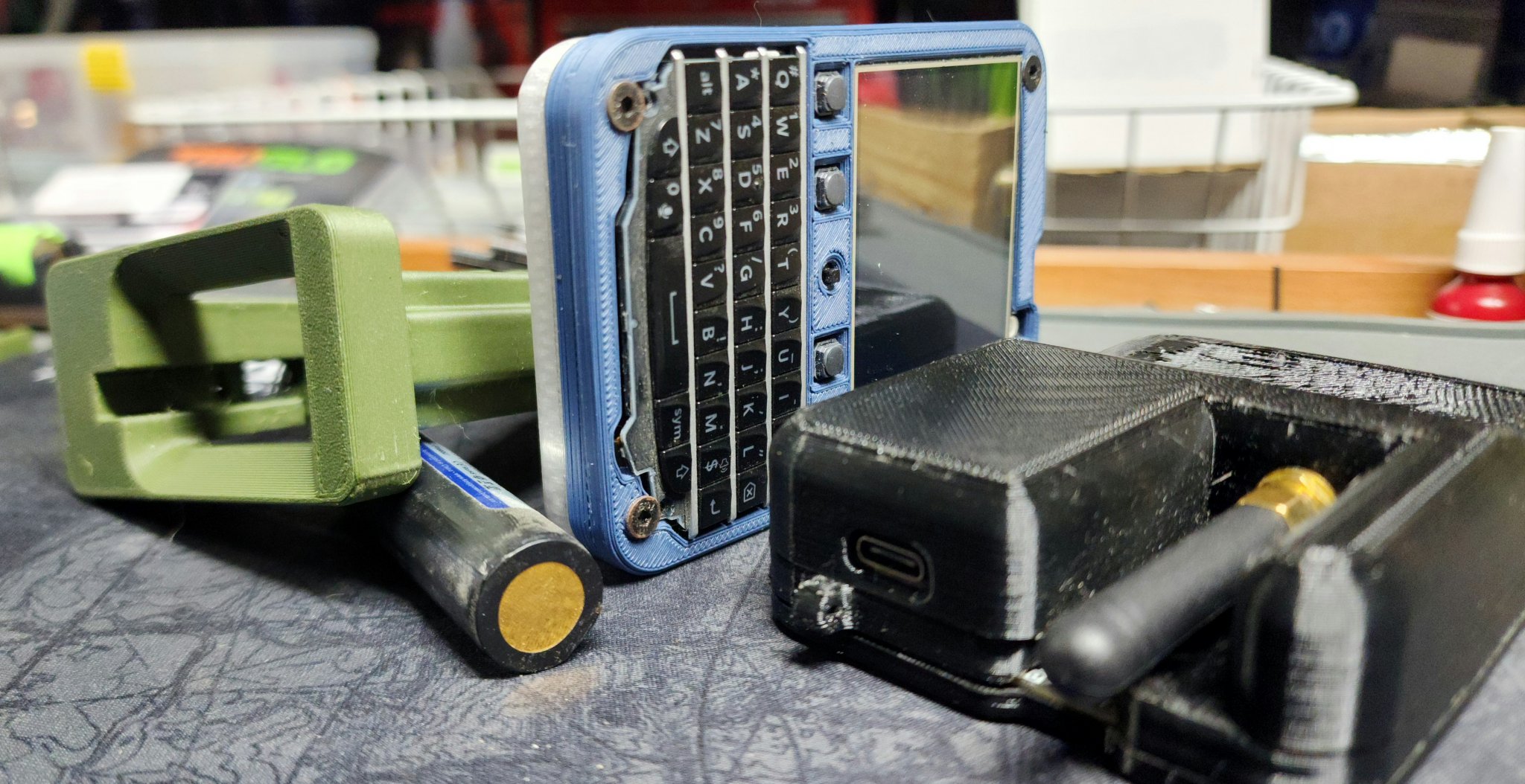

Have a few blackberry form factor, off grid Lora mesh network encrypted messaging devices I've built.
Which can have considerable range depending on your surrounding areas. People have had many miles of range depending on elevation and surrounding foliage.
Cost of parts are around $150, then soldiering, programming, 3d printing etc.
Just curious who all may be interested in these type of devices and if I should sell these build more etc. Or not mess with it at all.
They will communicate with each other on their own network even if there is a complete grid down situation and no other form of communication is working.
I can also build more advanced models with group chat, individual chat messaging, gps, and waypoint locating each device location.
These are stickly silent encrypted messaging devices in photos attached. When you write a message the device name and message shows up in a group chat.
Update of newest devices last page of this thread

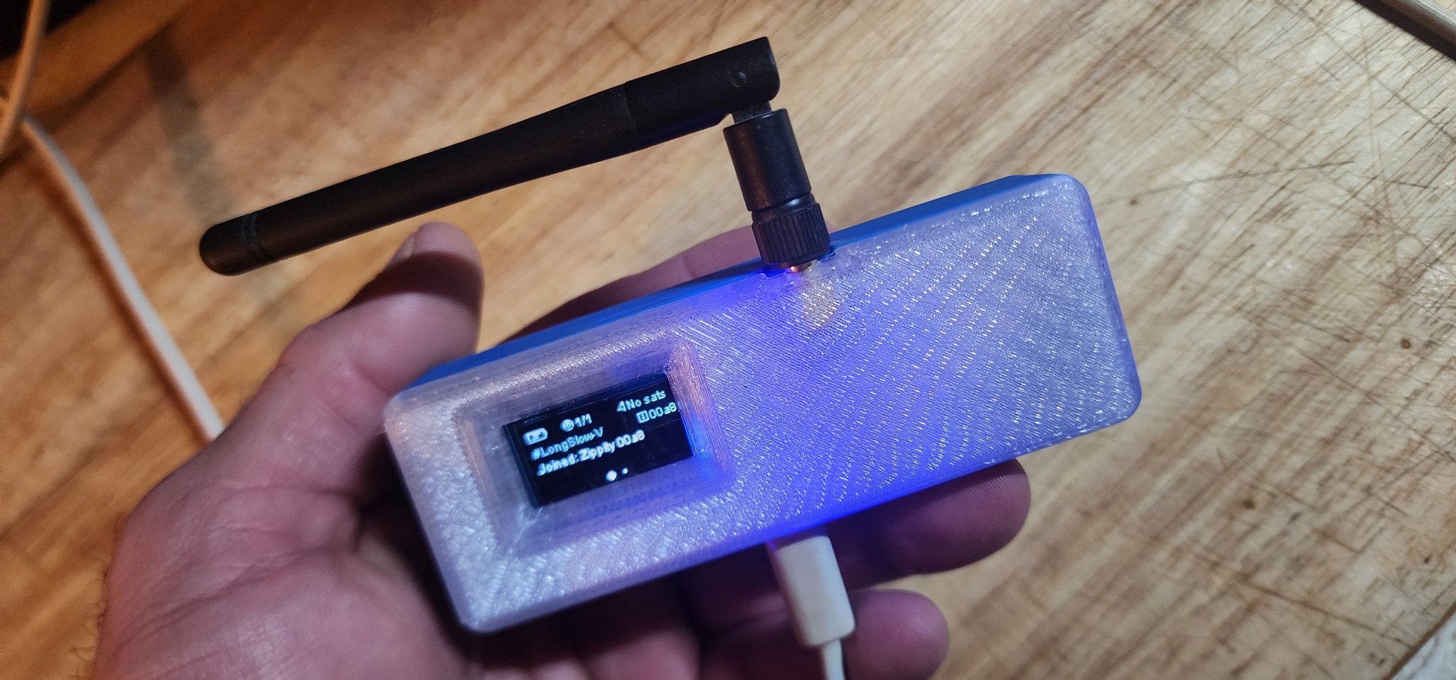

There is a repeater I've posted a pic of without the keyboard that can be put in certain locations and left there to expand the mesh networks capabilities as well.

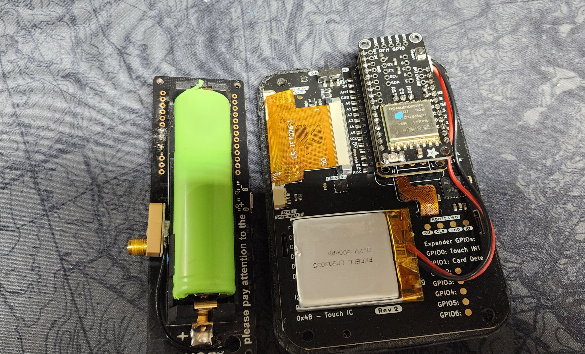

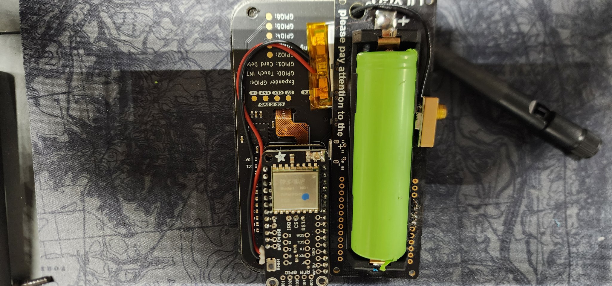

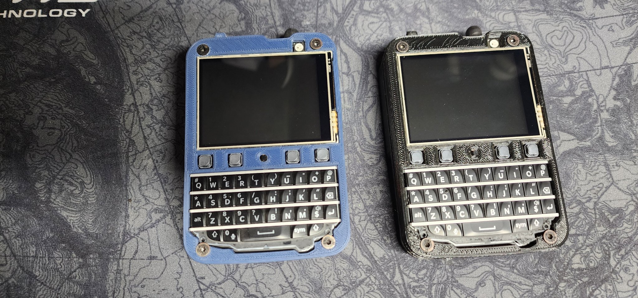

The PLA matte color frames print much nicer I've noticed than the PEG filament as you can see in the pics.
Touching on the 18650 battery swaps, larger internal lithium batteries charged by USB C like our cell phones will be the best option if wanting to keep a compact size due to keeping a slim frame. But a larger framed device is doable to house the 18650. Having a spare 18650 recharge pack that plugs to the usb-c is an option as well.
I would have to design an easily removable door that will access the 18650 battery housed by a larger rear frame on the device. That removable door has to be designed where it doesn't wear out easily and become junk. But obviously do-able. I'll prob end up with having two versions of these for this manner; first the lithium option and later an 18650 option.
Here are some pics to see the size difference of the two batteries.

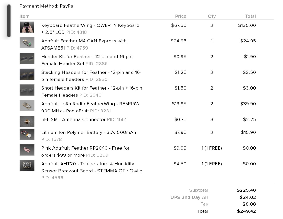

BOM - WTF? Is this the new wokeness where we need to be sure someone isn't making any money on the cool new thing they designed??
He answered my question perfectly (down to the correct estimate of a 3d printed enclosure) and almost immediately, so now let me answer your question:

His device is visually similar to the Lilygo T-Deck which is $53 plus a $7 battery and a 50 cent case. So rather than come off like an ignorant asshole I asked him to back up his factual claim that the hardware costs were around $150.
Which he did.
Immediately.
His hardware is better and faster. His BOM shows that.
My only question at this point is where his github repo is, because the BOM doesn't include meshtastic-supported hardware that I can tell....but its 1000% possible I just don't see it.

Much appreciated 👊
Here is some technicals I dug into that'll alleviate some of that experience you've had with this stuff floating around the net. I'm glad you have that to share, Nothing wrong with constructive criticism and endeavour done proper . I do applaud.
The BOM was for these that I have listed with the cortex M4 microprocessor purchased from adafruit. Since the moment I have listed these I've been catching up on parts available and info:
Adafruit has discontinued their keyboard featherwing w/ 2.6" LCD screen board. Potentially due to LilyGo creating a more advanced model that has taken over that market. Which I can see why:
LilyGo has an ESP32-S3 series has a:
Xtensa® dual-core 32-bit LX7 microprocessor,
up to 240 Mhz with 8mb of PSRAM & 16mb Flash memory
Compared to Adafruits feather M4 express having a
ATSAMD51J19 - dual core 32-bit Cortex M4 microprocessor, running up to 120Mhz, with 192kb of SDRAM & up to 2mb Flash memory.
Note: PSRAM compared to traditional SDRAM and SRAM has the advantages of higher speed and lower power consumption.
The Lilygo T-deck uses LX7 240mhz processor and does have superior upgrades in processor technology compared to adafruits M4 cortex.
Lora hardware:
Adafruits RFM95W Lora chip is based on the older Semtech SX1272/SX1278 chips. Since then there is newer gen Semtech chips i.e. SX126x series.
"Compared with the SX127x series this new generation offers firstly lower battery consumption, secondly higher transmit power and thirdly better immunitiy to noise on the radio signal."
-Which lilyGo T-Deck also utilizes
To sum it down, I'll be using the LilyGo T-Deck for these builds. It will cost $65 for the board, and I will have to soldier in the GPS unit and eventually the 18650 battery housing. Then 3d print, thread/tap, hand fit, the hardware to the cases. Newer versions of the cases may need to be redesigned for the 18650 model with a proper battery door latching system that doesn't wear out or become junky.
From my browsing, others whom have sold these and similar legitimately, are in the same $150-$160 range as I have listed. I will only sell at a fair value and won't be touching this if its deemed shady.
