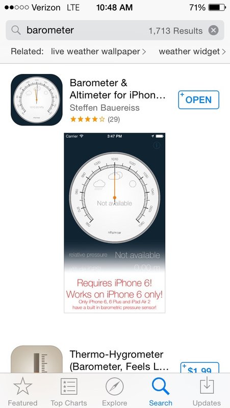

There are several apps called barometer-are you able to post pic of which you're using?
Here:
The iOS app called Barometer will work in airplane mode. New cell, Wi-Fi or Bluetooth.
I tested it but haven't used it as part of my kit
Sent from my iPhone using Tapatalk
Diver, checked into/downloaded this one. According to the "Description", it pulls data from nearest weather station (provenance not given), not from phone sensors. Still, it allows manual plugin of data to calculate DA, etc.
He's definitely not looking at the correct app.ZenBiker990, look up at my post #25 above. That app specifically says that it uses the barometric pressure sensor in the iPhone 6 and greater.

I don't think your looking at the correct app. Min does not have any inputs. And I am not sure how it can "pulls data from nearest weather station" when the cell, BT and wifi on the phone is set to "OFF". yet the actual pressure is displayed and changes.

My bad, I had intended to respond to this app: “Air Density Meter....”. The “Barometer and Altimeter for iPhone” is indeed stand-alone.
