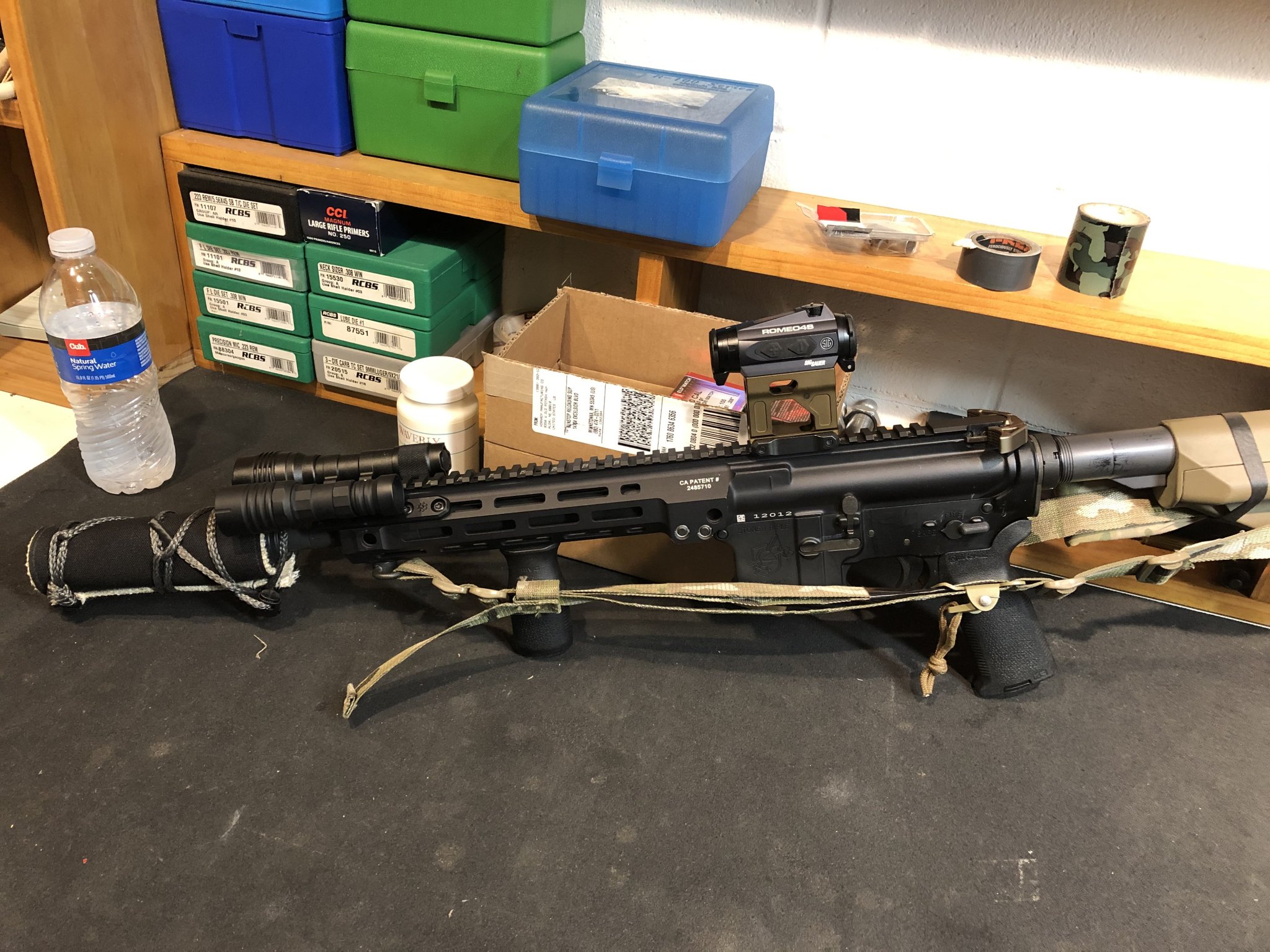

Here’s a picture of my setup. The left is Modlite IR 850 and right is Streamlight HLX. I thought about going with the inforce white/IR light for my 300blk but decided against it due to mixed feedback on reliability even with the Gen 2 design. I’d be ok with it being helmet mounted, but I try to keep excess weight off my noggin as much as possible. So I’d rather have it as a handheld with some velcro to just stick it on the helmet for quick hands free if needed.
I want to keep my 300blk as low profile as possible, so I may opt for the 600 series sized vampire light. Just sucks that you have to rotate bezel between modes. That’s one thing the inforce did right was just a lever you flip to switch modes.
