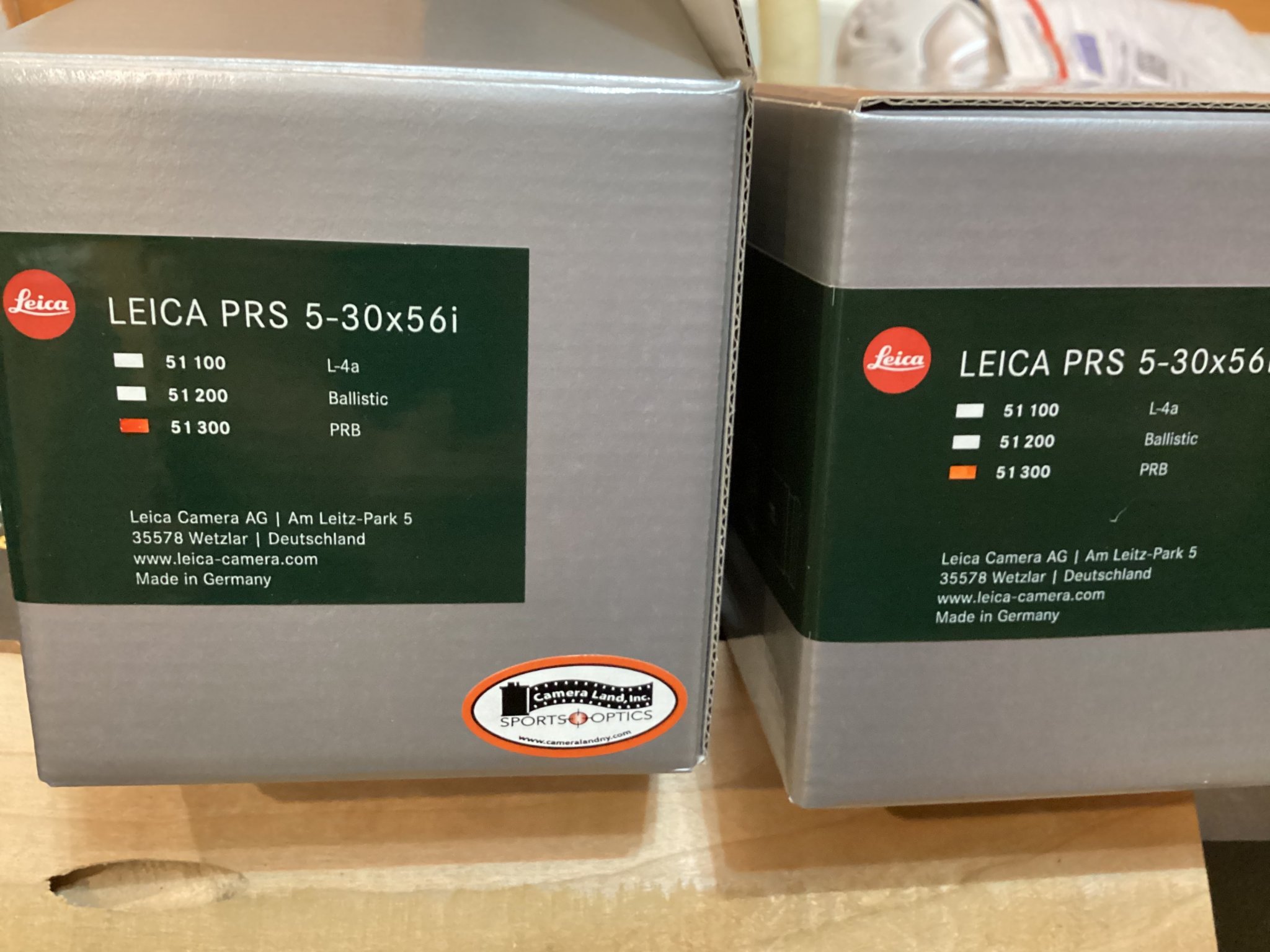

Good to know, I knew the PRS scope was made in Portugal as is their LRF line but surprised they went to Portugal for their top end scope.
i own two PRS scopes both have the PRB reticle, both made in Germany. I bought my dad an Amplus it was made in Portugal
So PRS scopes made in Germany and Magnus made in Portugal? What is going on at Leica? Reminds me of some Nikon lenses, some made in China, some made in Taiwan, some made in Japan. At the end of the day the manufacturer can make their products wherever they want as long as QC holds up on the manufacturing floor, but some people prefer their products to be made in certain locations, I get that.
