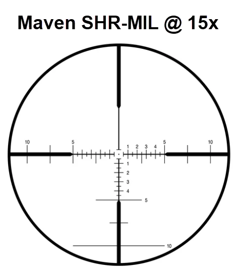

While I do not own it yet, I submit the Maven RS1.2 - 2.5-15X44 FFP with the SHR-MIL reticle has a ton of potential.
I have become more confident of this lately as when I asked, Maven advised me that with this reticle the center dot is .1 mil thick; every hash mark is .04mil thickness; the inner reticle (thinner) is .1mil; and the outer (thicker reticle) is .4mil.
This is essentially the 2.0 version of Leupold's .1 MRAD thick Illuminated TMR.
As such, I suspect this scope is VERY usable as a duplex at 2.5x; the hash marks are usable prone / static unlimited time / low stress at 7x; and the hash marks are usable positionally / timed / high stress at 9x.

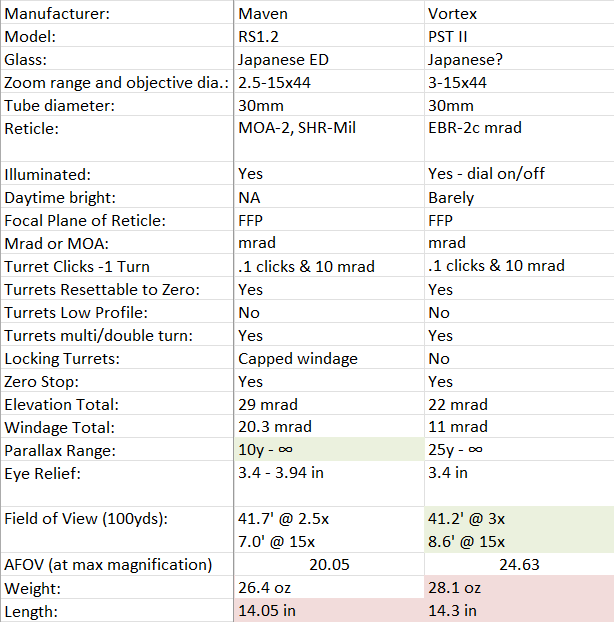

I think the Maven has more potential as a crossover scope than an MPVO. One of the criteria for an MPVO is that it be shorter in length and the RS 1.2 2.5-15 is quite long at 14". Also, the FOV is pretty narrow and some have said the Maven tunnels, compare these numbers to the Vortex PST II 3-15x44. I do like the SHR-MIL reticle, but did they really leave numbers off the left side of the horizontal... strange decision.

Howwwdyyyy. There is a gentleman here with one who has offered it to me to review. But Maven finally got back to me last week about sending me one to test out. Of course I went for the MIL's, and I also opted for the add on package so I can play with the rings and caps.
It is on the longer and heavier side, but I am not a stickler for length as long as it clears everything else on the rifle. I much more care about optical performance and tracking performance over some of the physical properties. But everyone is different, and some people like things that others dont. Simple as that.
The RS1.2 as a whole looks extremely promising. All it could really use is a locking elevation turret. If thats a deal breaker then check out the Tract Toric 2.5-15. On paper that and the RS look very similar. I would even hazard a guess that they share some DNA.

Great news!
I am very interested to see the reticle at 2.5x against a woodland background if are able to do so.

I have the tract 2.5-15, I belive they are basically the same scope. It’s a nice little scope, it was on a spr type 556 but it ended up being a little long so I put it on a 22 build instead. Great glass, build quality and eye box. Just a little small in the image department for what I needed on a spr. Doesn’t weigh too much either. Reticle is nice and clean and at 2.5 there is no problem finding the ret. 20 mils on a 40 moa base for my 22 lr. Could use a little more travel but it’s a 30mm tube after all.
That sounds just like the maven rs1.2 I just got. My limited experience with is is mostly positive. The fov and view through it seem to be on the tighter side but boy does the glass look stellar.
Yeah it’s an impressive scope, would make a great crossover scope for a lighter bolt action. They seemed to really do about everything right. For the price it’s really doesn’t get enough attention
