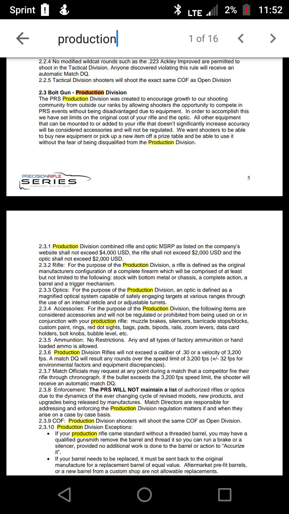

The answer to your personal debate lies here. Should keep you competitive until you improve as a shooter and begin to outshoot your equipment or it - and not the Indian - becomes the hindrance.

Aaah, that makes sense. Is there an analogue for FClass as well? There is a local regular FClass shoot close to me, though I have to do a fair bit of driving/flying to find PRS (it's a goal though).

Cartridge choice is NOT what bumps you to open in PRS. While your cartridge choice determines if you can shoot in PRS tactical, same is not true of PRS Production.
You can shoot any cartridge you want in PRS Production division so long as the rifle itself and the scope meet Production rules.
In the end, your skill is what will keep you from being competitive.

Looking at the PRS rules (HERE ) 6.5CM doesn't put you into the Open division, however, if you re-barrel the rifle it does put you into the Open division unless you send it back to Tikka for the work.
