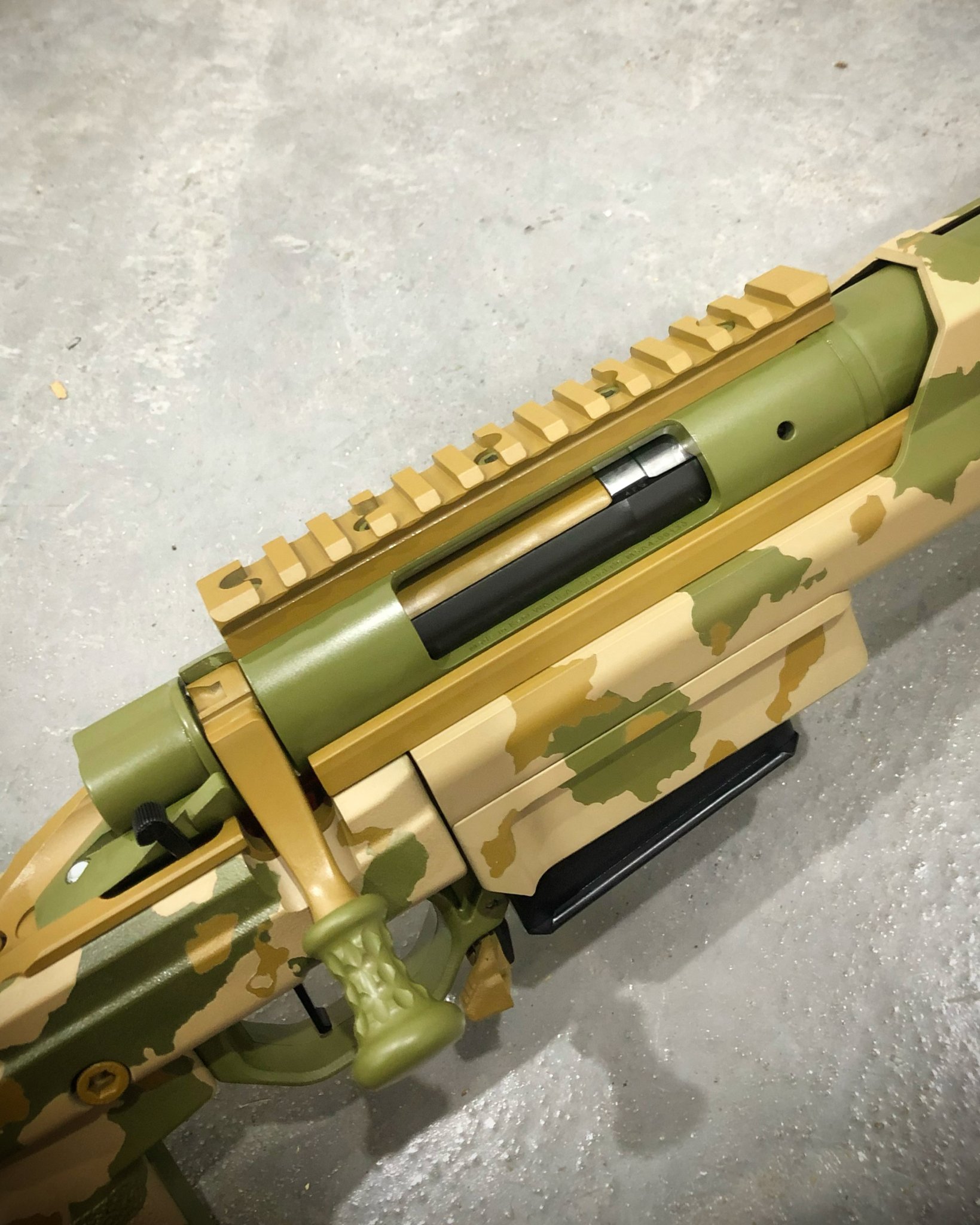

    My cerakoted Mausingfield is very gummy feeling in the last inch or so when moving the bolt near the open position. I've cycled it a couple hundred times and it doesn't seem to be getting any smoother.

    I've been shooting it, sometimes when pulling the bolt to the rear it binds up before it'll eject the brass. It's a 2020 M7 and it's got about 100 rounds on it now.

    And if it’s binding just prior to ejection, run the bolt significantly harder. If you break the bolt stop then either tone it down or there’s a design flaw, but the M7 design had a bolt stop improvement included for “durability and functionality.”
    Basically, don’t be afraid of being rude to the bolt stop, hit it with a good bit of speed and it’ll wear in that much faster.

    This makes sense, but it often binds and comes to a complete stop well before hitting the bolt stop. Not every time, but pretty often.

    That’s what I’m saying, give it the business, slam through whatever that hang up is. Might just be a very small high spot that’ll chip/wear right off, but you almost certainly won’t break anything. If you do, it’s easy to replace and I expect they’ll send it to you for free if you explain what’s going on.

    How old is the action and who did the cerakote?
    OP, this was asked because the early M5's came in the white and certain shops were not applying cerakote correctly which caused some binding; particularly in those lighter shades.
    Since yours is a M7 which was already nitrided, I'd suspect overspray especially when considering that whatever color you chose had to be sprayed over the black nitride.
    Not implying your smith/coater doesn't know what they are doing, just that similar cases predate your finding.

    I hear you. I've had other actions cerakoted and they sucked. This one was done by one of the best in the business and it sucks. I think I'm done with cerakote at this point because it seems like it doesn't matter who applies it, it sucks.

    I can understand your frustration and cannot blame you for feeling the way you do. However, do yourself a favor first and take some polishing paste to the inside of your action. Use a good light so that you can see where the overspray is and then polish that area carefully. You can even carefully place some polishing paste on the rear of the bolt, not allowing it to get inside the bolt, and work the bolt that way. Point is, the ceracoat has created a fit that’s too tight. The mausingfield actions have tight tolerances to start with and the coating inside the action is what’s binding it. Remove that carefully and that action will be slick as snot.
    Of course shooting it a lot also will do this, just not as fast.

    I agree. For personal and customer builds, I’ve gone to masking the inside of the action completely and not coating any portion of the bolt that is bearing surface.

    That‘s my usual method also. I’ve done stock Remingtons without masking and you can tell that the clearances tighten up.
    For the poster, I would suspect you have a thick edge or spot in the extractor grove at the rear of the action that the claw is binding on.

    What chassis or stock do you have the action mounted in?
    I've had a couple of action/stock combos where the bedding and action (despite both being R700 footprint) were mismatched enough that the tang would bend when you tightened the action screws and this caused bolt binding.
    If you take the action from the stock does it get any better or is the binding still there?

    It's the same result in and out of the stock, the stock work and bedding on this one is top notch.
