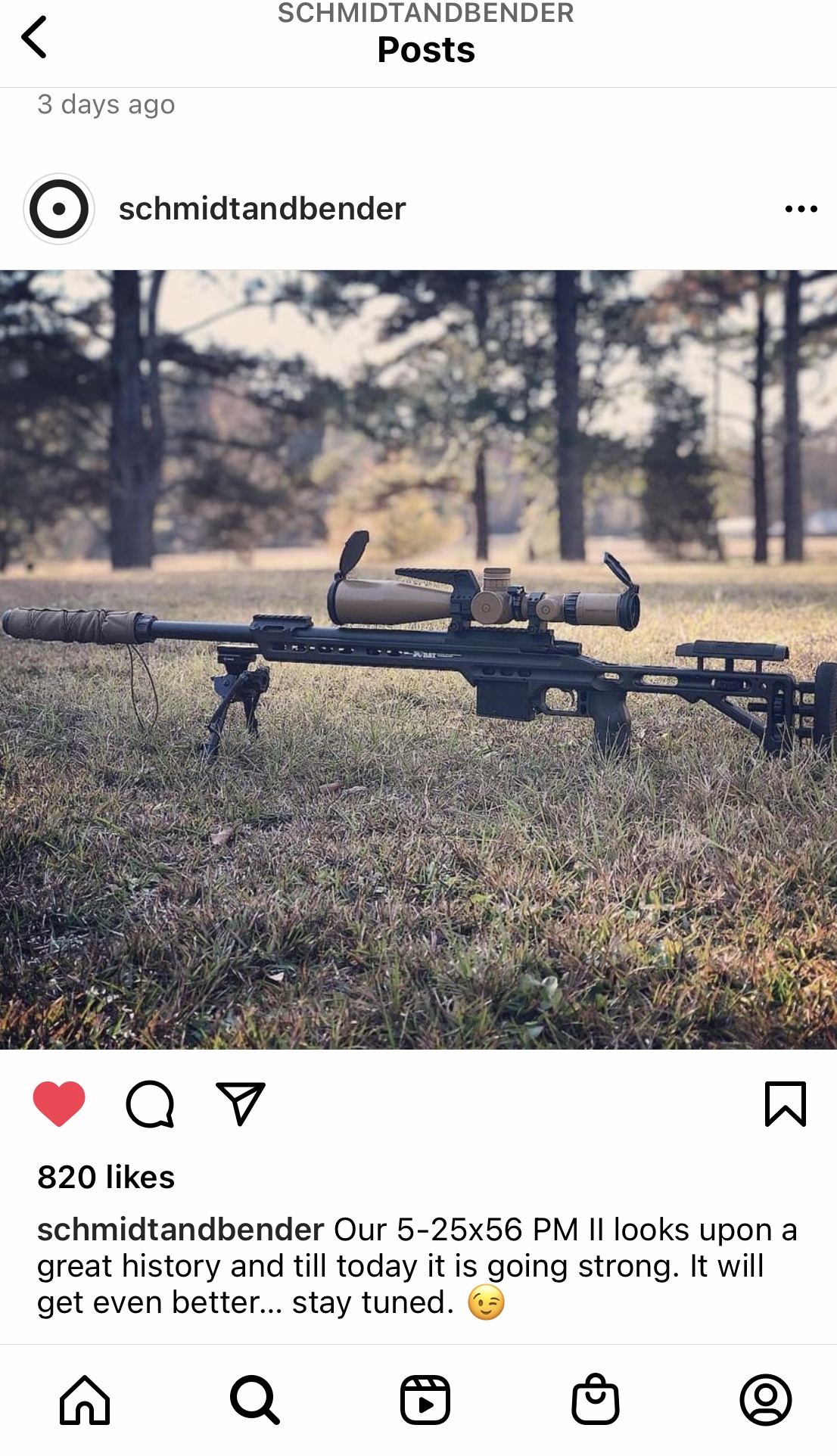

    There is no new 5-25 design yet?
    The only update on the 5-25x over the years has been turrets and reticles. The High Power and Ultra Short series are new designs with different internals. Case in point, have a look at their scopes with the newer multiturn turrets with 0.05mil click values. These models tend to have more available elevation range than the double-turn models:
    3-27x with old DT = 26 mils
    3-27x with newer DT = 35 mils
    3-27 with newer MTC = 39.5 mils
    Now look at the 5-25x with these newer turrets: still stuck at 26mils.
