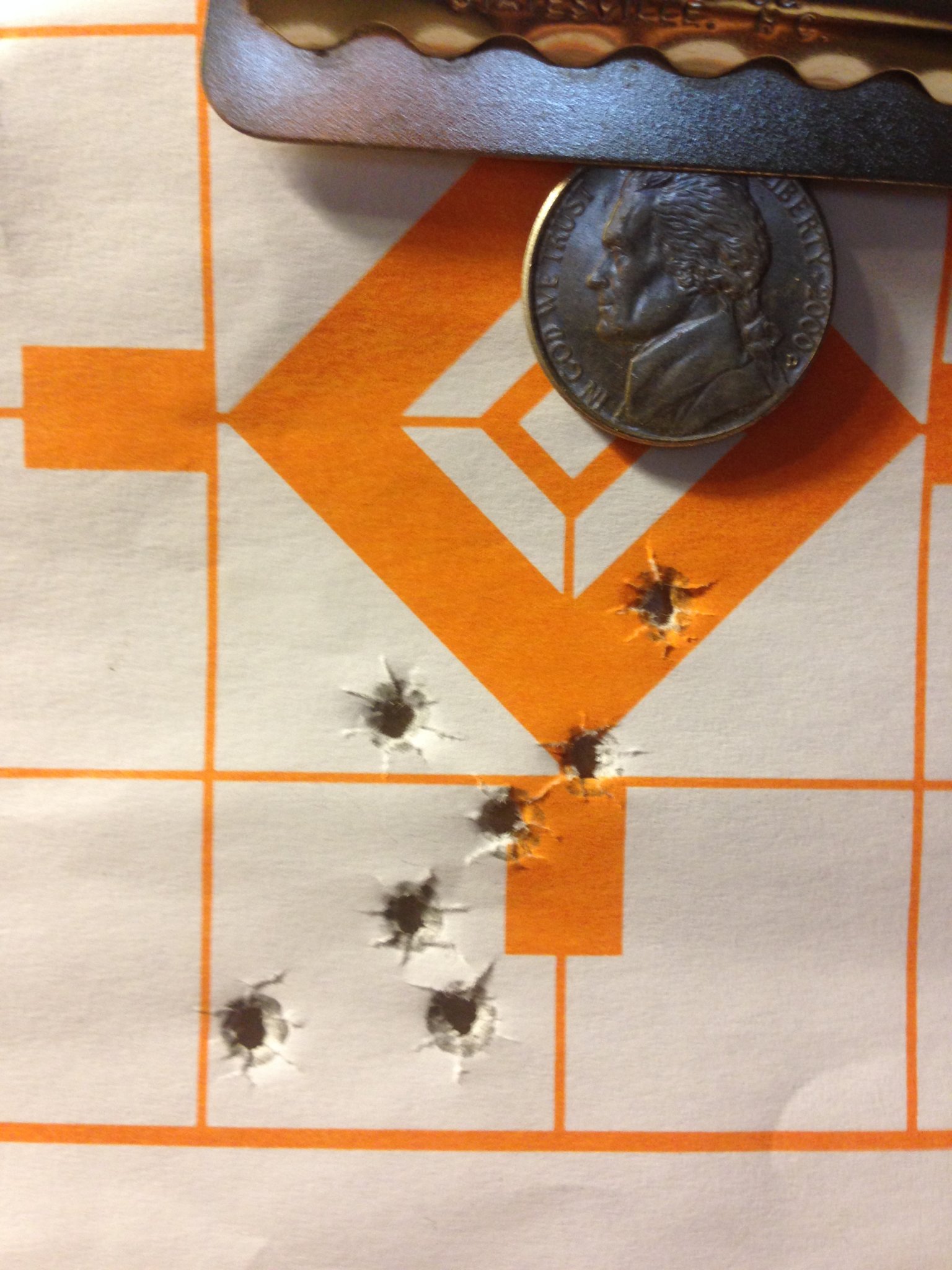

Savage .22 @ 100yds
It’s all in matching ammunition to the rifle.

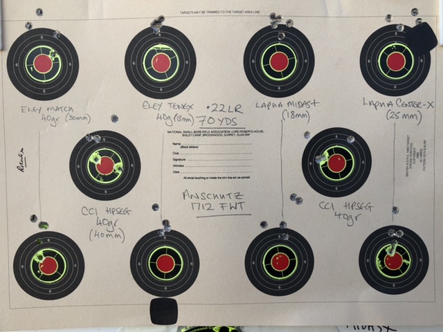

There should be a boat load of sub-moa rifles out there. My Anschutz 1712 FWT on the superb Match 54 Action shoots sub moa with Eley Tenex. My view it’s the ammunition every time. Image from 70yds, but do the math and you find that is sub moa
