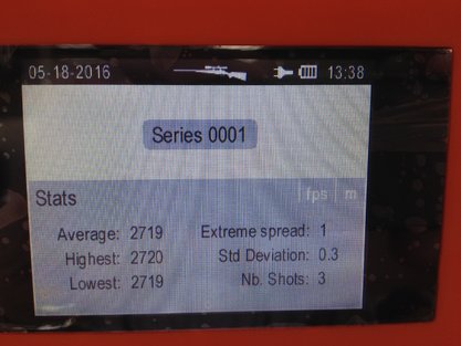

Only 3 shots in these photos , but sometimes the ammo is near perfect .
Slower velocity is one of my 6.5 x 47's , 3019 vel is a friends 308 we were
tuning for the Aus Queens F Class Nationals . This load was good enough to
win F standard category , beating all the current Aus F class team .
