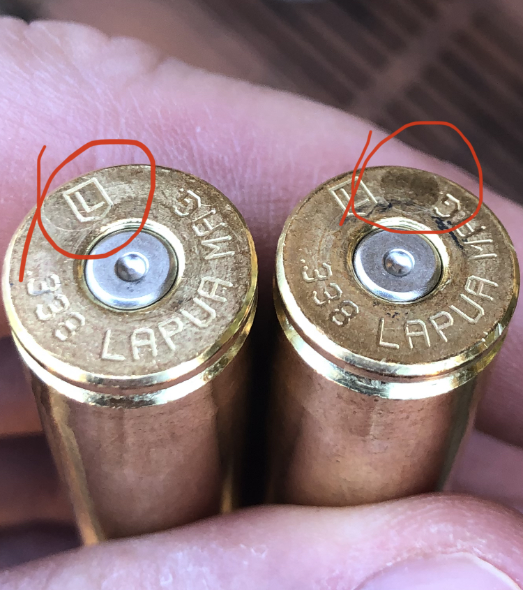

Is this overpressure sign?
ChuckSwagger
Nov 16, 2017
160
22
I am new to the rifles reloading and after find a good spot on my 308W I started to do my 338 LM reloading development:
Rifle GAP Precision Hospitaller 28' Barrel and 9.75 groove.
Lapua Brass trimmed to 2.712.
Bullet Lapua Scenars 300gn. 1.002 ogive length
Shoulder 2.261.
Chamber OAL bullet ogive 3.034.
Jump 0.020 (3.014).
I tested two shots to zero my scope.
One with 91.6gn and 92 gn of the Retumbo Powder and got 2.815 and 2833 FPS.
Maybe on the 92gn the bolt lift was a little heavy, but I can't confirm since the rifle action isn't the slickest action.
The primers looks like ok, but the is some extractor marks on the brass...
The question is:
Are those marks an overpressure mark?
I am asking because I have red somewhere the 338LM should be pushed to 2.850-2.900 fps to optimize its potencial and I am afraid to push it unsafety.
Here is the brass pick:
yep you are getting flow into your ejector..not crazy high but on the hot end...my 338LM barrel tops out at 91 gr of retumbo with 300gr bullets so you are about normal with that length tube.
Reactions: ChuckSwagger

That is not always a sign of overpressure.
With Lapua head stamps, that is a sign of overpressure.
ETA: I REALLY dislike you starting on handloading with a Lapua Mag, and with only the internet as your loading buddy.

Nope, move on.
Regarding charge weight, just start low and work up to it. This is no different than anything else. No need to trust the internet and just pick a narrow range. For me, I load three at each charge, start low, and work up. If I’m starting on a new barrel in a very familiar cartridge, then I’ll pick a narrow window, but still working up. Another thing. The lapua is a huge case, use half or full grain increments.
As said, ejector mark.
Not the end of the world unless you're getting other things like blown/very flat primers, excessive recoil or a heavy/stuck bolt. Sounds like 92.0 would be too high.
My only warning would be to watch it when shooting in higher temps depending on the powder.
