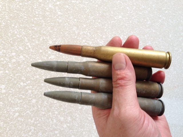

A few years ago I bought a bunch of .50 BMG from a commercial reloader. I shot some, and put the rest away in ammo boxes. All of these have been stored side by side on a shelf. Last weekend I opened the box of ball and found this.

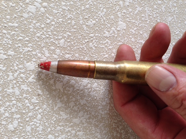

The other photos are of ammo from the other two boxes. Sadly I think I know the answer, but Trashing $500 bucks worth of ammo sucks, not as bad as blowing up my Barrett tho.
"Trash", no.
my suggestion would be to pull a bullet or two, and see that the powder is still ok/dry. If it is, (which I'm suspecting) then simply polish the brass and bullets BY HAND with a polishing cloth, and then go out and shoot. At best, they'll be fine. At worst, you'll have a dud. (check your bore)
They ain't going to 'raise pressures' and they ain't gonna 'explode', either. As long as they are clean.
Or, for the tremendously pedantic, (not pointing fingers at any mirrors, or anyone), you could simply pull the bullets, polish the brass, re-prime and re-charge. I don't know if you're set up for that yet though.
Just my opinion here, I'm sure many others will chime in.
I would go at one of the rounds with some never dull (or Mothers) or any other cleaner you may have around and give it a shot. Pulling the bullet may not be a viable option as you are not set up for reloading unless you want to select a "sacrificial lamb" and go at one with some pliers and vice grips and even though it won't go off, the pucker factor is there as you are trying to pull the bullet out of the case. Another option would be to contact a local that does reload and have them break these down, clean them up and reload them. Might cost you a little for powder, primers, and reloading service but that way you won't have any issues.

If they were mine, I would go to the local hardware and get some 000 Steel Wool. Most cleaners have some amount of abrasive, ie lapping compound. I prefer to keep most abrasives OUT of the chamber. That's why I recommend steel wool. I did that once with some 308.
If you are going to store, wipe it off with either alcohol or lighter fluid on an old TEE shirt.

As others have said, I would sacrifice one just to check that moisture didn't get to the powder to see if it's even worth the hassle. It's most likely dry as nothing screams they're in that bad of shape. Then just polish by hand with some steel wool before wiping them down. Just make sure you wipe them well before running them in your gun, you don't want that grit anywhere near your firearm if avoidable.
