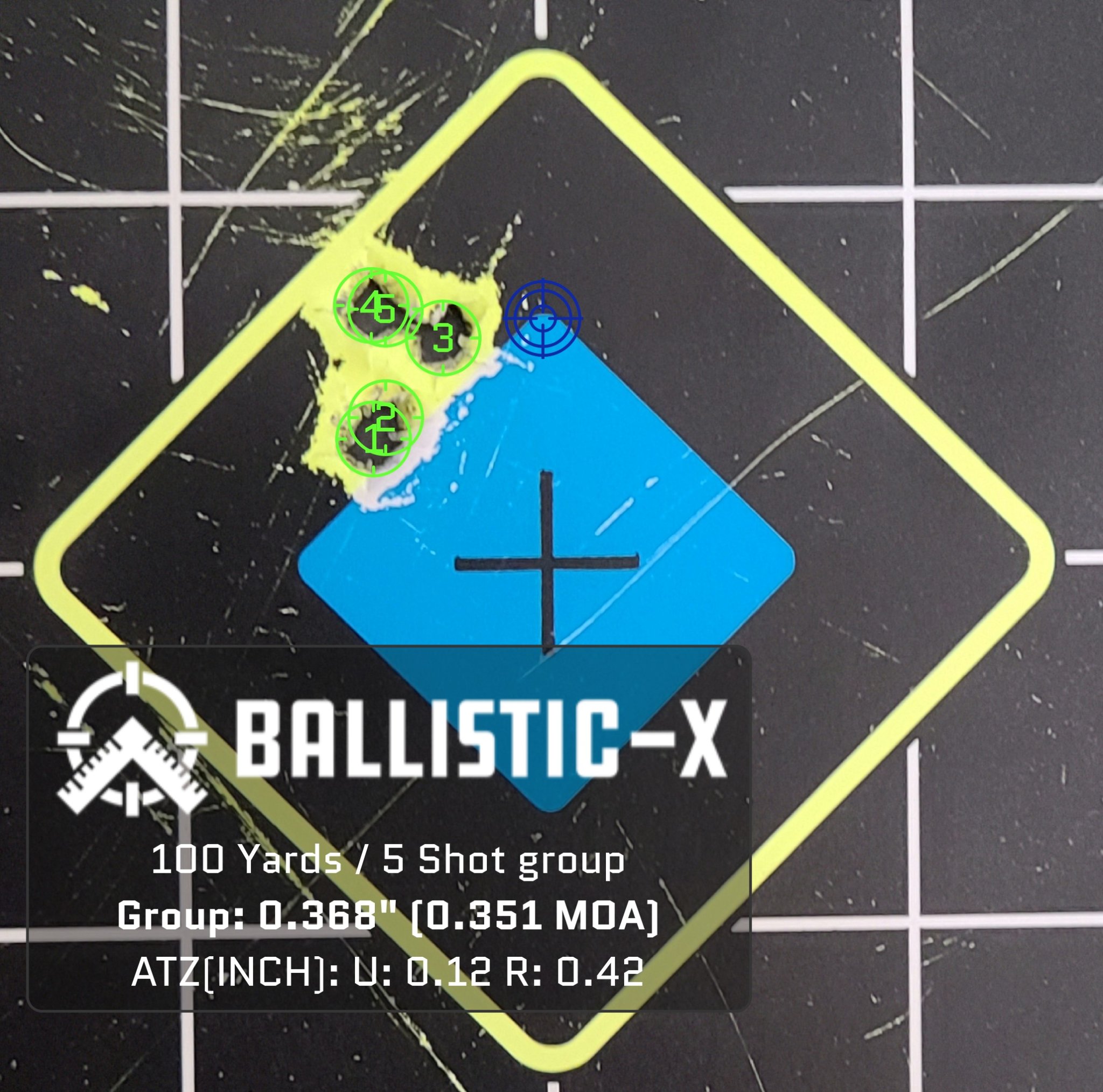

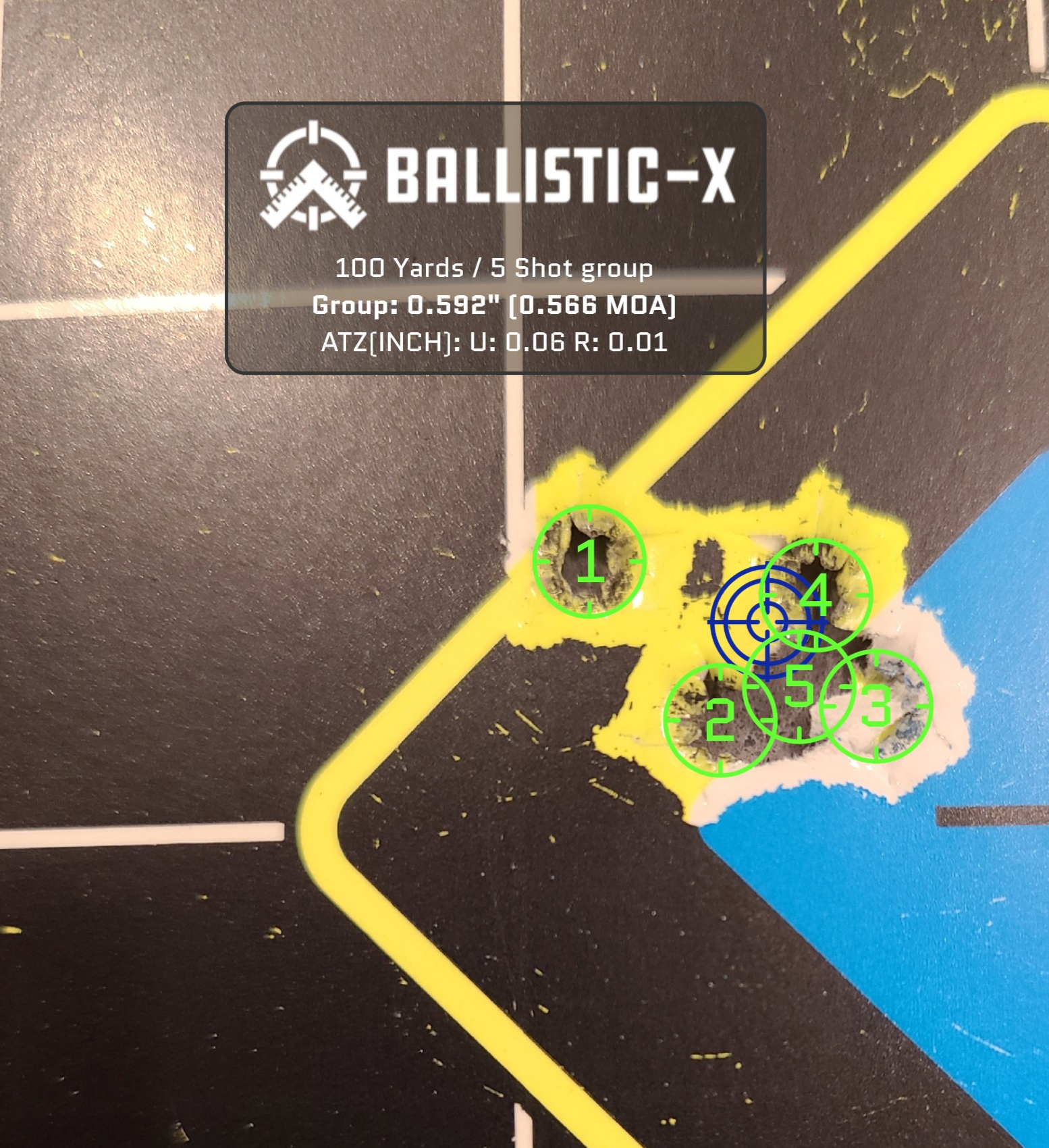

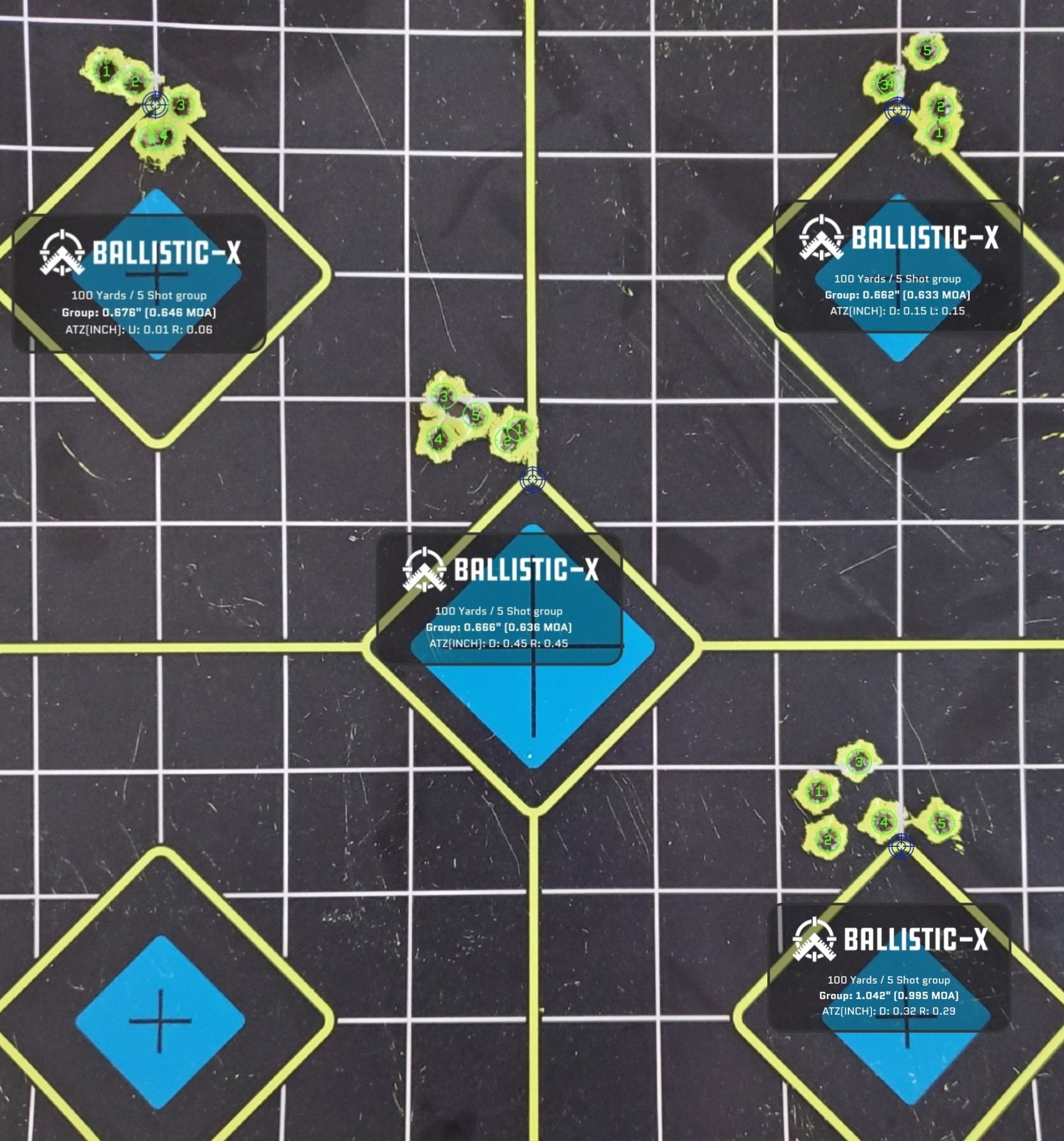

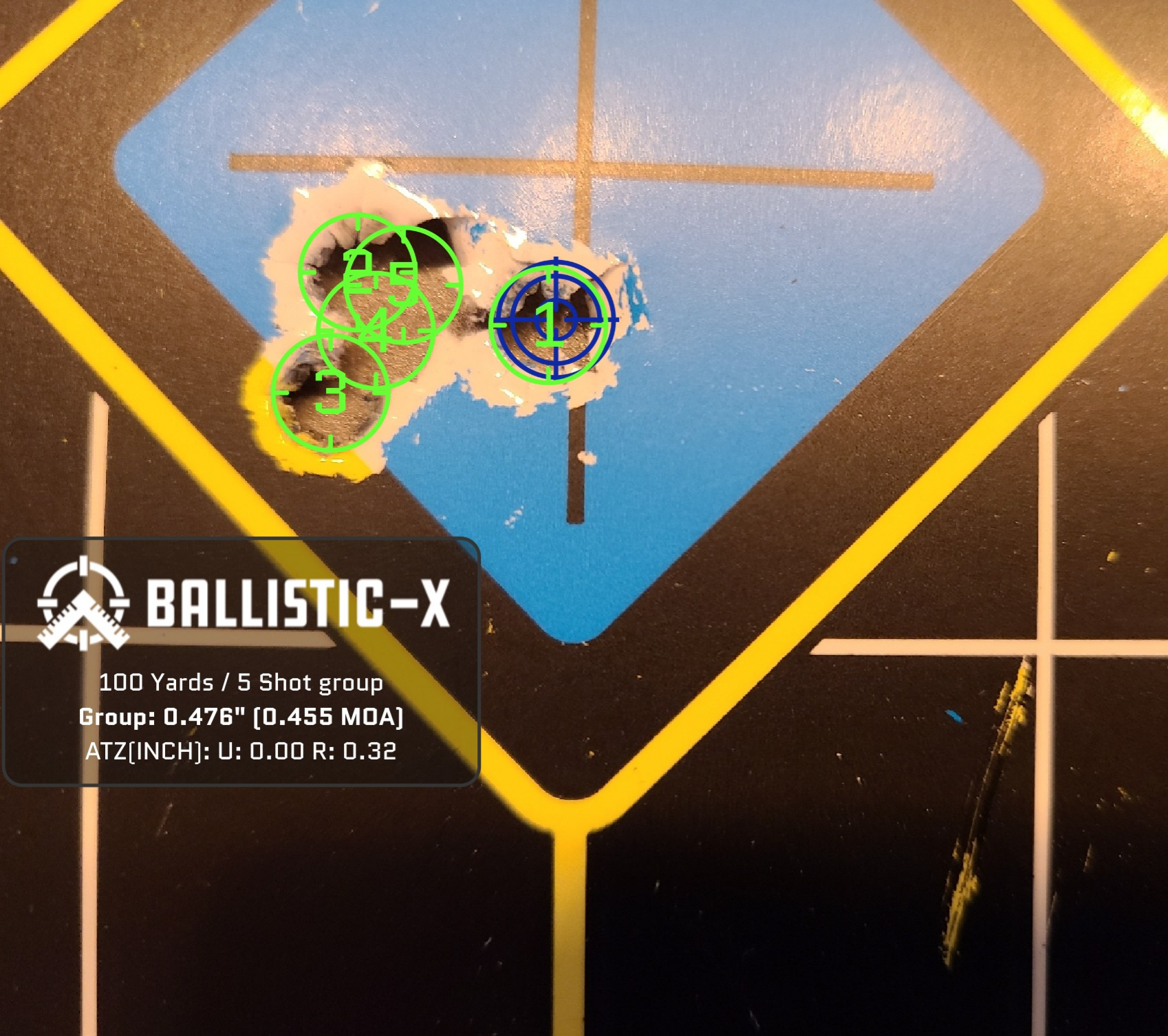

Why has nobody mentioned the awesome shooting SS heavy (.900") true match grade hand lapped barrels made by Wilson Arms? These are the barrels used by RRA on their Varmint models, and are available (often on sale for $99!!!) from JSE? Although I've been (rightly) chastised for posting the image of a single group, this group show the capability of one of these 16" ($99 with a free .936" gas block!) barrels and handloads. My two Wilson Arms barrelled RRA Varmint rifles and my new build (group below) are all awesome shooters and win matches.
BTW - these barrels are chambered in .223 Wylde so can handle 5.56 ammo, and are 8 twist, but shoot 69 and 77 gr. SMK's just fine (although I would not hunt with those bullets).
