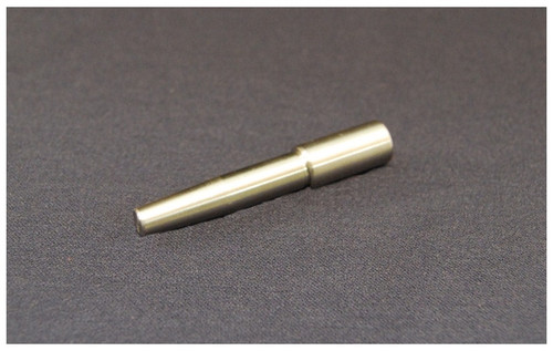

I used this to expand the 220 Russian case neck to 6mm. I think it ends up about 0.242".
Then I used this turning arbor with the neck turning tool. Its diameter is 0.241"
