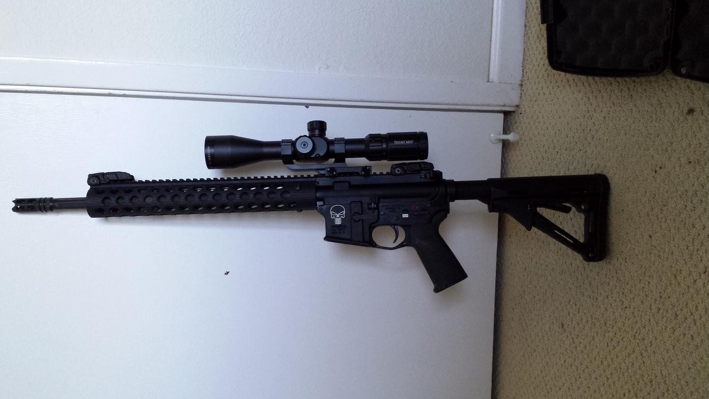

Here's a photo of my frankenbuilt ar in 223 wylde:
ps. this is my first attempt at uploading pics so I hope it works!

Very impressed with this rifle so far! Absolutely no FTF or FTE with this rifle at all. It just f#cking shoots and for $1130 dollars I just don't see how you can go wrong. An upgraded trigger in this rifle would make it down right sick.
The 600yard range!
The new ROCK RIVER ARMS ATH!
Sorry, this is the best I could get my camera to focus. By no means reflects the quality of the glass!
