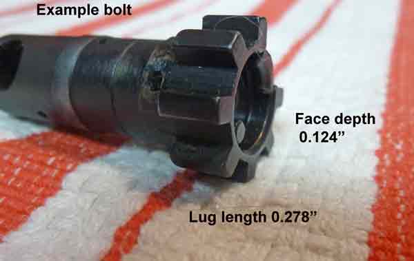

You're saying some bolt manufacturers don't follow the drawing with the only dimension that matters for headspace?
I'm saying, tell them to head space the barrel to drawing, measure your bolt at home.
If you ever have to replace a bolt, what do you do?
Send the barrel back in to have it headspaced to the new bolt?
An example bolt I have
Yep, all of my large frame AR bolts have identical bolt face to rear of lug distance including a JP.
My 6.8 SPC LWRC and AR15Performance super bolts match.
I haven't measured all of my 5.56 bolts but those I have are matching.
With CNC machining and production QC techniques, companies spit out bolts that vary in the 0.0001" range which is very much interchangeable (ignoring the development of wear patterns and parts mating up).

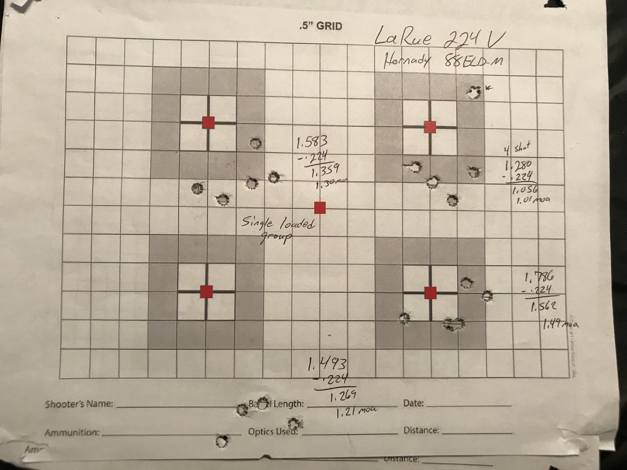

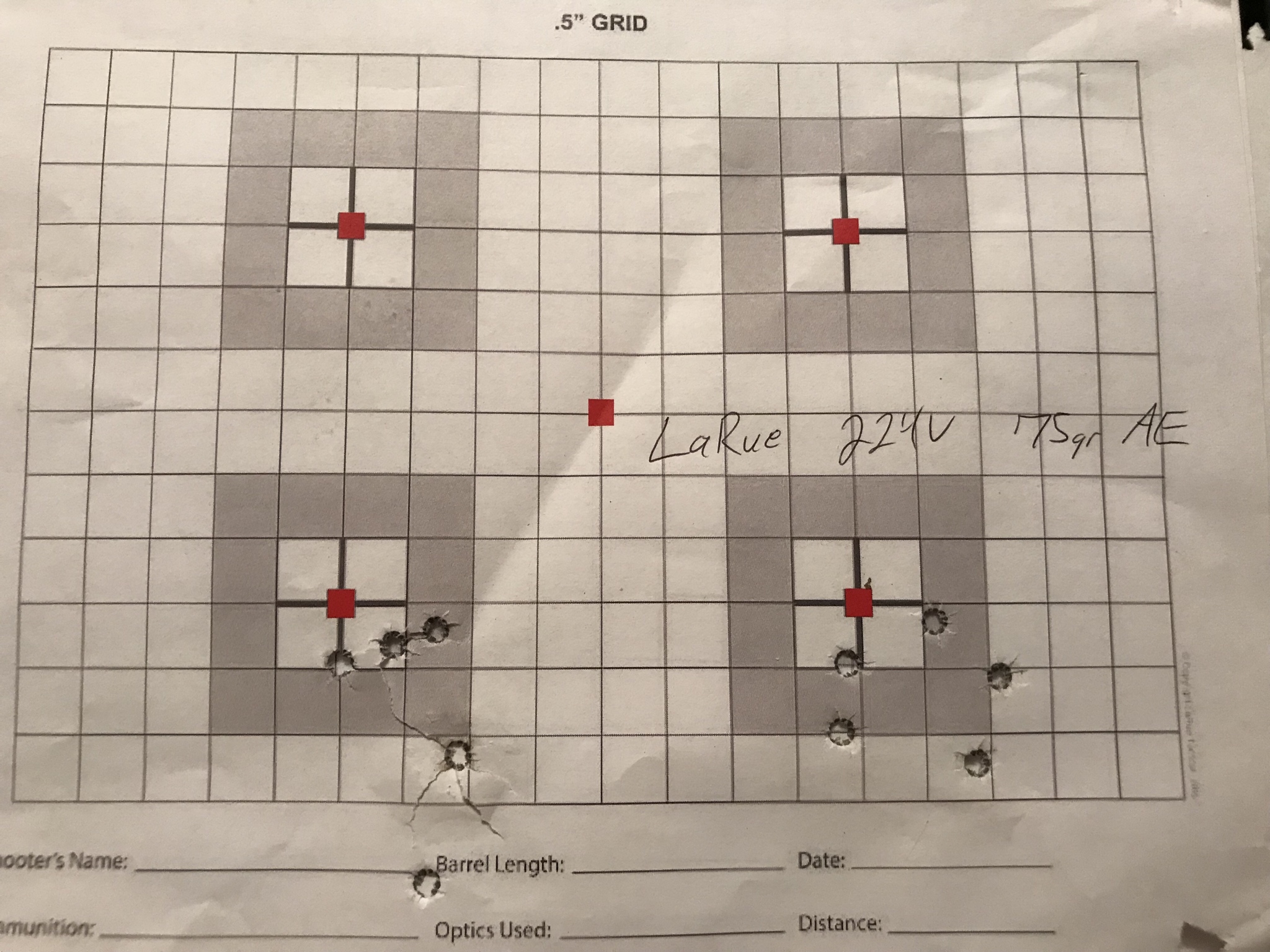

I’d pass on LaRue barrels. These were the best groups I could get from mine before I sold it. I can usually drive a gas gun to sub half moa if the rig is capable, so I don’t feel that the results are due to the trigger puller in this instance.
I have seen some ppl get average groups that were in the 3/4moa range with handloads, but I would view them as the exception and not the norm.
