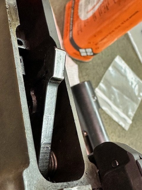

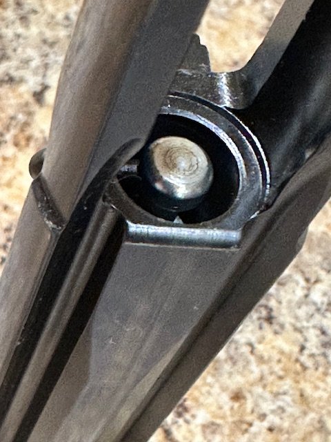

What would be the best option for a Mil-Spec AR-15 bolt carrier for use with a JP Rifles enhanced bolt? I have found that the JP Rifles full mass bolt carrier I received with the JP Rifles enhanced bolt is not compatible with the Geissele National Match trigger. The hook under the face of the Geissele National Match hammer is hanging up on the tail of the JP Rifles full mass bolt carrier. A Daniel Defense bolt carrier will work Geissele National Match trigger, but they don’t sell the bolt carrier separately.
Were I in your position and already had all these parts I'd try to measure the hammer hook interference and decide if I could live with removing a little bit of the hook.
Actually what I need is ether the longer hammer face of the SSA-E hammer or material added to the back of the JP Rifles bolt carrier so it replicates the Daniel Defense bolt carrier.
I have discussed this at length with both JP Rifles and Geissele staff. Based on my observations they concluded the combination was not compatible.

I sent my bolt carrier back to JP Rifles and they could not see any difference between the bolt carrier I sent back and their latest production. They did replace mine with a new one. There was a definite difference between the back of my Daniel Defense, Colt and LMT bolt carriers compared to the JP Rifles bolt carrier. You can see it in the photos I posted.
I think your bolt may look different from mine.
Thanks so much for your post. I looked at the replacement bolt carrier from JP Rifles and it looks like yours. I installed it in the rifle with the replacement Geissle National Match Trigger and it cycles. I am seeing metal wear in the notch below the hammer face with the replacement hammer from Geissle and the replacement bolt carrier from JP Rifles. The JP Rifles mating surface looks fine. What does your hammer face and the notch below look like?

Here are photos of my Geissele National Match Hammer and the replacement hammer from Geissele.
It appears the replacement hammer will work with the new replacement bolt carrier from JP Rifles. Hard to say which part was the source of the problem. Both original parts showed interference evidence. The new JP Bolt carrier does not show any unusual marks.
