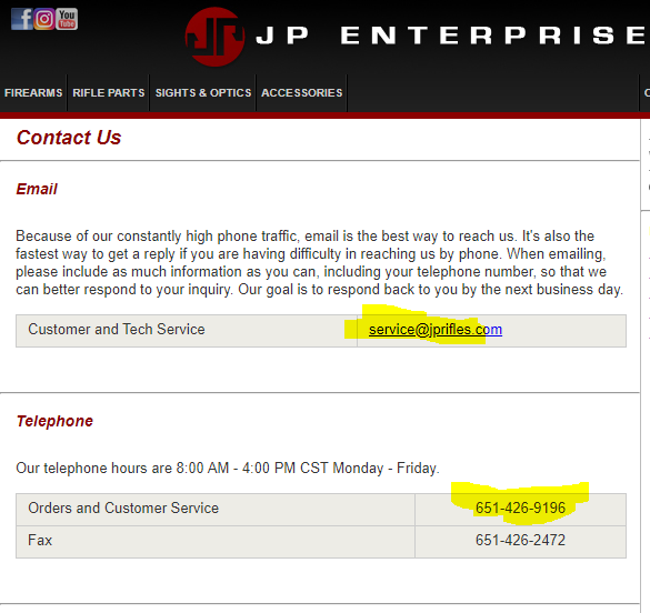

I'm still operating under the assumption that I'm doing something wrong and will wait to hear back from their customer support.
