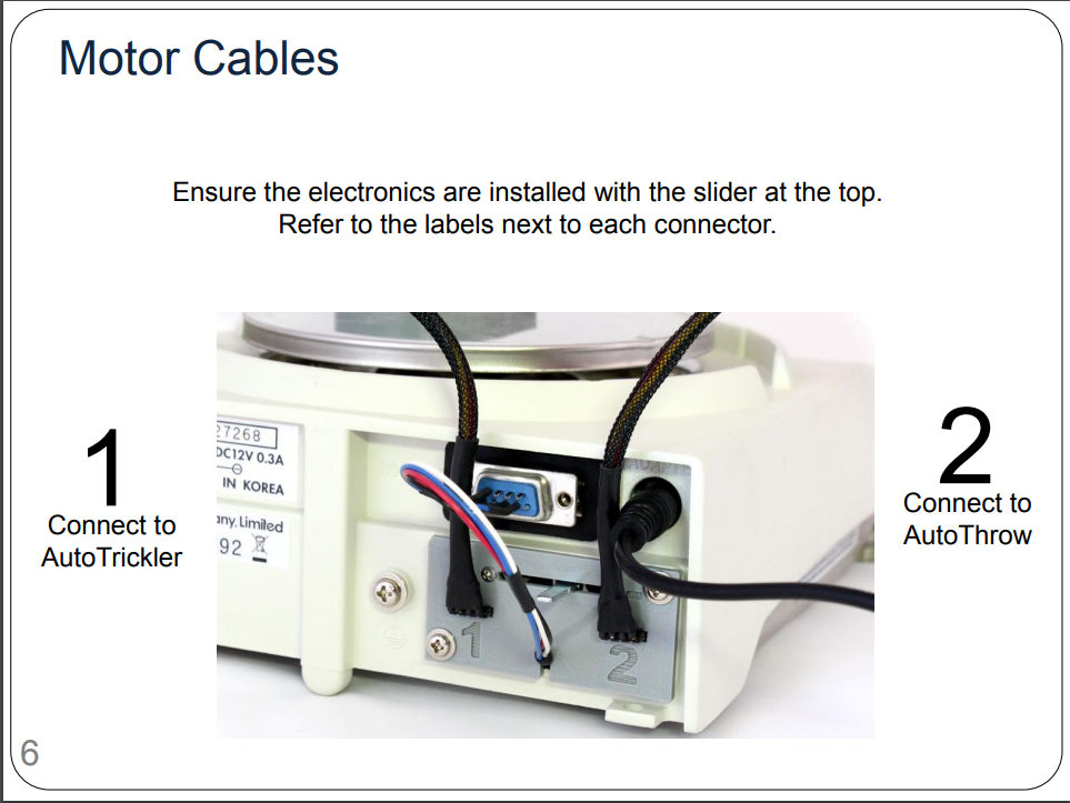

    Well... set it all up. Tried to throw my first charge and for some reason, the motor tries to throw the arm down instead of up, like its backwards. Any ideas?
    Try pushing the arm all the way up this time. I had the same problem, I just don’t remember if I pushed the arm to the top or bottom.
    If you still have problems, e-mail Adam MacDonald. He’s usually really fast to respond.
    Did that too. Sends the arm down nice and smooth, then proceeds to vibrate and tries to continue pushing the arm down. I have a video, just cant post it in here. I sent it to Adam via facebook but he hasn't seen it yet. I'm sure hes probably asleep or something
    Remove all powder from the measure, slightly loosen the nut on the “drum” of the measure and retry. I had to loosen the nut on mine before the stroke was smooth and would complete. It’s mentioned in either Adam’s or the powder measure instructions.
    What powder? Ball powder is a no go. It gets into the skinny party of the autothrow and seizes it. Found that out with cfeblk, trickler only. You’ll have to take it apart and clean it out.
    If not a ballmpowder then try unscrewing the screw in the large top pully just a smidge. That should lessen the tension and allow it to spin easier.
    Just watched again, are you sure you went through the set up procedure correctly? I can’t rememebr it even trying to continually run like that. When mines seized up before it’s just been for a second or two.
    Reactions: Changed
    It's a stick powder. Imr 4166. And it's not seized. The arm moves freely. It's in like a reverse polarity. The arm wants to go down instead of up.
    Thats a good problem solving step, mine are actually rotated 90 degrees from this page in the instructions so that the pins are all stacked in a line vertically instead of horizontally.
    The trickler (1) cable goes out straight left and the throw (2) cable goes out to the right
    My dumb ass knew the way they were suppose to go, but sometimes i do shit backwards. I thought i had it right. been dying all day to get home and see. im sure thats what it is. Adam emailed me back today saying that i probably had them switched.
