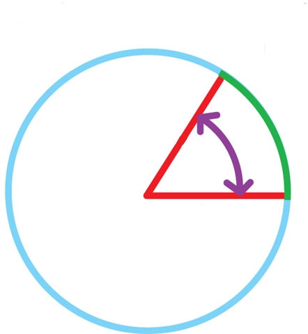

For OP: In reality MRAD & MOA are the same thing. Just angular measurements.
The key is to have turrets a reticle match and not to convert. Just think in your chosen scale. Where MRAD/Mils excel is that in practical application it is applied in base ten. Scopes are generally set up in .1 or 1/10th increments.
MOA is basically base 4. With scope generally set up in .25 MOA increments.
So, if I say 1.5 mils you immediately know it is 15 clicks by simply moving the decimal point. It works much like the metric system.
6.75 MOA you need to multiply by 4 to get 27 clicks. (Someone check me, it has been a while)
Also there are some really cool “quick wind” and “speed drop” stuff that is primarily for mils. I am now learning about a system where if you have a known dimension, say 12 inches and you can pull that off your target in Mils boom you have your drop without ever needing to know your range. Damn handy if your range finder craps out on a hunt.
The key is to have turrets a reticle match and not to convert. Just think in your chosen scale. Where MRAD/Mils excel is that in practical application it is applied in base ten. Scopes are generally set up in .01 or 1/10th increments.
