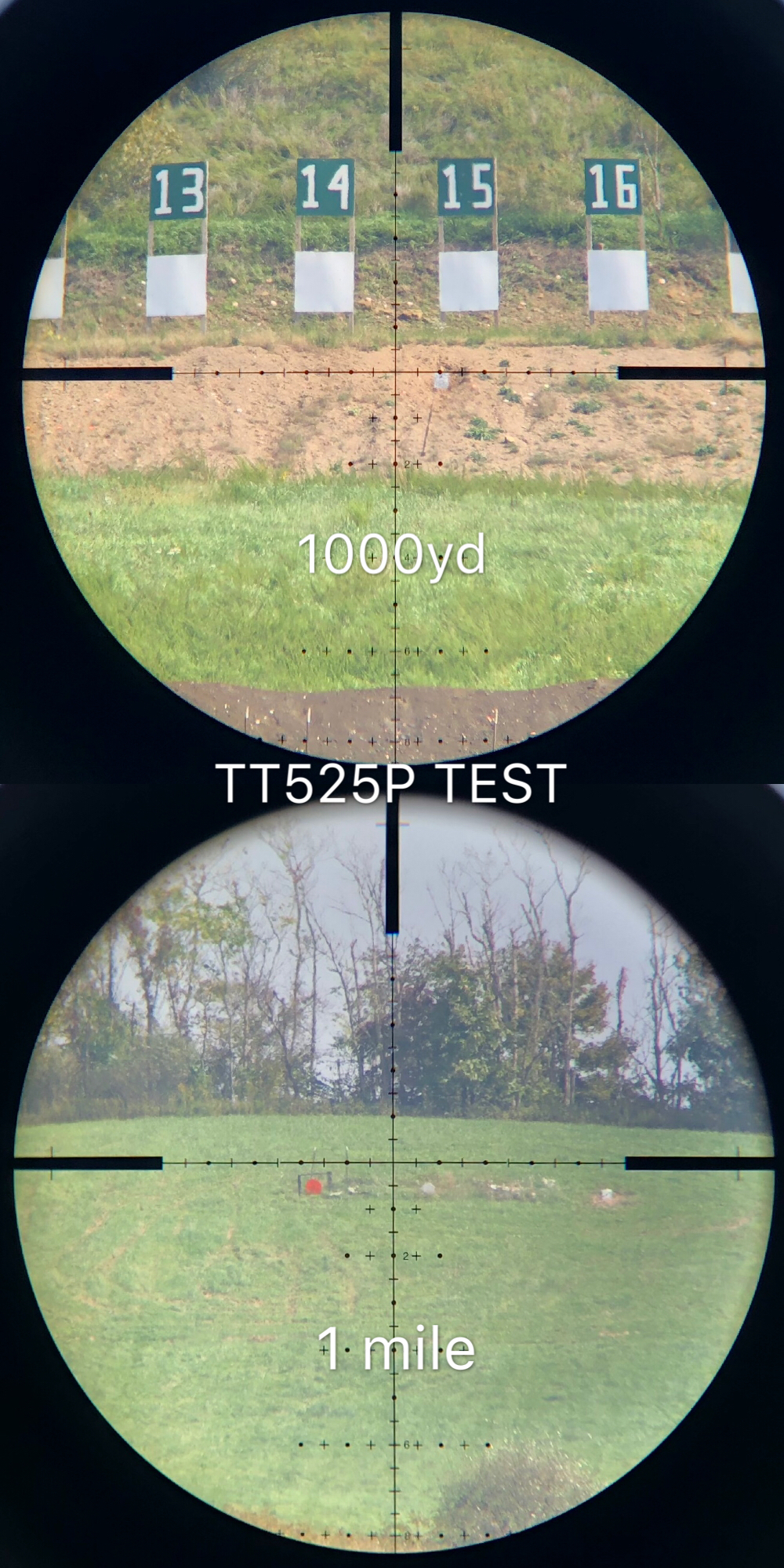

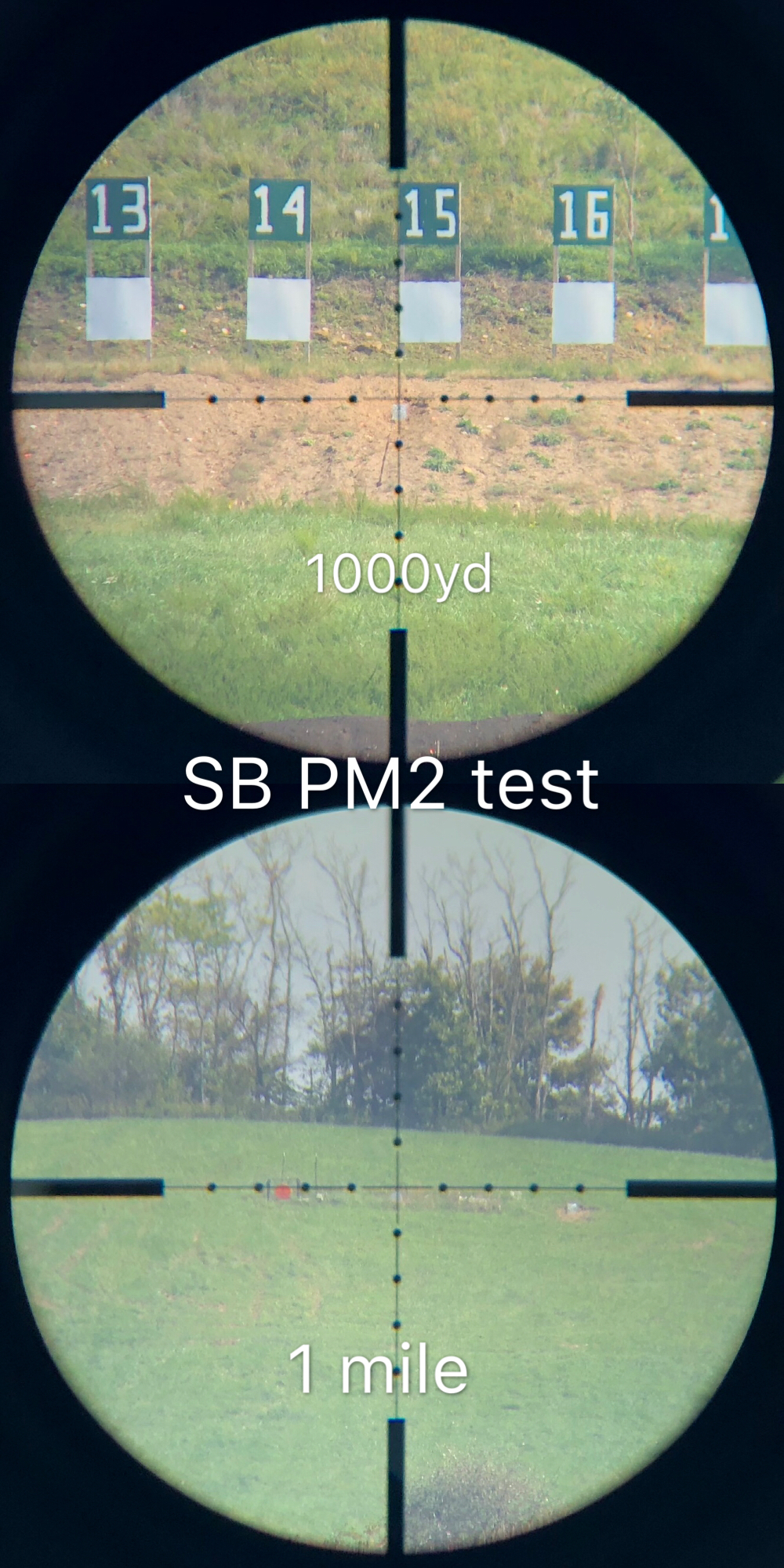

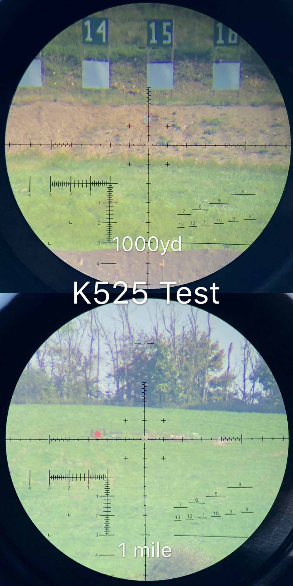

Rifle Scopes K525 SUCKS !!!!! SB PM2 5-25 vs K525 VS TT525P
Msaon308
Oct 7, 2017
122
34
Indiana
Well, I am backing into scope market for my 6.5 PRC build. Just tired of SB PM2 5-25 because I own 3 of them even on my rimfire trainer..... Because they are The BEST ELR scopes( at least about 4y ago I am still on the scope market). I do not shoot PRS match and I shoot meanly on 1K and 1 mile sometimes over 1 mile. And here are some photo I took at the same place/ target and the same time ..... at 1k and 1 mile. ( All three scopes I paid out of my own pocket)
I do not know what you guys think. There are just my 2cents. I had a K624 before the same thing in the photo even worse than k525 and sold it. And I bought a k525 hope it will change well I guess not........the FOV suck also the purple color. Really? Kahles WTF? Is this how you do a scope cost 3k? At the same price range SB PM2 still the King. like you guys see in the photo the TT525p is much better than SB PM2 at 1 mile but not so many different in 1k. I know most of the members do not have the chance or time to shoot 1k and 1mil often like me (every weekend 1k. 4 times 1 mile a month). So is tt525 worth you about 1k more than SB PM2? For me hell YES!!!! but not for everyone. In short, the K525 just not worth that price tag do not buy it !!!!!! Try to find some deal on SB pm2 is your best option.

Thanks for posting the pictures. I agree with your assertion. I would have liked to have seen a picture through a Nightforce ATACR F1 at the same time. Would have been interesting. I switched from a K624i to an ATACR F1 7-35 and I find the Nightforce to be far supperior.

I am surprised by your experience with Kahles. I see it in the pic, but have always found Kahles, Minox, Schmidt and ATACR to be of the best in long-range scopes. I find Minox and Kahles, personally to be a tad better than Schmidt. I have not tried TT.

Looks like K525 is complete fail line up with classic gold standard pm2 and the new king TT.
Personally I had a k624 and the reason I don't like it is CA issue, for some people it not matter to their accuracy of shooting but it make me mad and I have to get rid of it at the end.

Thank you for posting this. It’s great to see a real world difference. Now I just need to figure out how to tell the wife I want to buy a TT.
hahaha
I am interest in the NF 7-35 too,really want to bring it to 1k and 1 mile to take a look to see how it compare with the SB/tt/hensoldt
Won’t argue the CA in the pics, but the FOV is misleading because the image is centered lower than the TT & SB and in effect “crops” out the numbered targets.
Additionally, the focus looks WAY softer than both as well. In the 1k pics, blades of grass are clearly sharper in both the TT and SB. Something doesn’t seem right.
DeliaDog: I would guess that it is not a problem with focus as much as it seems to be a problem with contrast, probably combined with the shallow depth of field of Kahles scopes that makes the pictures look the way they do.
With the Schmidt and the TT you can clearly make out texture in the grass, where as the Kahles its pretty much just green. This makes me think about contrast, or lack there of.
I’ve only had mine at the range once (this weekend with plates out to 2k) and I could clearly (& sharply) see my hits at 1300. I would think I would have noticed such crappy resolution, but I ended the day thinking how nice the glass was. I’ve been using a March 5-40x56 for the past year at the same range and felt the Kahles was every bit as nice as the March.
I’ll definitely take both this coming weekend and compare them side by side at 1k.

Well, the FOV problem is a fact no matter how I took the photo......K525 fov spec on their official website is about 20% smaller than SB PM2.
well the CA and fov problem does not mean you can’t not hit the target maybe under 1300yd........but it well on 1mile. honestly the CA and FOV on k525 under 800yd is not bad. If I only shoot about 700-800yd I woud not know the difference LOL. But like I sad after you paid about 3k your hard working money......I guess you would expect soem thing better than this.
I want to like Kahles but the CA and a shallow depth of field is the reasons I will never buy one. There are a lot of fan boys in here though that will find this thread offensive.
Well, I can not change how people spend their own money. I am there is just tell people soem facts about Kahles scopes to help members to spend their hard working money wisely.

Holy cow. That's highly disappointing. I'm a k624i fanboy, but that's because mine does everything I could possibly want. It has much less CA than other scopes I've seen, including other k624i's. I guess I got really lucky with mine. I still scoff at a $400ish price increase on the k525, with only adding 2x zoom range, and locking windage turrets.

Yep I Did a review comparing tangent theta and nf 7-35 compared to the k525. There’s definitely a deterioration in resolution past 23x. It’s not horrible but it’s noticeable... Tangent theta is about as perfect as you can get it.... I expect ZCO to blow many scopes out of the water and rival the tangent. I’m really rooting for it considering it’s assembled in the US and tangent is Canadian.
My personal feeling on the chromatic aberration was made evident in my review... I hate it which is why I sold the k624 before even mounting it. I found it horrible and intolerable for principle alone. Why would I pay $3k for such a crap issue.
In my review I found the k525 improved from the k624 for chromatic aberration but it was still there. I probably should have done comparisons at white objects at distance because I have a feeling it would have been made more evident.

Guess nobody noticed, the photos of the TT & SB the point of aim puts the large targets closer to the center of FOV. The photos of the K525i the point of aim puts the large targets at the edge of the FOV.
It does look like the K525i lags the TT and S&B but that’s not really news. Those photos would of been more useful if the objects were in the same relative place for the different scopes.
the FOV problem is a fact no matter how I took the photo......K525 FOV spec on their official website is about 20% smaller than SB PM2.
I'm not talking about the FOV, I'm talking about the POA in the photos, with the TT and the S&B the POA was the same with the K525i the large targets are close to the edge of the FOV. Your photos show what everyone already knows, Kahles scopes have trouble with CA, the thing Kahles does very well is the eye-box and reticle design.

That 1000 yard Tangent Theta image is truly impressive.
I will state that my K525 experience is not the same as @Msaon308 , but mimics more of @DellaDog 's experience. The image does deteriorate at anything above 18x. I typically run mine in the 12-18 mag range and the image is excellent.
I could not use a K624 because of the CA, believe me I looked through several and tried, which is ultimately why I went with an AMG instead. I sold the AMG to fund the K525 and do not regret it thus far. Yes, CA is still present but it is not nearly as bad as the K624 and is better than the k318. I would put the CA on par with what I saw in my T5Xi.
As far as image clarity/contrast/resolution I would put it as superior to the AMG. I have a simple test I run, there are power lines at ~700 yards. On those telephone poles are tags, about the size of an index card, with numbers, barcodes and labeling. Depending on how much I can make out on those pole tags determines to me the image quality. I was able to decern more with the K525 than the AMG.
